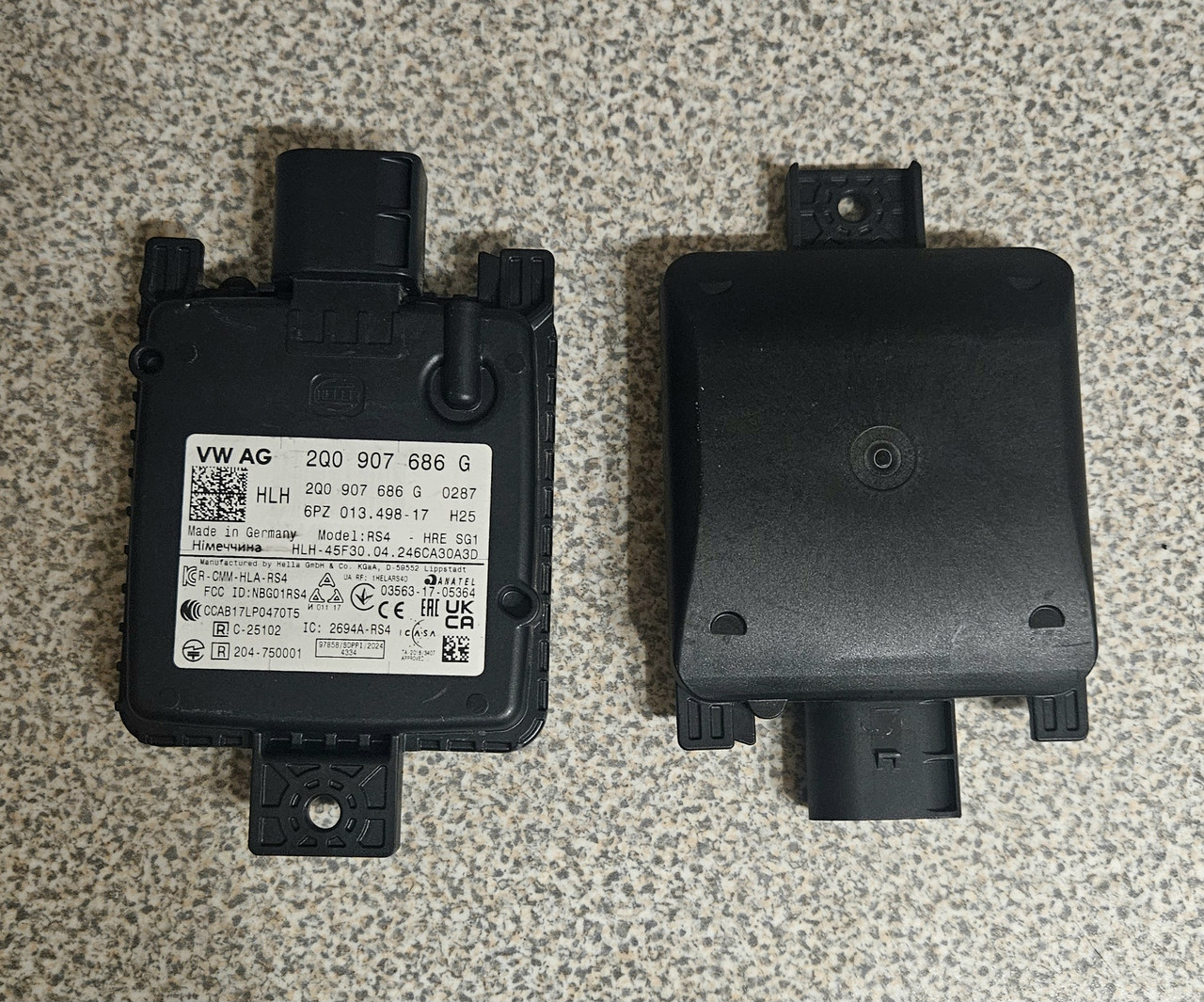

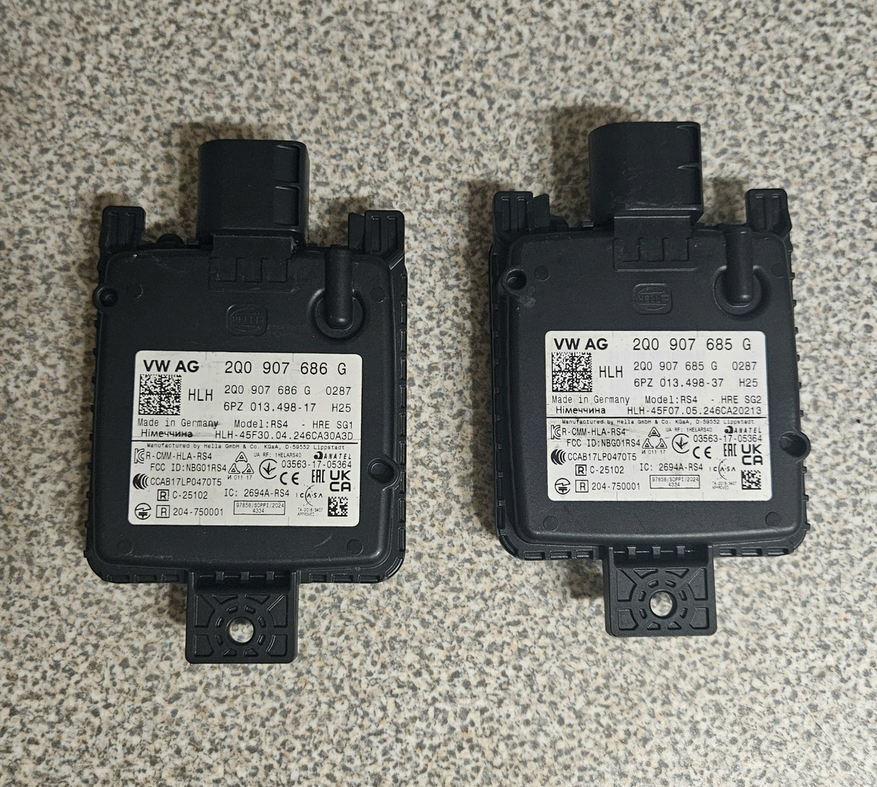

Finally, i have those radars at my hands.
I hope I can install them on the car this weekend. If the weather helps...

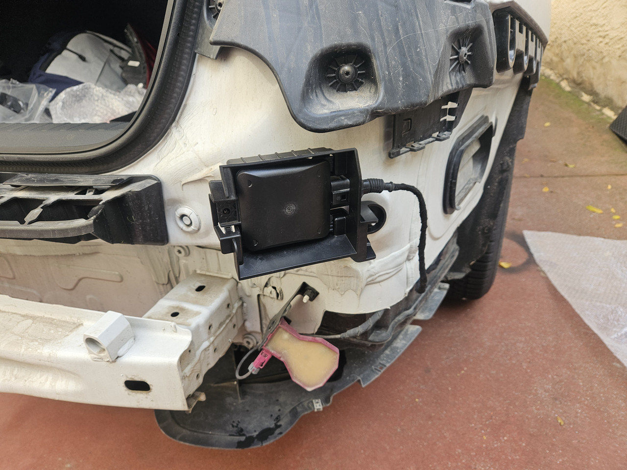

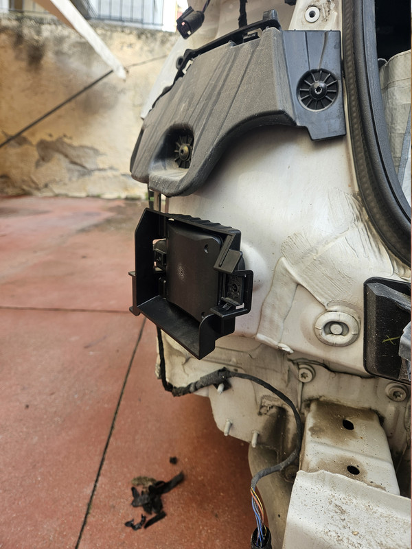

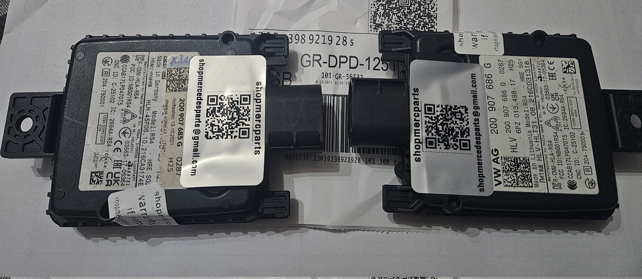

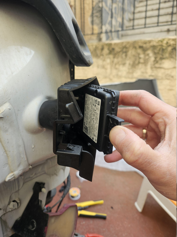

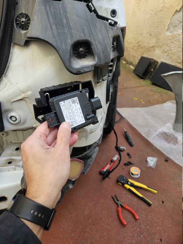

2nd attempt for BSD installation
Used radars with index G
Some pictures from the installation, the same prosedure as the others radars.

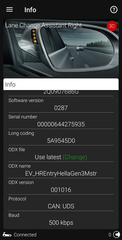

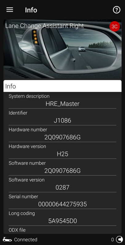

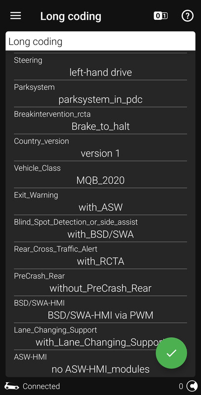

The result (from the OBD11 perspective)
Because the radars are used, they are already encoded and can be seen here:

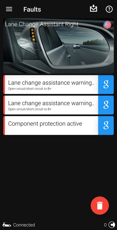

Next step, removing Component Protection... the most crucial step.
giannis20vt
Posts: 425
Location: Greece
Re: Skoda Octavia MK4 2023, 2.0TDi DSG Ambition
Post by giannis20vt »
#2nd attempt
Today there was an attempt to remove the Component Protection on the BSD radars.
https://youtube.com/shorts/G214JMYkLHE?feature=share
Error !!!!
It seems that this retrofit is never going to happen.
I'm disappointed.

At the SKODA forum ( i did the same post) 2 guys told me
FAZ4990E means the the unit is stolen !!!!

FAZ4990E is not good but not necessarily stolen, it can also mean the part has been swapped in repair process etc. Put it into trash and get brand new ones.
No one is hacking them due to their relatively cheap price.

3rd attempt
Another pair of used parts.
This time with "Product origin assurances for the purchase"
