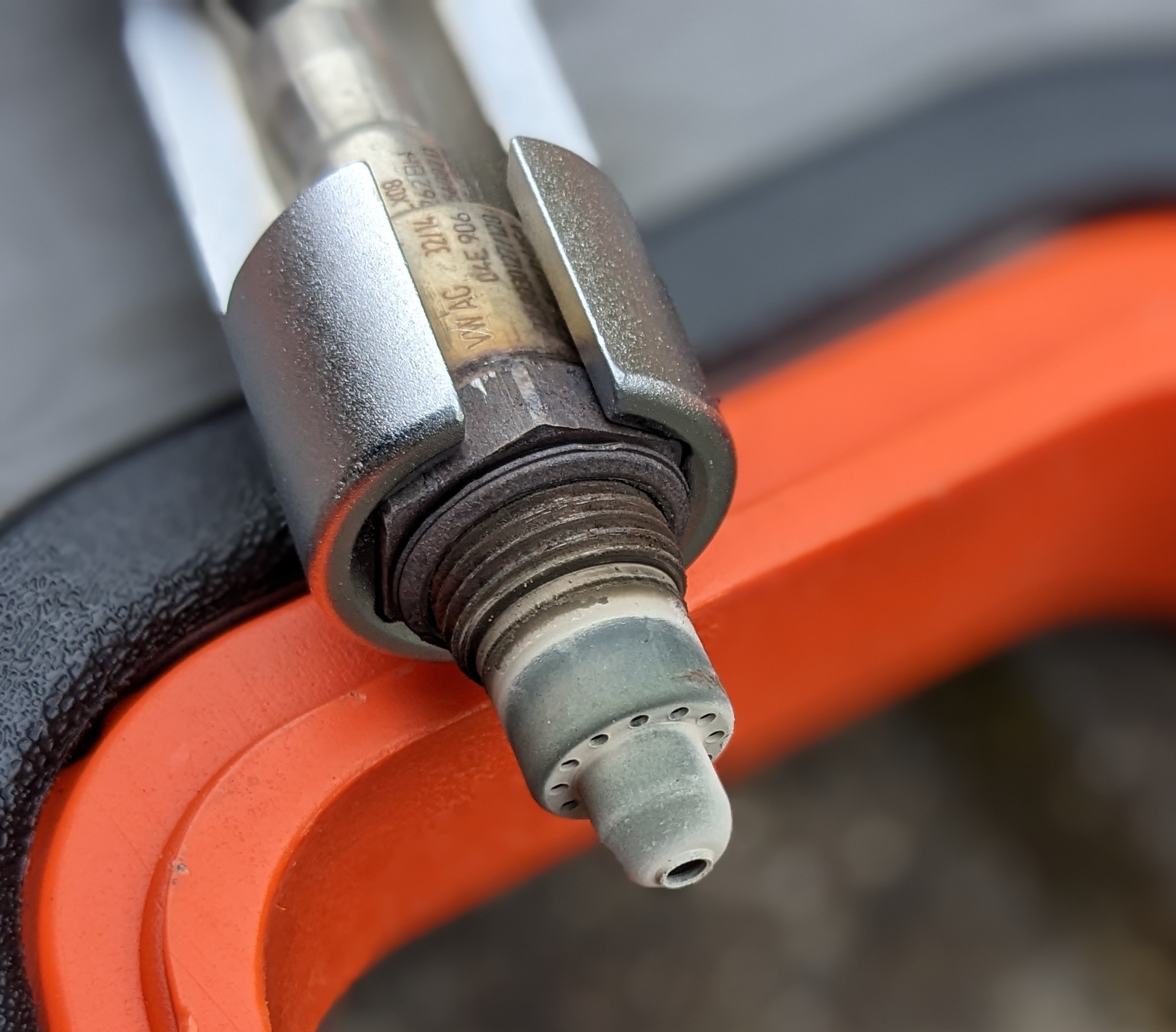

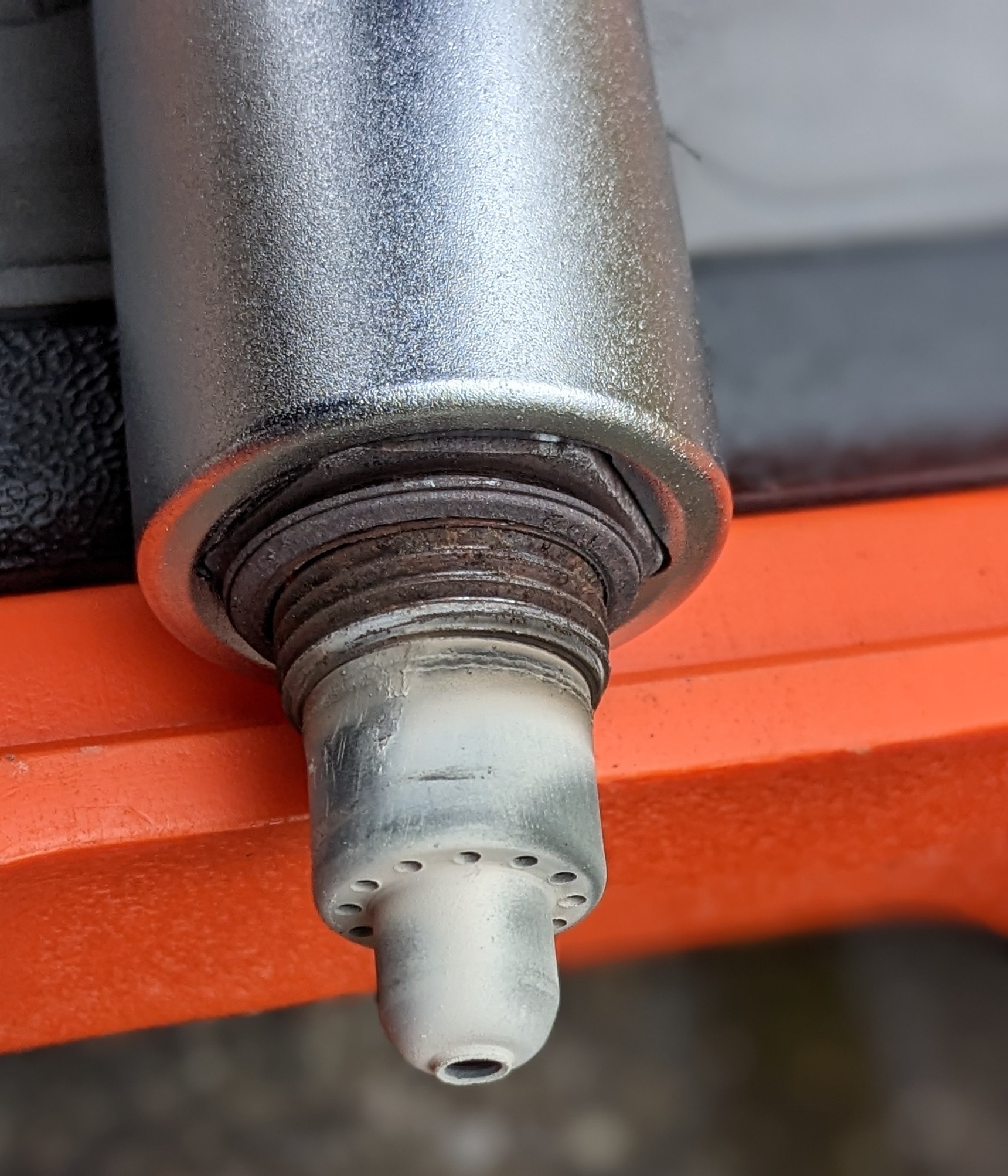

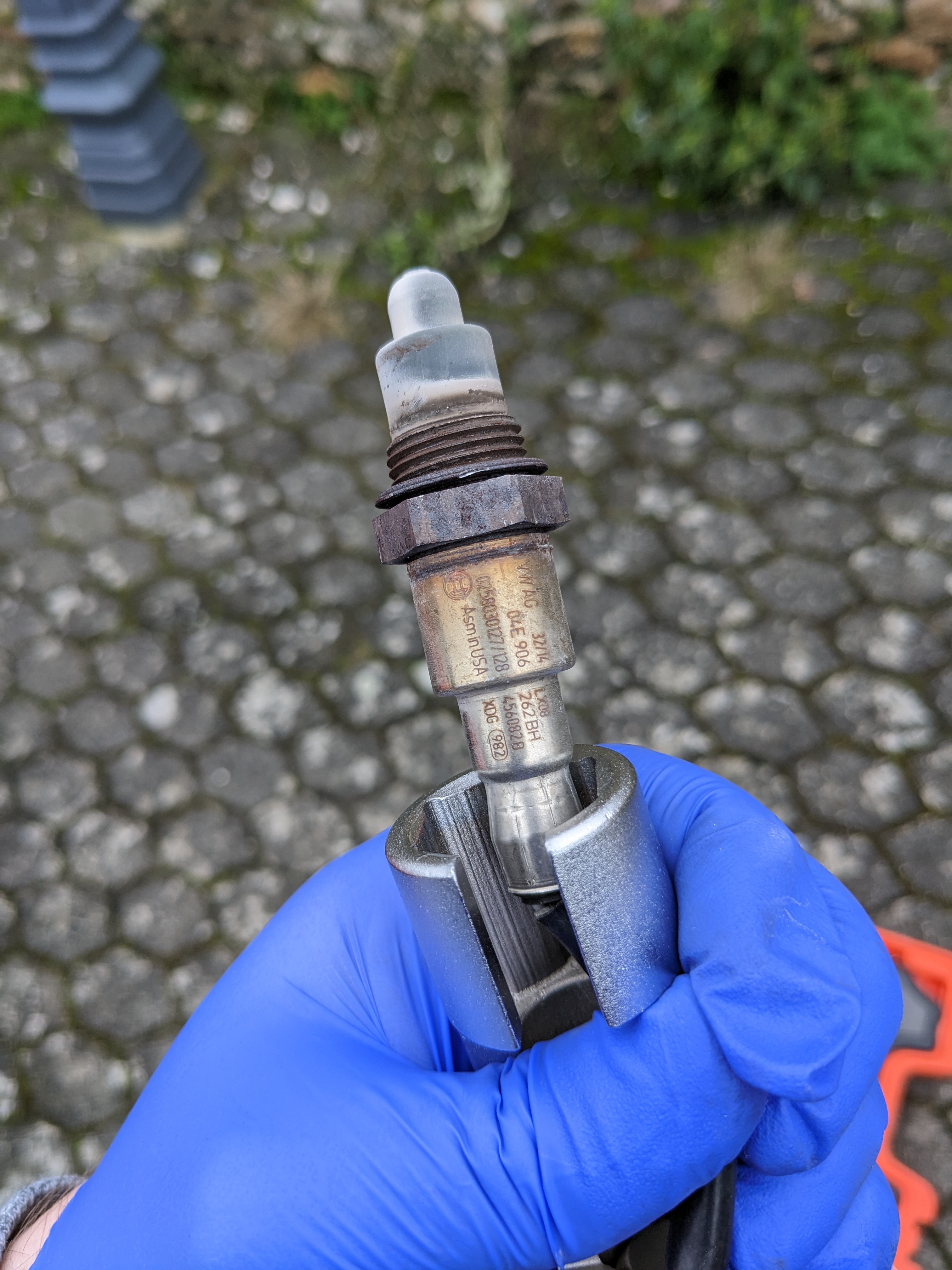

Also, today I removed my 0² sensor to check it visualy.
PXL_20250207_140849827 - Copie.jpg (2.19 MiB) Viewed 12999 times
On one side, little white pouder (?) and on the other side nothing.
According to some people it's quite normal as modern engine tend to run lean to pass emission test.
For info, my long term fuel trim is at -0.8%

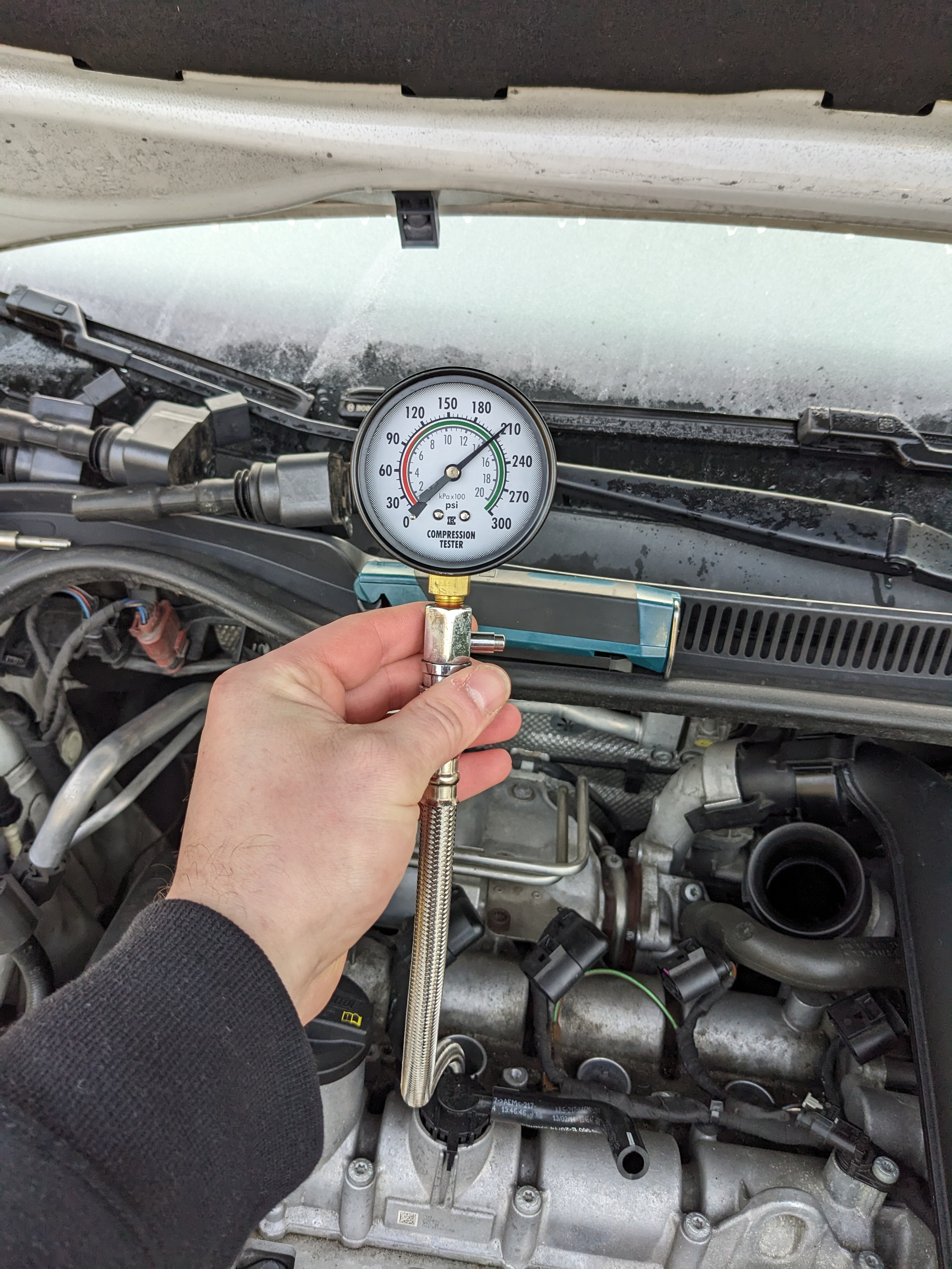

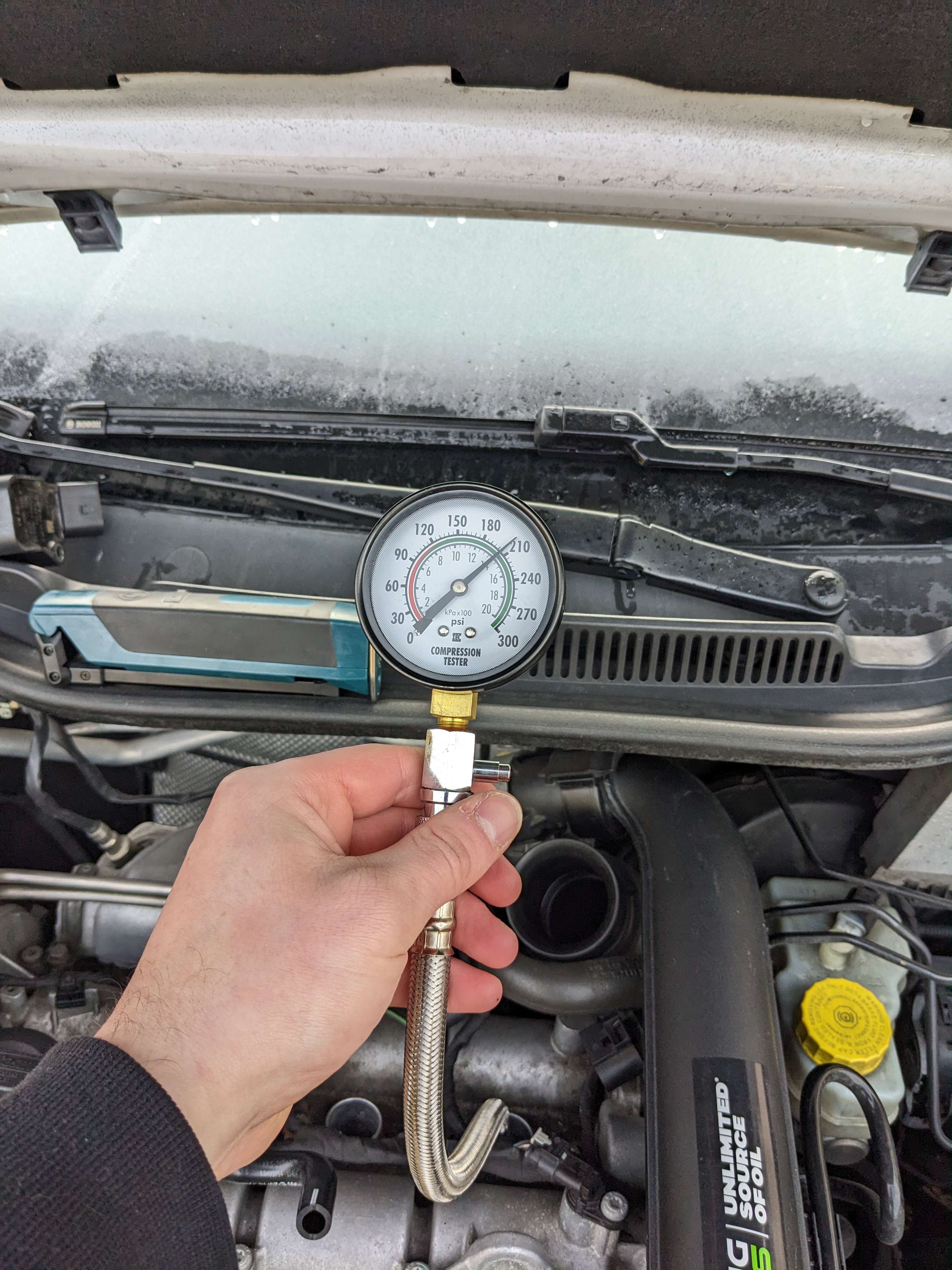

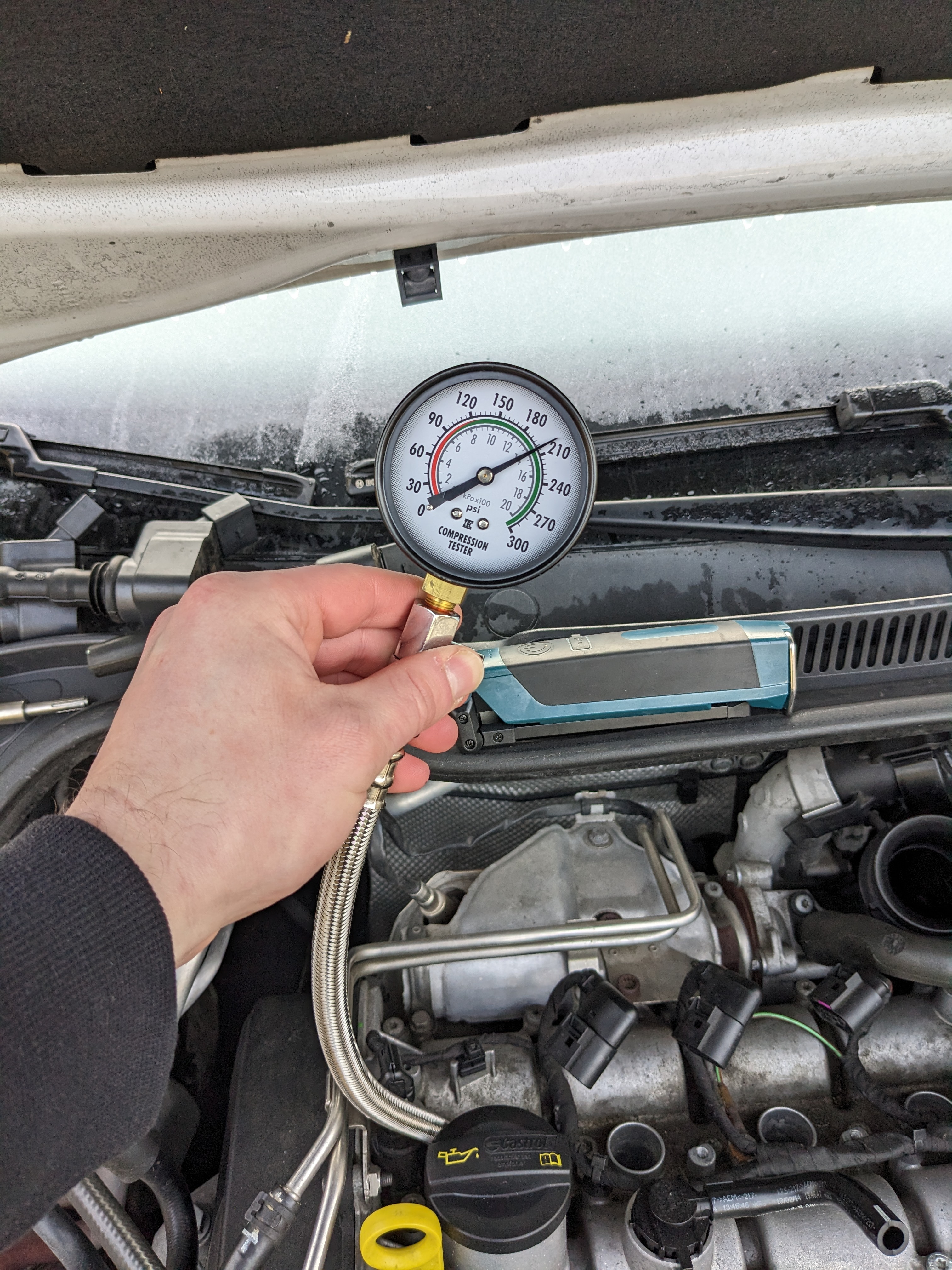

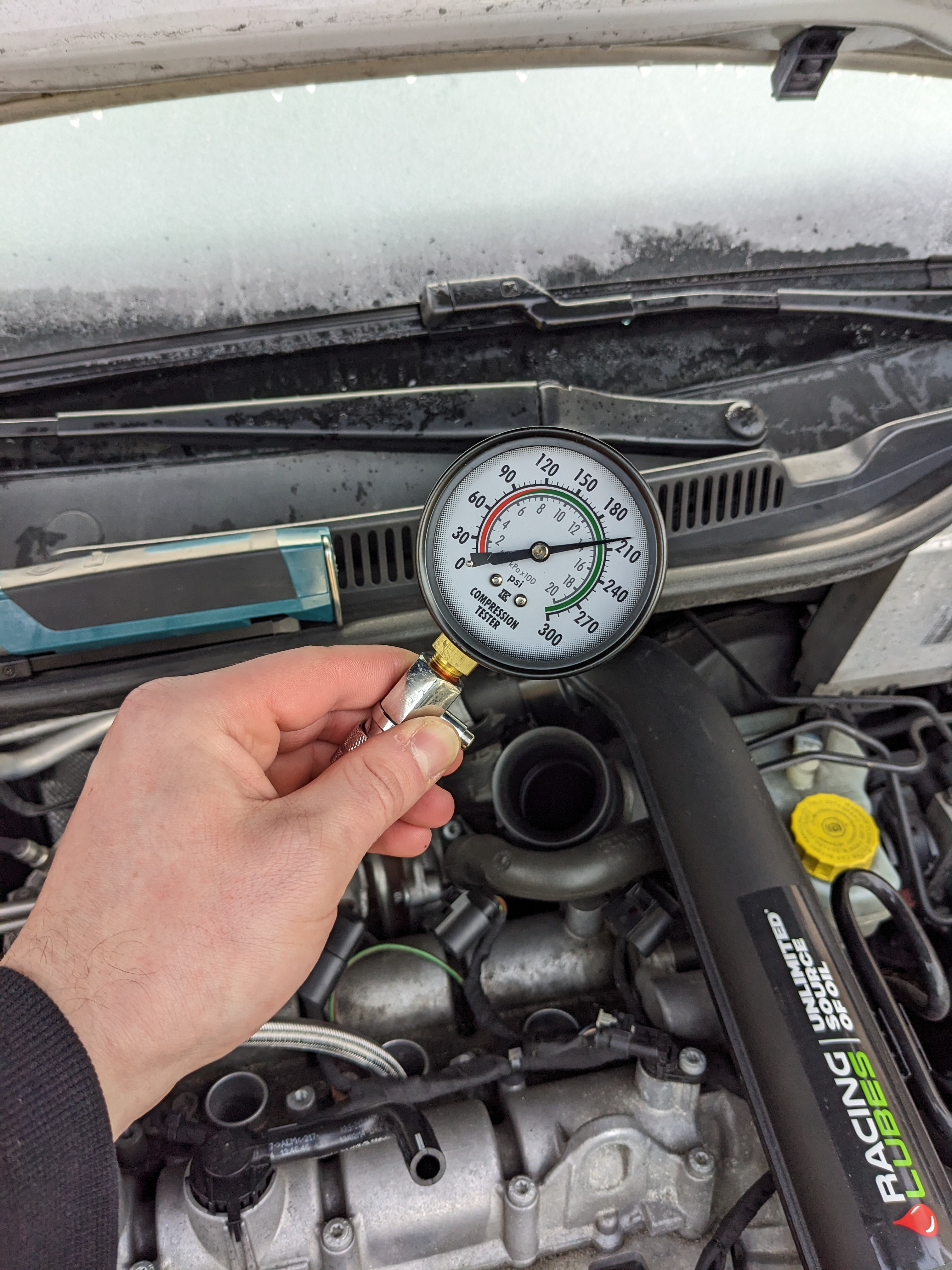

So today, by -2°C, I took compression of my engine again.
I wanted to know if it was a mechanical issue due to the cold weather (piston ring, valve seal or whatever).
I remove all the fuses in relation to the fuel system and started the engine until it stop.
By the time, oil temp reach 40°C. My issue is present up to oil temp at 60-70°C so it's okey.
I was confident about the health of my engine and here are the results:
Results are similars.
But one major point: I don't know how accurate my device is. So results are pretty good but we have to be careful.
VW Manuals said: Between 10 and 15 bars for a good engine.
Tomorrow I will run with my coolant temp sensor disctonnected to see, when engine is in open loop runs better or not.
If it's the case, coolant temp sensor is faulty or not accurate for ECU.

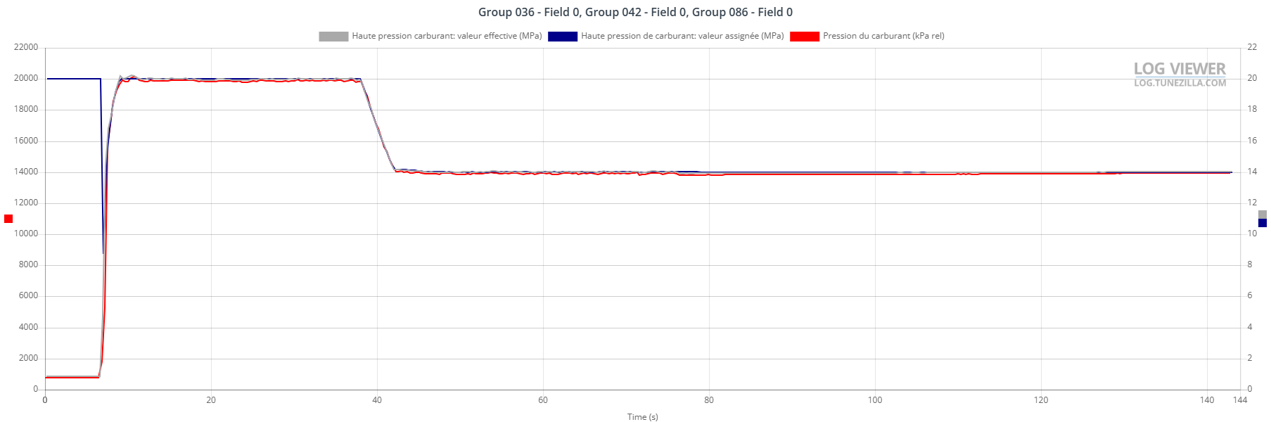

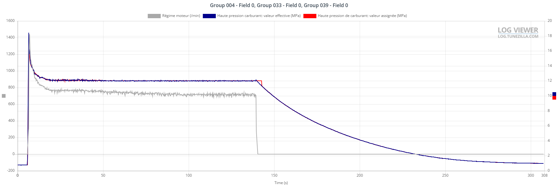

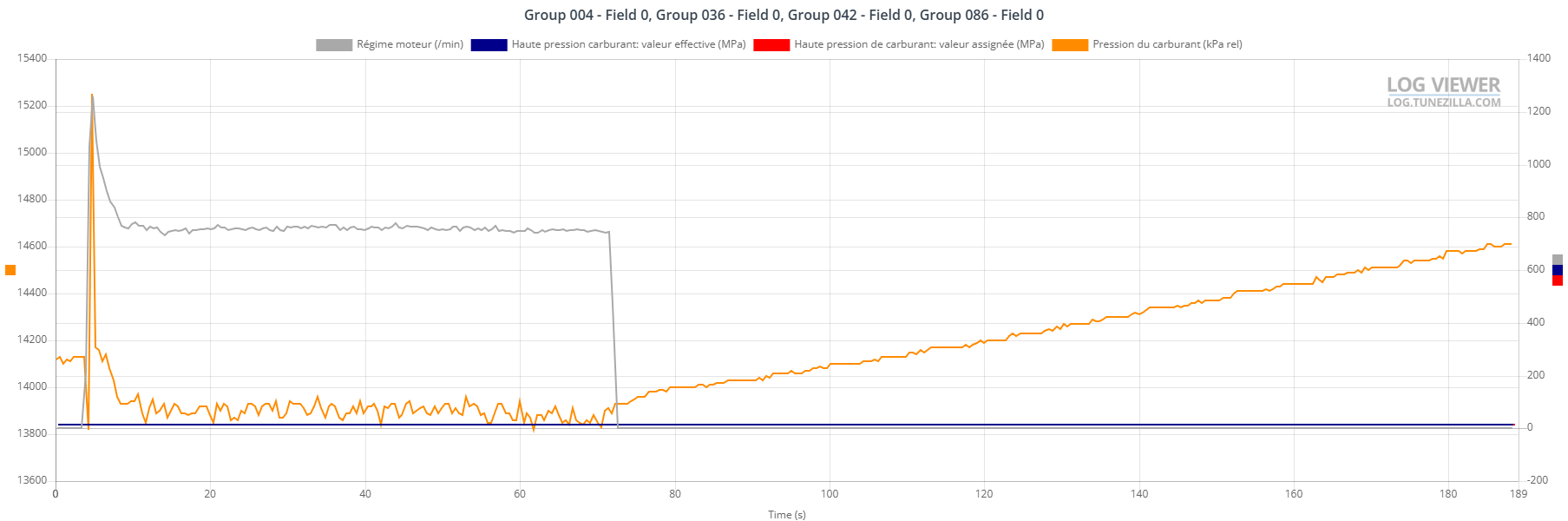

Since I'm focusing/suspecting fuel issue, I did a comparison with my parent's car.
A Skoda Octavia of 2015 equiped with an EA211 CZDA engine (1.4 TSI 110KW).
Mine is a EA211 CJZC engine (1.2 TSI 66KW) but the architecture is the same.
Here is the graph of the high fuel pressure of the Skoda.
It was used few hours ago and some pressure was still inside the high pressure fuel rail:
*I just forgot to include RPM on the first*
Group 004 - Field 0, Group 036 - Field 0, Group 042 - Field 0, Group 086 - Field 0.png
Group 004 - Field 0, Group 036 - Field 0, Group 042 - Field 0, Group 086 - Field 0.png (105.72 KiB) Viewed 12072 times
Here with RPM
Group 036 - Field 0, Group 042 - Field 0, Group 086 - Field 0.png (81.76 KiB) Viewed 12072 times
When can notice since the moment engine is switch OFF, fuel pressure remain stable and even increase in the fuel rail due to the heat generated by the engine and by the fact, injector/fuel pump are fueltight.
And here, the graph of my Polo.
Car was used until midnight and the test was performed 14-15h later.
Notice how low the fuel pressure in the rail is low.
Group 004 - Field 0, Group 033 - Field 0, Group 039 - Field 0.png (100.11 KiB) Viewed 12072 times
Engine was cold so I let it stabilize during 2 minutes.
Then I switch off the engine.
And immediately, high fuel pressure drop like skyrocket.
What I do not understanf/missing is the fact that the "High pressure fuel request" is also dropping and if there is a link between the two (request and actual pressure mesured in the rail).
On the Skoda it stays at 140 bar, factory value for idle (on mine it's 120 bar).

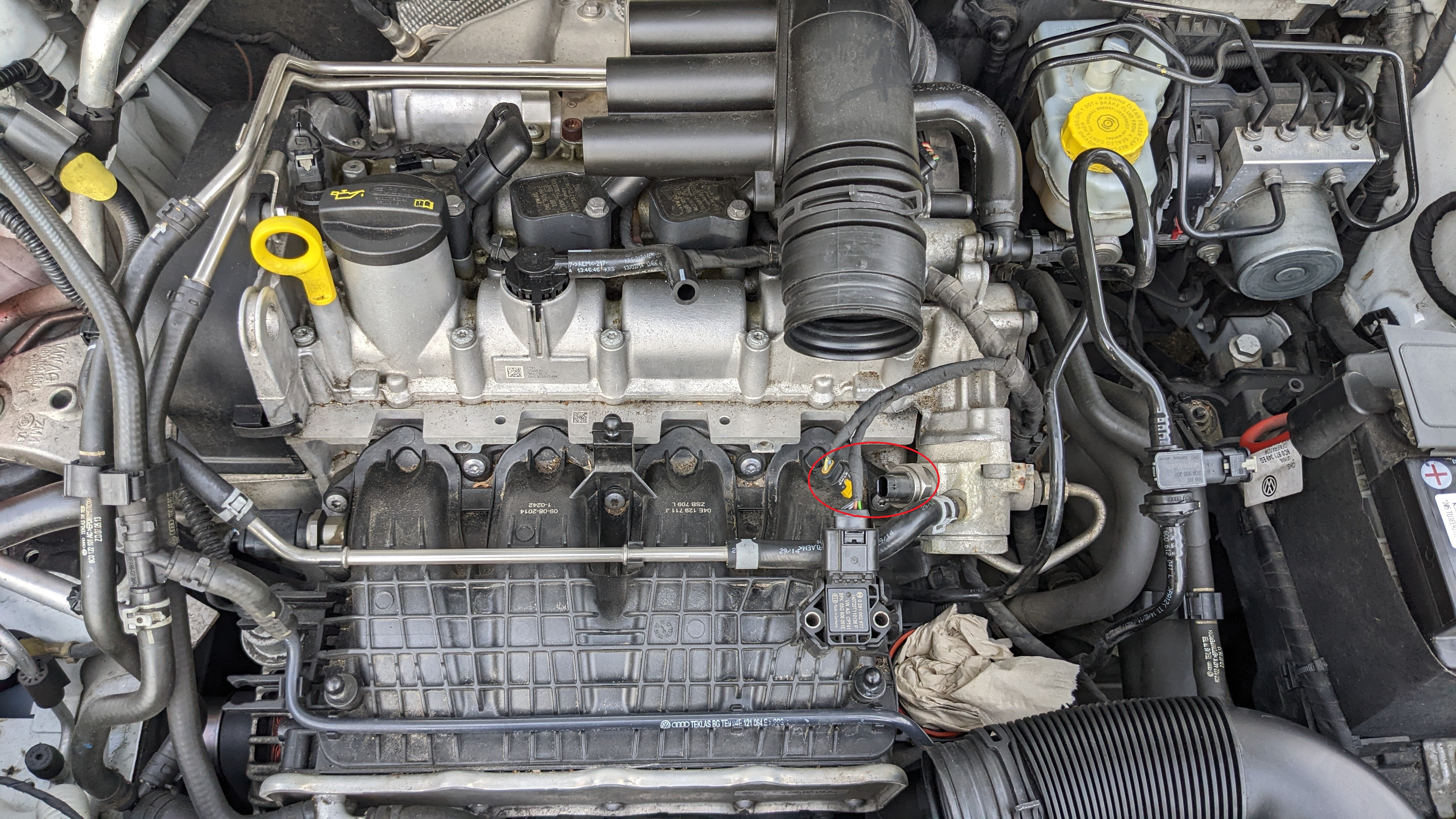

With VCDS, the LPFP went smoothly to every level of power/pressure. And from what I can heard, no issue or suspect noise.

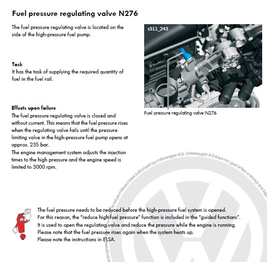

Now today I was on the HPFP and the N276 solenoid.
I'm going to try to measure (time permitting) its resistance and power supply.
On the internet, the value seems to be between 1 Ohm and 1.5 Ohms.

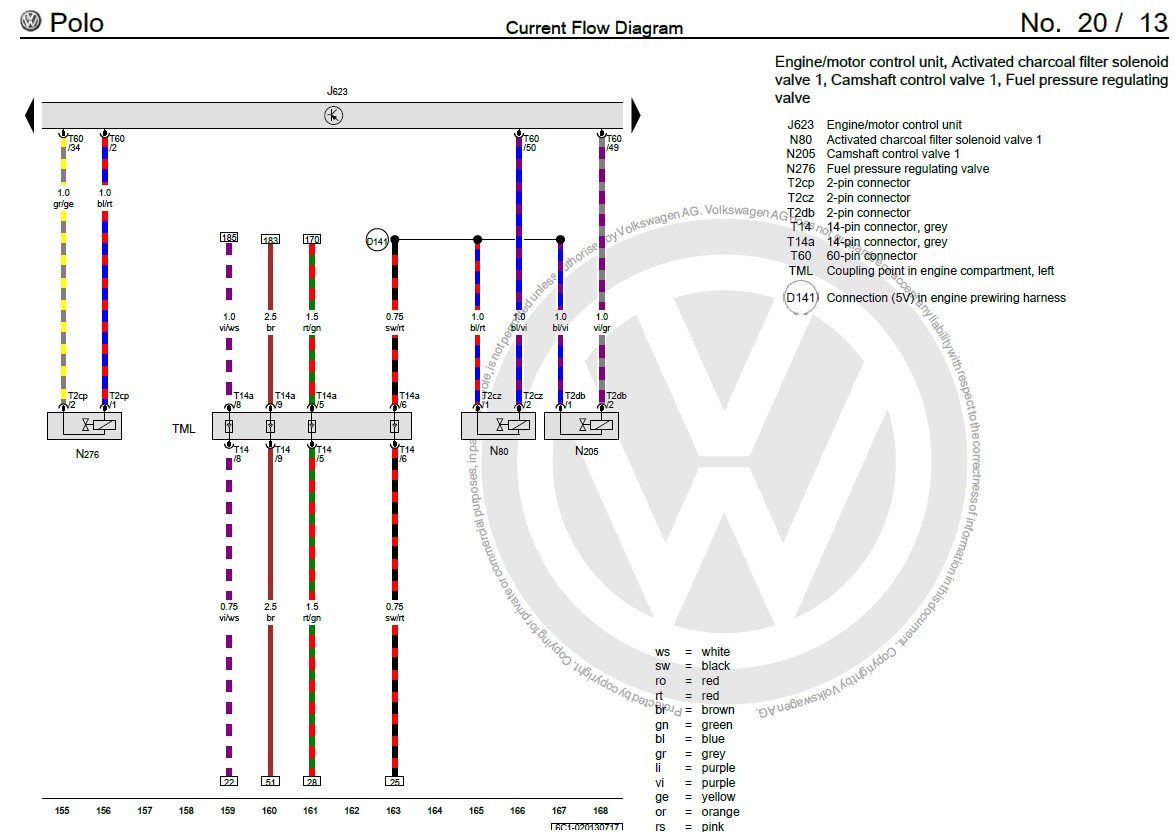

For the power supply, between 11 and 12V also according to internet, but on my schematic: no informations.
Also, I'm going to check that if I disconnect the N276 sensor, I have 235 bars by default (degraded mode):
Capture d’écran 2025-05-31 131606.jpg (80.87 KiB) Viewed 10076 times
When I disconnect the N276 connector, the pressure rises to 235 bar.
The values are quite variable (it's not a perfect 235) between 220 and 235 bars (a little more).
Resistance values are between 15 and 16 Ohms (the engine was still warm, at least when I opened the hood, you could still feel the heat).
Being a solenoid, its resistance will increase with temperature.
I'll be able to try the experiment tomorrow, with lower temperatures and with a cold engine.
Now for the power supply:
-5V after ignition (engine off)
-5V engine on
So I'm quite a little be confused and bored by this issue :banghead:

Just by curiosity, I want to see if there any difference. The thing is, even on VW workshop manual, Wiring Diagramm, I can't found the spec for my N276 internal resistance.
I have to rely on internet only.

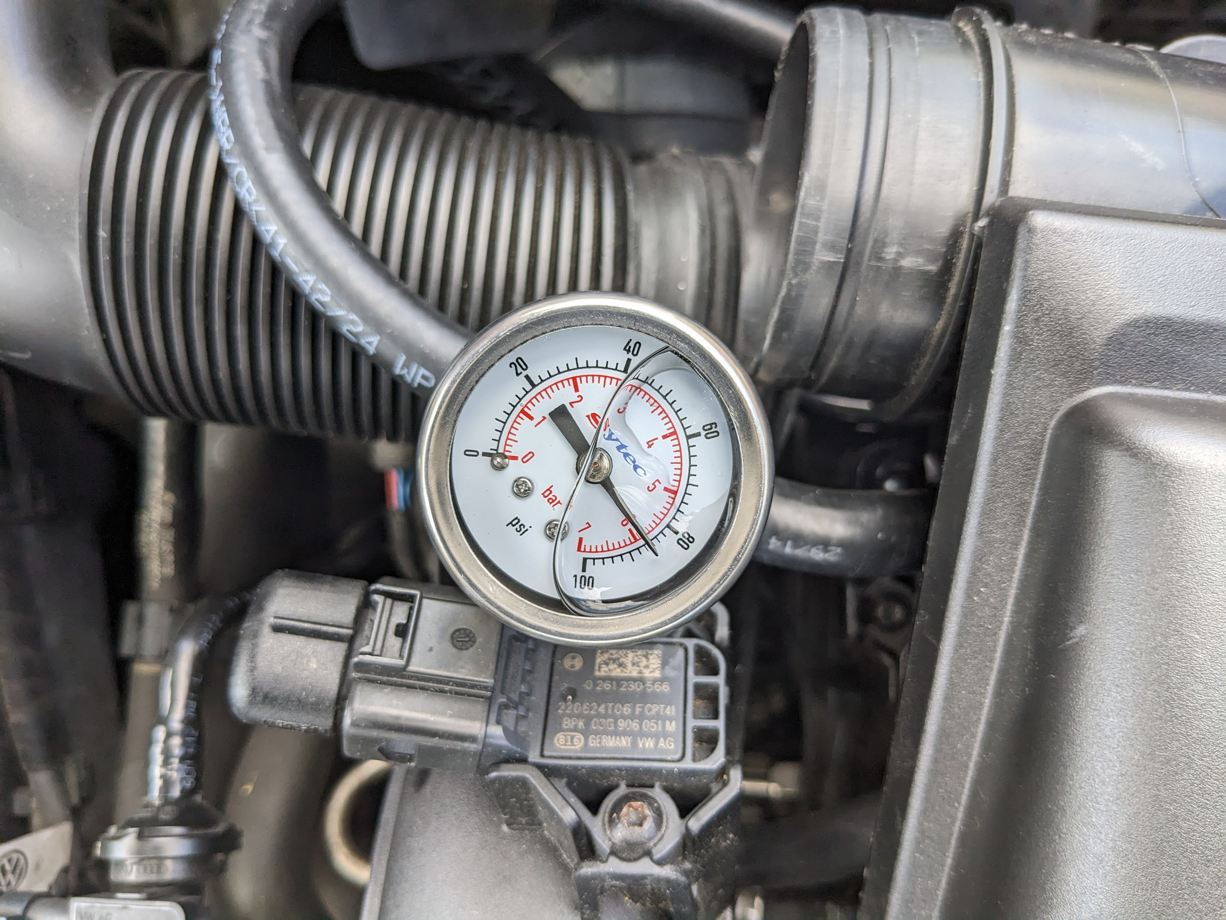

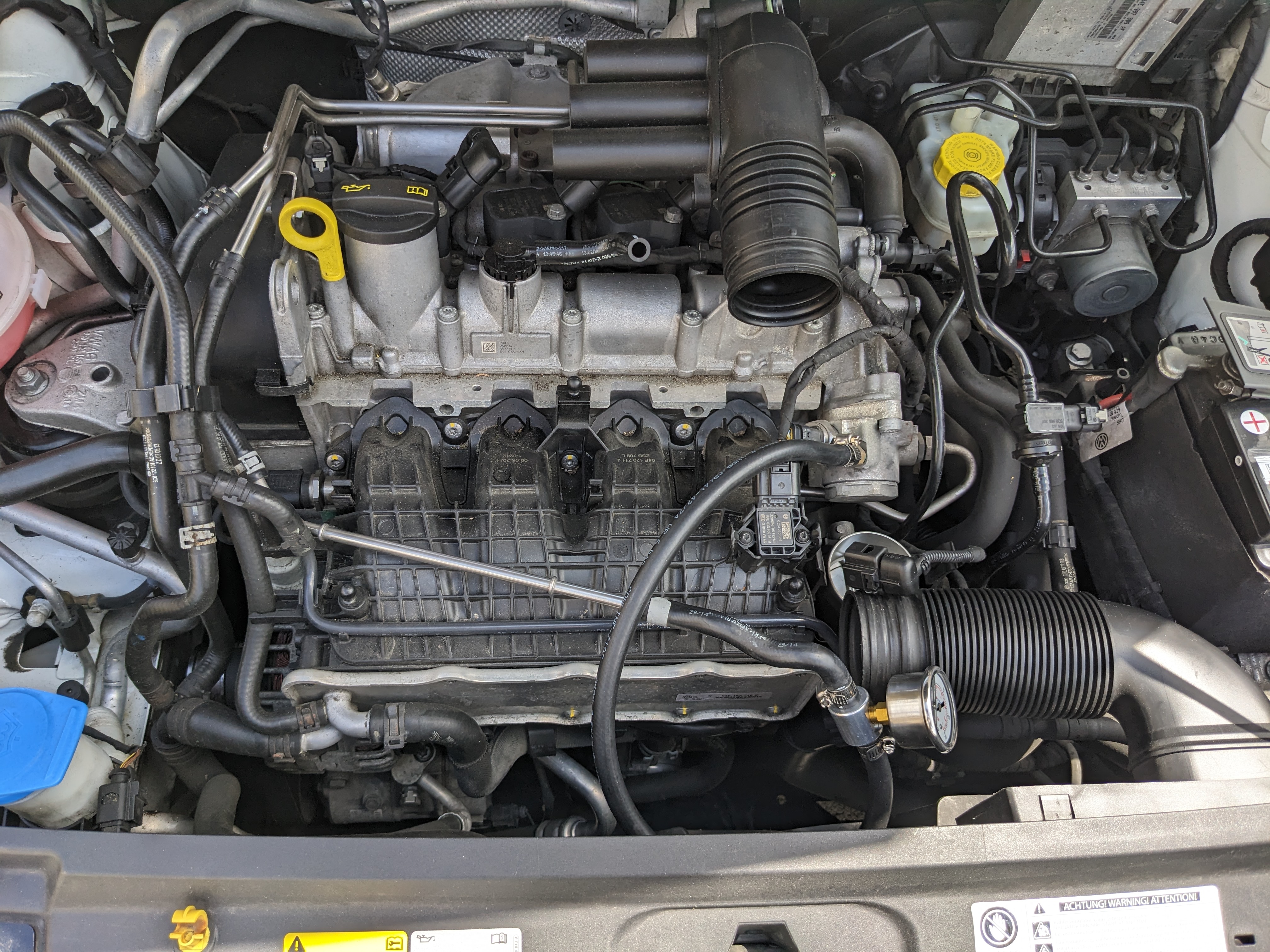

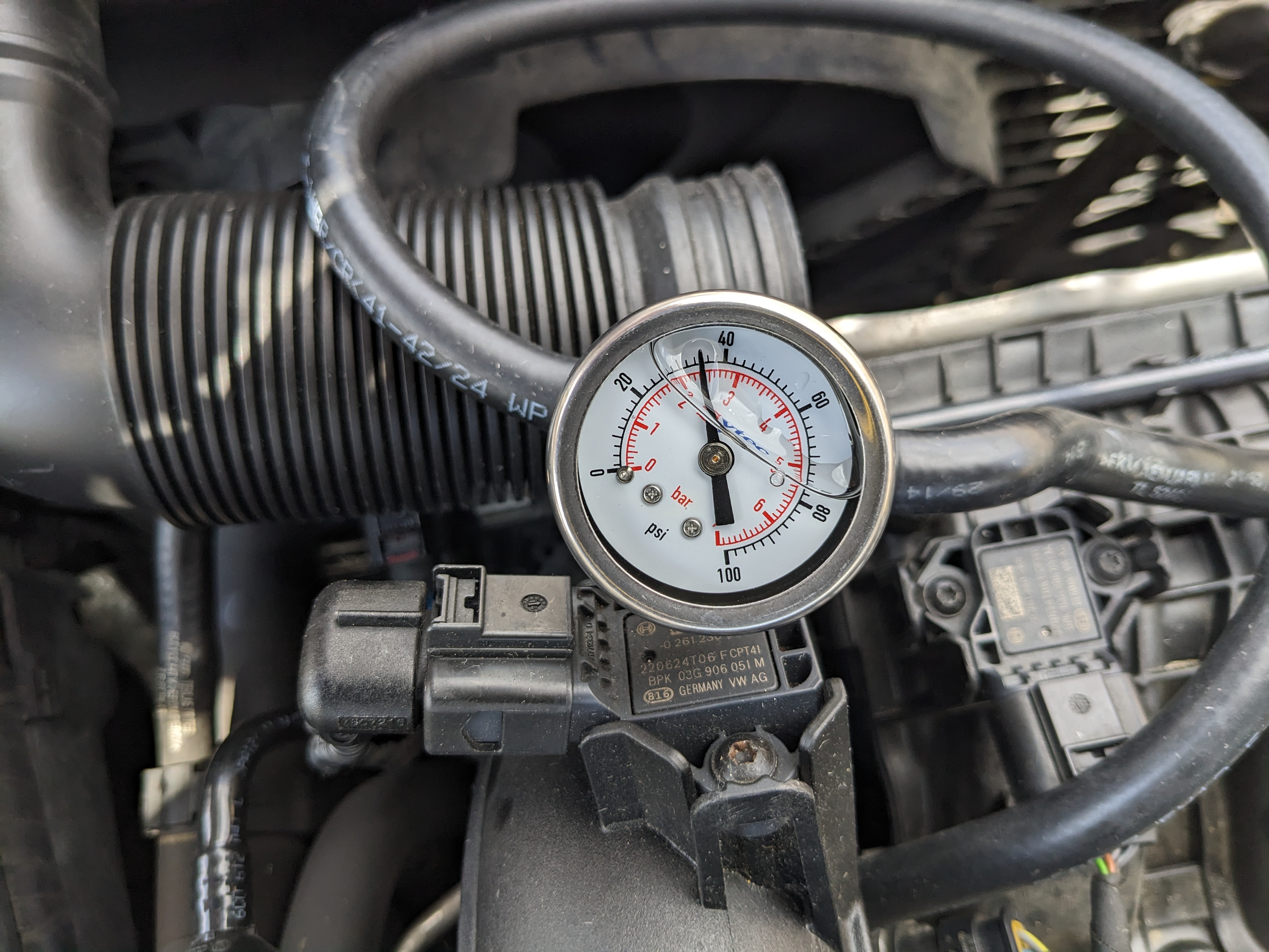

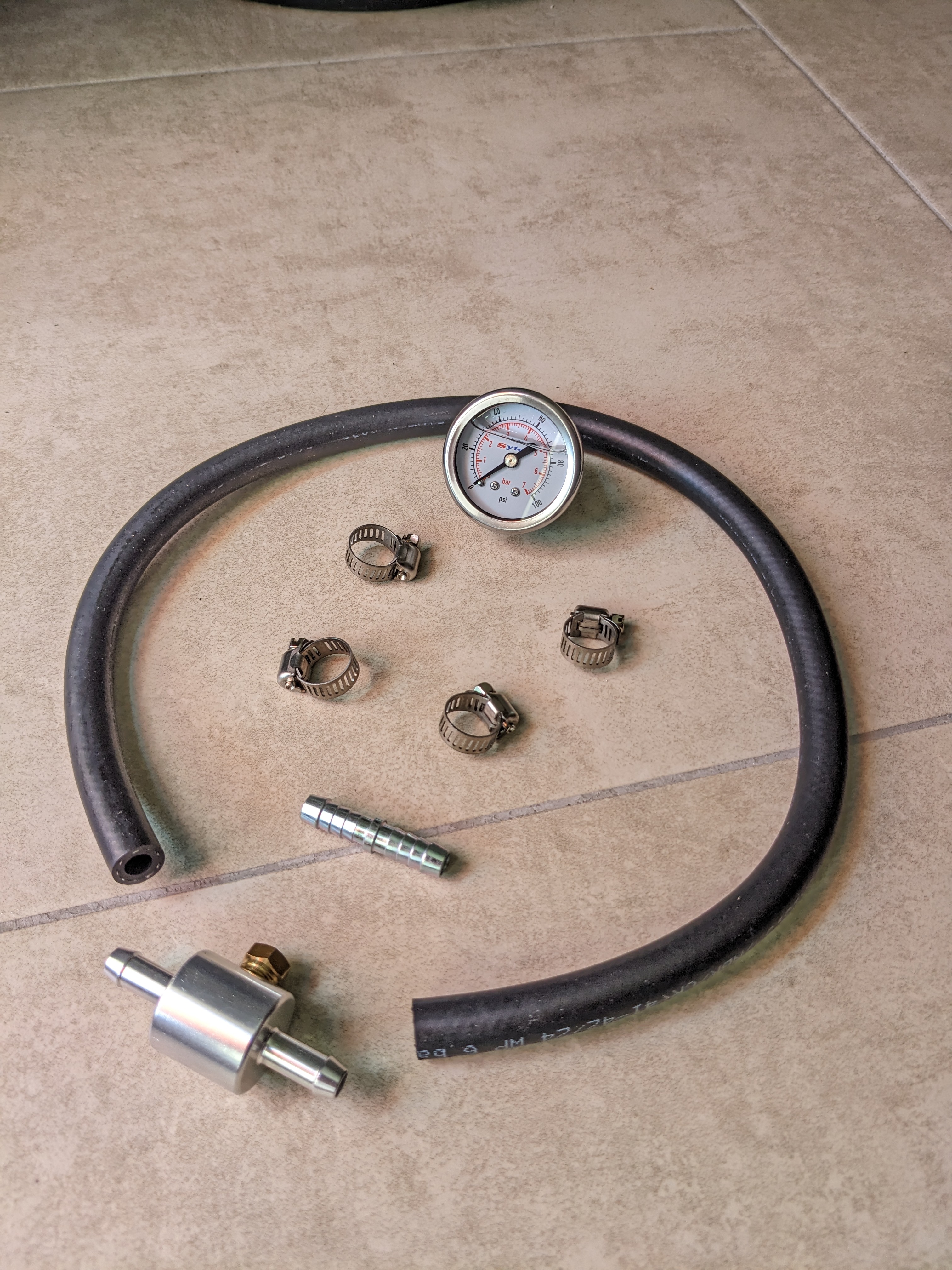

So today I decided to investigate the LPFP:
First try, ignition "ON", the LPFP prime the circuit just over 2.5 bars:
https://youtu.be/18rXd6RqqVU
According to my VW documentation, the low pressure fuel pump must regulate between 2 and 6 bars depending on engine requirement.
Now with VCDS, I can test the low pressure fuel pump on it's entire power range, from 0% to 100%.
Pressure almost reach 6 bars:
Now, an other video with the following sequence:
-Ignition "ON", pump priming
-VCDS test of the pump (pressure reachs almost 6 bars)
-Engine start with revs up to 2000 rpm
https://youtu.be/SJiQtxjRtQ4
What do you think?
If we follow the VW doc: no problem. The values are in the specs (4-7 bars via the VCDS).
Now I find it hard to believe that there isn't a problem, knowing that with the engine running, I have 1 bar, 1.5 bars, whereas the regulation should be between 2 and 6 bars.
So does this pressure change according to the load? Possibly, but I have no way of knowing.
