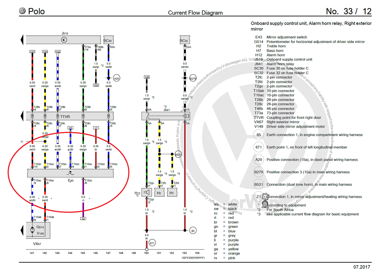

-Polo 6R (2009-2014). The turn signal indicators on the same side (Right or Left) are electrically connected (Front, Mirror, Rear), the wiring/single wire connects to a single point/terminal/pin on the BCM.
-Polo 6C (2014-2018). All turn signal indicators are independent. Each one connects independently to a different terminal/pin on the BCM.
If it's a 6R, check the condition of the connections for all three turn signal bulbs (Front, Mirror, Rear) on the side where the fault is occurring.

silly question.
Ive managed to find the relevant wires in the diagram for the drivers side indicator.
How would I multimeter test? would i connect one probe to the 28 pin connector side, and the other to the connection on wing mirror side?

i have tested the wires as per the diagram and a i get continuity.

UPDATE:
i had learnt that the cabling for the indicator runs via the motor unit behind the door panel, i decided to take a look there with a multimeter. i was able to get good amp and resistance readings on the motor.
i put the motor back and reattached the cables.
i tried the right side indicator again and i found the unit is now working as normal. also the other issue i was having (wipers activate when i turn the door handle knob to the heated wing mirror icon), i no longer there either.
hopefully this issue is now fixed.
Posts: 8902
Re: wing mirror indicator still faulty after replacement
Great!👍
If this happens again, thoroughly inspect the E43 connector (terminals, wire strands - separate the parts) or the mirror wiring (remove the fabric tape).
Related to the previous diagrams I posted.
