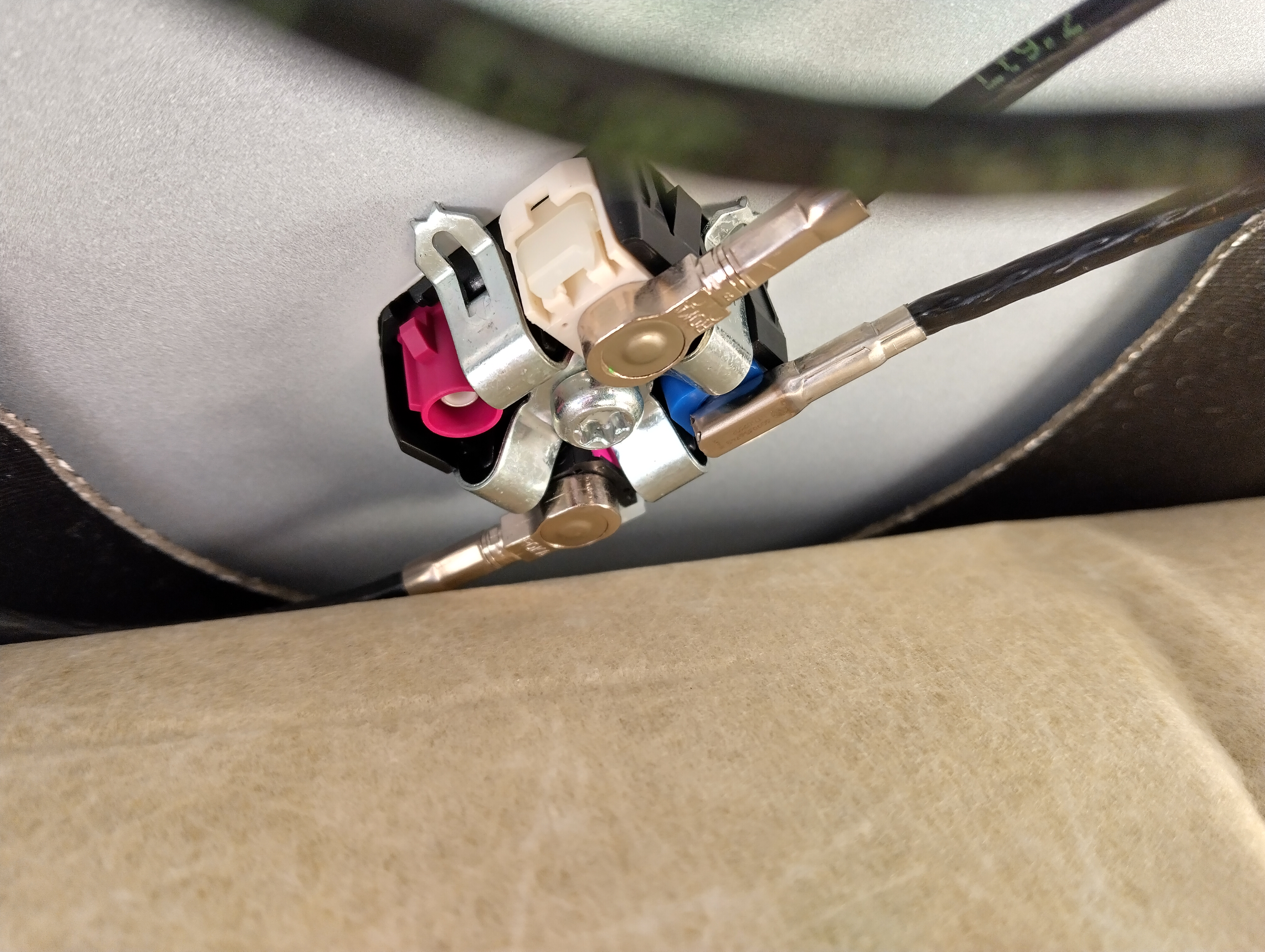

Had a look at the antenna from the inside, it looks OK, no signs of water ingress or any other problem.
Should I be looking for a new antenna?
Any pointers?

This may be the case but that fault code appears very often on polos, my 2015 GTI has had this
B126D13 and B110311 static codes from day one out of the factory with zero effect on DAB reception.
Its my understanding this is to do with the unused terminal on the amp base ? Someone more knowledgeable could confirm or deny this theory.

Maybe what I did when I replaced a non DAB system with a DAB system in my 2011 Audi S4 could help you pin point the root cause of your problem.
Initially after buying a used DAB "radio" to replace the non DAB original factory, to prove that this used system worked before spending money on getting the "component protection" removed, I bought a cheap "screen DAB powered aerial with preamp" from Halfords, I just plugged it into that new system without connecting any power to that DAM aerial's built in preamp, and draped it over the passenger seat back - and got very good DAB reception from that used but "protected" system, so that gave me confidence to get the component protection removed, then buy and fit a DAB preamp and lead.
Just a thought, before you rip things apart any more.
