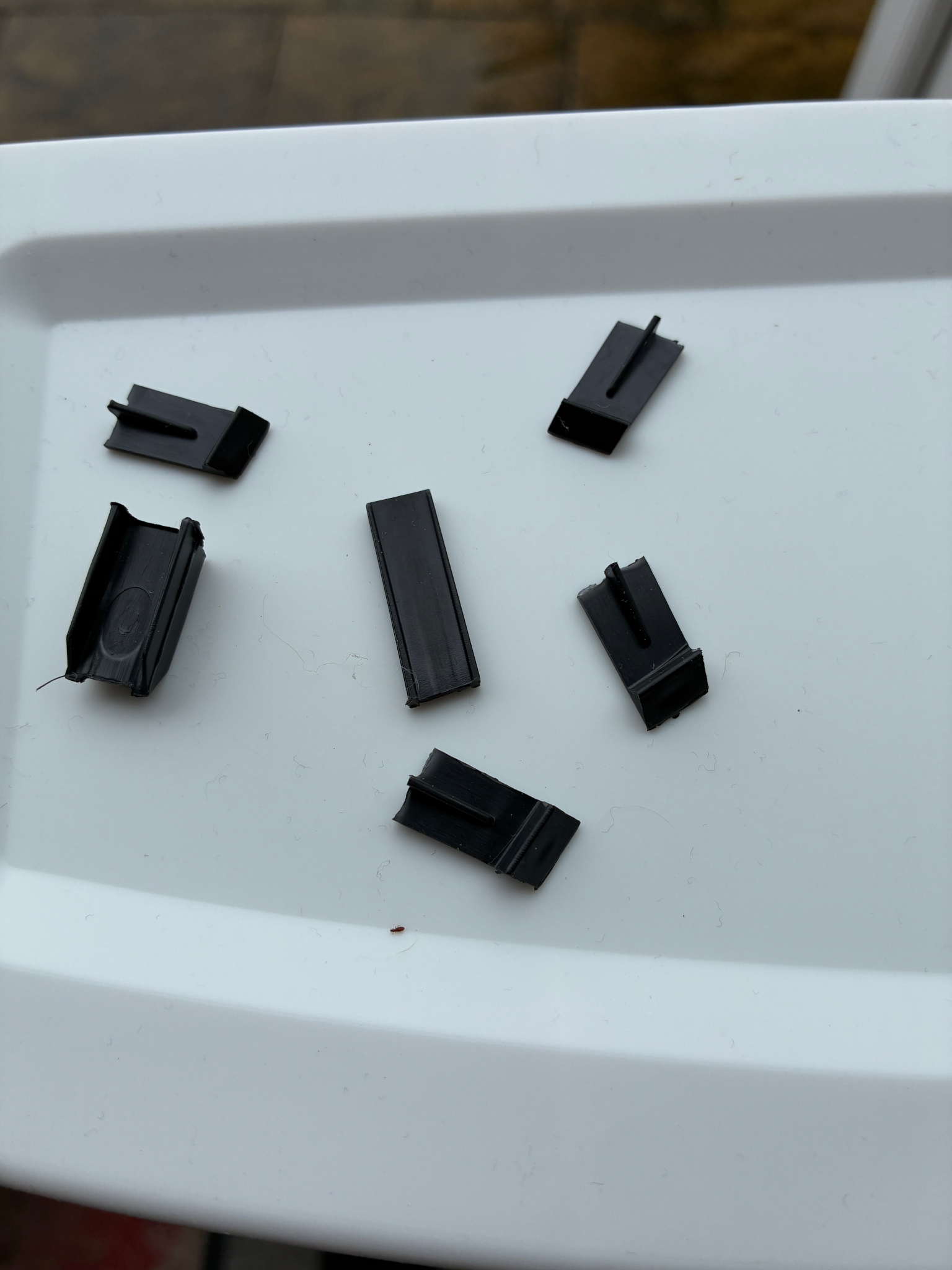

I had the cambelt and break disks on my car changed and when I got it back I found various pieces of broken plastic in the car. They're like plastic clips that have been snapped off.
Long shot, but does anyone recognise them, or think they're off the vehicle? Just wondering if it's damage, but I've looked over the car and can't see anything, so hopefully just some random plastic they left inside. I did mention it to the garage but they didn't know...

Was it the rear brakes that were being worked on, if so, the garage might have needed to remove part of the interior trim to reach the handbrake cable adjuster if someone previously had adjusted the cable to try to resolve a handbrake issue.

Yeah I had front and rear changed. Come to think of it I did find some of this broken plastic in the back of the car, but I've never knowingly had anything done to the handbrake cable. Would I be able to notice it anywhere?

You would probably need to take the rear of the centre console apart to see if any of the clips have been broken off - but really, why bother, if they are from that area, the garage would only have taken it apart because they had felt the need to adjust the handbrake cable - possibly because someone had been messing with it in the past. Bottom line is, when you get a mechanic to work on your car, they will normally operate in a way that minimises damage to your car, if VW has made a mess of designing any parts that might need removing, so that they can end up breaking, then that is hardly your mechanic's fault, it would only be your mechanic's fault if you could prove that they had been clumsy - and that could take some proving.

Agreed, if it was necessary, then so be it. It was more a case of I didn't want to randomly find some preventable damage 6 months' down the line, but based on everything I can't see that being the case. Thank you!

Hi, Do you have arm rest and rear cup holder? If so I'm certain those are clips broke from the arm rest side or/and rear cup holder trim. The mechanic would have removed the arm rest / cup holder to gain access to adjust the parking brake cable.
