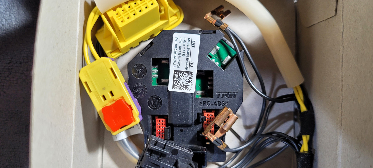

Hi, so I've got a polo 6r 2012 match. the original steering wheel had no buttons. I got a leather steering wheel as an upgrade with the buttons on the left. so just a couple of questions if anyone can help.
the new airbag fits and the yellow look connector is the same so it goes in and there's no lights on the dash, however the airbag doesn't work.
apparently non mfsw airbags are a physical analogue connection and the mfsw airbags work by a digital signal.
it is possible to get the airbag working through coding or not?
also same question with the buttons I'm not too fussed if I cant with just coding but I'm more fused about having a working horn, for obvious reasons.
any help would be great. thanks

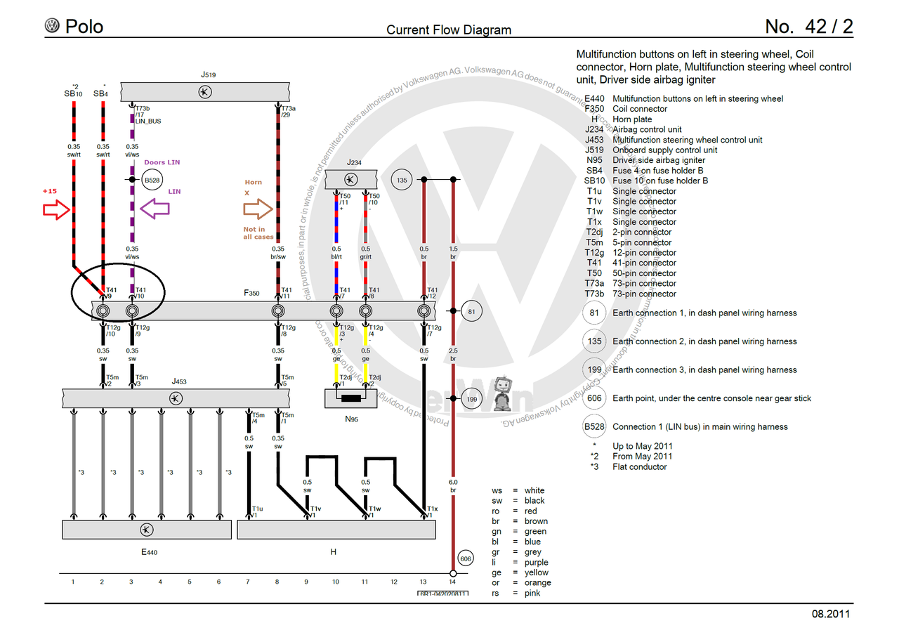

The standard steering wheel airbag wiring does not work for MFSW.
You have to install the right one for the installed steering wheel.
ETKA:
3C8971584E (standard) vs 5K0971584C /D, etc (MFSW)
On the other hand:
For the buttons to work, you need to add two wires: one positive with a +15 signal, and one LIN wire for communication.
There's a tutorial here on the forum.
'Sometimes' (not in all cases) the BCM needs to be coded for both the horn and the MFSW.

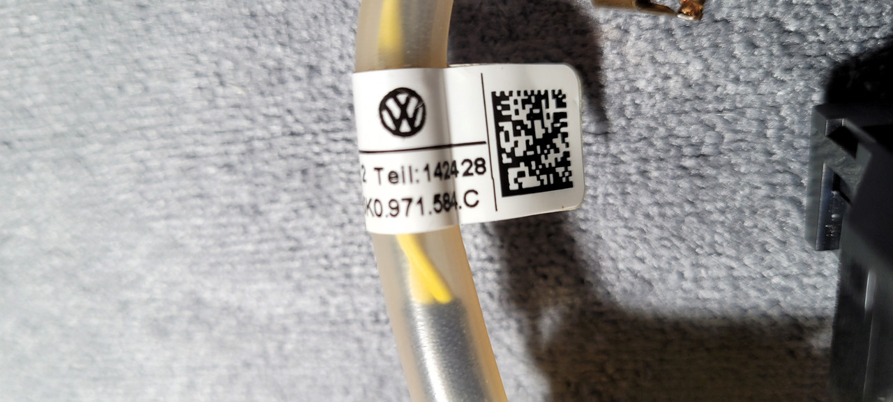

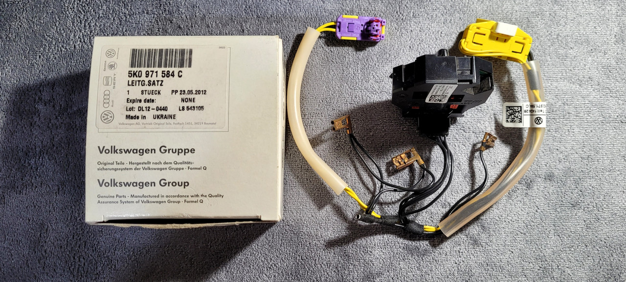

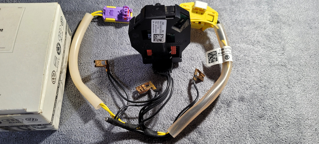

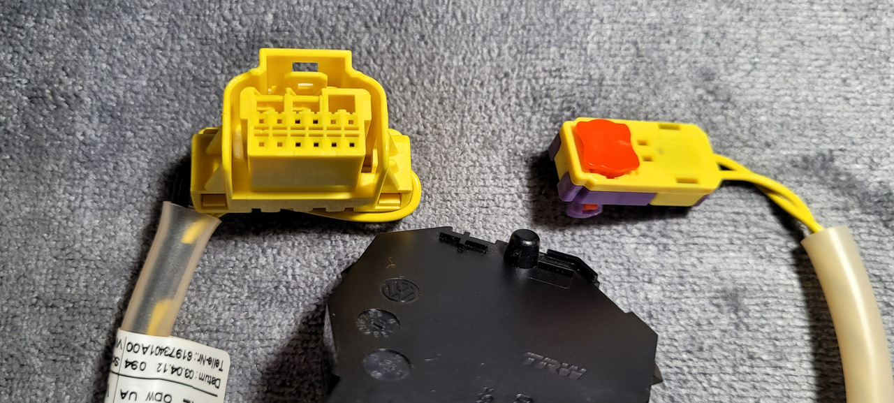

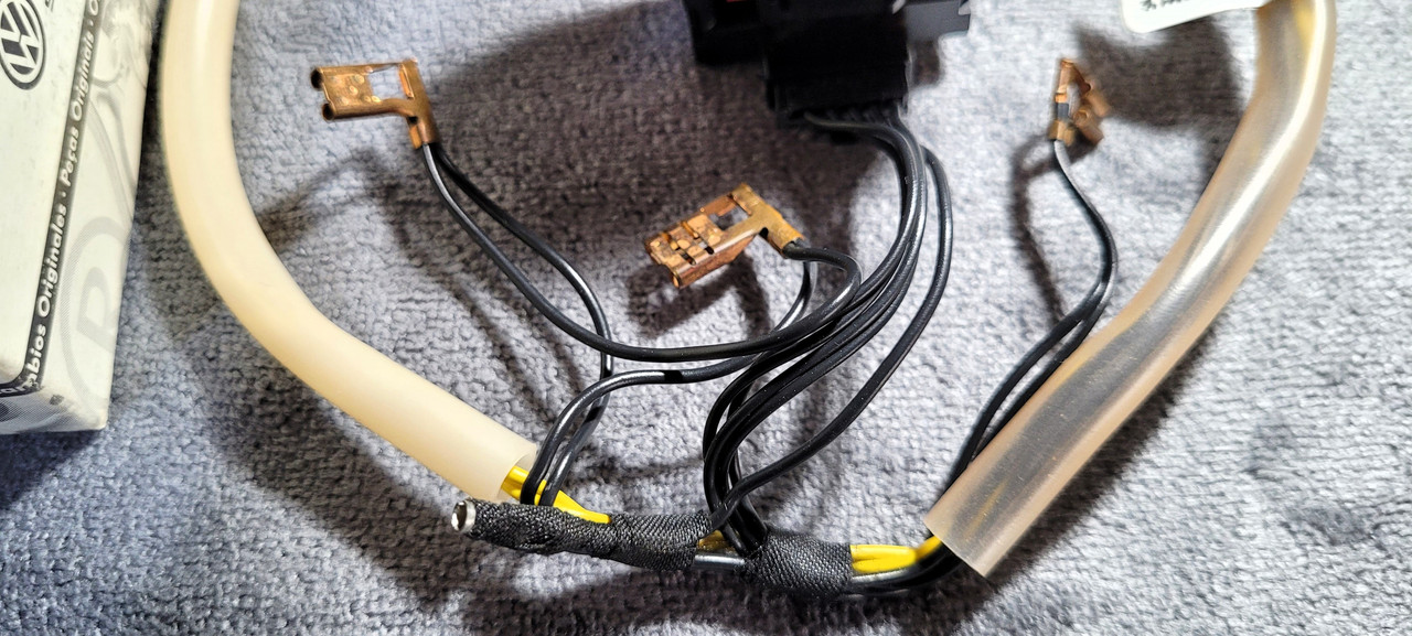

thanks for the reply and help dude, however I know that the standard airbag doesn't work for mfsw so the one I have in is the mfsw airbags (it came with the wheel when I bought it) that wiring looks too complicated for me to do for the buttons so I'll deal with that later. but my main issue is that the horn doesn't work
I have that wiring pictured it came on the airbag, everything is plugged in and the large yellow connector is same type/size it's just the horn not working
yet again thanks tho
do you reckon the new airbag for the mfsw just needs some coding with my car to get the airbag to work
