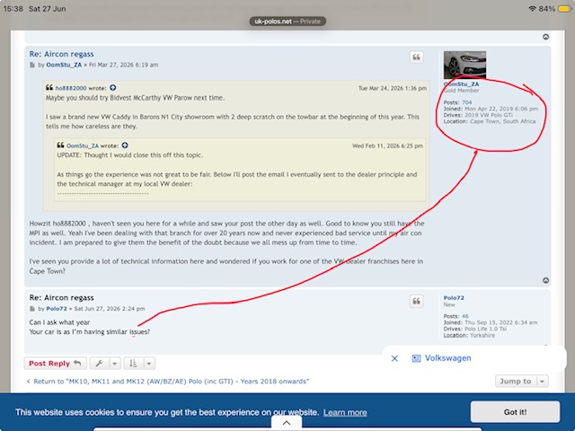

Can I ask what year
Your car is as I’m having similar issues?
Posts: 3847
Re: Aircon regass
Polo72 wrote: Sat Jun 27, 2026 2:24 pm Can I ask what year
See picture below;
My Polo GTI+ was a 2020 car and the air con was never that great; at best, I’d describe it as just about adequate in warm-ish weather. It would have struggled to cope with the heatwave conditions we’ve been having this week.
