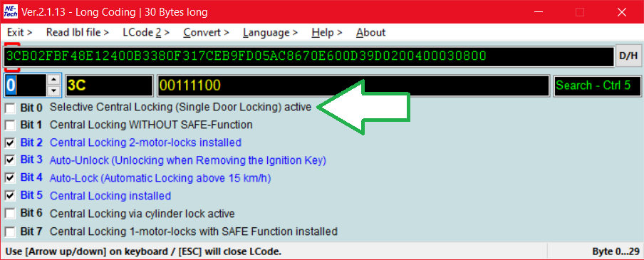

Vehicle is a 6R.ciclo wrote: Tue Jun 30, 2026 4:24 am Hi,
Perhaps the problem lies in the BCM coding.
Do you have any diagnostic tools?
If it's a 6R (not a 6C), perhaps that POLO had Byte0 Bit0 activated/enabled in the BCM.
In that case, you just need to deactivate/disable it.
Example with VCDS:

If your OBD2 diagnostic tool is very basic, you probably won't have access to unit coding -BCM, 09 Central Electric-, you'll likely only have access to diagnostics like checking DTCs.
You need something like VCDS, OBD11, VCP, 'etc' -multibrand tools-. Many enthusiasts and workshops have these tools. Even the place where you bought the Polo might offer this check for free... ?
From the comments provided, it definitely seems to be a coding issue! Check that Byte0 Bit0 in the BCM.
The good thing is to know that it is not a problem with the locks, because everything works as designed.
On the other hand, if your 6R does not have a factory anti-theft alarm, it is likely that it does not have the SAFE function -double click on the remote buttons-.
