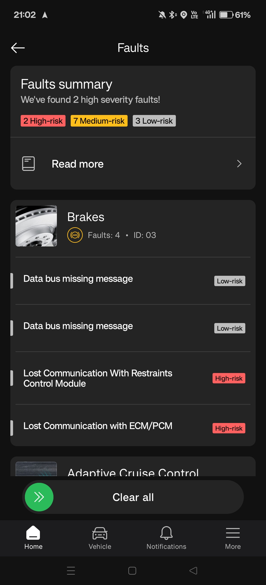

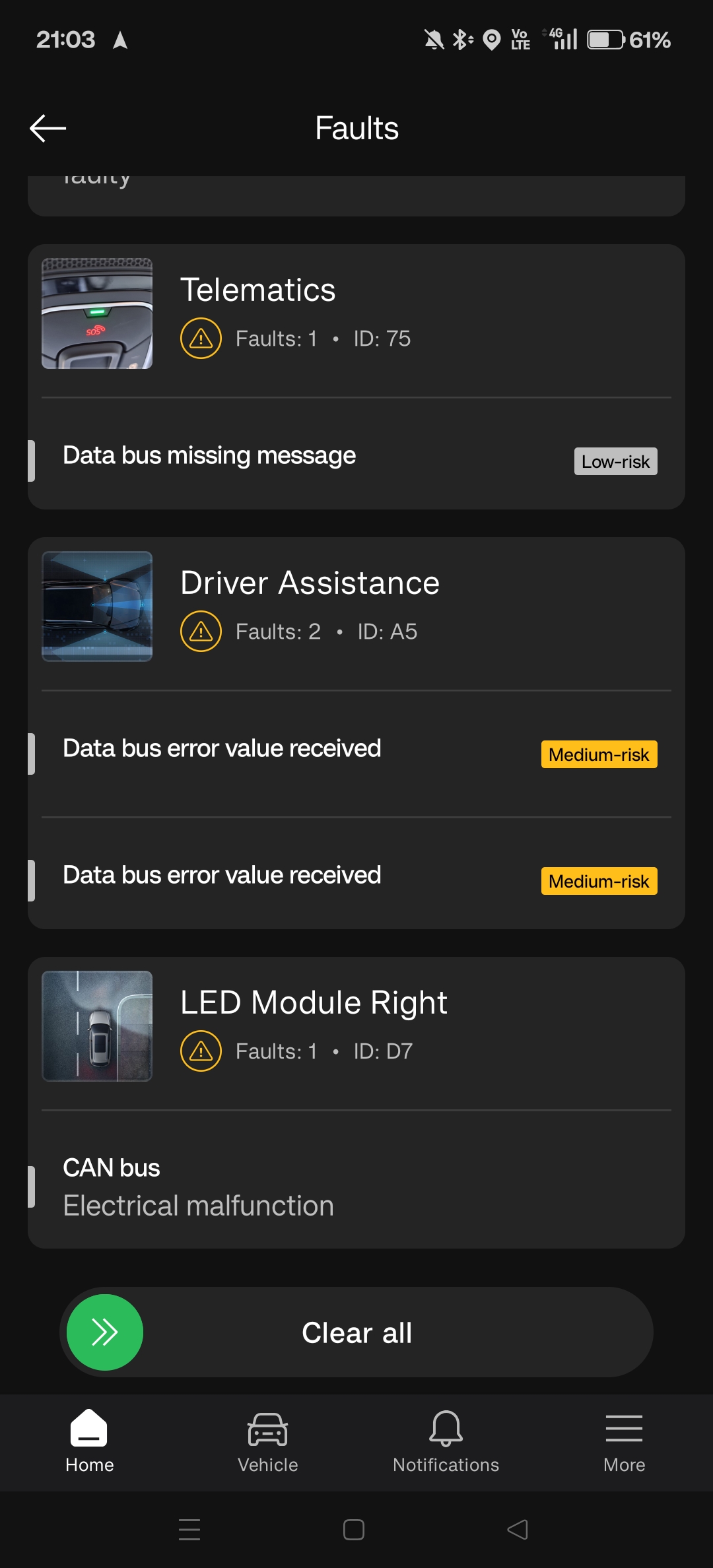

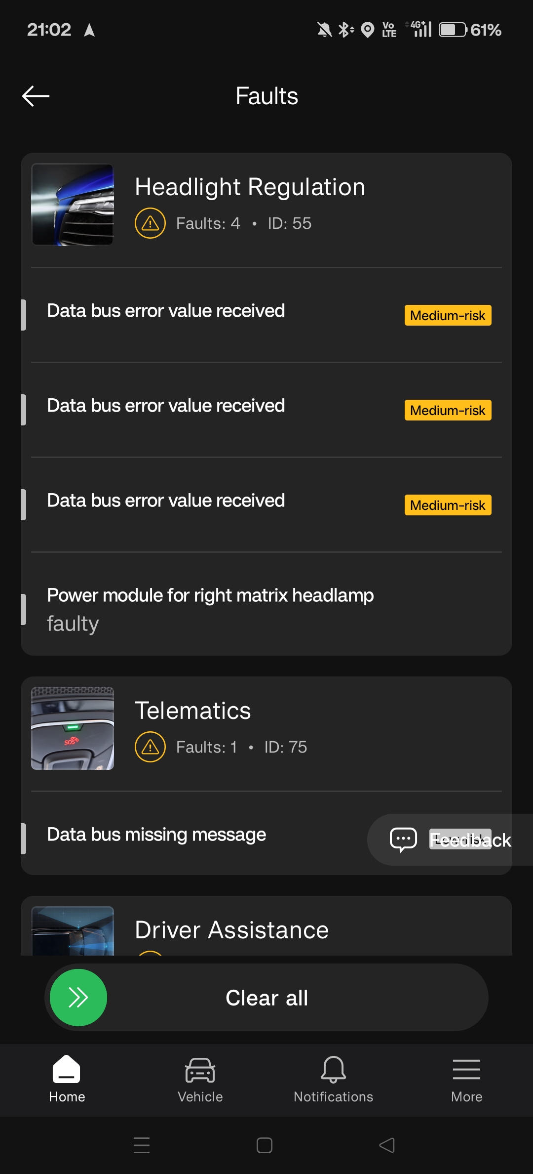

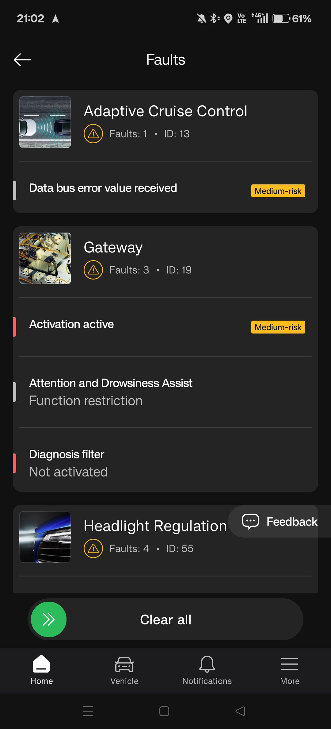

Hello all,
(I'm going to apologise for the size of these images, I'm not well versed with forum uploads lol)

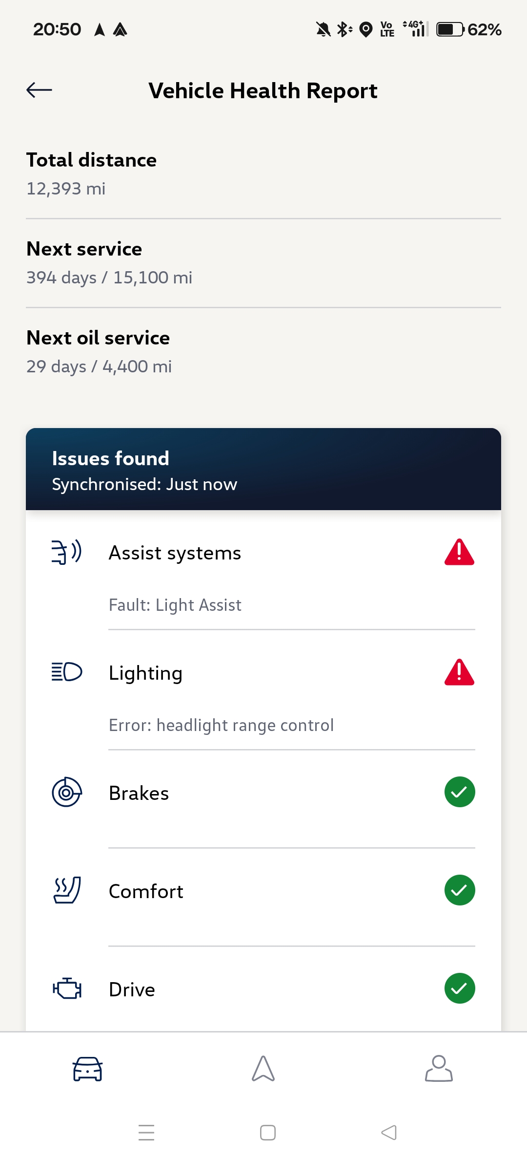

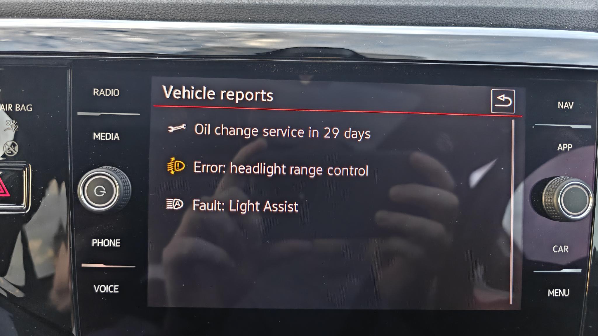

So I have a Polo GTI 25 Edition which seems to like giving me gyp with an error every so often, "Fault: Light Assist" and "Error: Headlight range control". This also knocks out the ACC - So when on a long drive, it's rather annoying.
I've had this in at the dealers twice now, Once was about a year ago, they looked at the infotainment screen. Shrugged. Said no fault and left.
In the last week had it in and provided app screen shots and ODB11 screens of about 16 faults, they managed to find a short with the offside front LED power module. Replaced. yay.. fixed?
Nope. Still happening. Wondering if anyone has any ideas, as the dealer seems to like shrugging this off.
Images attached are those from tonights drive..
Anyone have any ideas? or able to point me in the right direction?
