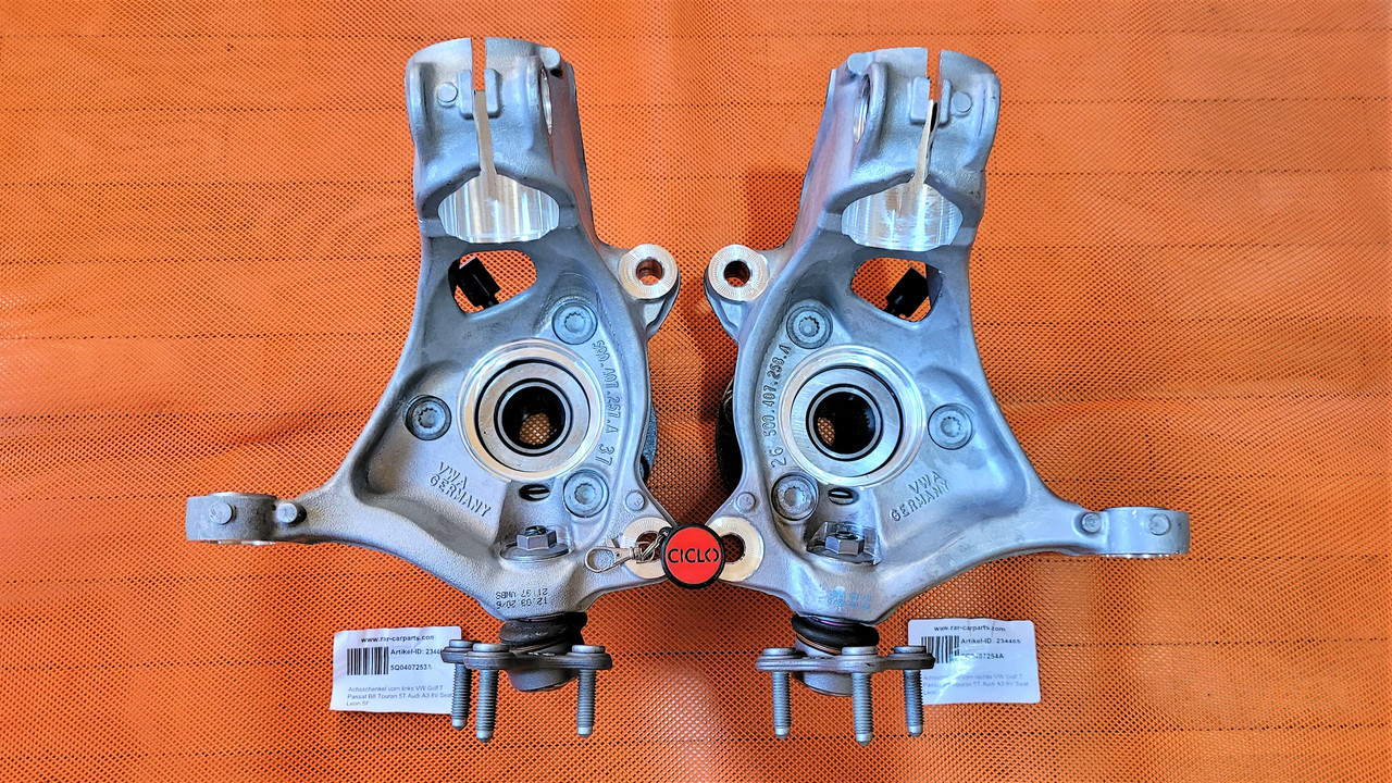

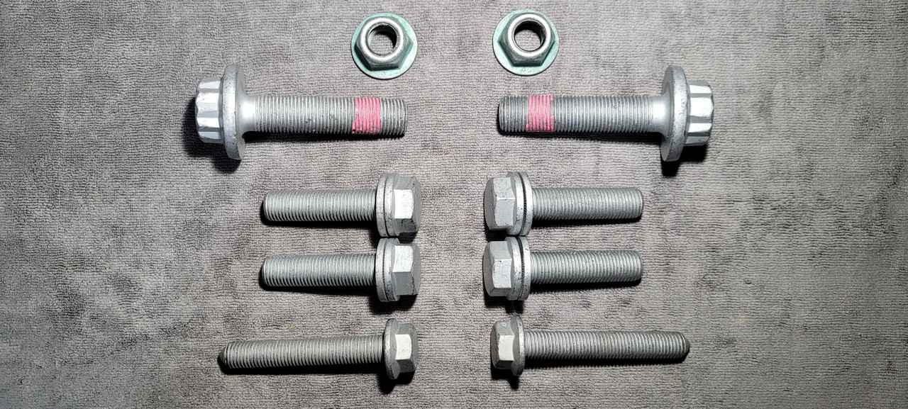

3- Torque update for bolt WHT005437A according to erWin:
e2018
Related: :arrow: viewtopic.php?p=603218#p603218
IMHO, it's best to apply full torque with the car jacked up (to protect the wheel bearing).
e2023
I don't know if this is due to the bolt's Property Class/Grade or the lateral preload applied to the wheel bearing.
Which engineer is responsible for this new torque on this bolt that also applies to the Golf 8? :mrgreen:
Remember not to use an impact wrench, or the bearing will be damaged, and in a few thousand kilometers/milles you'll have to replace it...

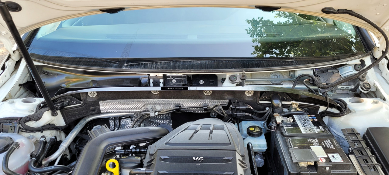

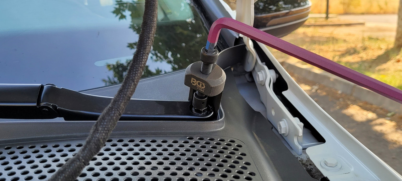

I've already removed the plenum chamber covers in the engine bay for 'easy access' to the upper shock absorber bolts (3 min), so replacing the suspension springs is now a must...
Note the 'free' wiper repositioning marks. V6 sound
Step by step...💦😄
