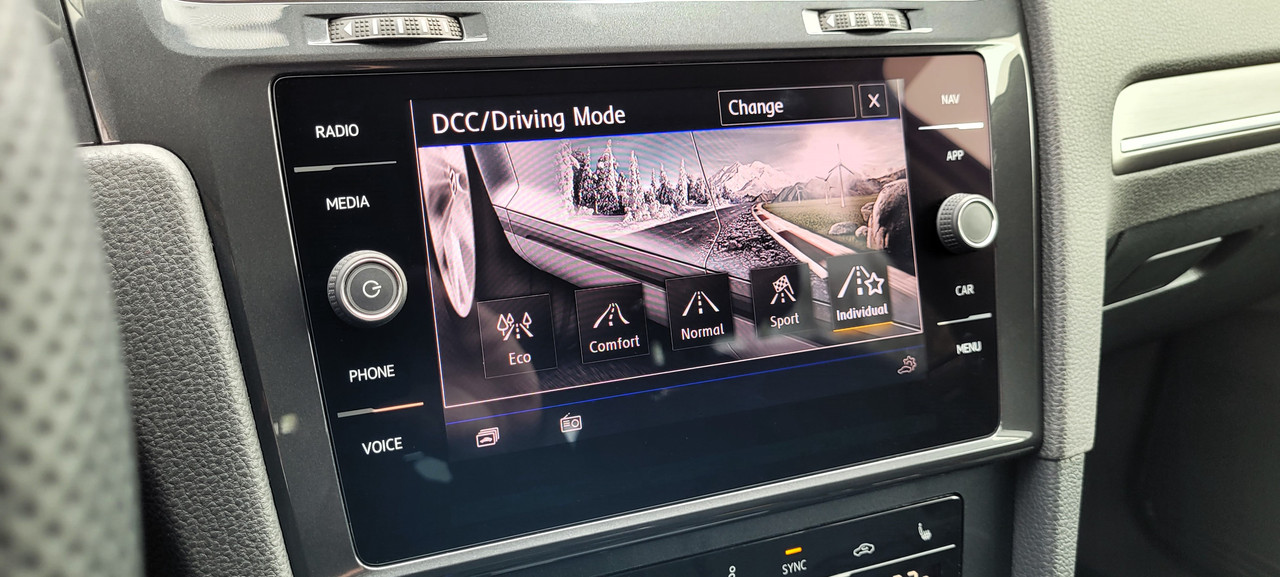

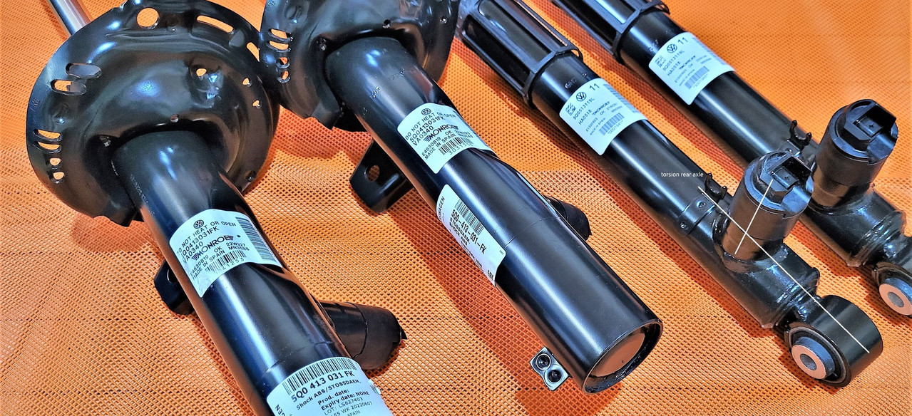

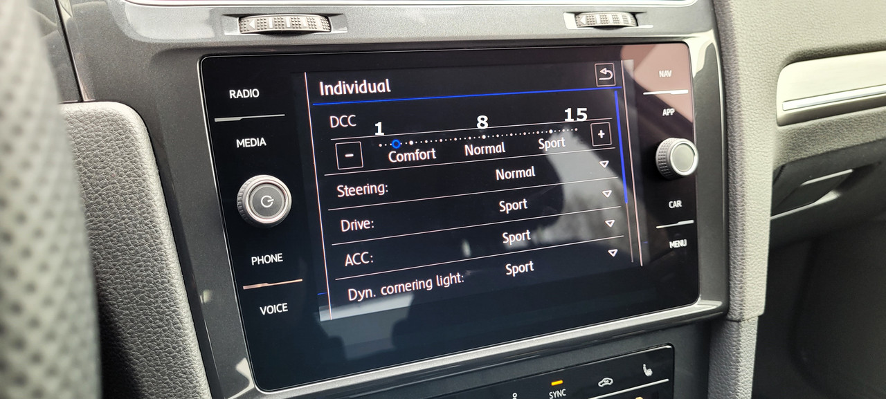

They are excellent dataset for making 'my' Golf feel like it's on a magic carpet at all adjustment levels (1-15 on the slider - Individual MODE-).
Since then, enough time has passed to accurately understand and test all these suspension settings on all types of roads.
But, in Slider position 1, for 'extra' maximum comfort, and when driving over a very specific speed bump, and only on this particular bump with a very high hump, the rear suspension bottoms out. This doesn't happen in Slider position 2 or higher. It's a very, very specific issue.
Since I have to drive over this speed bump every day, I'm going to correct this small 'deviation'.

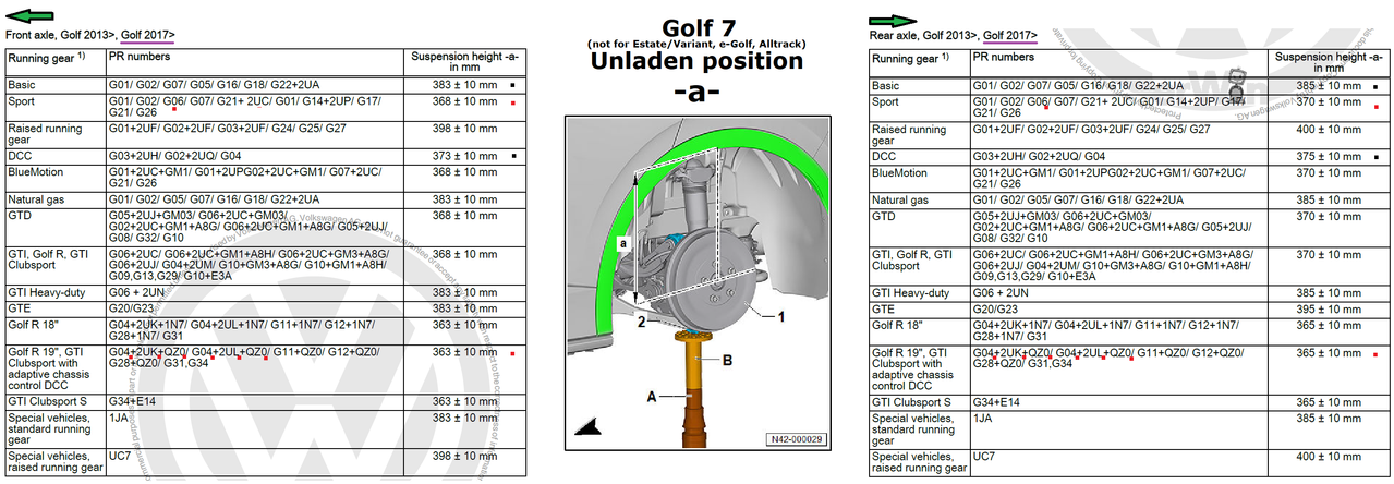

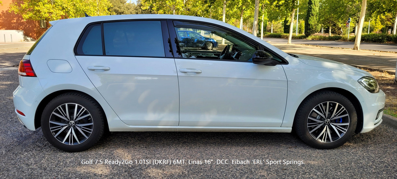

To prevent the rear suspension from bottoming out in Slider position 1 when going over this bump, I am going to opt for a mechanical solution: 'Original' Sport springs to lower the ride height by 15mm (not GTI, not R). This will allow me to maintain the same comfort across all 15 levels but within the range expected by this dataset V03935317XE... I might even get a slight improvement at the maximum sport setting.
Note:
In no case is my intention to reduce the height of the body, only to try to correct this slight 'deviation'. The small 15mm suspension lowering is just an addition to ensure that everything is in 'harmonic frequency'.

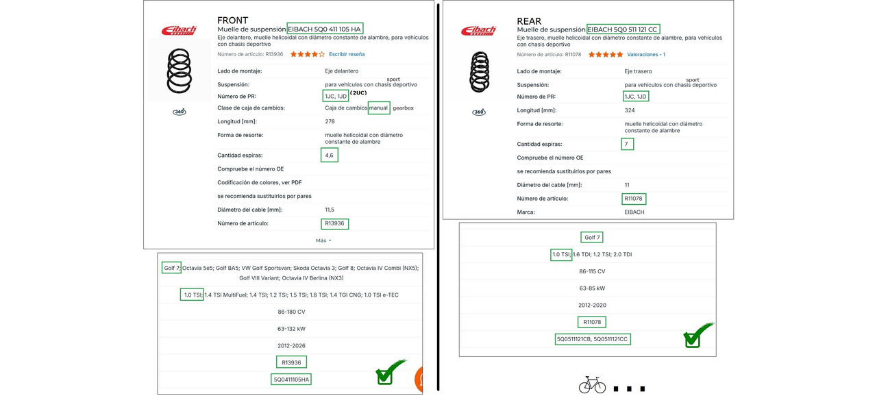

After collating a lot of data regarding the factory configuration of my Golf 1.0 TSI, manual gearbox, to choose the appropriate original sport springs (-15mm), I come to the following conclusion:
-Front springs.
From factory 5Q0411105GH (PR codes: G05 2UA) to 5Q0411105HA (PR codes: G06 2UC).
-Rear springs.
From factory 5Q0511121AC (Pr codes: 1JA 0YC) to 5Q0511121CC (Pr code: 1JC or 1JD + 0YC).

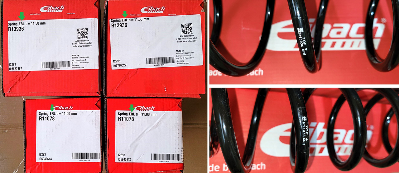

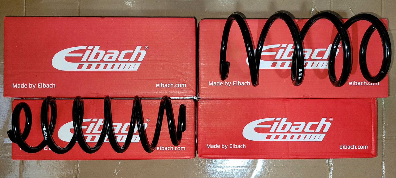

Eibach is perhaps the world's best manufacturer of springs, so the cross-references Eibach ERL for these original springs are:
Front: 5Q0411105HA ... R13936
Rear: 5Q0511121CC ... R11078

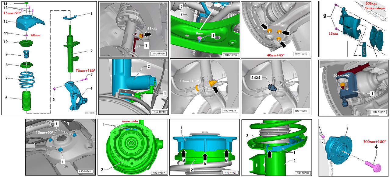

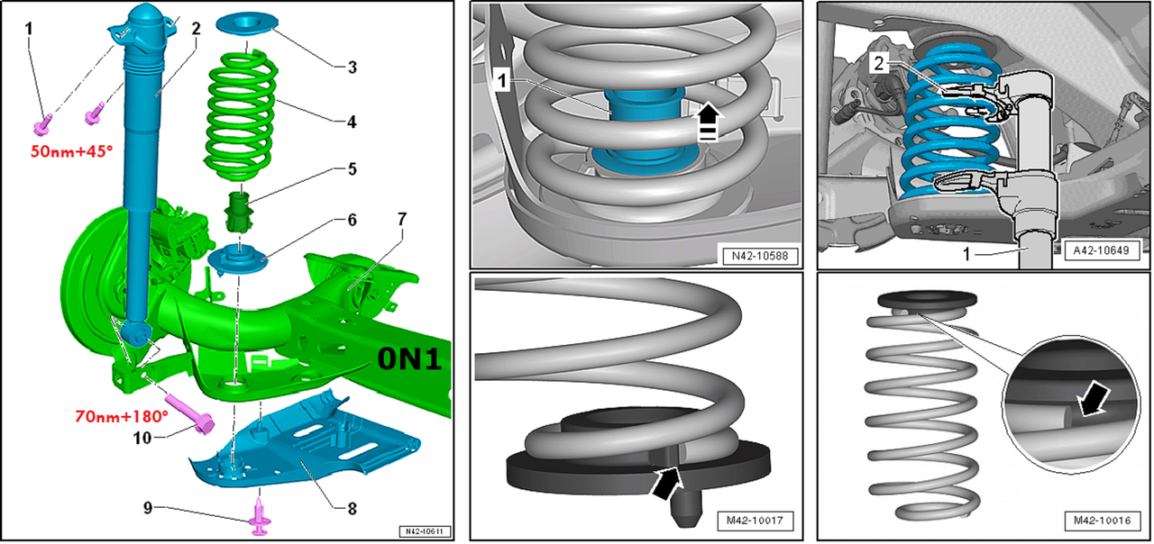

I will install these new springs according to erWin, just as I did when installing the DCC suspension, plus the basic settings of the units involved with ODIS S.
Looking at the new bolts I'm going to replace, you can probably guess how to do an efficient installation of springs. The remaining six small new nuts and bolts are in the garage, I had them left over from when I installed the DCC shocks.
