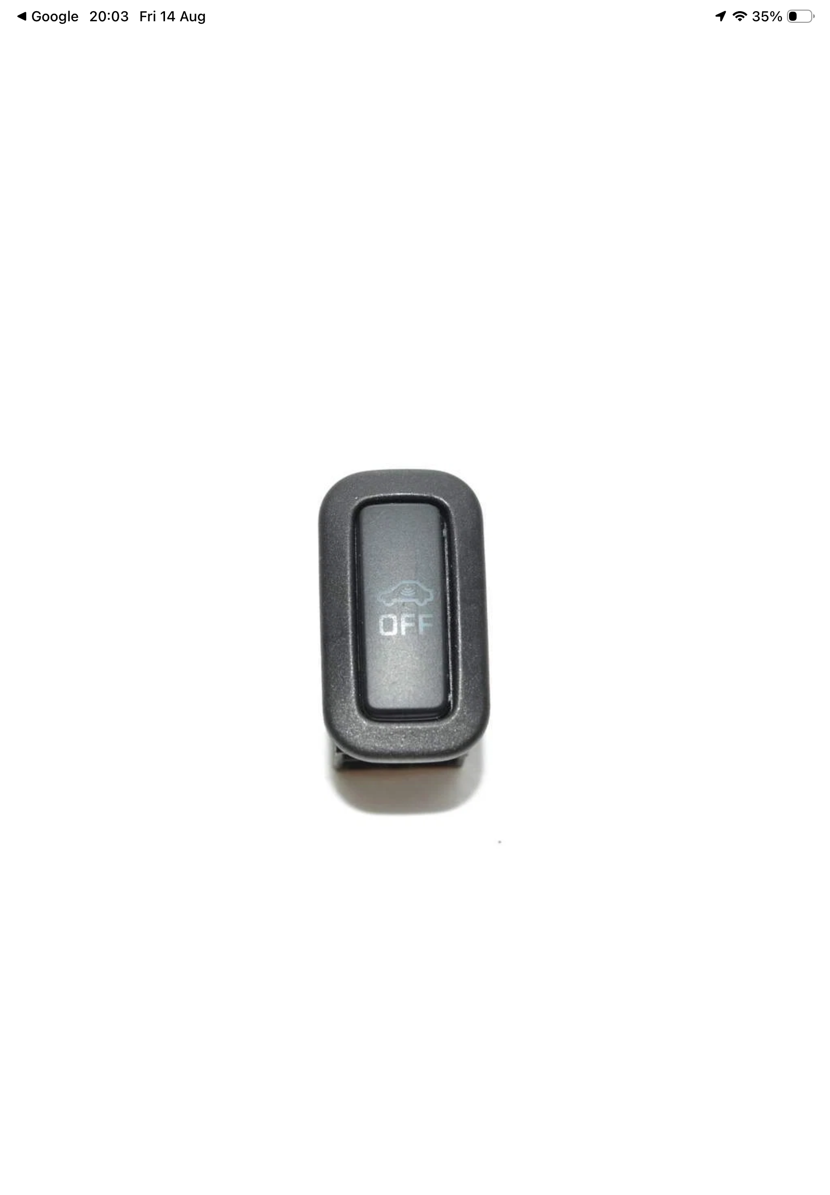

Can you disable the interior sensor with the switch when you initially lock the car ? This would eliminate that sensor as a cause and aid diagnosis further.
