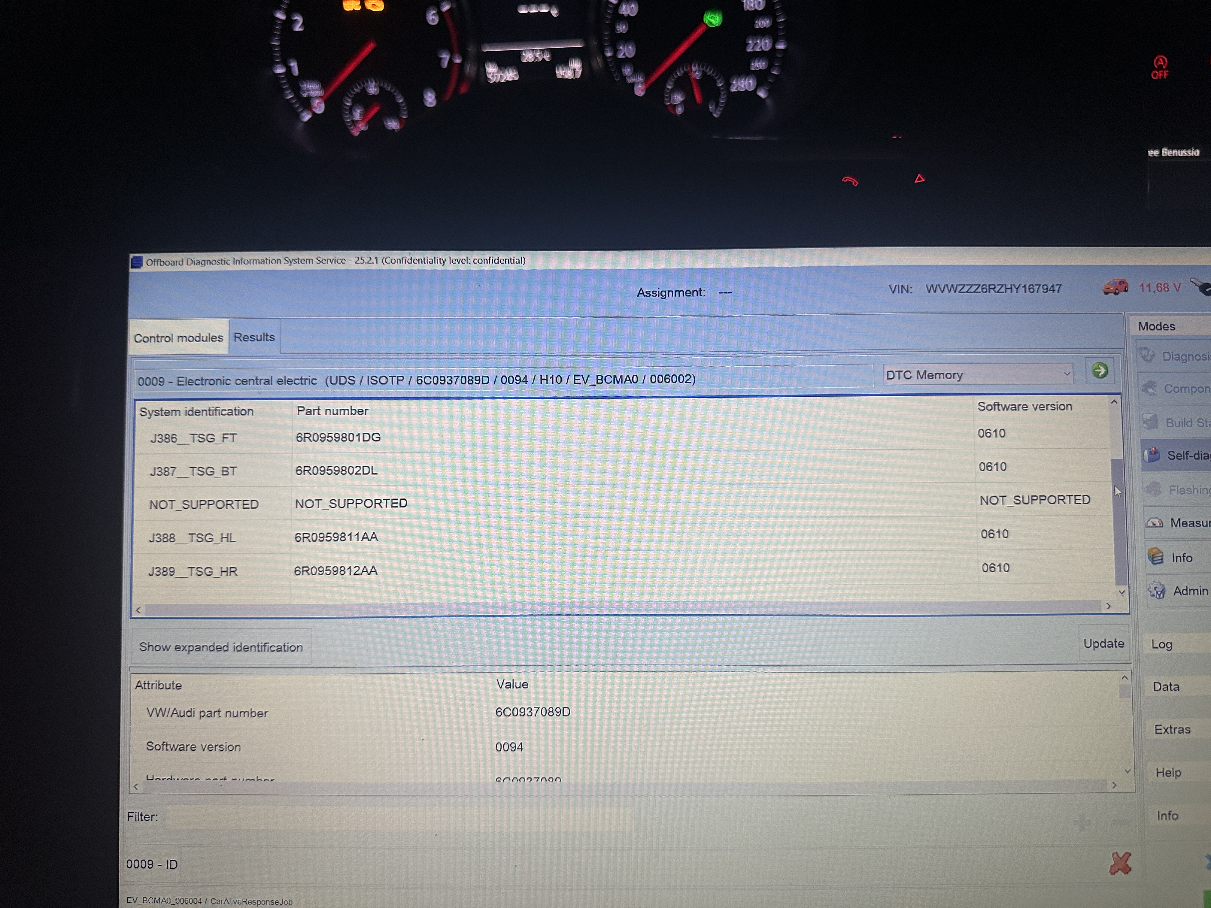

Hi team, could anyone tell me if these WRMs (attached) currently in the car support folding mirrors? I tried checking ETKA and searching online, but I can't find any clear info.

Looking at the software, 'usually':
0XXX = NO
1XXX = YES (via the switch).
8XXX = YES (via the switch and the remote).
But there are pitfalls, the WRM needs to have the right pins. Some WRMs have the correct software for managing the folding function, but the pins for the folding function are missing!
As is to be expected, the WRMs underwent some evolution, but that doesn't mean they were better or had more features.
What to look for? SW and pins.
