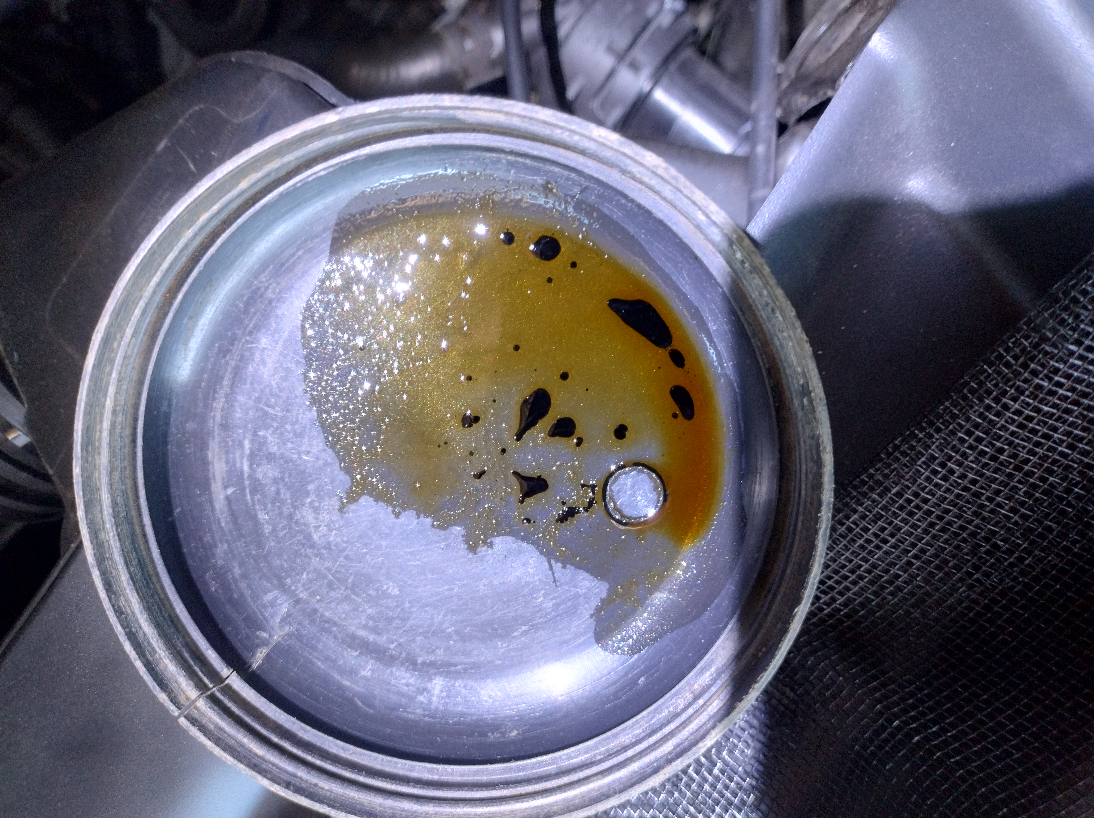

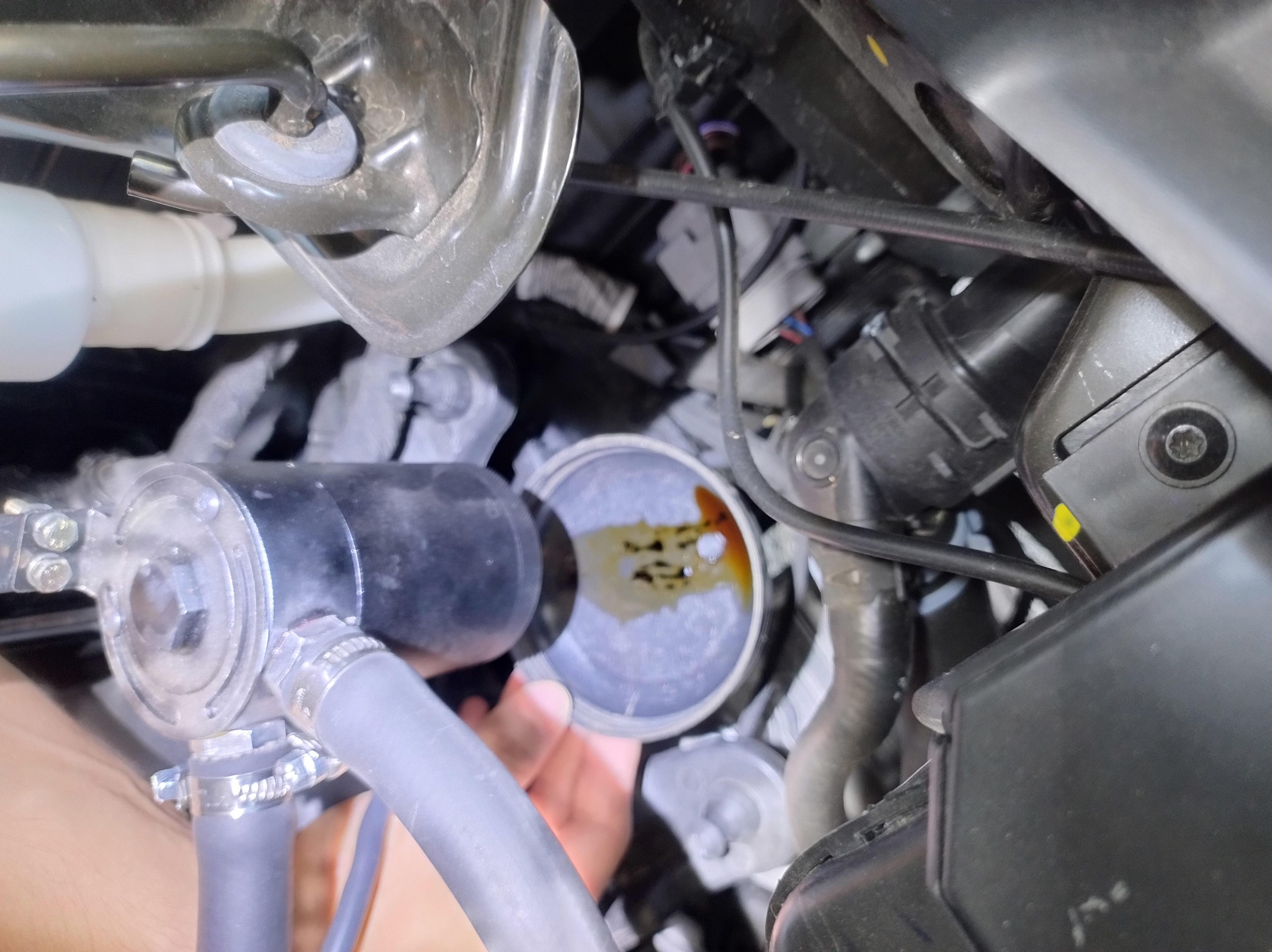

That's quite a bit of oil. How large is the catch tank?

Hi, I think there was a translation issue; actually, there isn't much oil collecting there. I can't find a thermal sleeve locally—only on AliExpress, but it's expensive. Also, the standard hose I used is braided (I don't think it shows in the photo, but it is). I'll attach a photo so you can see what the catch can has collected. Insulating the piping is a great idea; it's definitely on my to-do list.

Still a fair amount collected. That's good. It's working.

In that photo, it still has the original factory oil; if that’s the case, Volkswagen really did a shoddy job. I’ve always wondered about the fluids cars leave the factory with—or how old they actually are inside the engine by the time you get them.
Your comment confirms my suspicions.
Actually, that photo is about nine months old; you can see the state of the oil after 1,800 miles. I didn't want to share anything until I had a collection of photos showing the project's progress, but it’s currently running on Castrol oil (meeting the 508.88 spec), which is considered a good choice around here. Hopefully, I’ll be able to share the results from that oil after the upcoming service.
I agree with you—unforeseen issues always pop up. Sometimes I wonder if BMW owners have to deal with so many nuances just to get things sorted, but then I remember that, unfortunately, we’re Volkswagen owners.
In that photo, you can see some strange black traces; I just hope it’s not material flaking off something. Let's hope this project turns out well. I look forward to sharing results on how it runs later on, and I hope to hear updates on yours, too. The idea of ​​the insulation is really nagging at me, but you have great ideas—analyzing everything like that definitely has its merits.
