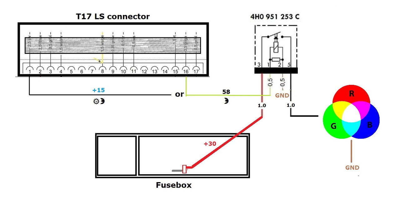

For any interior light you wish to add that should only be ON 'at night' (i.e., when position/side/parking lights are active), you must use a relay triggered by the 58 or 58d signal, powered by a +30 supply.
Never use the 58 or 58d signal (which is dedicated to lighting switches) as the power supply source, only as a relay activation signal. Whether due to a lack of knowledge or other, more mundane reasons, it is common to use the "58" signal as a power source for this type of electrical installation... and that is when strange things start happening with the instrument cluster, the radio, the climate control panel, etc.

Can you recommend a relay for the interior lights I plan to install later?
While we're at it, is there a diagram showing where to get the 58d signal, the positive, and the negative to connect the relay and lights?

A good relay for an ambient lighting or additional interior lighting setup (LED strips, etc.) is the VW646. You can physically mount it in the relay carrier-BCM bracket. In addition to supplying power to the new installation, it isolates the original installation of interior lights from the new installation.
