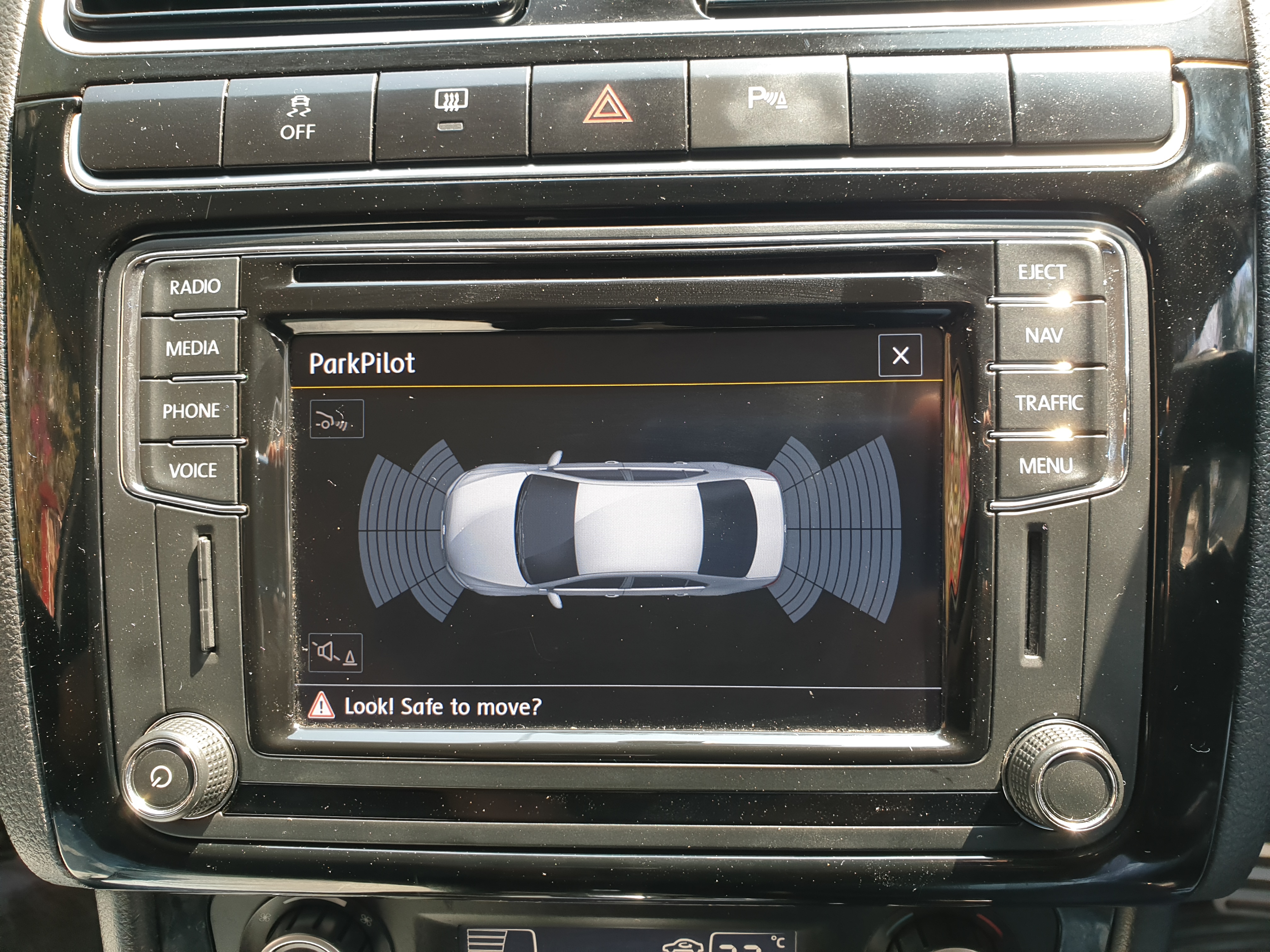

Hey guys,
I am trying to install 12K sensors on Polo 6R? I was planning on using this from Ali
https://www.aliexpress.com/item/Auto-In ... 65175.html
My end goal is to have Park Assist. But I would like to know if anyone tried installing the 3AA 919 475 (12K PDC Module) and had issues.
Any comments or thoughts?

@rdasadiardasadia wrote: Thu Apr 27, 2017 6:45 pmYa I know these parts of PLA2.0 , i have retro fitted my Superb & Yeti and PLA 2.0 works just fine.ciclo wrote:I'm afraid not.![]()
Look here, on a Golf VII. This way you already know what is necessary.
Btw, your wiring looms is already made. I will inform you by email.(I still have to do the installation guide)
But I was wondering if any one has tried with the CAN lines of 7E0 BCM in 6R. I m sure it will work in 6C cause of seperate CAN.
Did you by any chance look into the supported modules to enable PLA 2.0 on a 6R?
Did you possibly connect your Superb/Yeti's PLA module CAN to a 6R?
Could you explain further about requiring separate CAN?

As Ciclo rightly said polo 6R cannot support 12K PLA 2.0. The module requires separate CAN. You can maximum install the eight sensor configuration. Some pictures attached

The 7E0 937 090 max BCM for polo 6R has an in built low & high CAN communication. The polo 6C & majority of other VWs, Skodas, Audis has a separate CAN module which can support much higher number of functions like PLA 2.0pranaynewton wrote: Sat Feb 23, 2019 5:24 am@rdasadiardasadia wrote: Thu Apr 27, 2017 6:45 pmYa I know these parts of PLA2.0 , i have retro fitted my Superb & Yeti and PLA 2.0 works just fine.ciclo wrote:I'm afraid not.![]()

It's also very unlikely that the Abs and power steering of the 6r would support pla2.0

Absolutely, 6R does't have steering module to support this and PLA rear ABS sensors are different having higher refresh rate for detection of wheel movementsiichel wrote: Sun Feb 24, 2019 7:06 am It's also very unlikely that the Abs and power steering of the 6r would support pla2.0

Thanks for the input. Does this mean even 12K sensors without PLA will not work?
Anyone tried changing power steering motor, ABS sensors to implement PLA on their Polo?

No it cannot work!!
To my knowledge I haven't come across such modification probably cause its too expensive with no surety it will work
No it cannot work!!

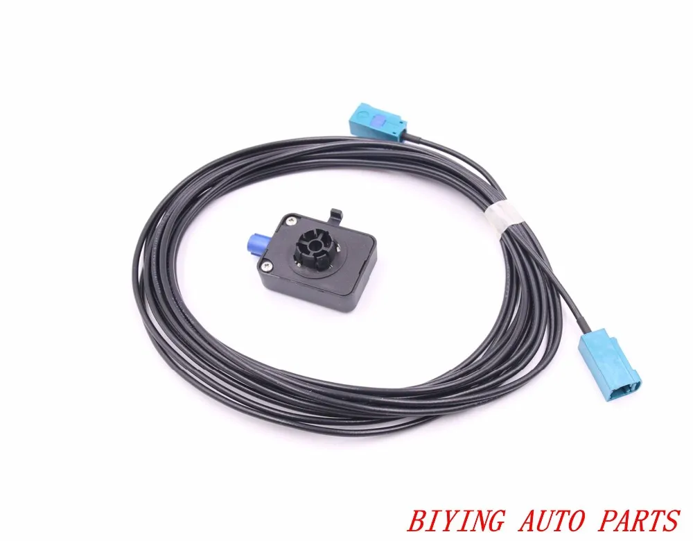

1) Check Below Picture of GPS Antenna for MIB 2. Any idea where can it be press fit in polo 6R?
