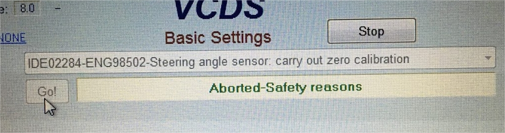

Perhaps some expert here can help me. Done a mistake (cluster swap - different VIN) and ABS recoded itself to zeros :shock:
Well, I was just testing so I have my original IC and everything is fine, except G85 which I can not calibrate :|
Actual coding of ABS module is EXACTLY the same as factory, cause I have several backups I can confirm it.
ESP and "steering wheel" indicators are on while ignition on, and also a "ESC malfunction" error pops up in IC.
This is the autoscan:

Tried so many procedures here that I am lost :(
What´s more concerning to me is the following:
Please consider that VCDS isn´t "recommending" in a popup any security code, so I am using the wide spread 40168 one, which is actually accepted
This is done in ABS 03 module - Security access - then Basic Settings
If I do not enter the code, this basic setting shows "ERROR: Security access required".
Tried while driving and still and the same.
Can some one help?

are you holding the steering wheel straight?

iichel wrote: Tue Apr 17, 2018 8:57 pm are you holding the steering wheel straight?
For sure. also drove for more or less 100 meters and then done the same no success (at 15km/h aprox, no higher than 20). Tried 30 deg left, then right, then center and the same
Also removed the battery for a while with steer straight, then connect again, tried the same with full left and full right.

Did you check if your steering angle sensor can see the rotation of your steering wheel (in Meas. Blocks)?
Even if you didn't set the zero in Basic Settings, a properly working sensor should read something and show it to you.

Jay-Jay wrote:Did you check if your angle steering wheel sensor can see the rotation of your steering wheel (in Meas. Blocks)?
It does
The sensor can't possibly be faulty. These errors are present since automatic abs recoding. I have never seen any fault in esp / abs module
Enviado desde mi iPhone utilizando Tapatalk

It's strange the sensor has become faulty after the ABS Unit lost its coding.
Can you try with another VCDS version (18.1.0 or older than yours)?

Jay-Jay wrote:It's strange the sensor has become faulty after the ABS Unit lost its coding.
May be I can
Mine is 17.8
I will give it a try later.
I am sure the sensor ain't physically faulty, it's just impossible cause I haven't made any physical thing. I just need to bypass this test aborted due to safety reasons
Tried 17.1 and the same exact problem. Aborted safety reasons..
Also tried again several times calibration procedure of performing short test drives and no luck.
Any leads??

Re: Polo 6R ABS CODING
Post by firegrafik »
My friend had same fault. His issue was because he changed steering wheel and slip-ring accidentally had been rotated half turn from zero position.
EdgardoRodriguez
Posts: 56
Joined: Tue Feb 27, 2018 5:31 pm
Drives: other
Location: Argentina
Post by EdgardoRodriguez »
firegrafik wrote:My friend had same fault. His issue was because he changed steering wheel and slip-ring accidentally had been rotated half turn from zero position.
Hi !
I swear that I haven't even disassembled the steering wheel.
But when the unit recoded itself wheels where pointing straight ahead. So now measures while in the same position throws some thing like -720
Perhaps I need to turn all the way left and trigger another self zeroing to the sensor begin reading something nearer to 0?
Then run adaptation again ?
I totally confirmed by g85 sensor Is integrated in esp sensor. Do you known any security access code to test ? Tried several without success.
