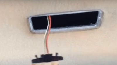

ciclo wrote: Tue Aug 29, 2017 5:45 am Image
Hi Fernando. Sorry to bump this old post, but is there any chance you can tell me the part number for the reinforcement frame for the vanity light (shown in the above picture) ? I looked on ETKA, but I couldn't find it. :(
