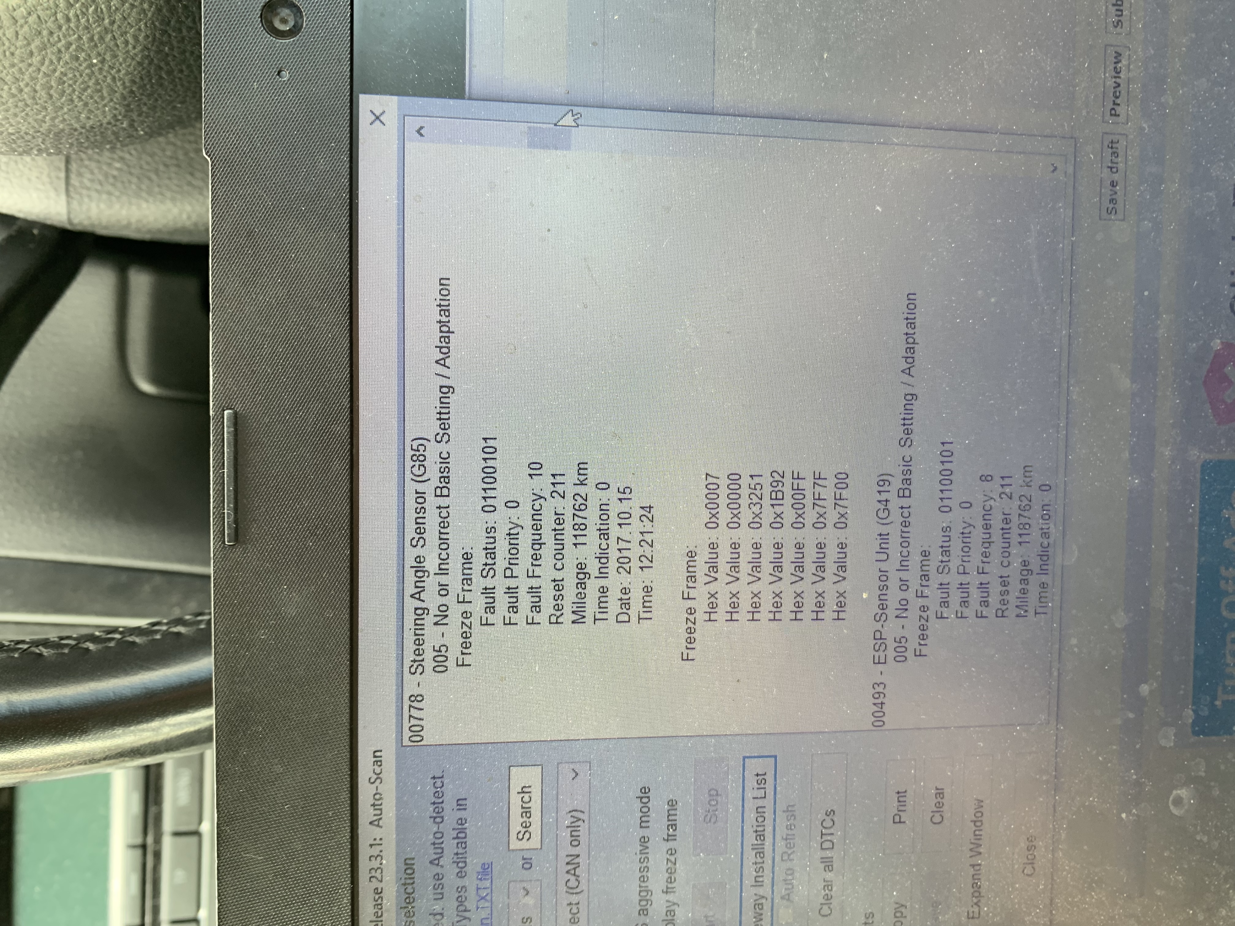

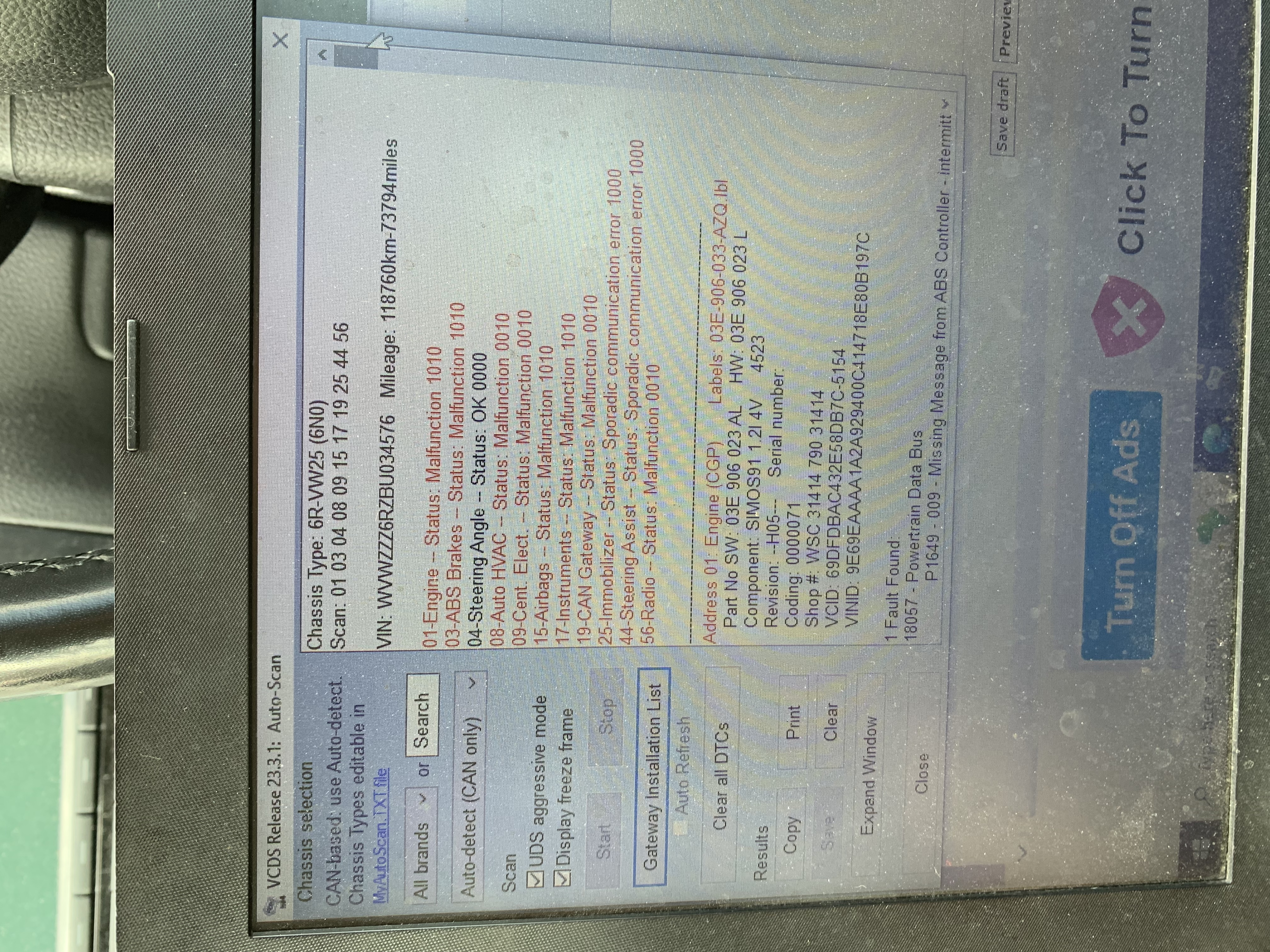

Hi I’m wondering if you can assist me. I have a vw polo 2011 that has lost its coding for the ABS. I tried to send the whole scan report but my laptop isn’t allowing me to so I hope these screenshots will do. It has front brake disc size 256mm and rear drums of 200mm. It’s an an ESP 8.2 module. Wondering if you could be any help to me please.
Thank you in advance
- 2AC7F554-96F6-43A4-98B6-6D1B13DB7DB3.jpeg (5.04 MiB) Viewed 3129 times
- 87920E49-89DA-4FC0-B105-EB57368B595C.jpeg (6.29 MiB) Viewed 3129 times
- Posts: 6695
Re: Restoring lost abs long code with new vcds hex v2 pro
If you have genuine cable, go to Ross tech forum please and post full scan there. I'm a bit fed up with making all these codes for anyone and everyone for free and most people can't be asked to even post results. Like the guy above.
