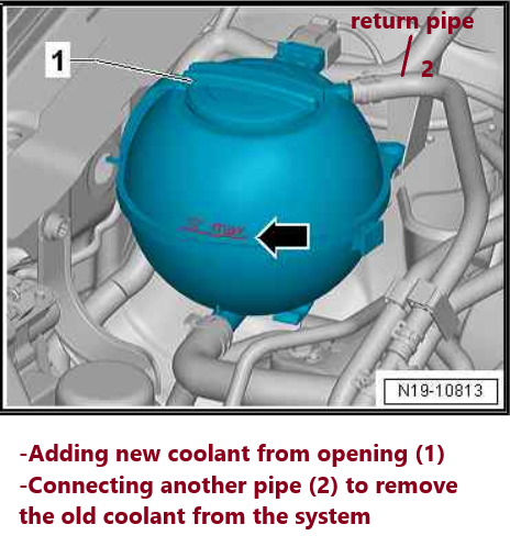

Hello,
I read about the possible "habit" of coolant G13 to clog pipes..
So i am thinking change the G13 with the newer G12 EVO coolant.
I read the treads of Ciclo and iichels
viewtopic.php?t=78017&start=90
viewtopic.php?p=598477#p598477
Both of you have changed the expansion tank also. Why did you change it ? Is it necessary ? (it is because of that silicat bag ? Mine doesn't have the sign "mit silikat" )
Is the process of changing the coolant as simple as it seems? Draining the old coolant and then adding the new? Or does it need a flush before adding the new coolant?
PS. a video showing the process
https://www.youtube.com/watch?v=ffZRYoqT9RM

I changed the expansion tank because of the silicat bag. My tank also had g13 written. Two reasons to change it.
Changing does not drain the system, there will be some g13 left. If you want to lose all (or most) g13, you have to repeat. Or flush with distilled water and add g12 evo concentrate.

I renewed the coolant because it is something that should be done every 'X' amount of time, normally it is indicated every 2 years, but it largely depends on many engine operating conditions. In non-extreme climates and with 'normal' driving/use, the useful life of the coolant can be greatly extended (2>4 years).
We all know old engines that are more than 15 years old in which the coolant was never changed, even more years and they work relatively normally, but this cannot be done with current engines, the calibrated passages through which the coolant circulates are very narrow, and the materials of the engines are more sensitive so as not to go into further explanations. The coolant needs to be in perfect>good working condition at all times if you want to extend the life of the engine.
According to the repair manual, the coolant replacement procedure is very similar in almost all engines (with the original VAS tool, a vacuum system), and you must also take into account whether your engine requires a bleeding procedure. ODIS S tells you if it is necessary to bleed the cooling system on your engine. It is normally applied to diesel engines and I think in larger displacement engines with a more complex cooling system.
Draining the coolant through the radiator is what the manual says, but it does not renew all the coolant in all the pipes, narrow passages, pumps, thermostats, etc... if you do not have the VAS vacuum system to achieve it.
If you renew the coolant through the return pipe that reaches the expansion tank, with the engine at operating temperature and idle, making the mechanical pump, the electric pump and the radiator fan work, you will be able to expel the 100% of the old coolant without having to drain it through the radiator pipes.
You have to keep some type of liquid in the expansion tank at all times while the old coolant is evacuated through the return pipe, either 'distilled water' to clean/flush the system or the new coolant, which will be responsible for expelling the old coolant.
'Never' use tap water, wine, beer, spirits, or other atrocities.
My Golf was not affected by the G13 and silicate bag problem, it did not have the silicate bag, which is indicated on the expansion tanks of the affected engines, but I changed the tank because it had the G13 icon drawn on the surface. Due to the bad reputation of the G13, it is better to get it out of the way to avoid confusion in case of repairs, sale of the vehicle, etc.
There are those who paint the expansion tank with a marker... in my most sincere and humble opinion, I think it is not the best for vehicles of 'very high international prestige'. All my respects and I understand everyone's conditions and needs.

Thank you for your answers and Information.
So the change of the expansion tank is recommended only for removing the silicate bag.
I don't have the VAS vacuum system so i have to do it manually.
I made this picture from Ciclo's instructions
Am I understanding this correctly?

Thank you for all the details.ciclo wrote: Sun Nov 26, 2023 8:56 am I renewed the coolant because it is something that should be done every 'X' amount of time, normally it is indicated every 2 years, but it largely depends on many engine operating conditions. In non-extreme climates and with 'normal' driving/use, the useful life of the coolant can be greatly extended (2>4 years).
My expansion tank now it is just the icon without any nomenclature, 'currently' the G12evo is the one indicated for all engines.
Procedure seems to be simple and straight forward.
Tomorrow I will go to my dealer ship to ask for 2*5L of G12Evo plus the new expansion tank.
Because your car is a 6R with the EA111, mine is a EA211, so no problem in term of compatibility.

The reason I did write G12 Evo on my bottle is because otherwise it refers to the manual and the manual doesn't refer to G12 Evo.

Seems to be obvious.iichel wrote: Sun Nov 26, 2023 5:07 pm The reason I did write G12 Evo on my bottle is because otherwise it refers to the manual and the manual doesn't refer to G12 Evo.
I will see If I can print a sticker at the size of the black mark on the expansion tank and put it on it.
