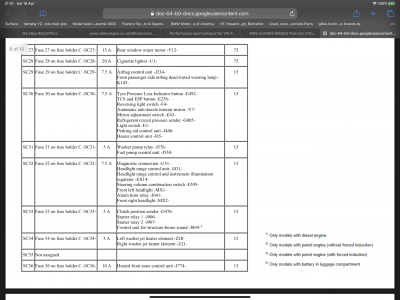

Looking for some guidance for my 6C heat seat retrofit,
The wiring shown here shows 1 control module for both seats, but the wiring has several fuses referenced thanks to ichel information, does anyone have each of this diagram with the ref for each item known in full to help. :D :D
Fuse sc26 - 5A, sc36 - 10A, sc55 - 10A?

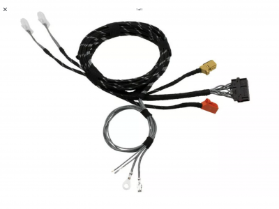

Hi iichel,
I am trying to complete my wiring in of the heated seats to the car
6R kit wiring looks like this I believe
The kit I got for a 6c looks like this, I need to change the seat plug ends to the same as the 6R as the GT seats have those plugs, but I only have the following wires available..
For up at fuse box
1 big wire with crimp for large fuse -Blue/black
1 x light wire for small fuse - red
A grey wire
A brown earth - with earth crimp
See pics
The control unit as shown with wires
And the 15 and 16 output to seats red/yellow and yellow/black which have own earths
I seem to short of bcm cable and or illumination cable and a third power cable....by wiring diagram....
Can you help as stuck till I get this sorted to finish install.
Re: POLO 6R. HEATED SEATS. OEM.
Posted: Thu Apr 30, 2020 2:17 pm
by iichel
For up at fuse box
1 big wire with crimp for large fuse -Blue/black --> This one goes to the fuse box, suggest SC36 with 25A fuse
1 x light wire for small fuse - red --> this one goes to the BCM T73a/36
A grey wire --> this one is for the illumination
A brown earth - with earth crimp --> connect all of them to an earthing point

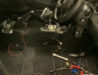

Posted: Thu Apr 30, 2020 7:11 pm
by Robbo770
Thanks to iichel made progress wires clipped into fuse box on fuse 26 which is class 75, so should go off with ignition off I think..., red wire into plug A black plug on BCM terminal 36, awkward as hell, plug c is a arse to get back into the bcm.
Got earth onto nice main framing assemble bolt as it a solid earth.
Got to change the plugs on the wiring, but will try with the seat pads I have loose to ensure I know which switch switches on which set before running them under the carpet to the seat areas.
Then got the usb hub and rear additional usbs to get all wired in, and fix the bulb gone on the cigarette socket!!
