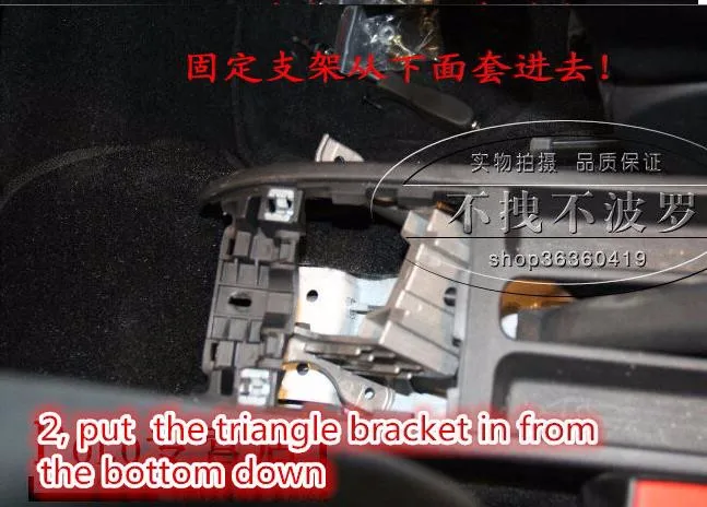

Thanks so much for the advice, but could I pick your brains a bit more please.
From this pic https://ae01.alicdn.com/kf/HTB1OrifJFXX ... 4240c593e1
the alloy mounting bracket has to be inserted under the rear edge of the console, as mine is dsg, how is the gear lever surround loosened - assuming it needs to be to give enough movement of the rear of the console.
As I only picked up the car on 20th Dec, I am loathe to risk causing any damage/scratches/marks to my brand new 'beauty'.
I am quite capable of doing most mechanical jobs and have masses of tools - and the ability to make/modify special tools. The problem with plastic 'parts' is knowing how far they will bend before breaking or cracking.
The surround for the gear stick lifts up it's just clicked in place so carefully pull it up and the plastics aren't too Brittle so have a decent amount of give however they won't bend much just be careful and listen for any unwanted noises if you hear a crack or anything then stop you don't need to bend it too far
