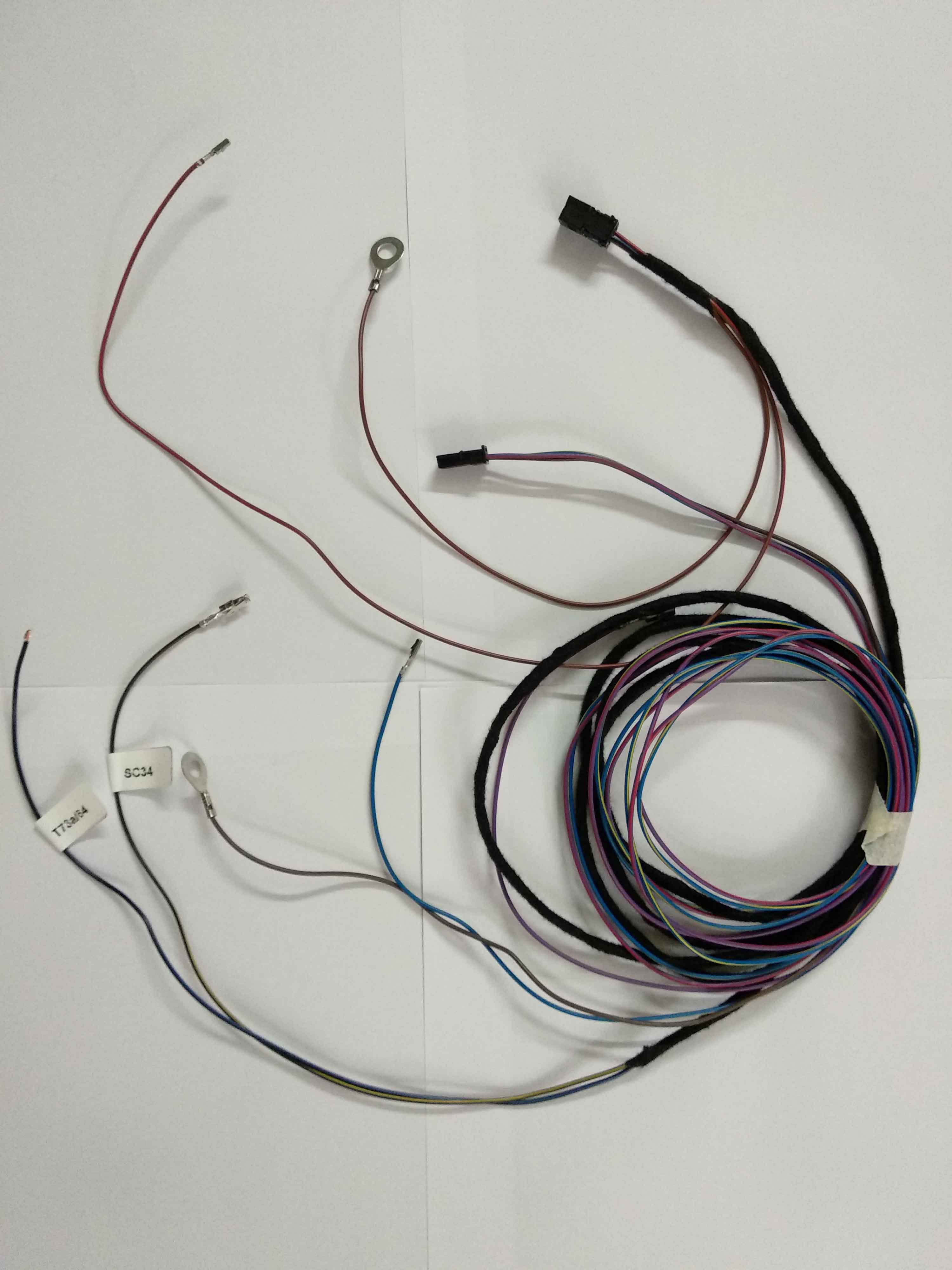

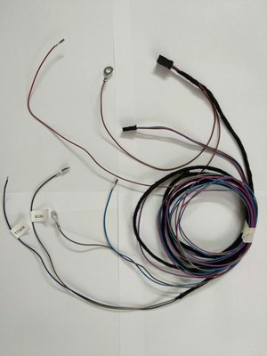

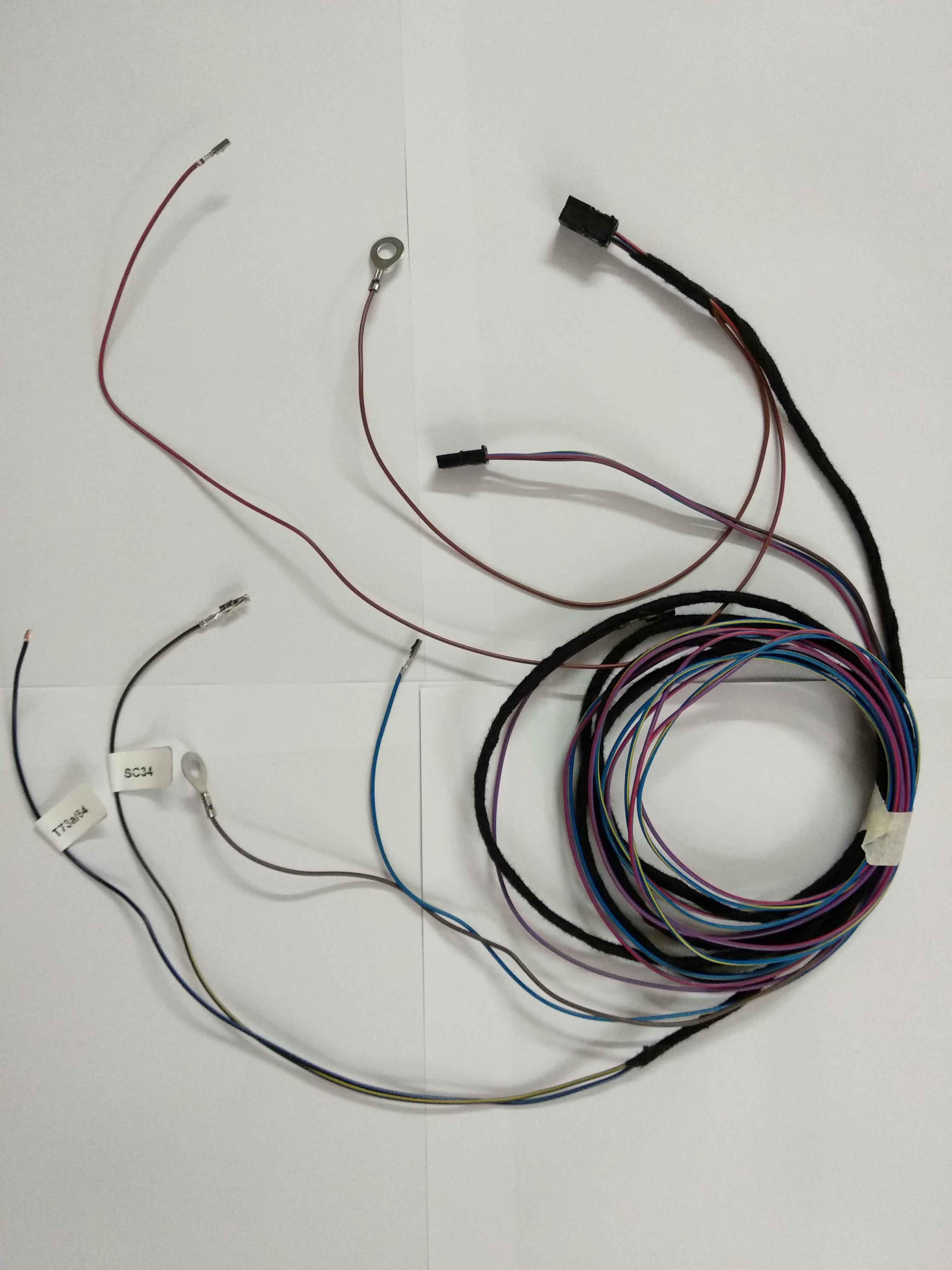

Hi, Fernando,
I have this wiring for Dimming mirror and RLS
from Ali express.
when I compared it with your Dimming mirror and RLS wire. Mine is different. So I don't want any confusion while installation.
So please I request you to make Dimming mirror and RLS wire too. Sorry for making changes in my request.
Thank you
Posts: 8994
Re: Retrofitting Bi-Xenon & BCM Max Adaption+Auto Headlight with CH/LH on 2013 6R
Ok, I'll do the wiring for RLS and auto dimming mirror (25€ paypal fees inc), along with the other wiring looms requested (BCM adaptation + auto lights) .. I have to order the RLS connector from my VW dealer (takes two days to arrive) I beg you a little patience.

Posts: 8994
50% made.

Posts: 8994
Made 90%
The RLS connector hasn't arrived yet. It is expected to arrive tomorrow.

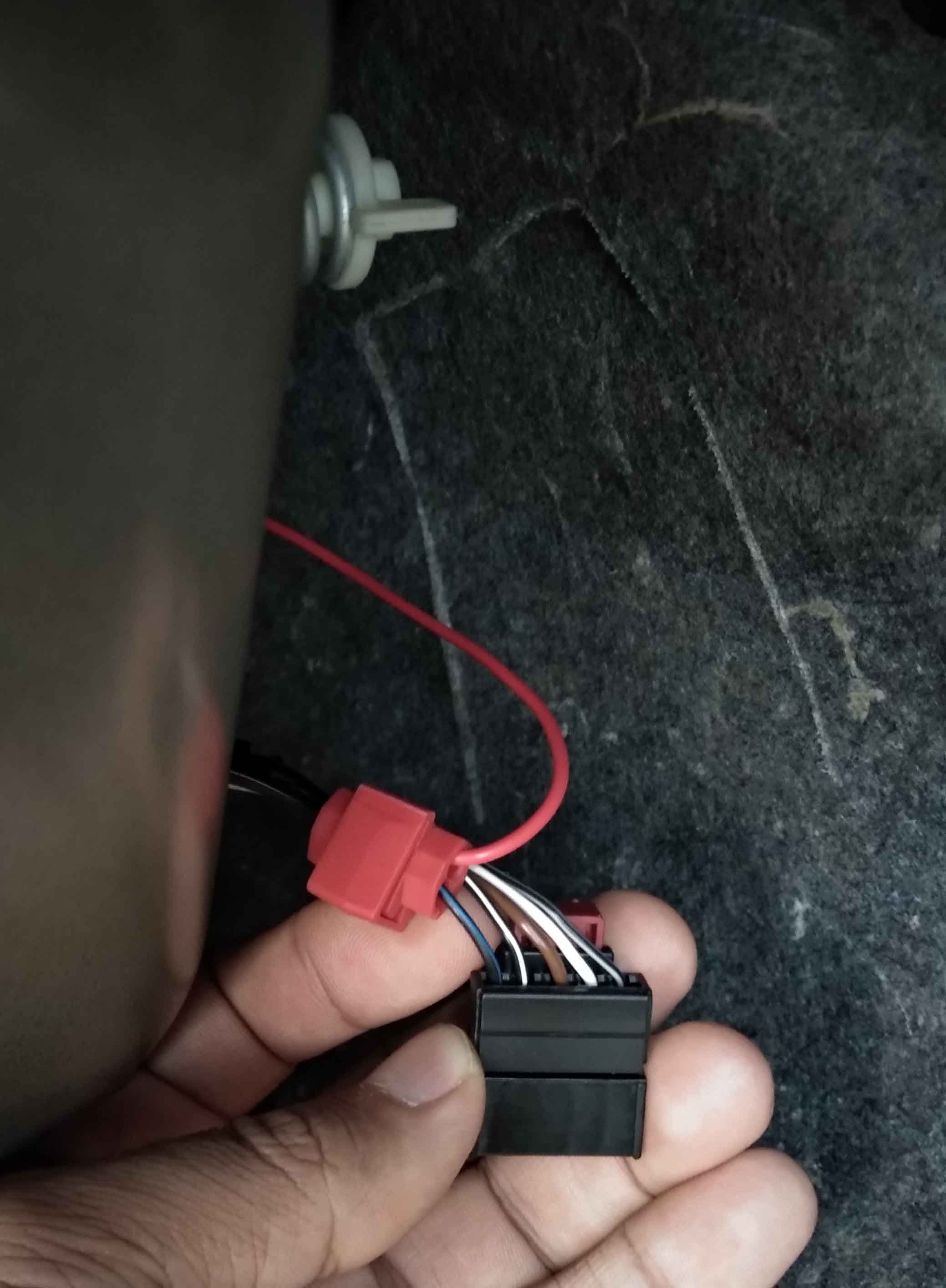

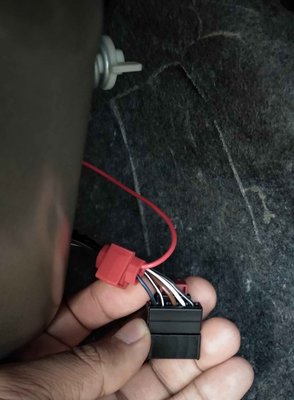

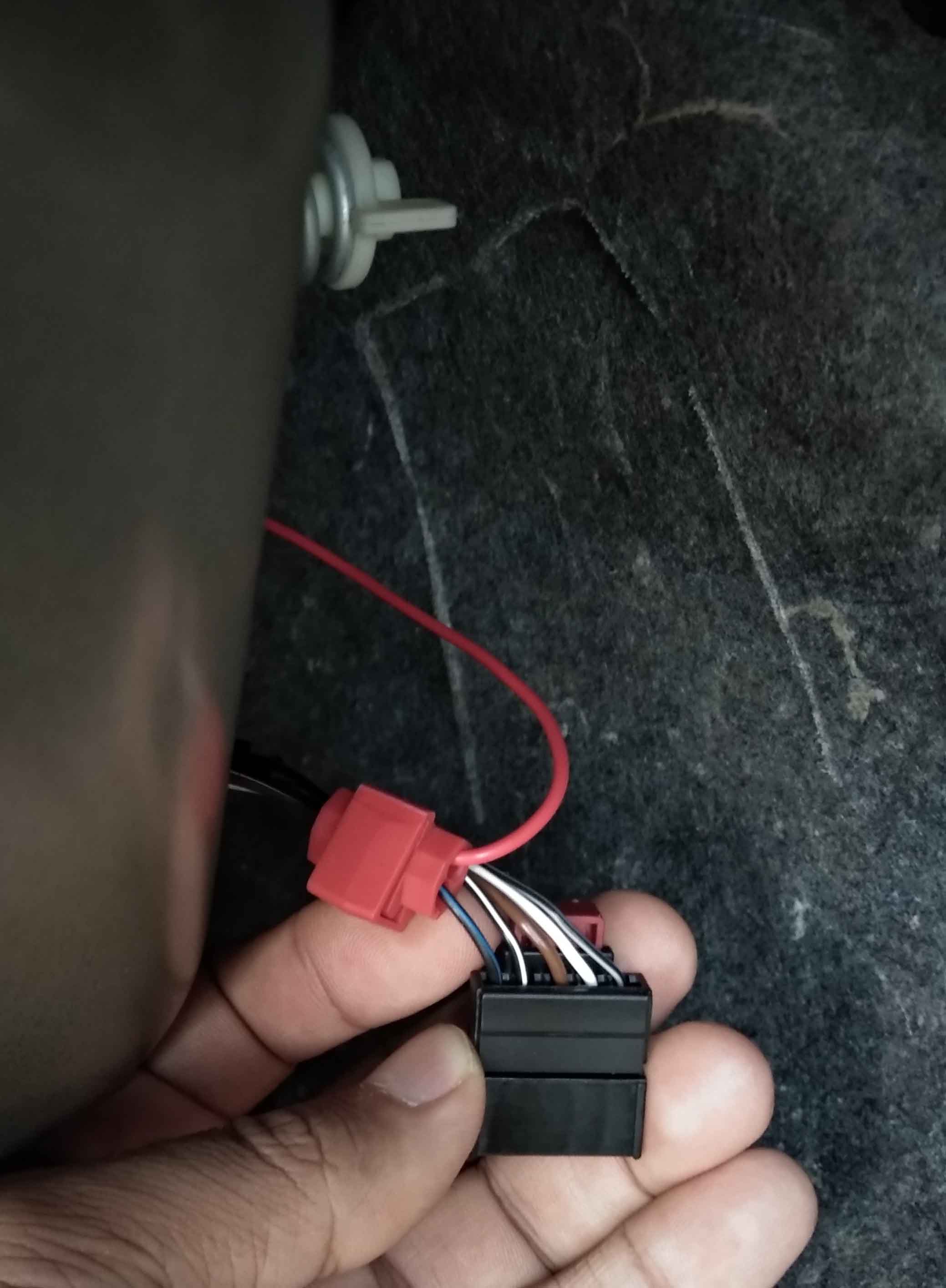

Please take a picture from the T5 Left taillight connector.
T5/1 wire should be blue/black, belongs to Reversing Light.
Because your Vento is with manual transmission the original T5/1 wire must be isolated. to be able to install a new wire from T73b/12 to T5/1.
Yes its blue/black
That red taped wire is for reverse camera.

Posts: 8994
Made 100%. (nice electrical installation)
I still have to do the installation guide, your Vento has extra wires compared to other installation guides that I did for Vento IND.
It's not necessary that you download the images, they will be included in the installation guide so you can view them correctly.
When I post the installation guide here I will send you my email by private message. :wink:
