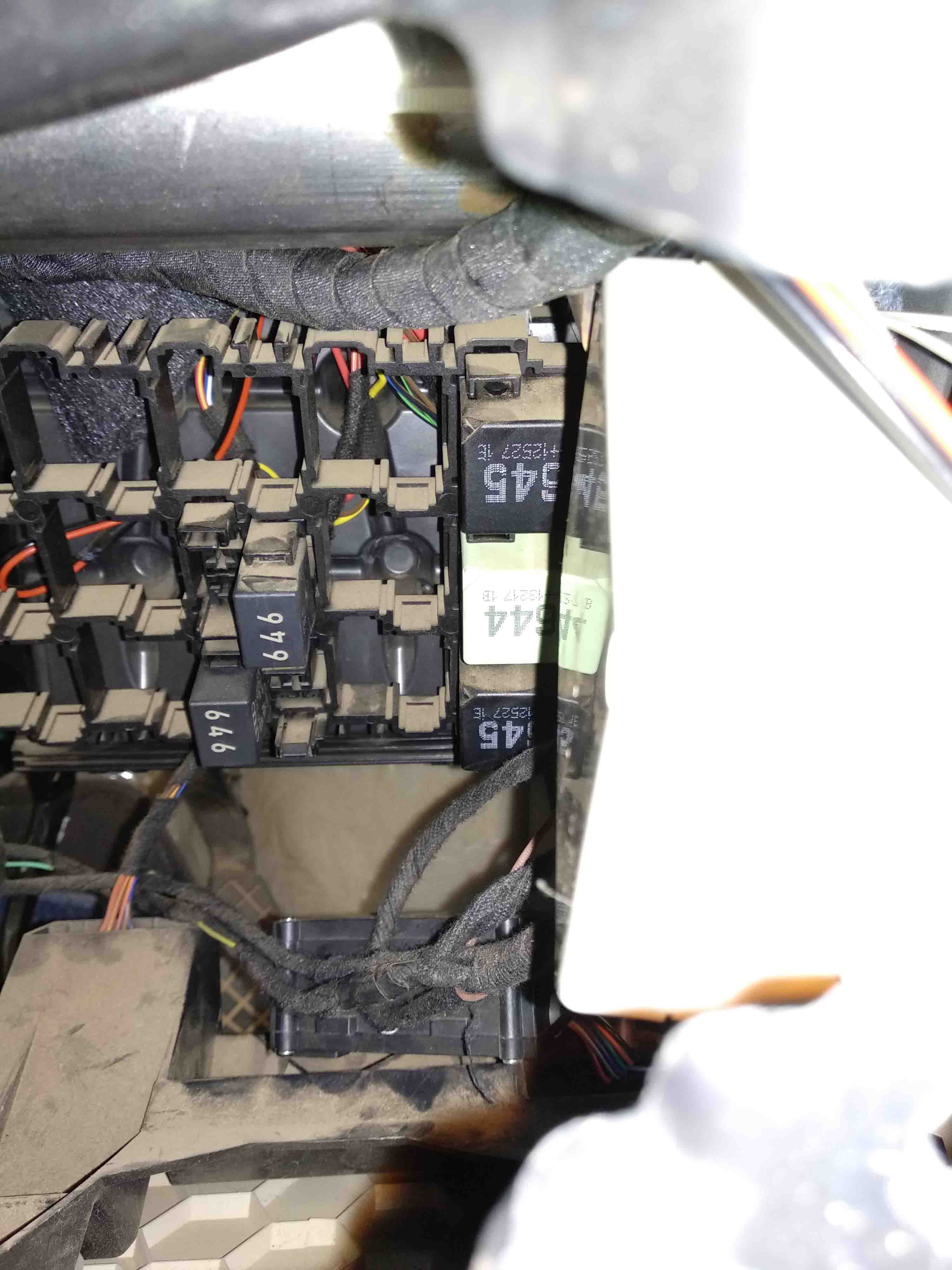

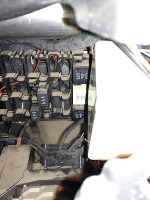

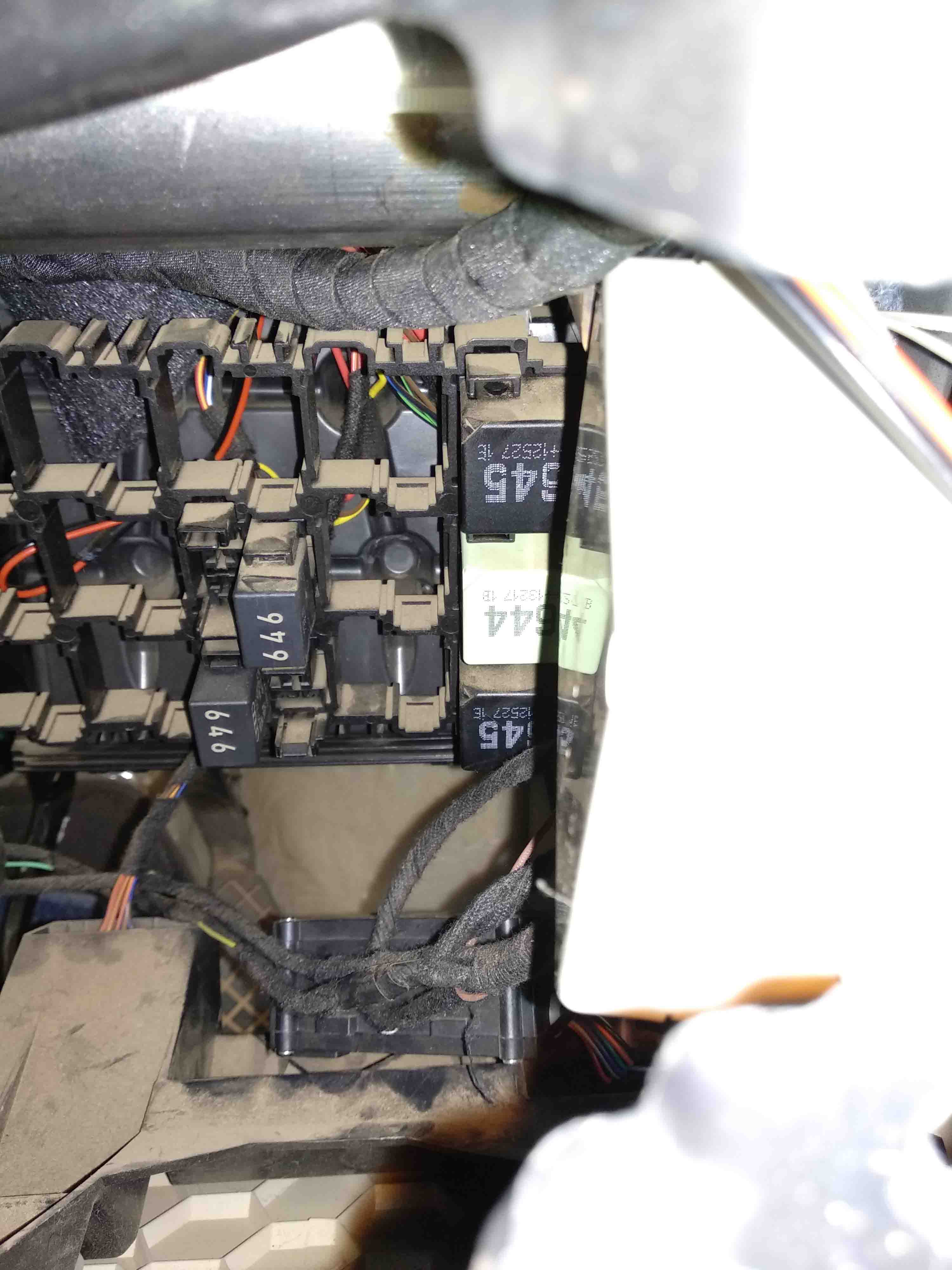

1) Relay Carrier
Pls ignore the dust

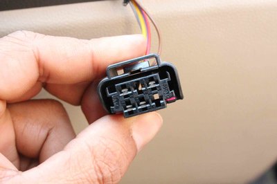

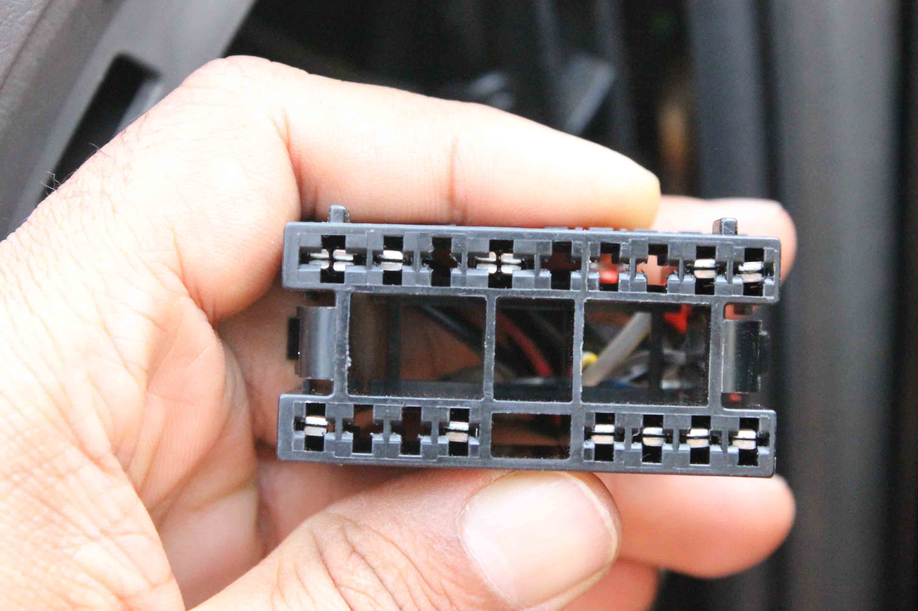

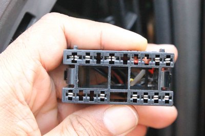

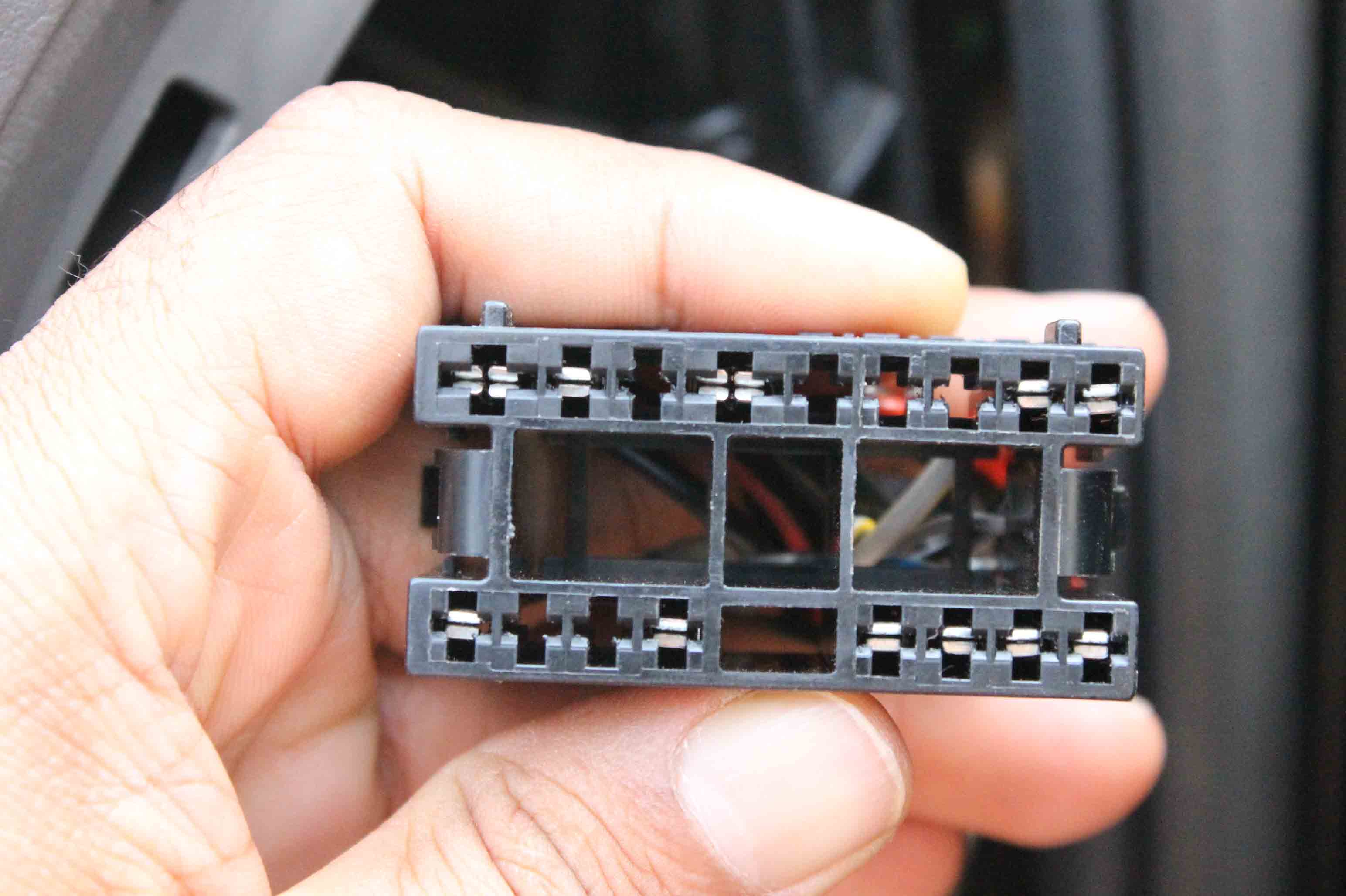

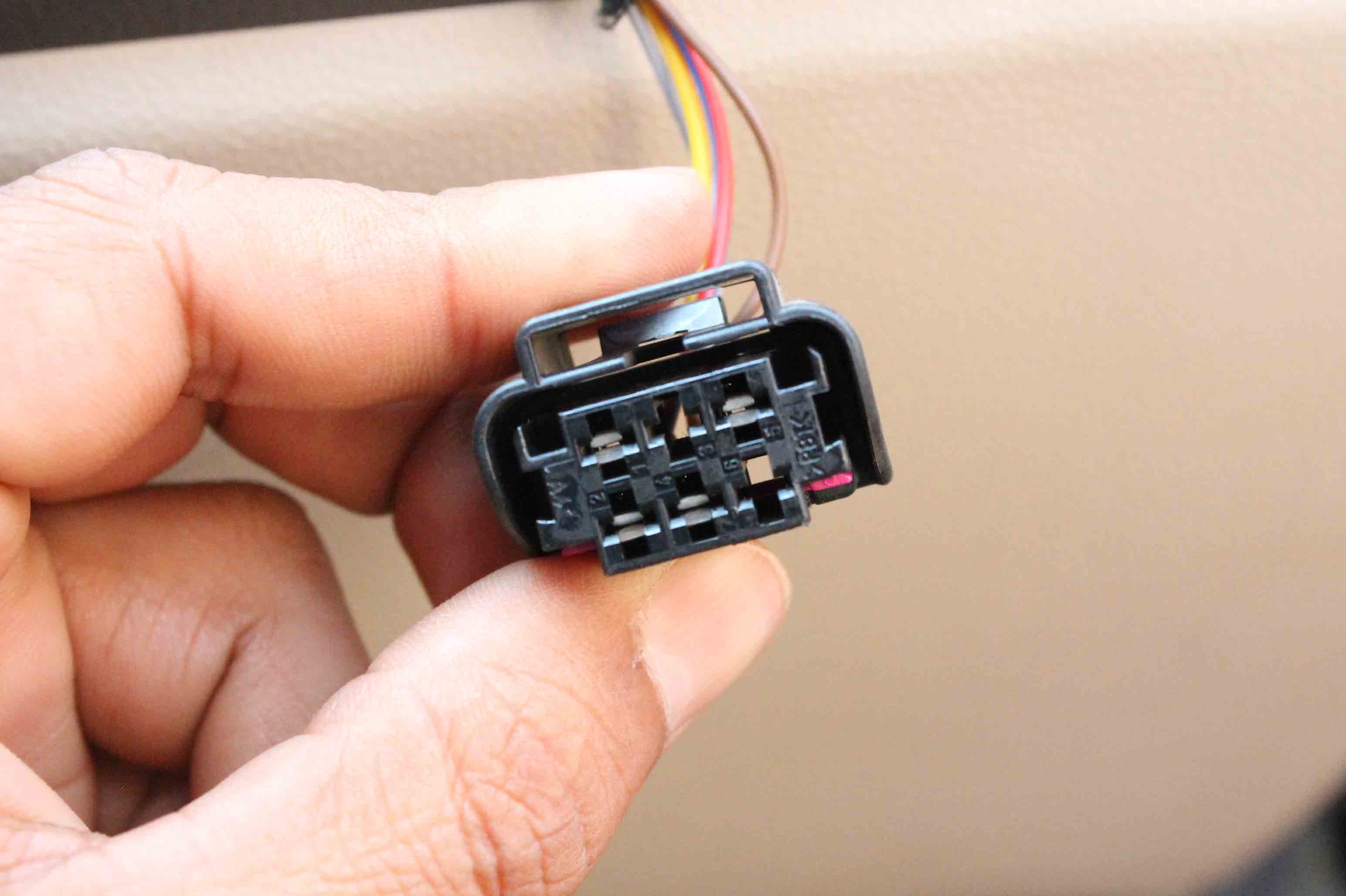

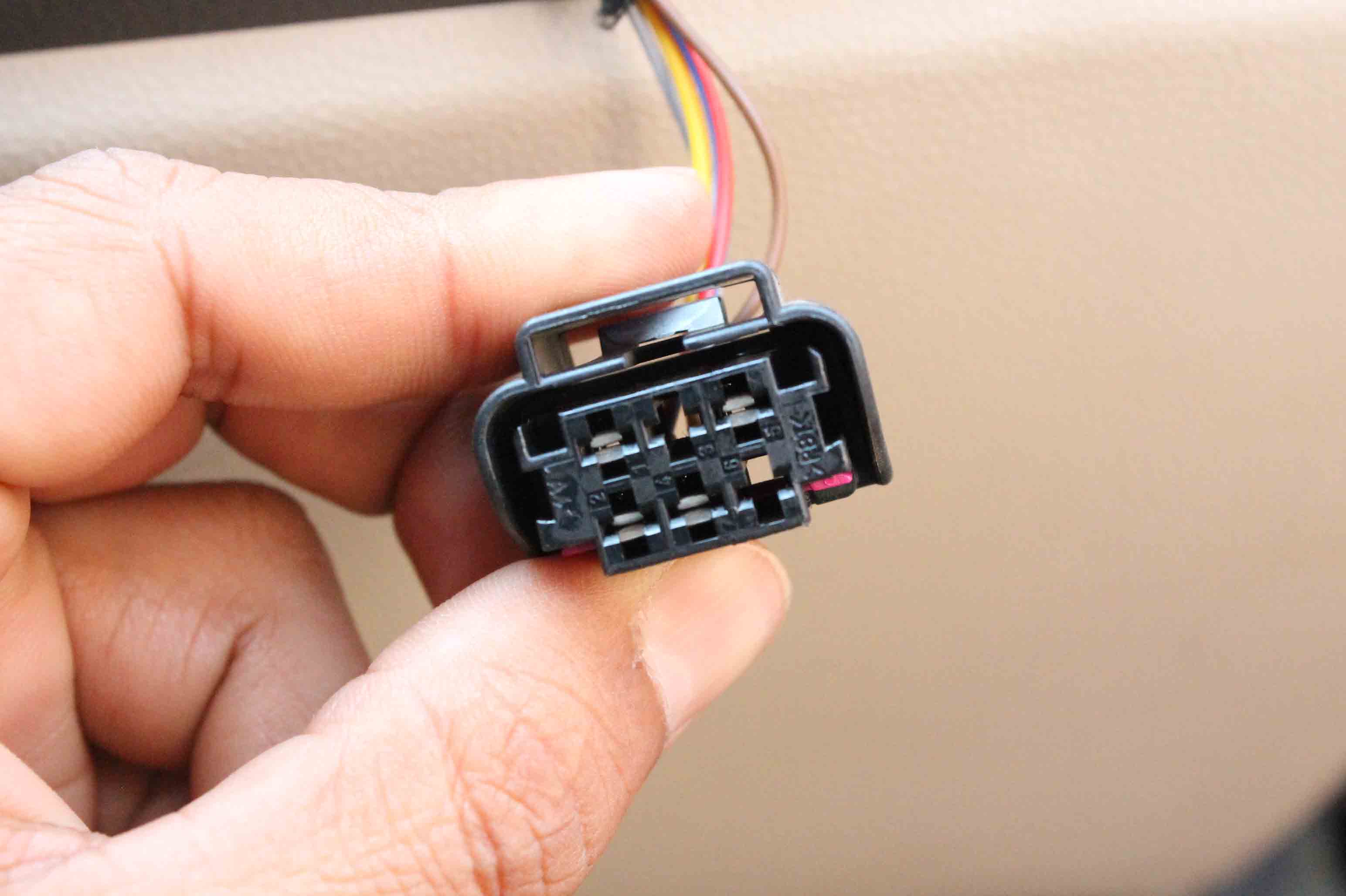

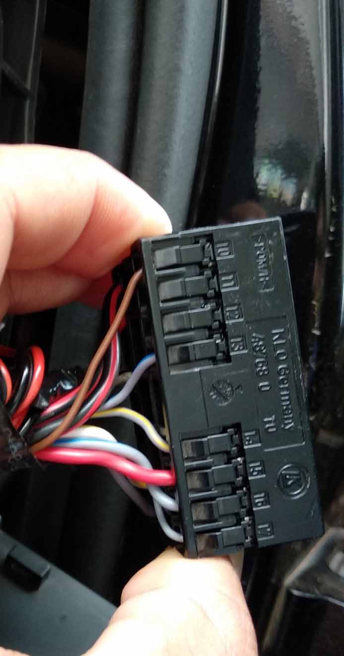

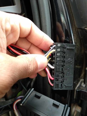

2) Light switch connector

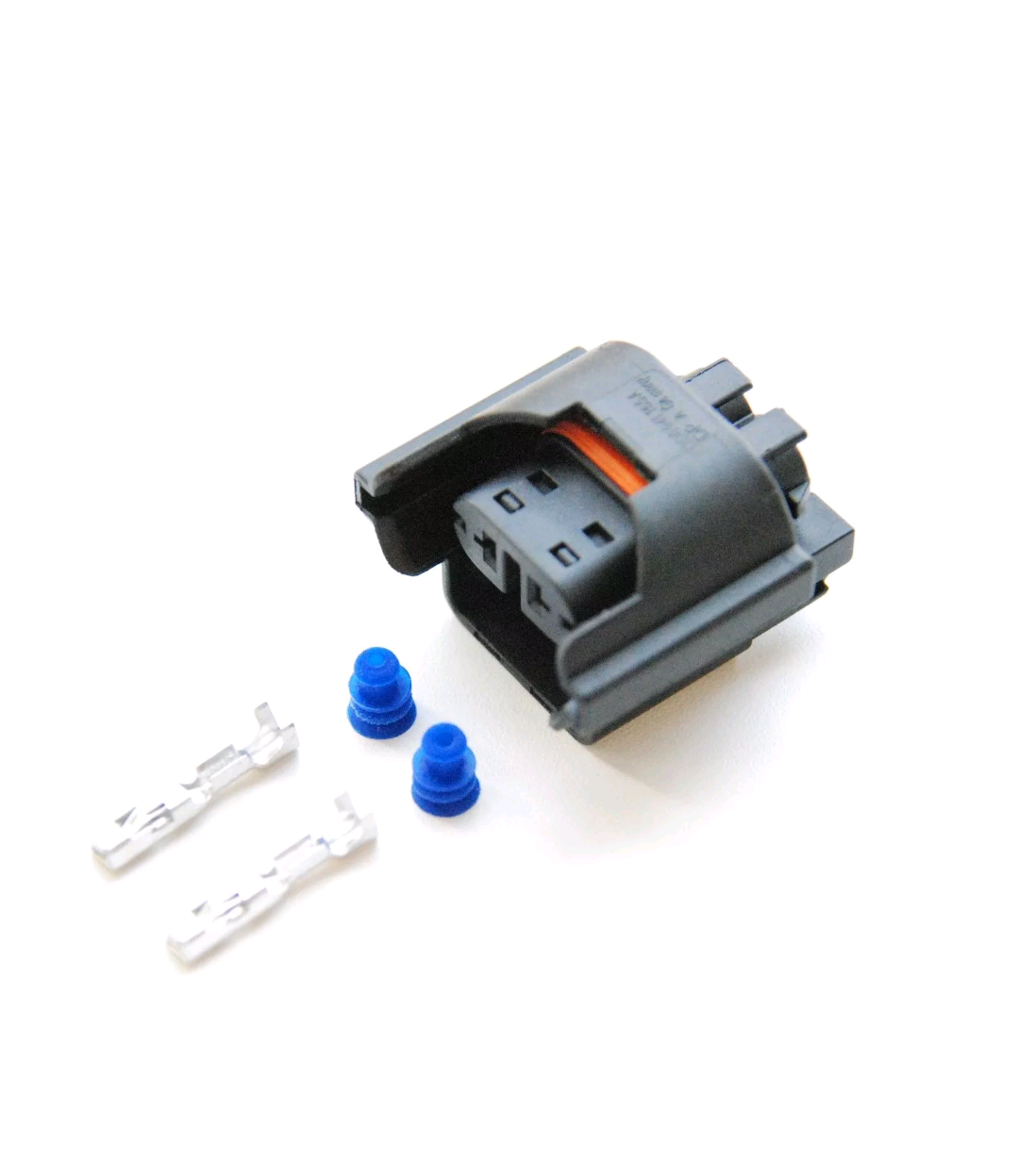

3) Dimmer connector (In India its headlight level adjuster)

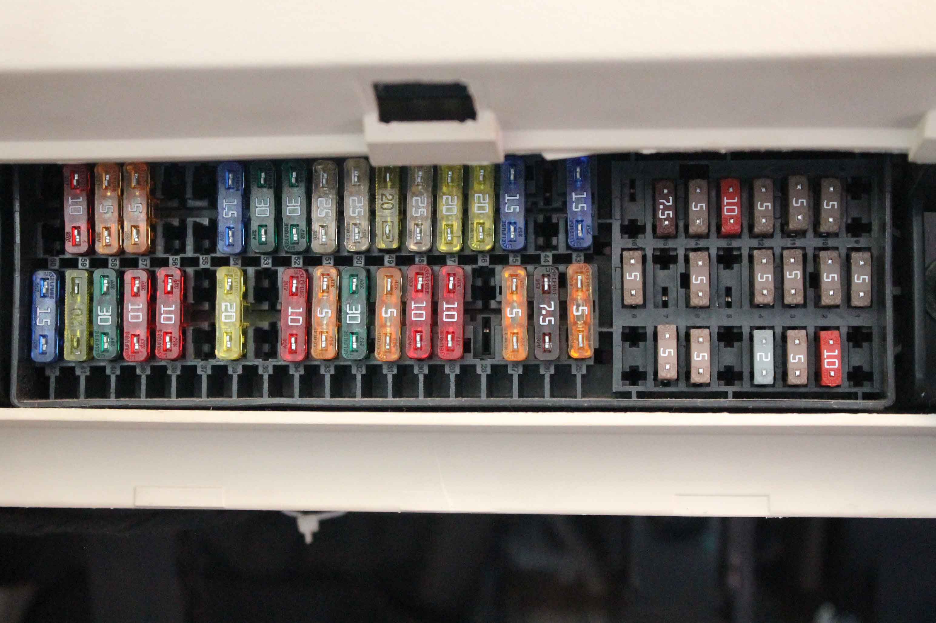

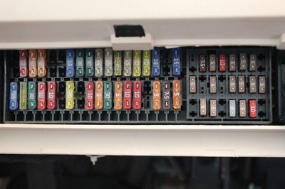

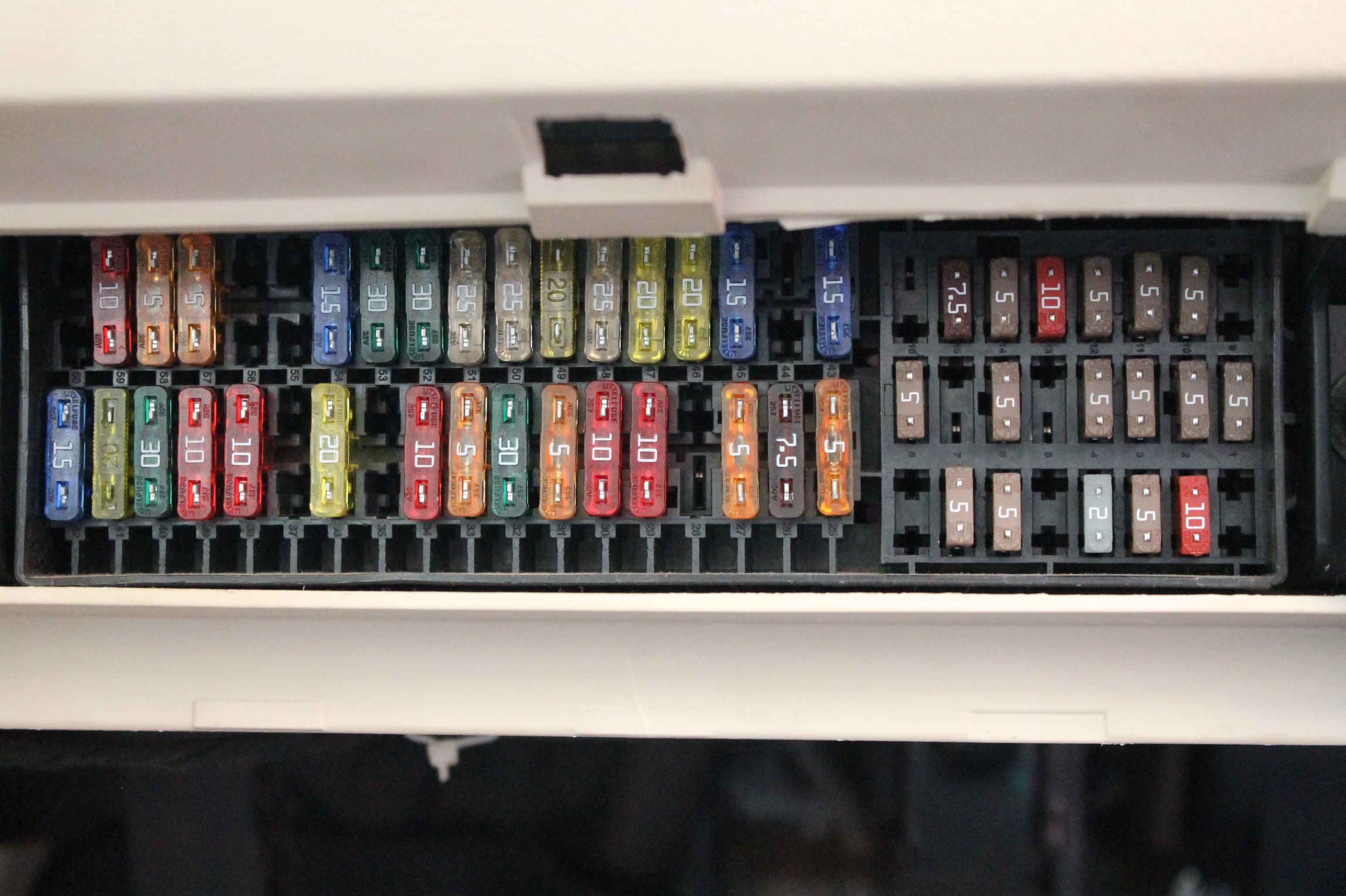

4) Fuse Box
No.41 & 49 I have used those for Auto folding mirror
BCM yet to receive. Scan report already posted

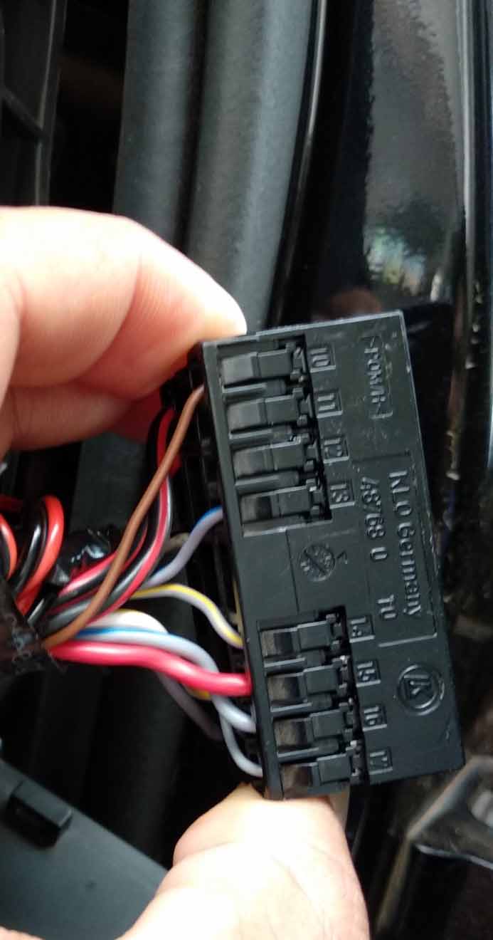

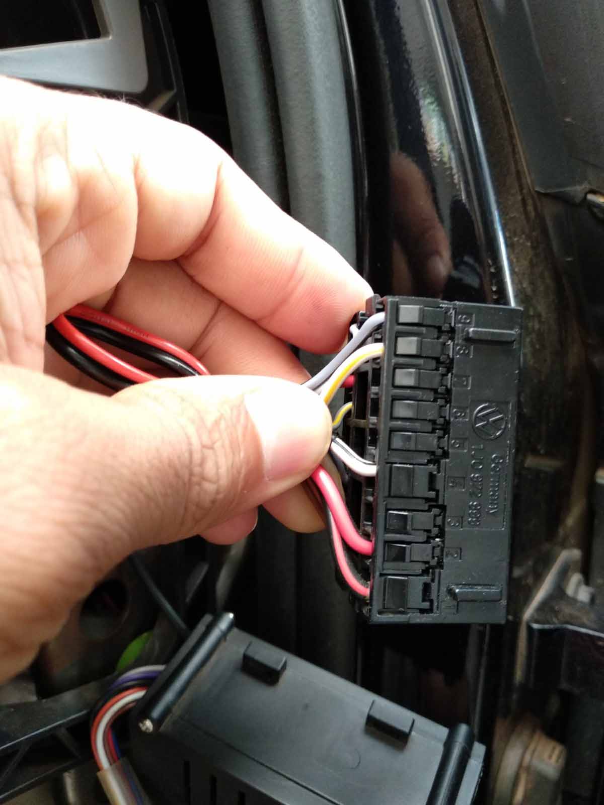

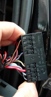

I need to see the colors of the light switch wires. Both sides of light switch connector.
Here is something interesting (T17/11), not seen here so far. (everything is verified in Elsawin :))

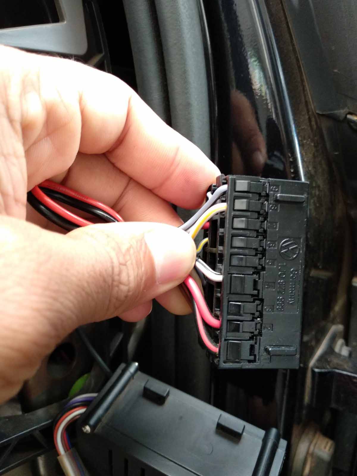

ciclo wrote: Thu Mar 29, 2018 10:28 am Thanks
Interior
Posts: 8837
Re: Retrofitting Bi-Xenon & BCM Max Adaption+Auto Headlight with CH/LH on 2013 6R
Excellent!
As you can see, there is no wire in slot T17/11, but this wire is very important with BCM Max.
This wire was always present in all the previous installations.
No problem for this, I will add this wire in your wiring looms. It will be a very complete wiring that will facilitate a lot of new functions to your Vento.
I will also add the power wire (fusebox-bcm) for your Static Cornering Lighs (SCLs), regardless of which bulbs will be used for this function (Bixenon VS Foglights).
At the moment I already have all the information to make your special wiring for BCM adaptation and wiring for automatic lights. (many wires)
I'll make them as soon as possible, hmm... the next week. Enjoy your holidays. :wink:

Hi, Fernando,
Reply for PM,
I will source dimmer switch, thank you.
I will install LED headlights,

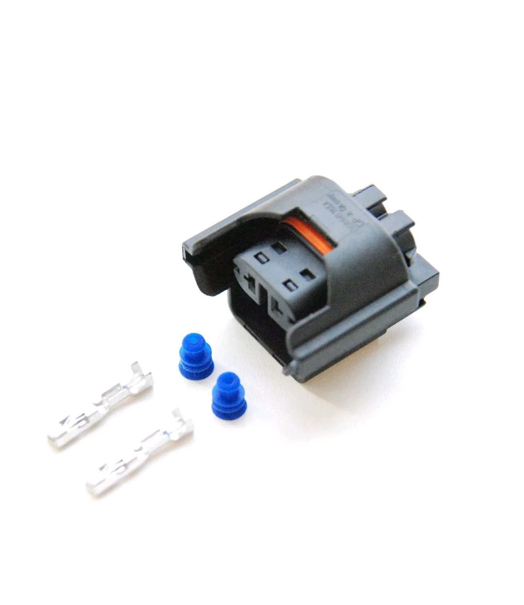

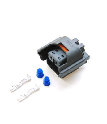

Fog light connector
its vw 2 pin H11 3D0941165A
sorry for delay in replying
