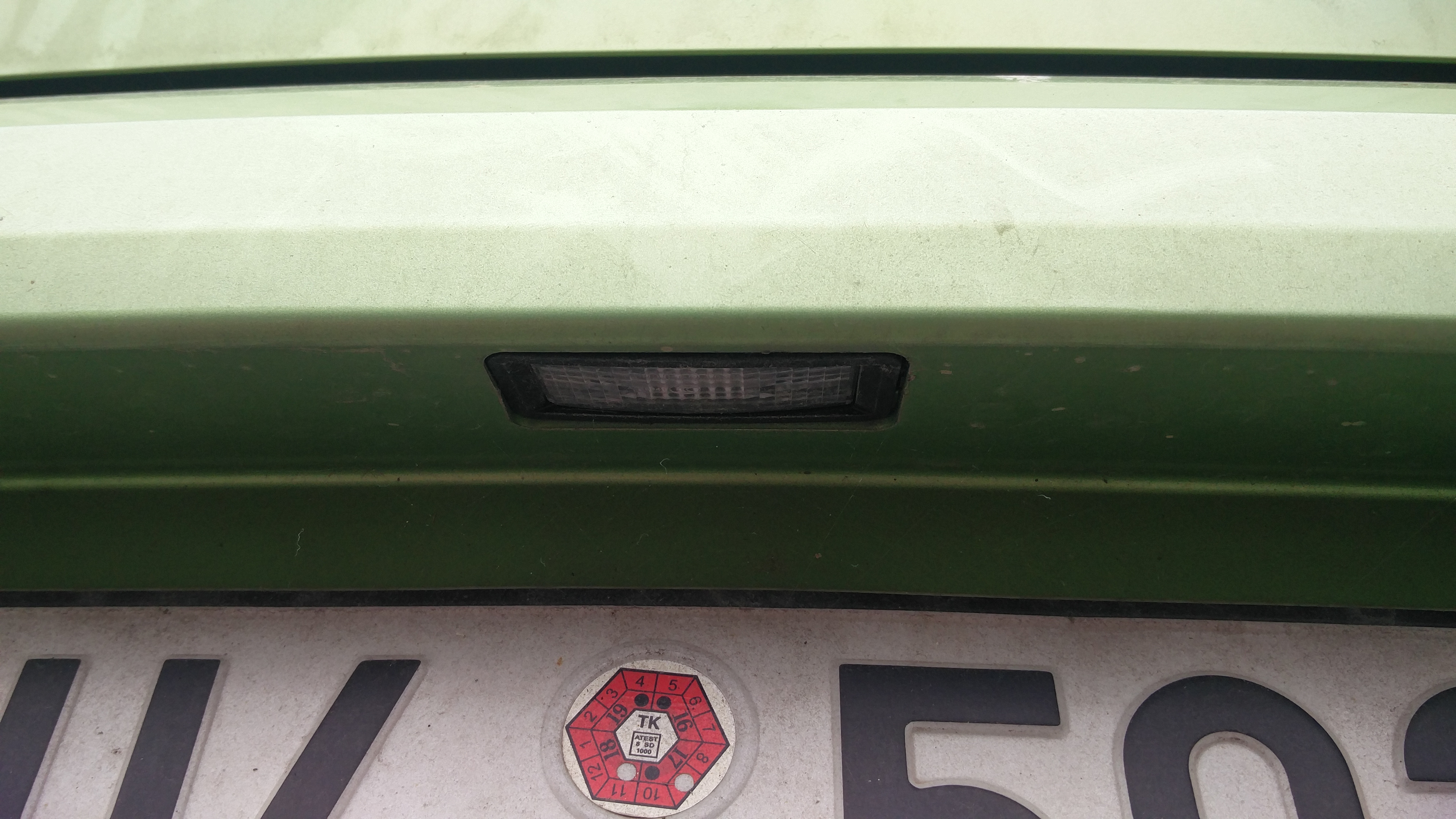

Yes, license plate light.
But take the freedom to surprise us with the images.

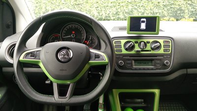

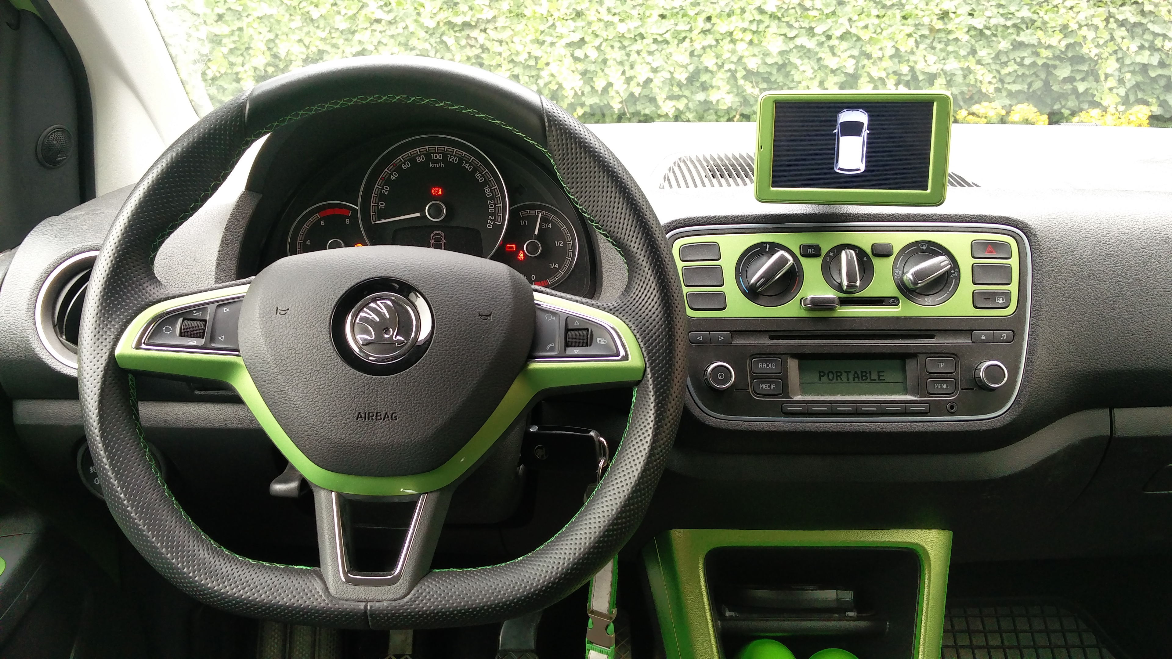

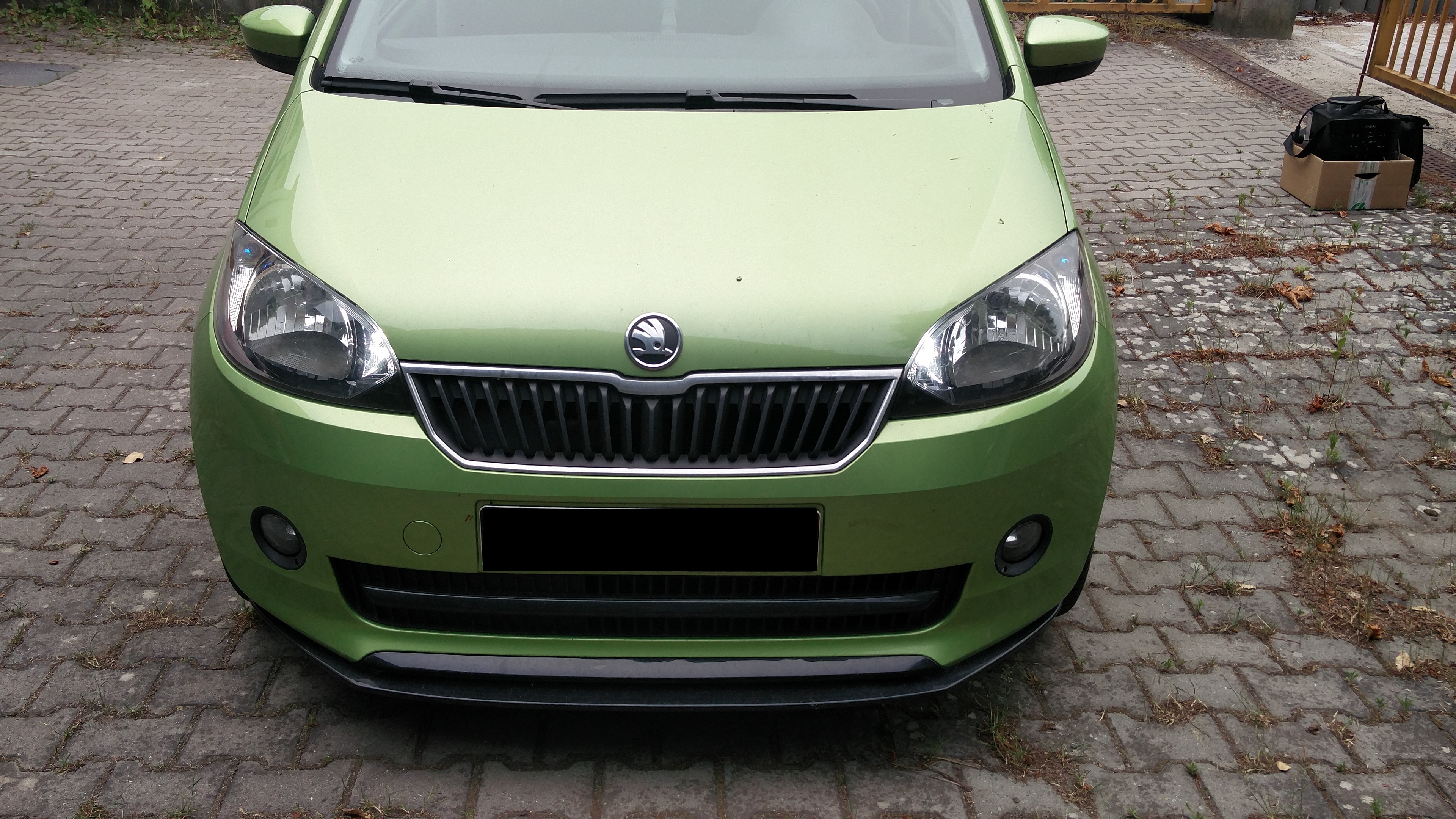

Promised photos :

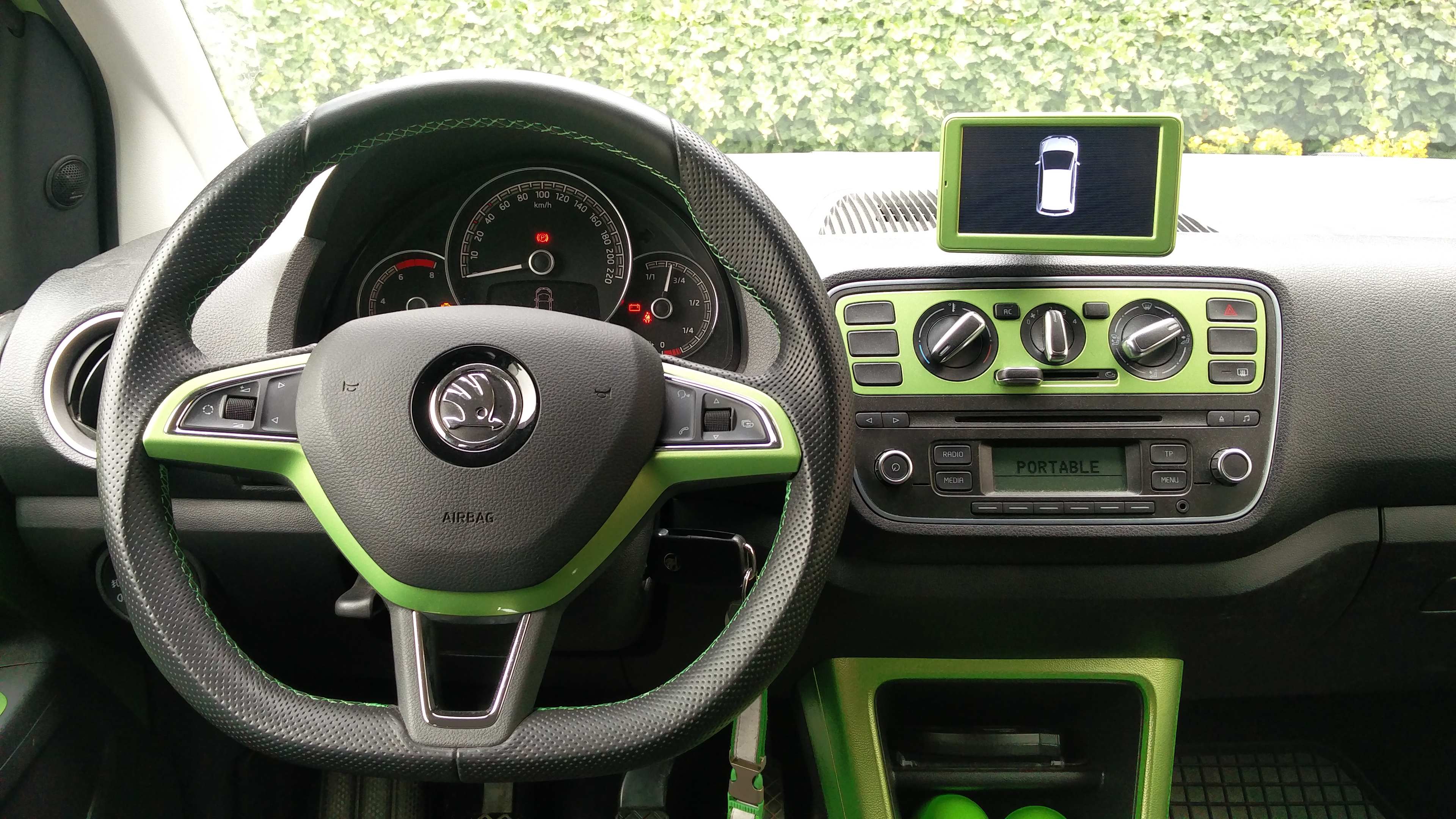

Interior with retrofitted Yeti FL MFSW with new FL maxidot cluster ... Factory radio will be replaced by china RCD330+, but it need a lot of work, because AC panel need to be moved to lower console.

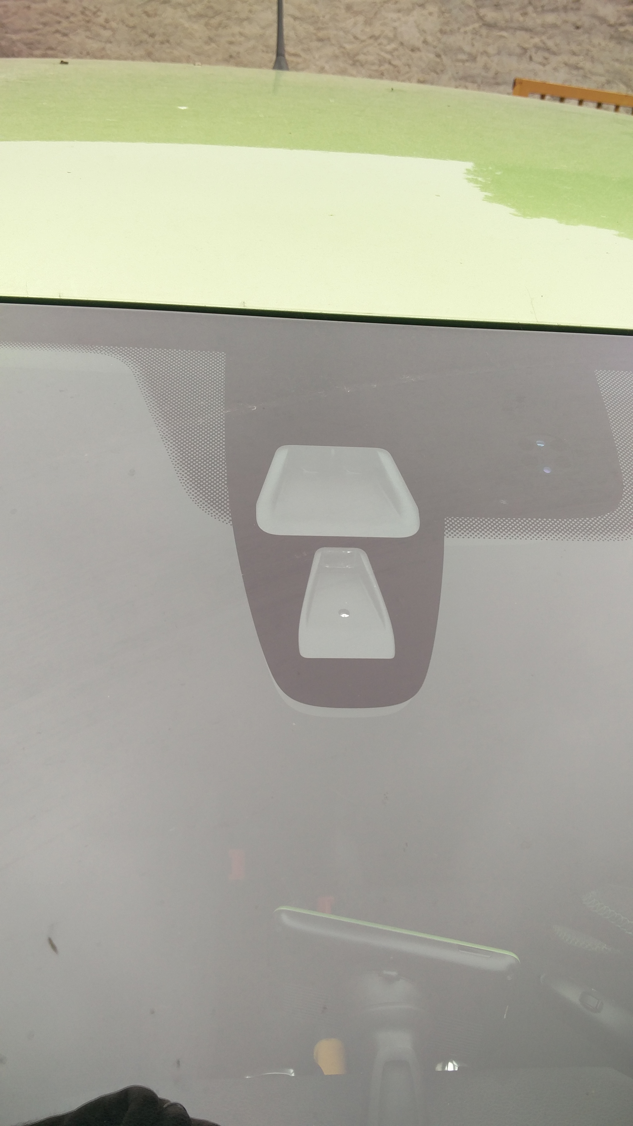

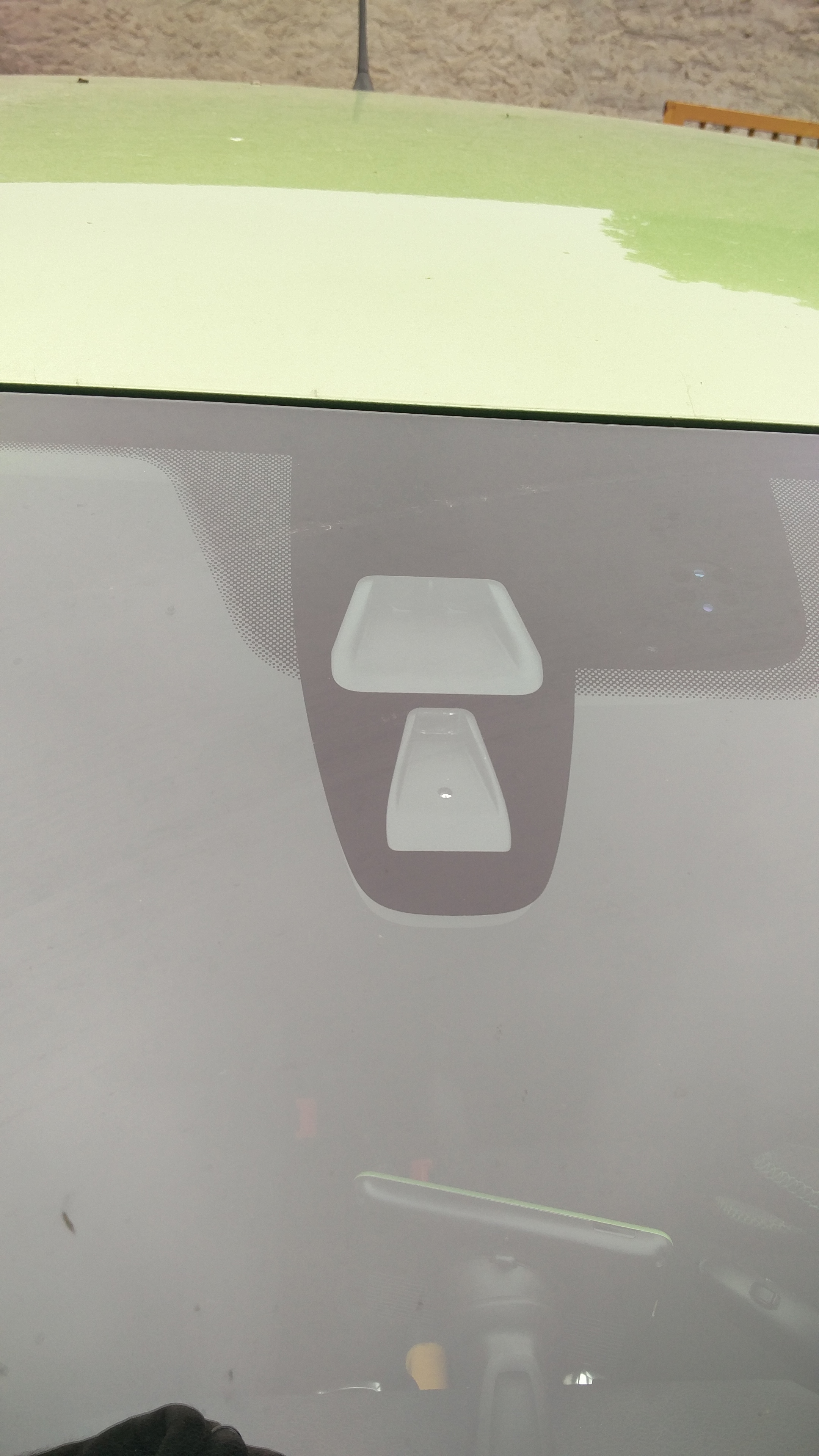

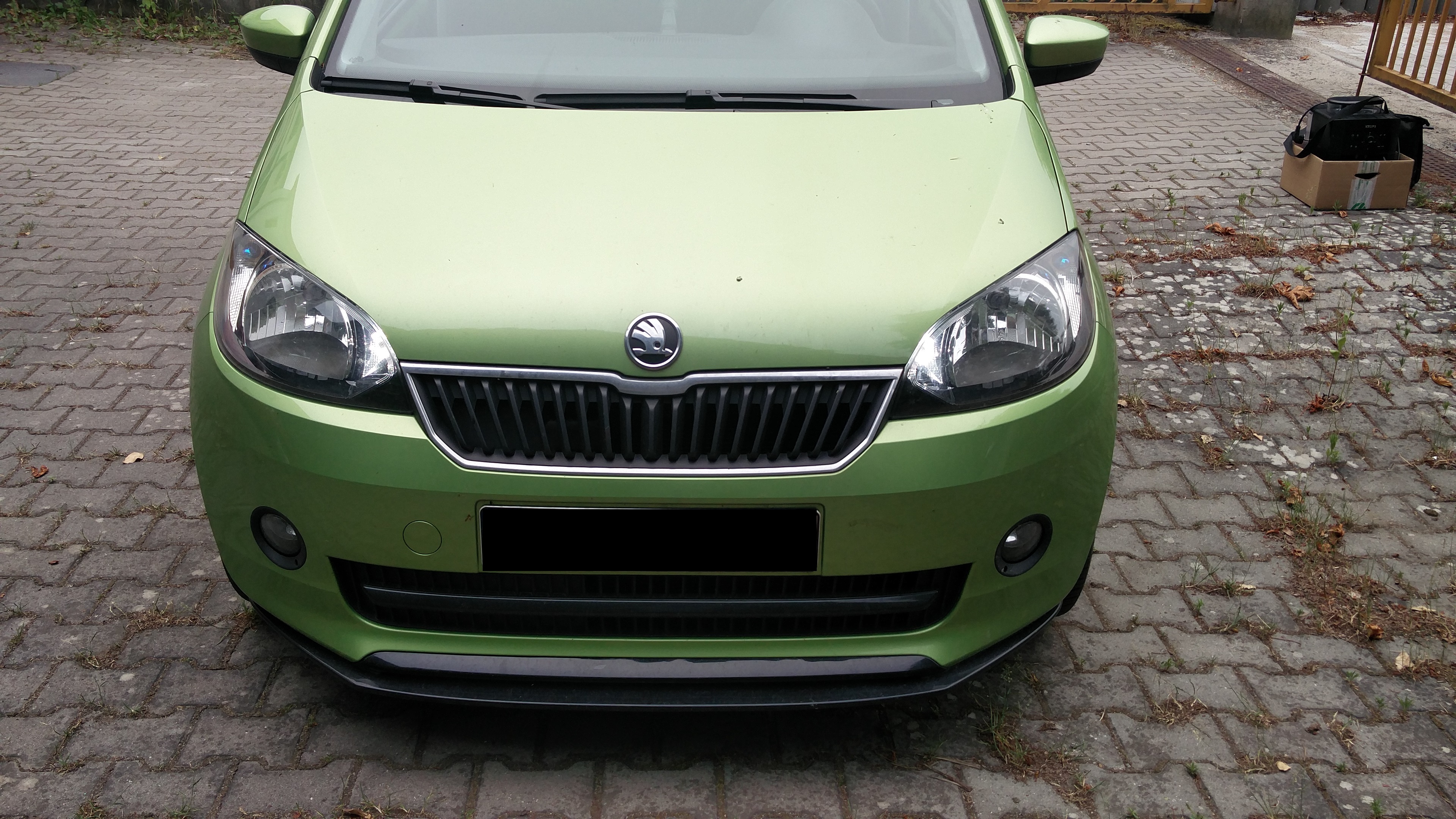

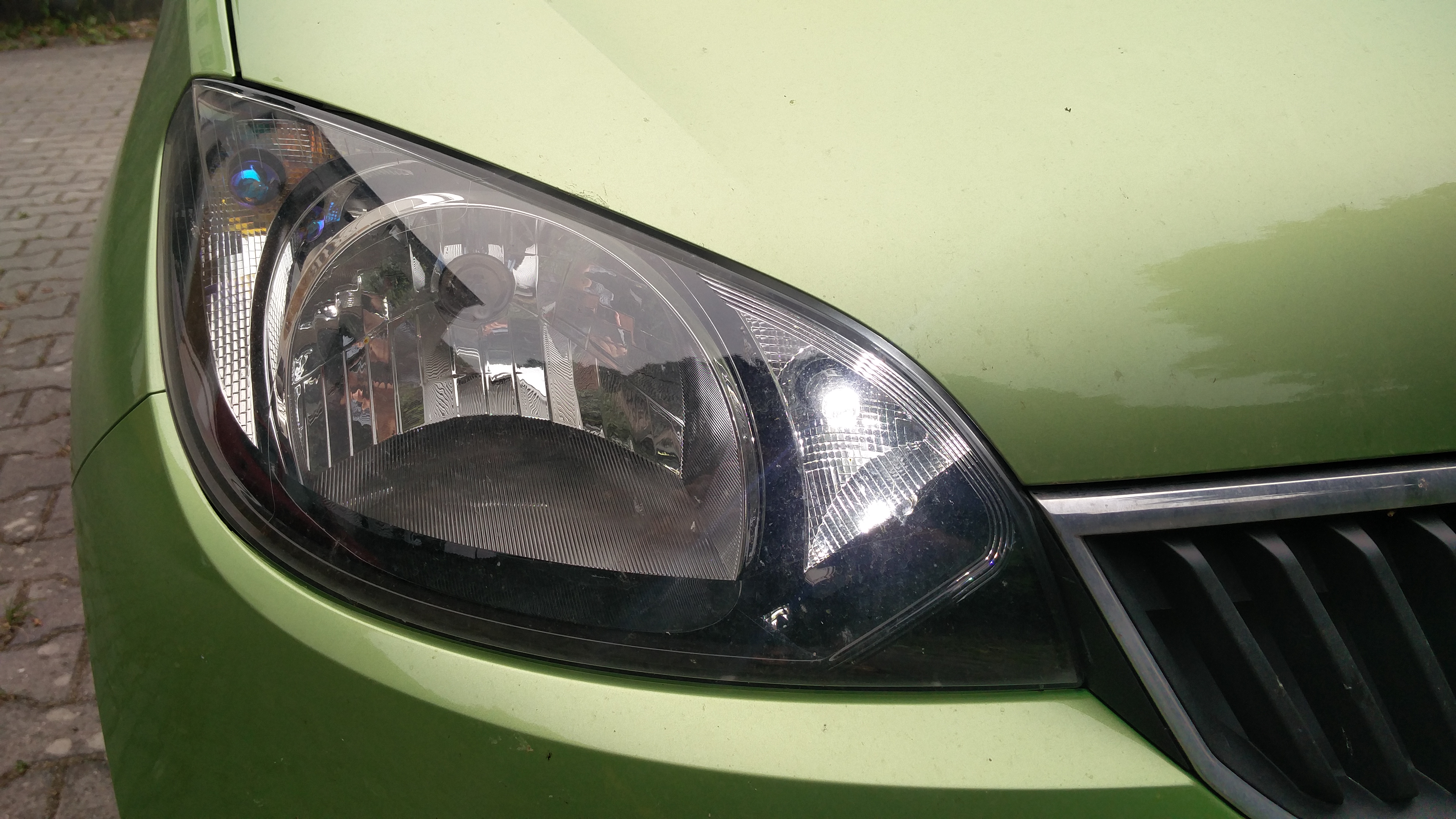

Another photo of exterior, with retrofited LIDAR brake ( Citysafe ) nad RLS. Light point in thje middle of lidar sensot is actually light sensor from china set in drilled hole
BTW anyone know how to list/export all BCM cosing option? I dont know where I have to code LIDAR sensor ... connection OK, but as you see my log, external unit is not correctly coded ...

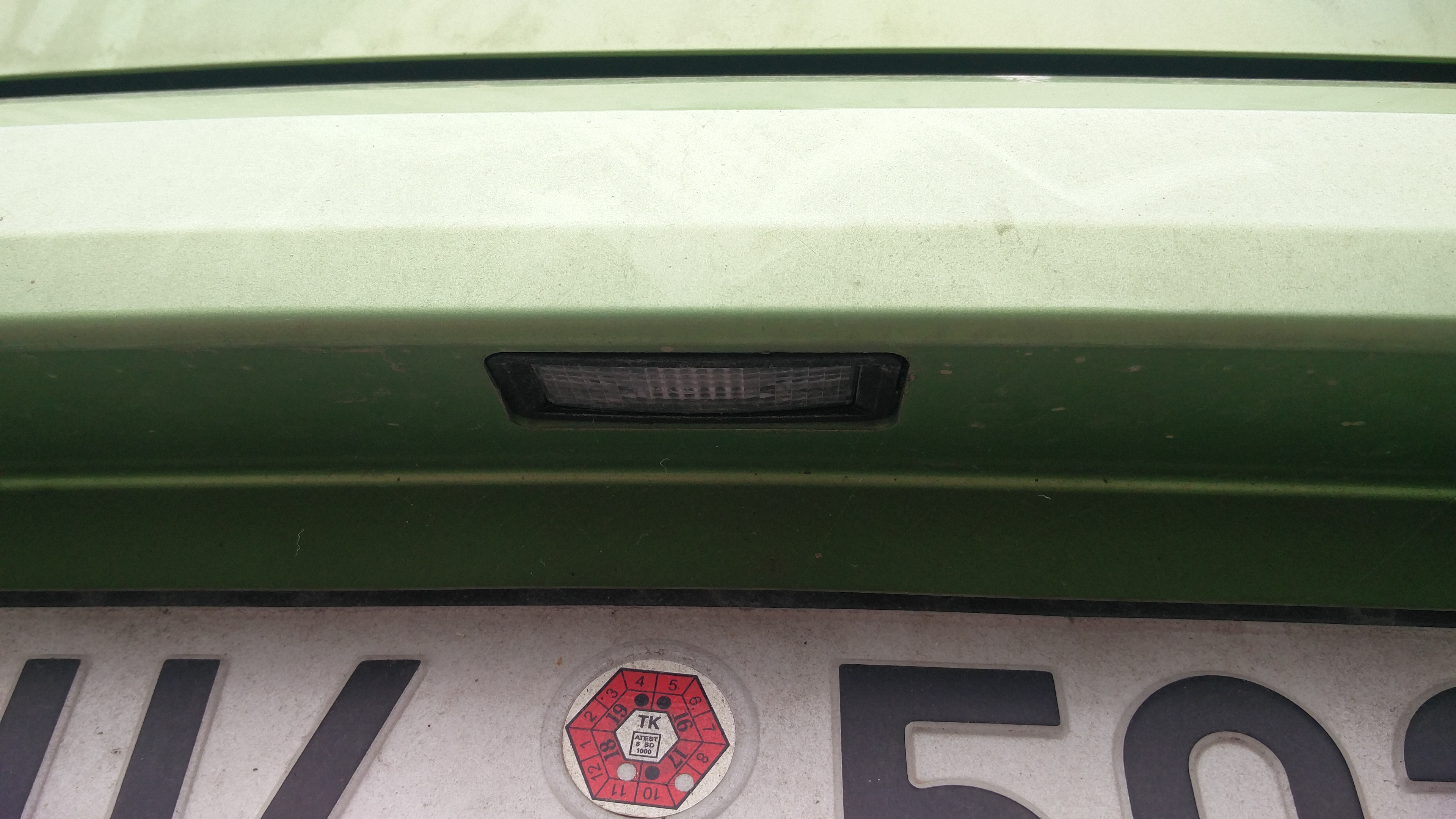

Licence plated light is single light in the middle, only in FL cars with factory RVC there is camera unit and then there are two lights as normal ...

Thanks for the pictures, but ...

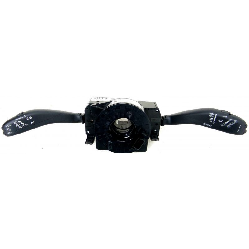

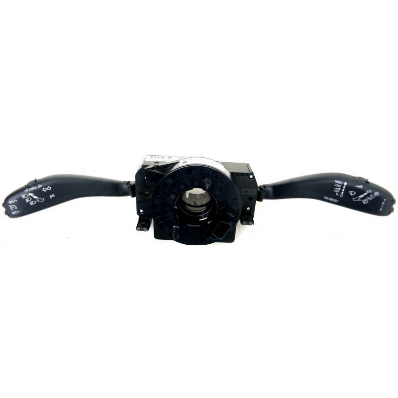

Tell me the part number of the stalks you installed.
ciclo wrote: Sun Jun 10, 2018 6:30 pm The most important images are; the front of your Citigo (lights) and the dashboard (mainly the new stalks you installed - for Cruise control and Wiper functions -)

Sorry, I forgot stalks.
They are from Polo, because its the old style and preFL Citigo/up! dont have RLS. From 2014, Citigo/Up! ahs new model of stalks with different connector ...
Stalks are exactly 6Q0953503EJ Question on MHH site is from me
Only from my friends account )
Thx. Daniel
Thx. Daniel

1. Two wires to RLS, its seems that it can wait, I will make it with a your harness. Its OK?
2. Plate light, its possible to cut the wire somewhere in interior? Or must be really near licence plate? I dont wont to remove bumper

2.
It's hard to explain with a single diagram, I hope you understand what I mean.
The connection points in the diagram for the different wires are not specified anywhere.
Look for the cable in interior.
This is so that the parking lights (P on the turn signal lever) work properly in the individual operating mode. New function for your Citigo.

1. My mistake, I mean DRL
2. I understand, I will check original harness in grommet outside/inside ...because from outside in this grommet, there is only harness for plate light, RVC ( if factory fitted on FL models ) and PDC ...

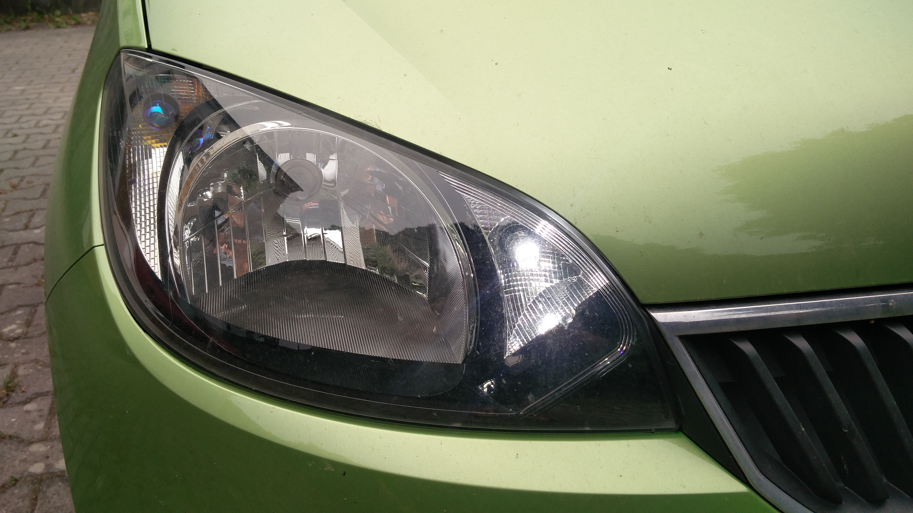

Your current electrical installation of DRLs is not correct for automatic lights. It is solved by isolating the T17/3 light switch connector wire.
Now you must do a new electrical installation for DRLs by installing two new wires:
- from T73b/3 to T3d/1 .... left headlight.
- from T73a/5 to T3g/1 .... right headlight.
Current wires in headlights for DRLs are violet/green in T3 connectors, remove from connectors and isolate them with cloth tape.
Install the new wires in their place.
