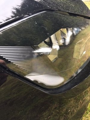

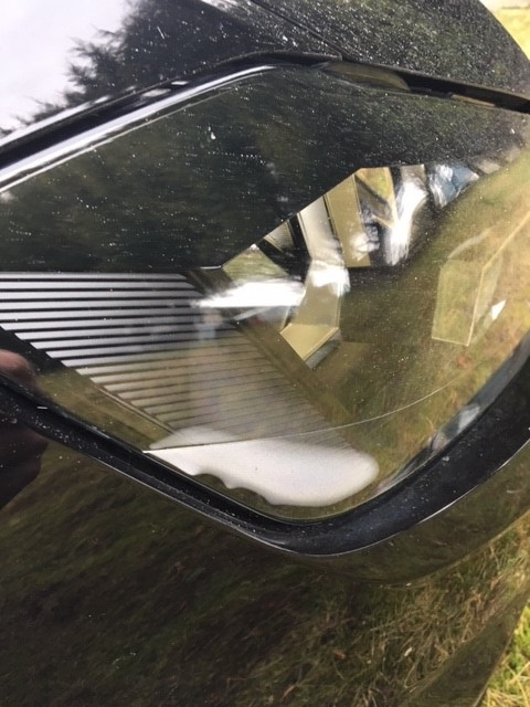

Aaaaaand the new headlight has started misting up too.... :evil:
Nowhere near as bad and not in a critical place, but still.
I'm going to see if heating up the outside of the lens tonight with a hairdryer gets rid of it.
I've no idea what's wrong with these headlights and no idea why it's only the driver's side. :?
It only misted up last night after I changed the bulbs, so I'm guessing there's something about the driver's side headlight that means the vent is easily blocked when you re-insert the light into the body.
Weird as hell.
