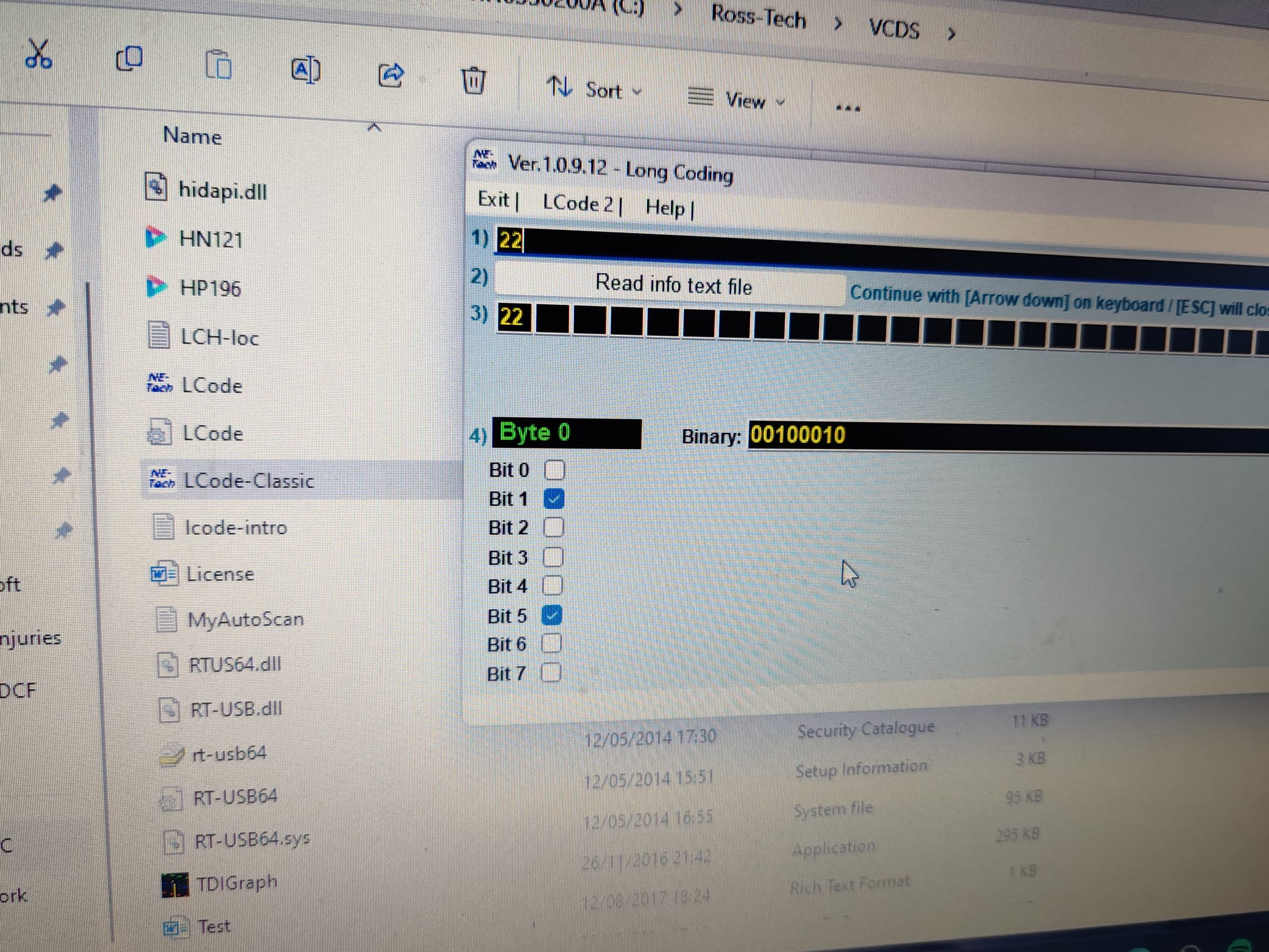

I have tried what you suggest ciclo, after I make the bit change and check it has changed by clicking on another to confirm it doesn't save when I exit. What am I doing wrong?
Thanks in advance

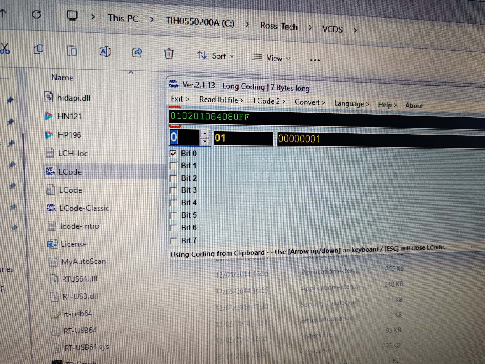

These make any sense ciclo?
Posts: 9037
Re: Headlight problems, dip &full beam not working together,
Those are the Ne-tech applications that are inside the ross-tech program and they make sense as long as you know how to use them. Better LCode than LCode-Classic.

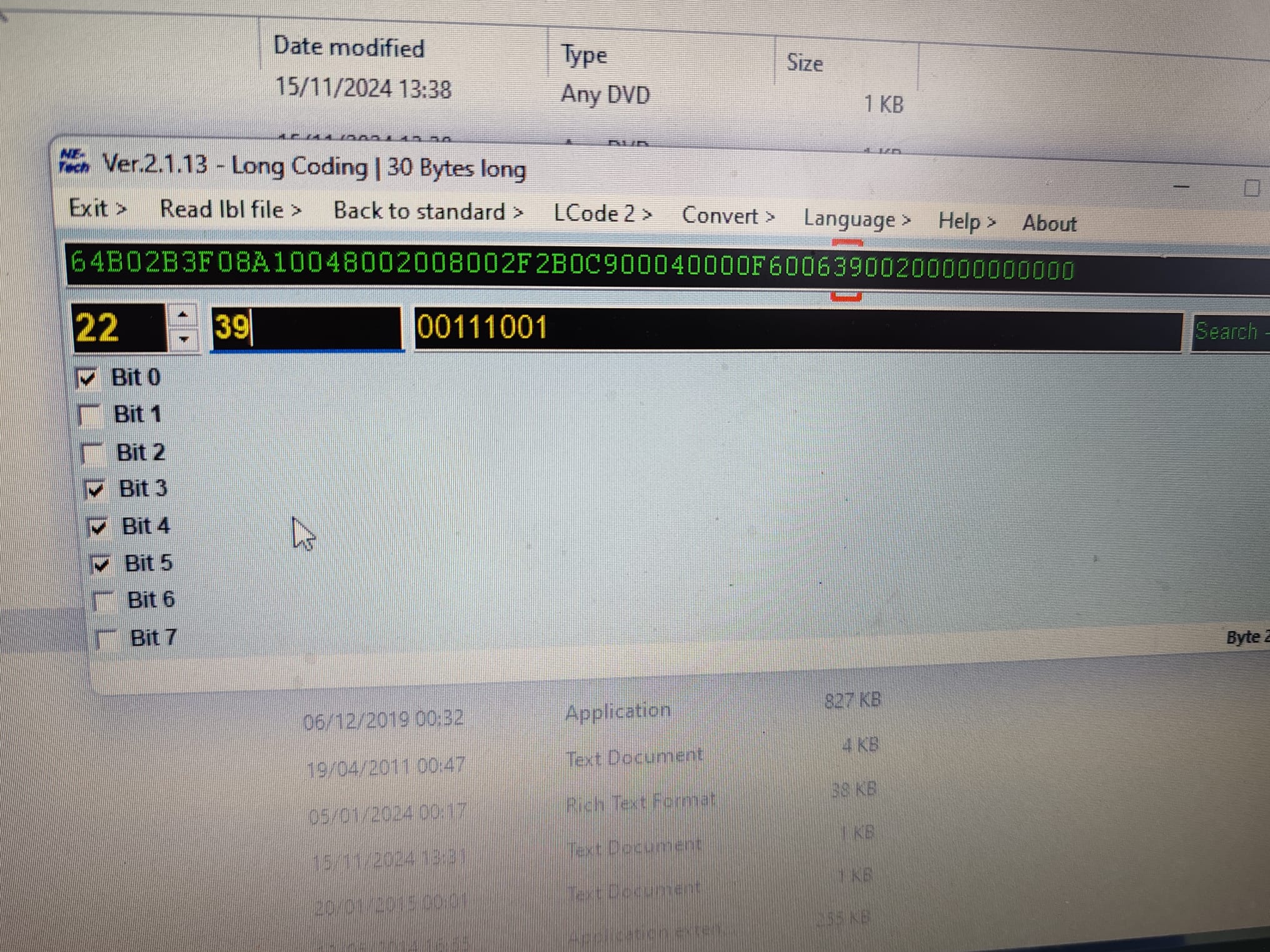

N-Tech. LCode application. 'Example'.
Let's assume that the hexadecimal value in Byte22 in your BCM long coding is '3D' and we want to disable Bit2.
Since we know in advance that the resulting hexadecimal value when disabling Bit2 in Byte22 is '39', we type it in the hexadecimal box...
...so Bit2 is now disabled, all that remains is close the window to accept the new BCM long coding if you are working on the car with VCDS.
You can easily calculate the hexadecimal value of a Byte with the Ne-Tech application by enabling or disabling the Bits.

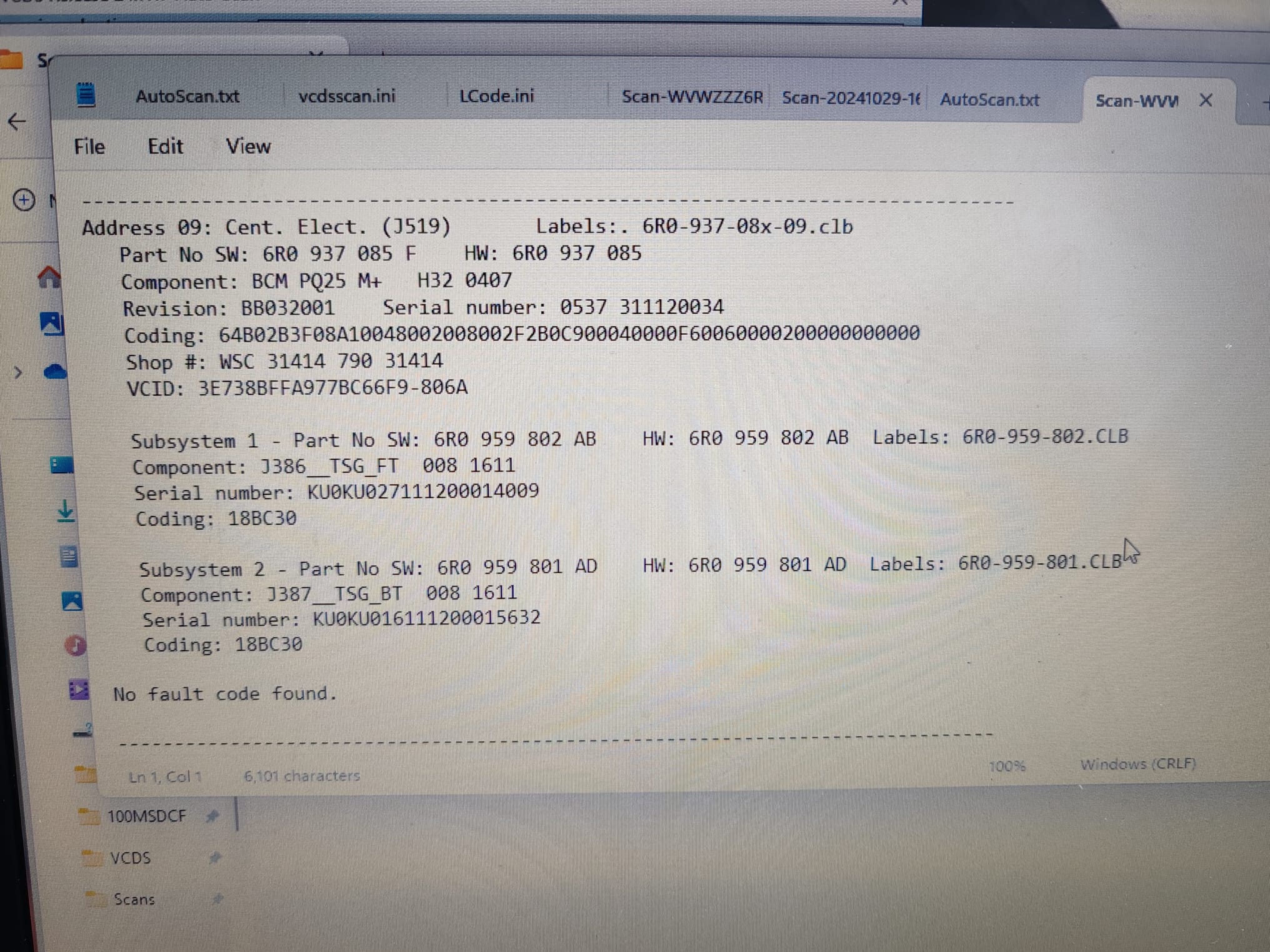

Post by Heathcliff »
Hi ciclo,
I've worked out how to perfom an Autoscan! I've attached the coding and the bit in question looks correct? What is the problem or is it still something I'm doing wrong?
Thanks for you continued support.
Posts: 9037
Hi Heathcliff.
The problem is that your 6R's electrical configuration is not correct, which is something I already told you previously.
Please, let me explain, according to your BCM, your 6R is not a Bluemotion model with H4 or H7 headlights, which is the model on whose BCM this coding (Byte22 Bit2) can be performed/applied and for which this thread was started.
Fortunately, there is a simple solution based on the original diagrams to install H7 headlights on non-Bluemotion models with original factory H4 headlights.
Links to the solution:
-viewtopic.php?p=508917#p508917
-viewtopic.php?p=529863#p529863
...and some more posts that I can't find now but that are exactly the same.
Everything will work perfectly forever if you or a workshop does it correctly. It is a simple operation that requires some experience and tools.
Show the picture to the workshop if you order it.
