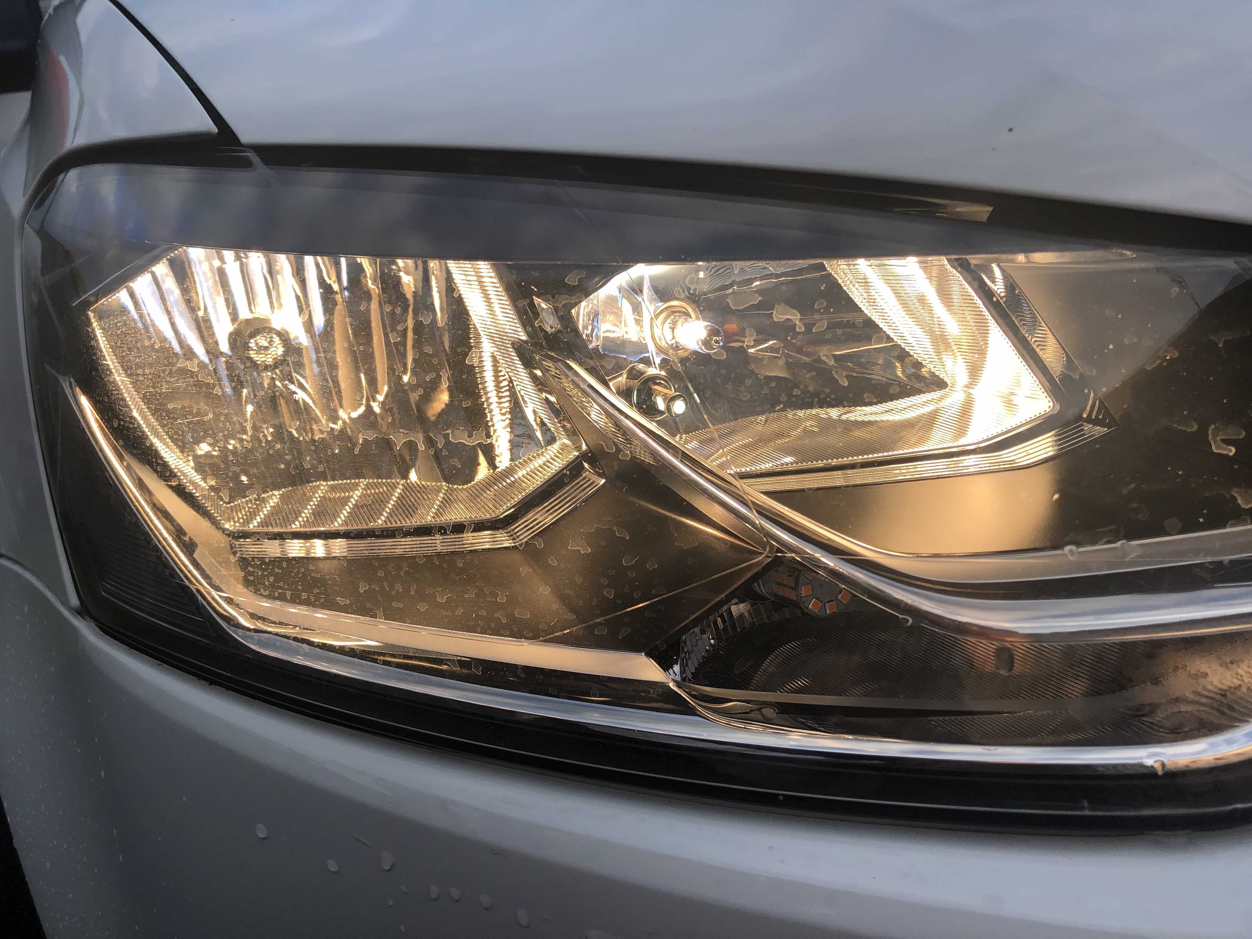

I've got a polo 2013 1.2tdi bluemotion and I have a problem with the headlights ,
All bulbs have been checked and work fine indipendantly but the problem is when you have the lights on dip beam and you put them on to full beam only the inner two full lights go on and the dip lights go out,
Should it be like that? Has a relay gone?
I think the two dip and the two full beams should be all on together ?
Any help will be much appreciated

So pete.williams, hopefully when you check your headlights tonight you will find that the DIP and MAIN beams are both in the same area, so you have a single headlight with an H4 dual filament bulb - unless the previous owner did what I suggested in my previous posting.

I've had both headlights off the car and both dip and main/full beam bulbs are H7 single element,
So not H4 duel element,,,
So still scratching my head as to what's gone
Cheers
Cheers
