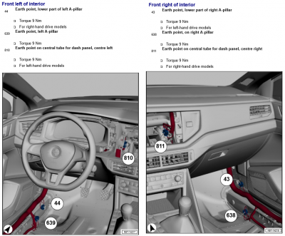

Could this be caused by loose earth wire / points?Little red wrote: Thu Oct 31, 2019 2:40 am I am currently experiencing intermittent electrical problems which I know are a bugger to fix. Front assist daily stops and starts. Car went into sports mode for 3 days despite having selected eco. iPhone not connecting WLAN or the Vw dongle of course when garage have it everything is good.
(Earth Points not torqued properly.)
The following is just 2 sample pictures from ErWin, but this is what I meant for earth points: I have the entire Earth Point document of the AW Polo in pdf format, if you need it feel free PM me your email address.
(I can't upload pdf to this forum.)
