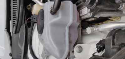

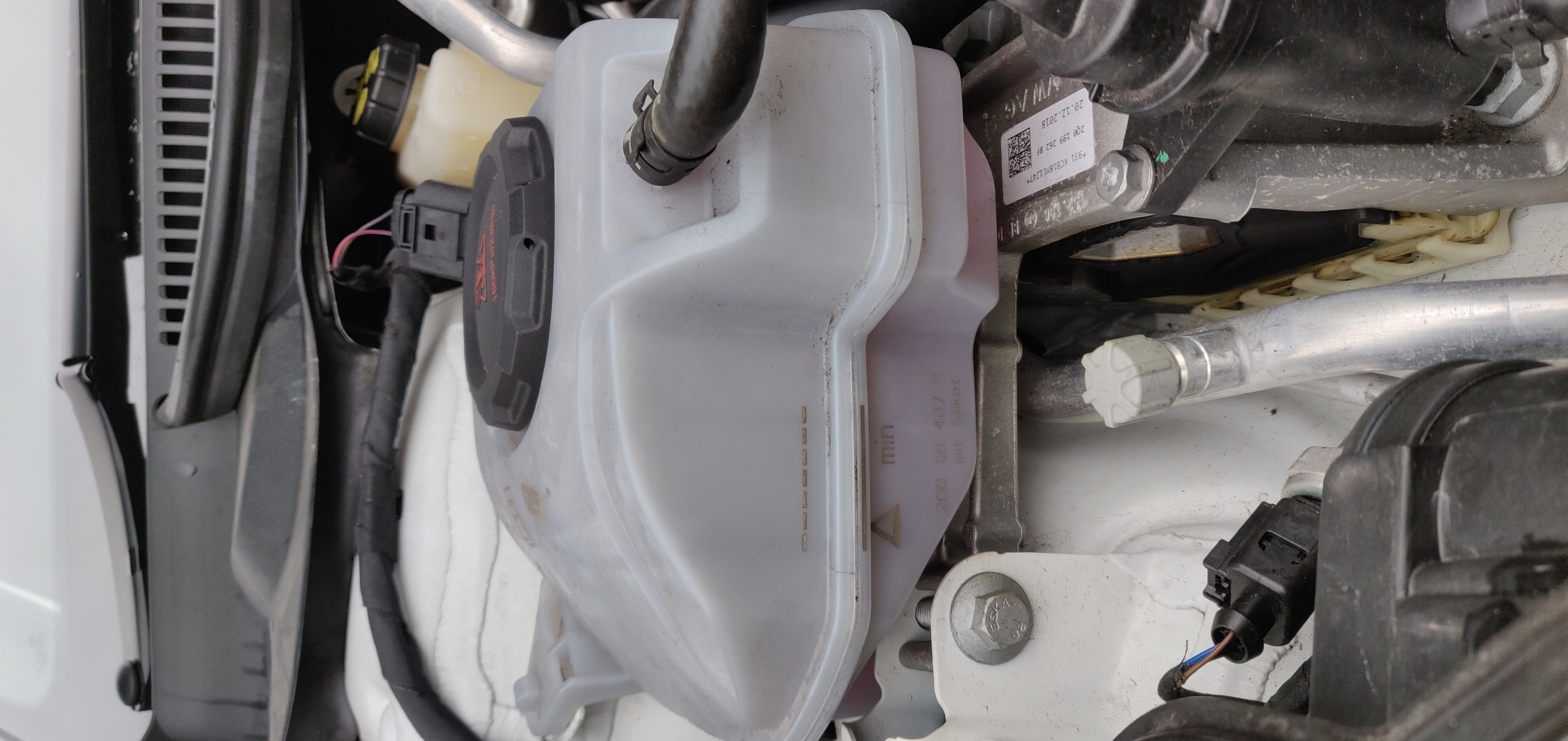

Afternoon all.
This thread promoted me to check the levels of the engine coolant in my car. I'm pretty sure it needs topping up (looks to be below the minimum from the picture).
If it does need topping up, can I buy this online anywhere or would I have to go into a VW dealership?

While VW Group, as far as I know, do not manufacture coolant or coolant additives, while a car is still under warranty, I'd always go the extra mile and buy direct from a VW Group outlet and retain the sales receipt. This could be a simple "trapped air" in the system getting purged back into the reservoir, and so after topping it up you will never have any more "level dropping" issues, but it might not be.

Just "one of these things" - it looks like your coolant level is just down to the join in the reservoir so is mid way between Min and Max, so maybe okay, I've always aimed to have the "cold" coolant level on or just above that point.
Now, most car engine's cooling systems have maybe 3 zones to optimise heating up etc, so maybe the standard filling rigs are not able to ensure that no air is trapped.
I've never ever had this sort of issue with any cars that I have bought new over my 40 years of buying mainly new cars, but, from being a member on the Skoda motoring forum, and SEAT motoring - this sort of thing is far from being unusual, and even with the 1.2TSI 16V petrol engines, which might seem a bit strange as few if any 6C Polo owners with that engine reported this issue - maybe it differs from factory to factory although Skoda factories built all the 1.2TSI 16V petrol engines.

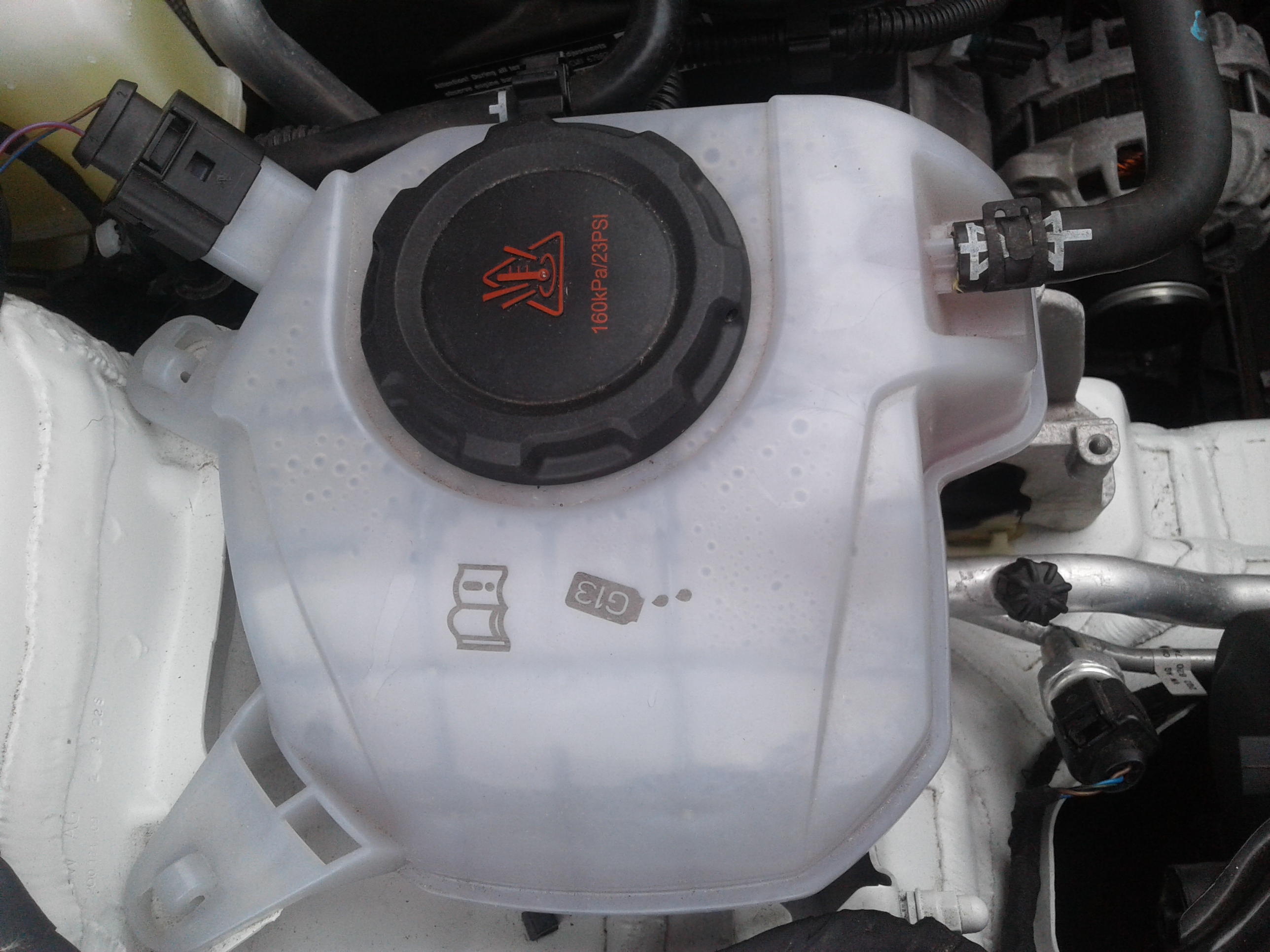

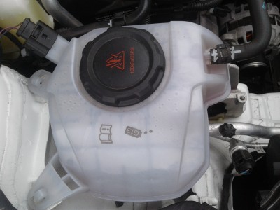

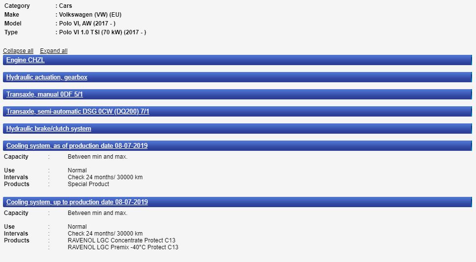

Re: What is "G13 PLUS+" Coolant???
I read the owner's manual and it says my Polo should come with G12 evo coolant from the factory, as shown below:
Can someone also check their owner's manual and expansion tank label as well, and tell me if it says "G13" or "G12 evo"?
According to the Ravenol website VW Polo factory changed over from G13 to some other coolant on the 08-July-2019, as shown below:
(My Polo is assembled on the 24-AUG-2019 in South Africa.)
But on the expansion tank of my car, it says G13:
I am a bit confuse on which coolant is filled into my car.Can someone also check their owner's manual and expansion tank label as well, and tell me if it says "G13" or "G12 evo"?
My tank says G13 as well. Took delivery of car in May 2019.
