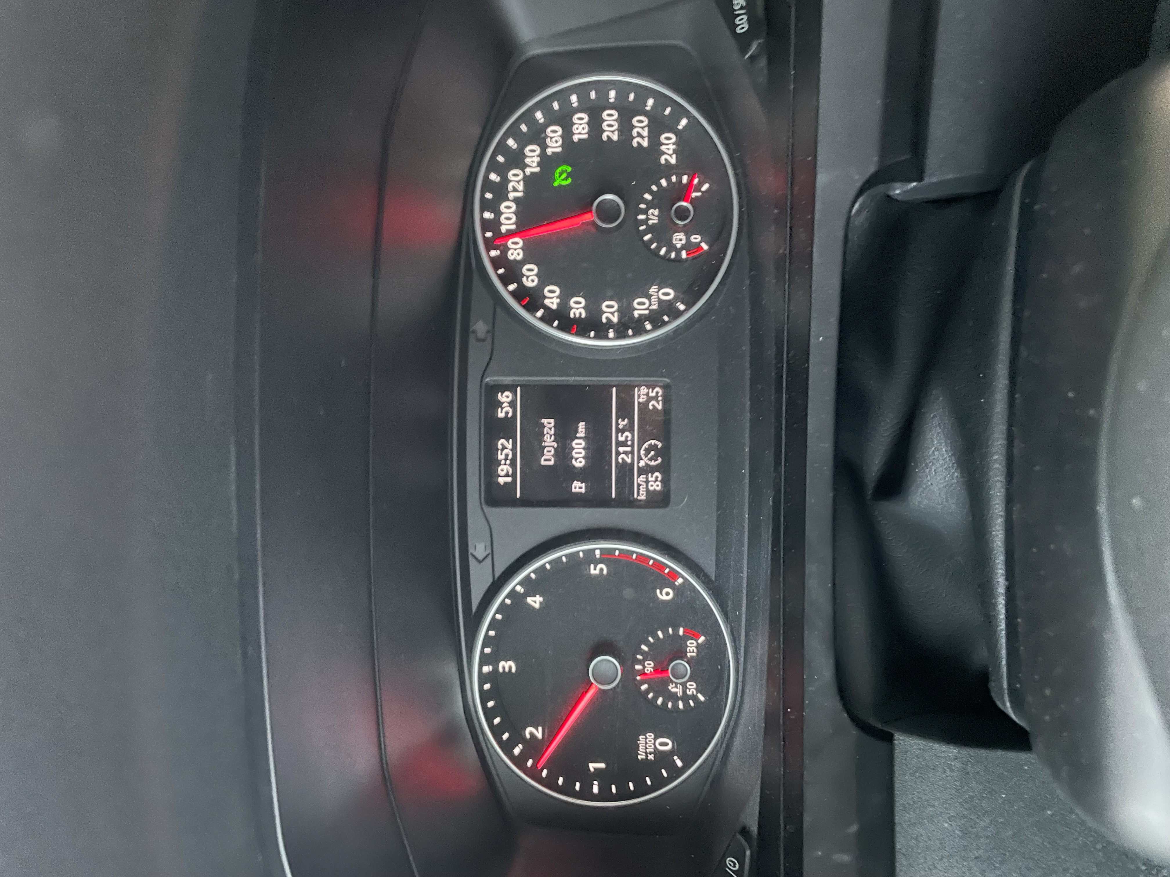

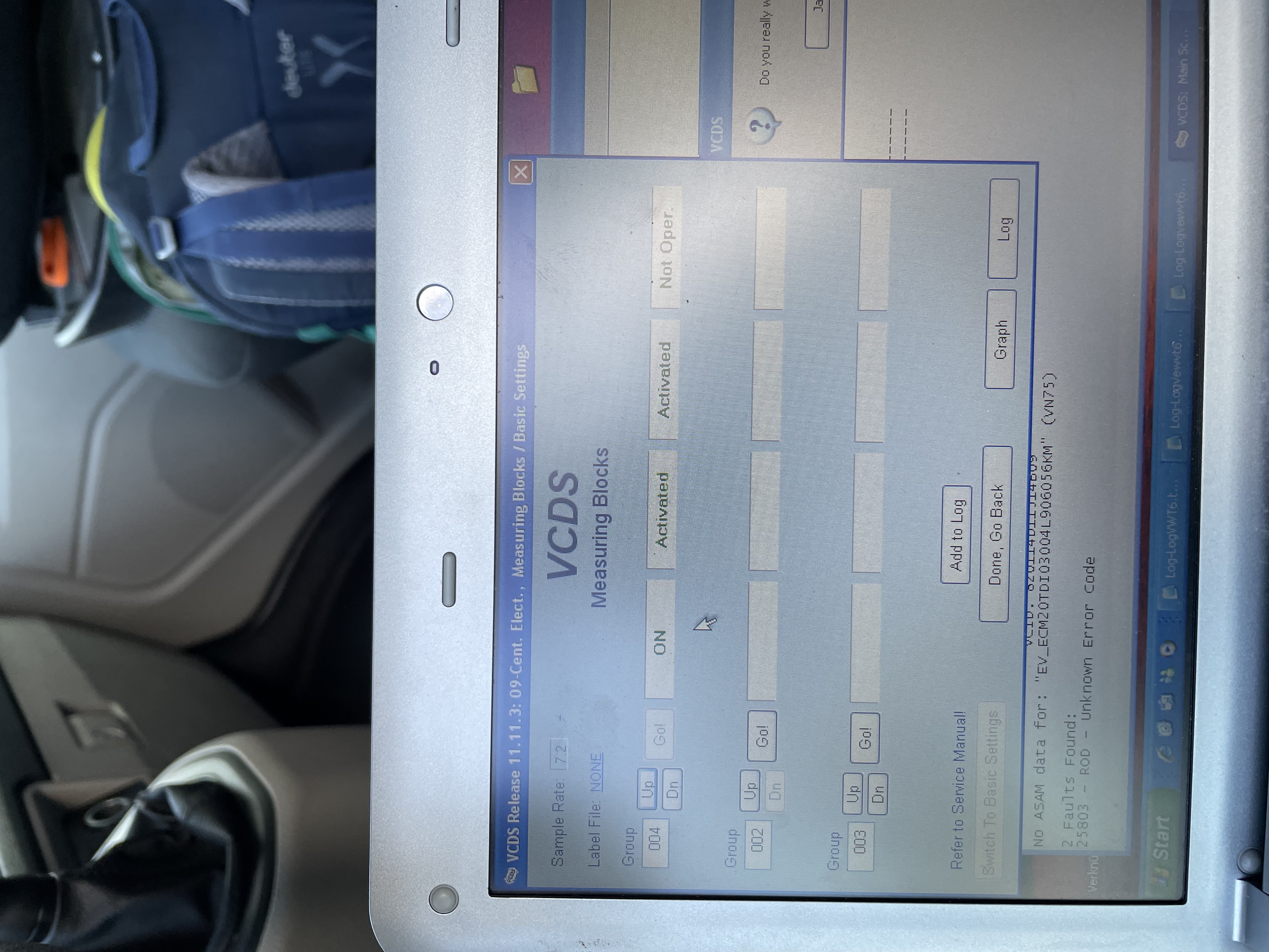

Hello guys, I'm not the owner of Polo, but solving similar problem with my T6 and retrofitting cruise control. I have these two faults.
I cant use CC.. No led on dashboard.. No working CC but vcds in 09 - measuring blocks, group 4, i can see on/off, activated /not oper, and so on...
Do you have some tips? Thanks a lot.

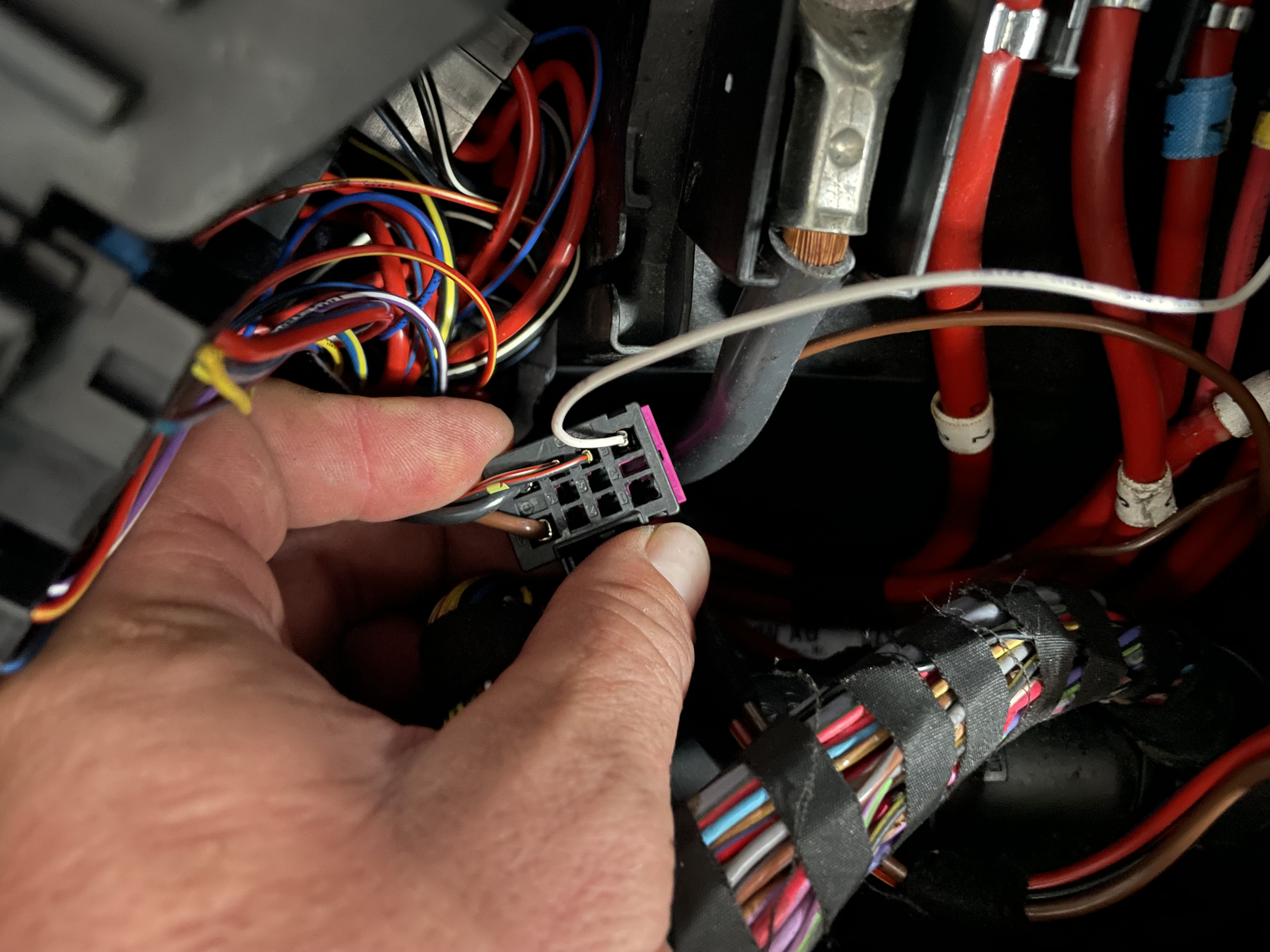

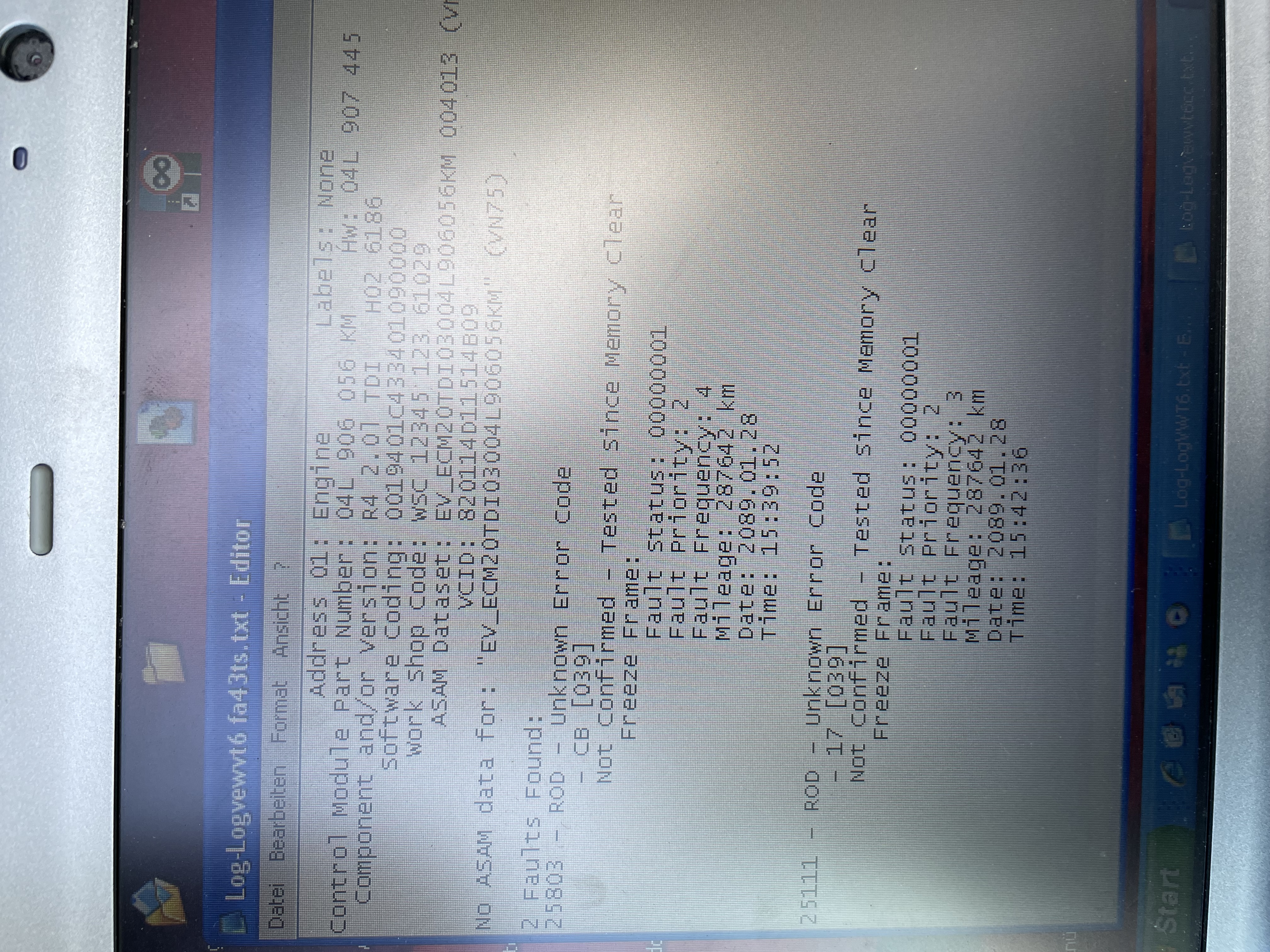

The coding in the ECU is correct and from what you comment also in the BCM.
Please post a full autoscan so we can help you.
Tell us the engine code to look at the diagrams, it is together with the production codes in the sticker in the maintenance book.
It is possible that the terminal that you have to pin to the ECU connector is not installed correctly, or that to activate the CCS on your T6 an online activation is necessary.

Re: VW Transporter T5.1 CC retrofit
Thank you!
When I read that the fault could be in the ecu wire, it flashed in my head that this single wire was pinned by my friend.
I found that the wire was not in the pin one but in the pin three.
Fixed and it works!!
Thanks!
Thank you!
Thanks!
