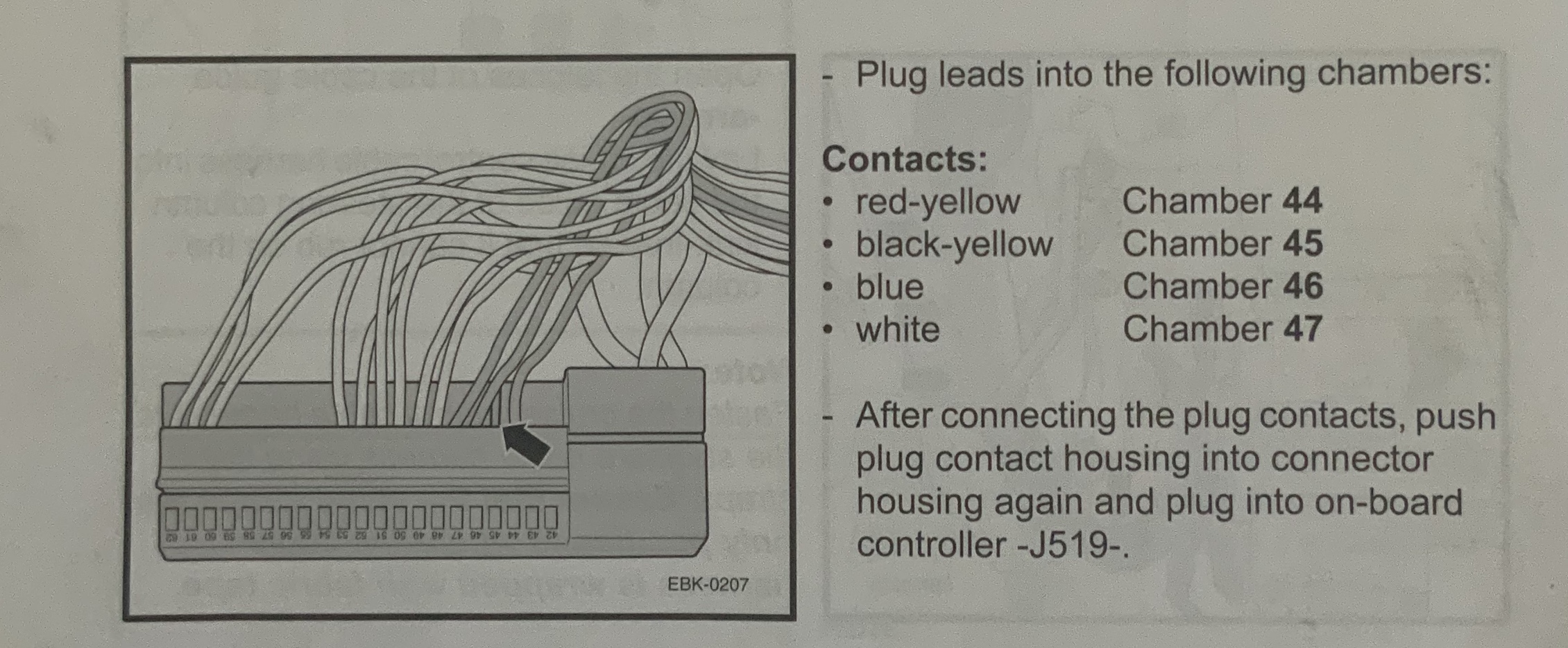

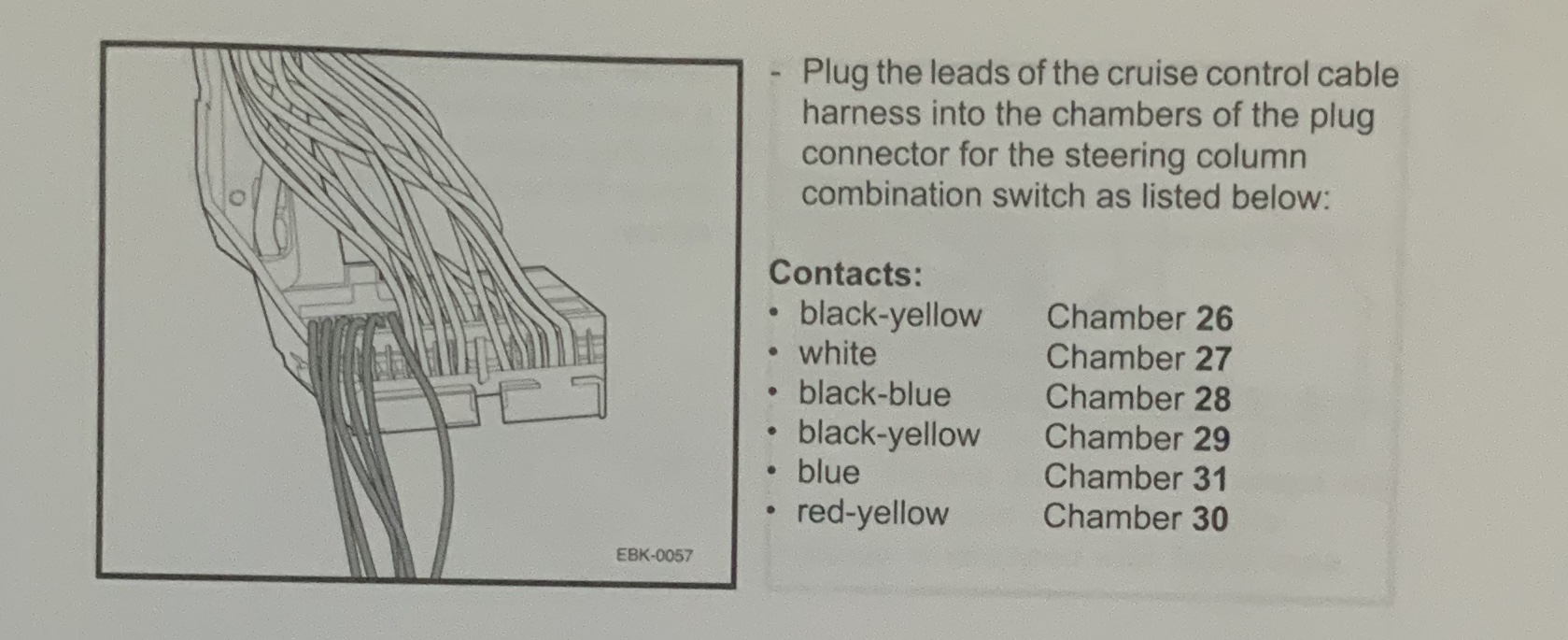

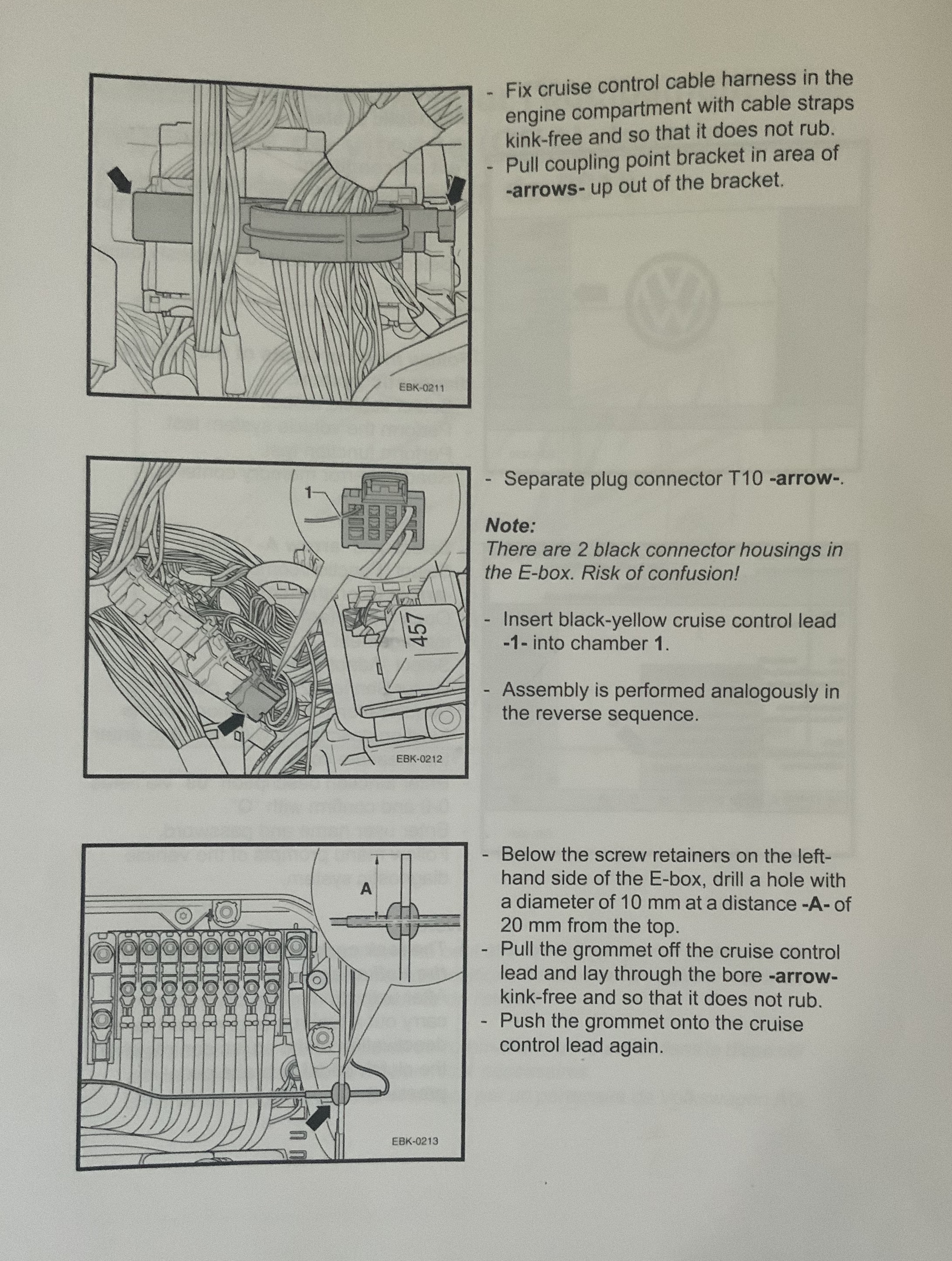

Hello, I have installed a cruise control system to my transport 2013, I connected all the wires, then activated cruise control system throw VCDS, but I get 2 errors
- Posts: 6695
Re: VW Transporter T5.1 CC retrofit
Please post a full scan and describe precisely how you wired the system
- Shadow109
- Posts: 154
- Joined: Sun Aug 16, 2020 2:59 pm
- Drives: Vw t5.1 2013
- Location: Israel

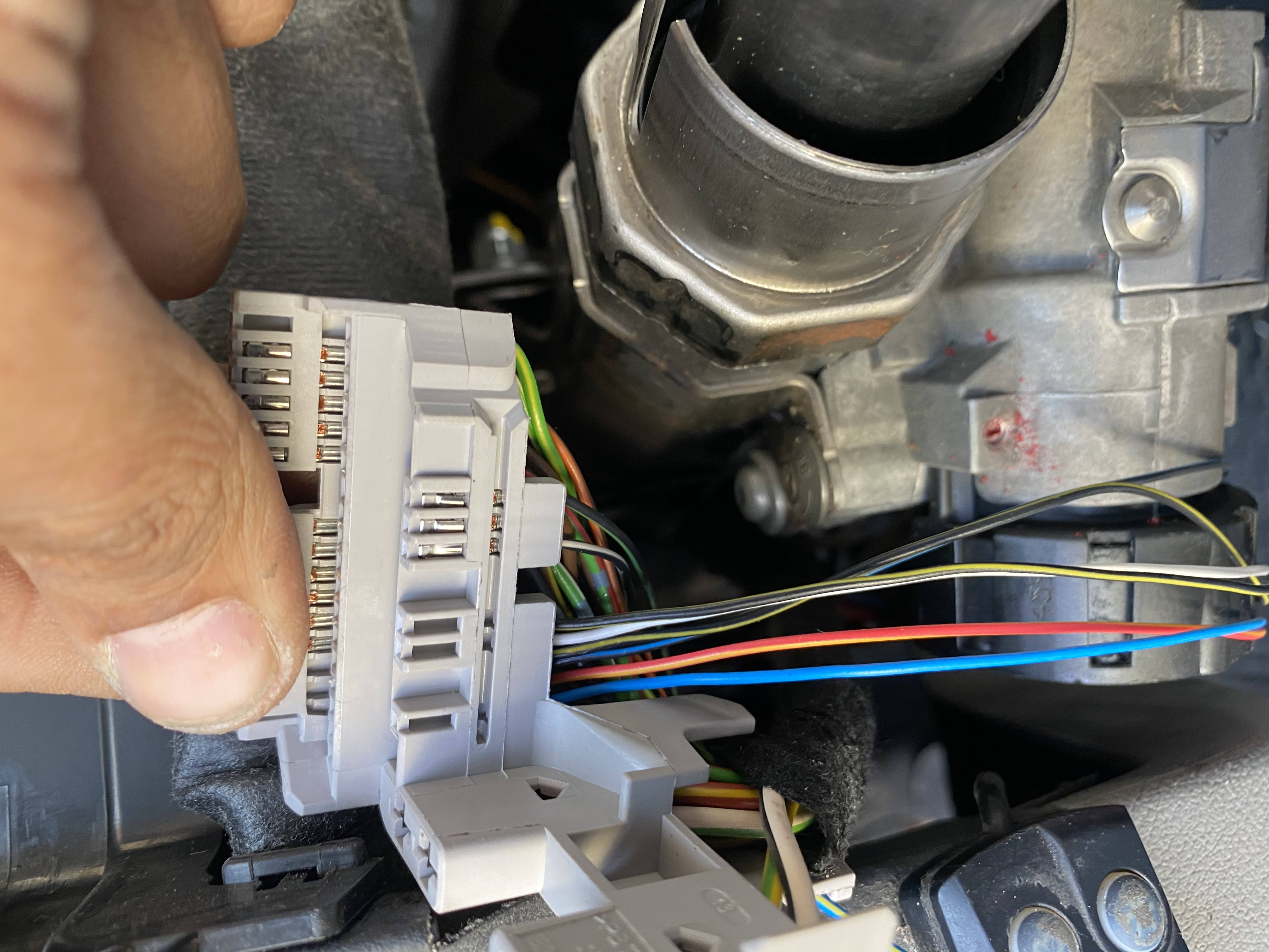

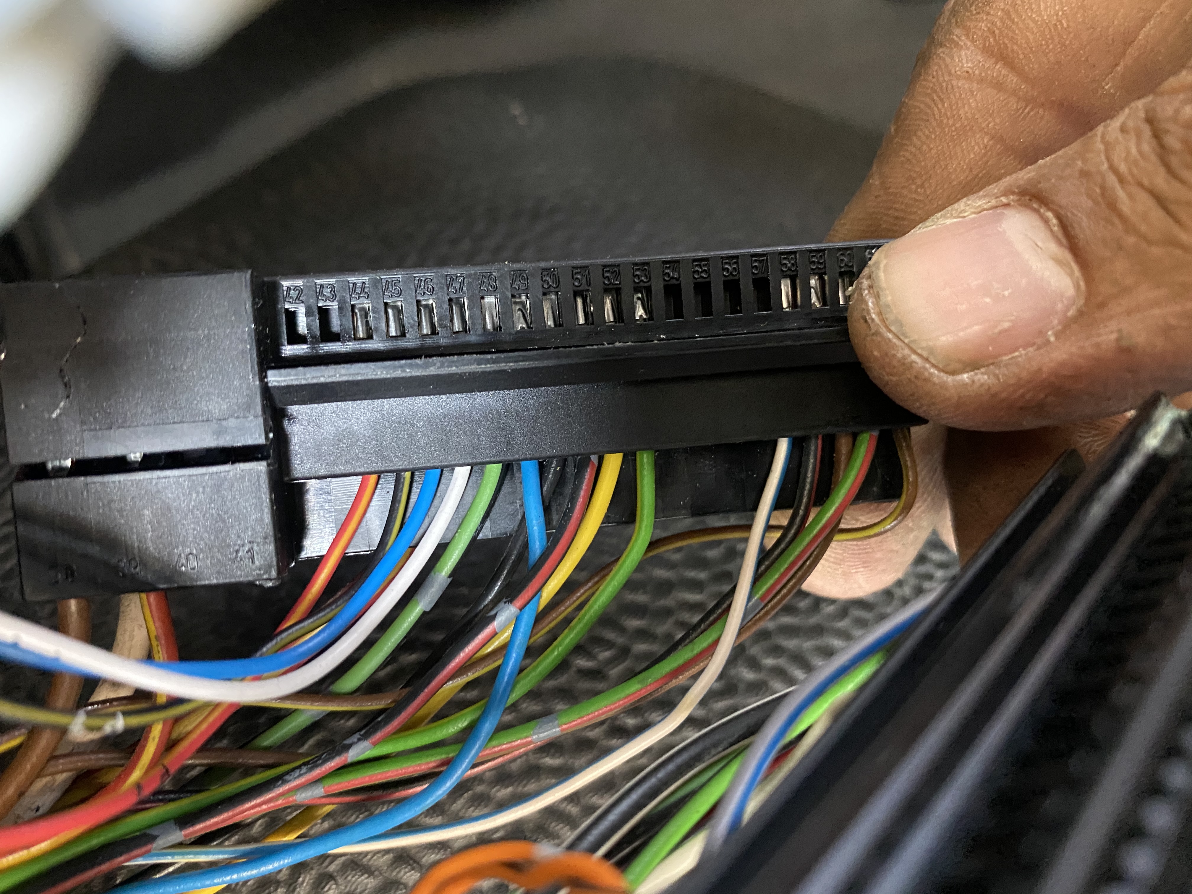

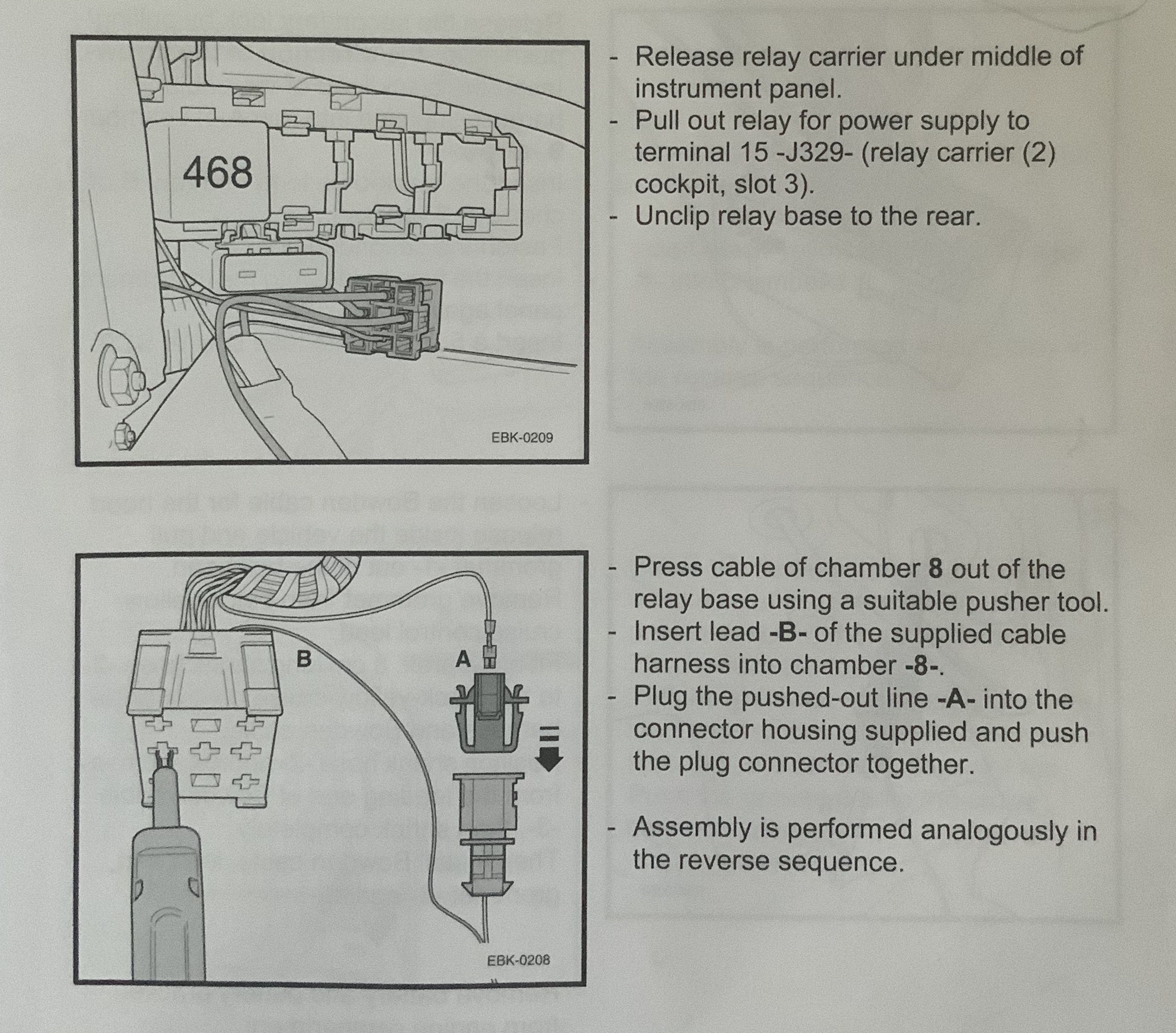

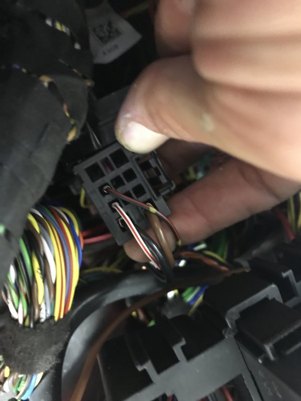

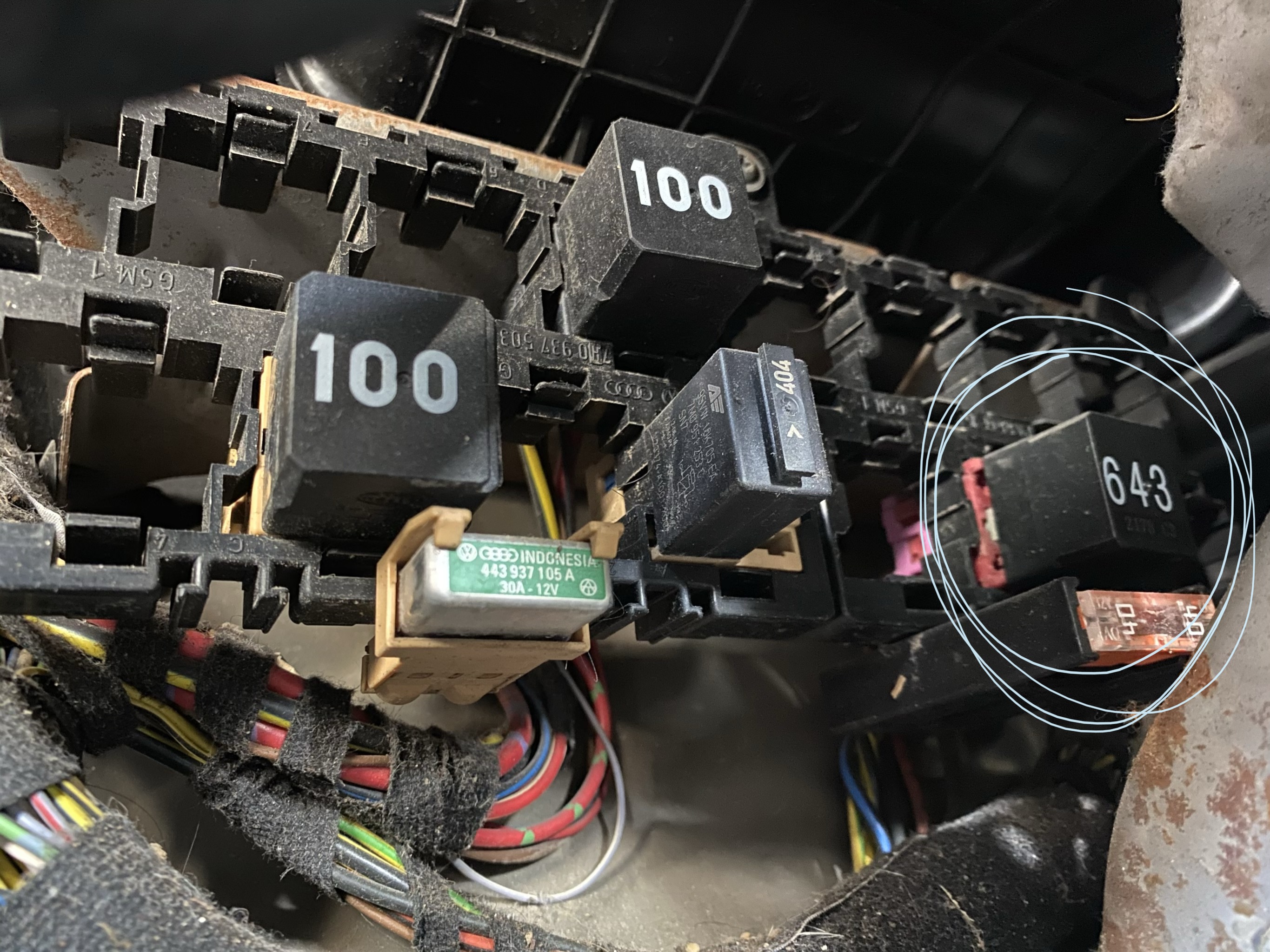

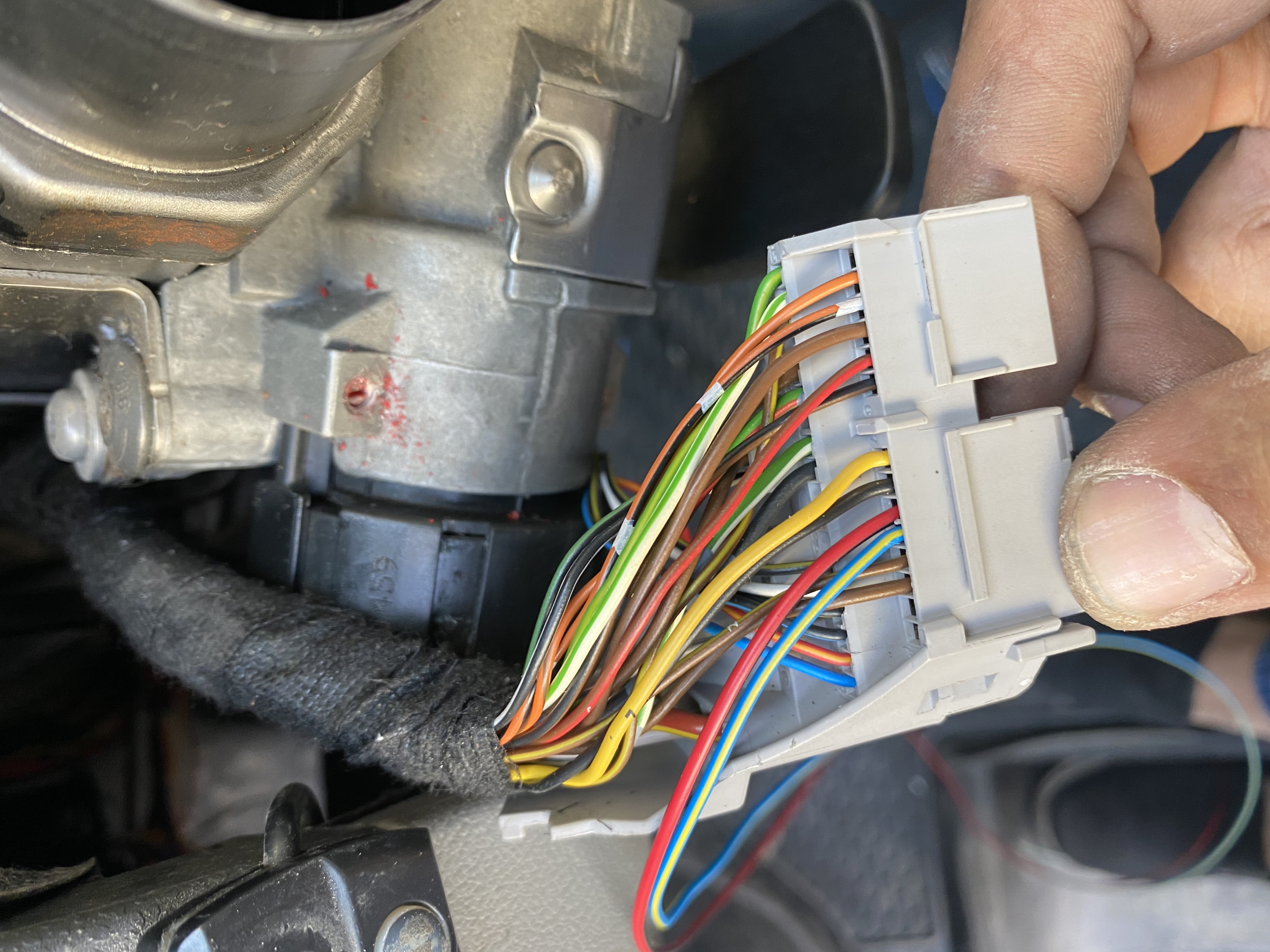

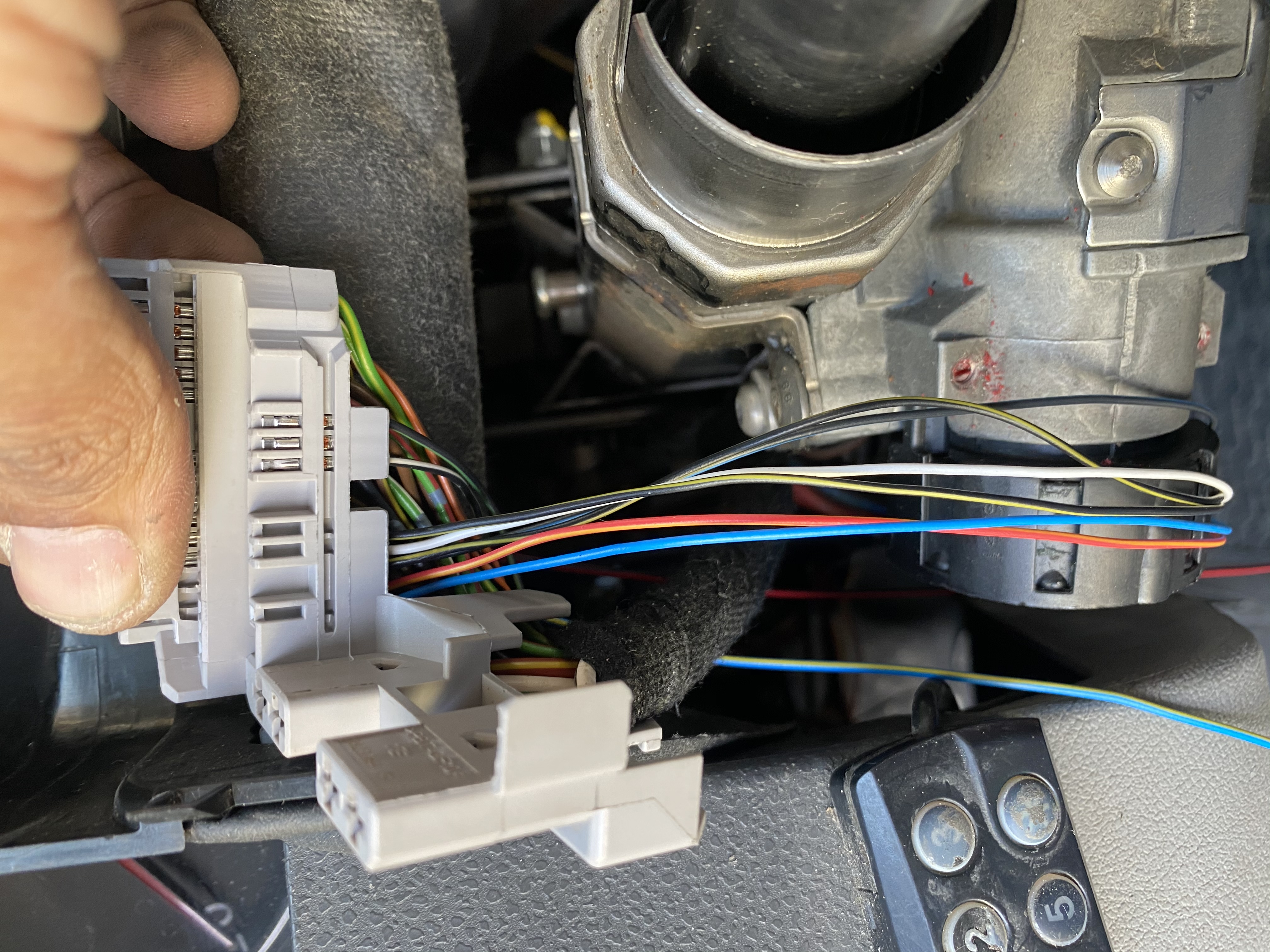

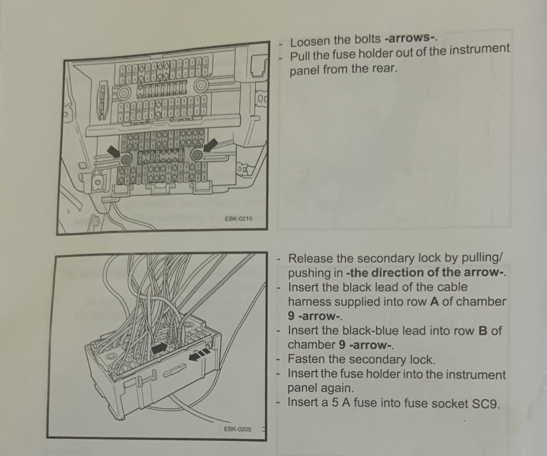

1. I have connected 6 wires to the steering connector
2. 4 wires to the white bcm connector
3. 1 wire to the relay as described
4. 2 wires to the fuse box
Then I put a 5 amp fuse there
5. The final wire was to the E-box under the battery
I will post a full scan later
- 370B4F5E-E0F6-4F5E-96CD-44EDE201D56E.jpeg (728.98 KiB) Viewed 7960 times
- Posts: 6695
I think I found the mistake. 28 and 29 are switched
- Shadow109
- Posts: 154
- Location: Israel
I have noticed this after I wired, then switched them back
I am not sure about the wire in the e-box
- Posts: 6695
Yes it is indeed possible the wire to the e-box is wrong

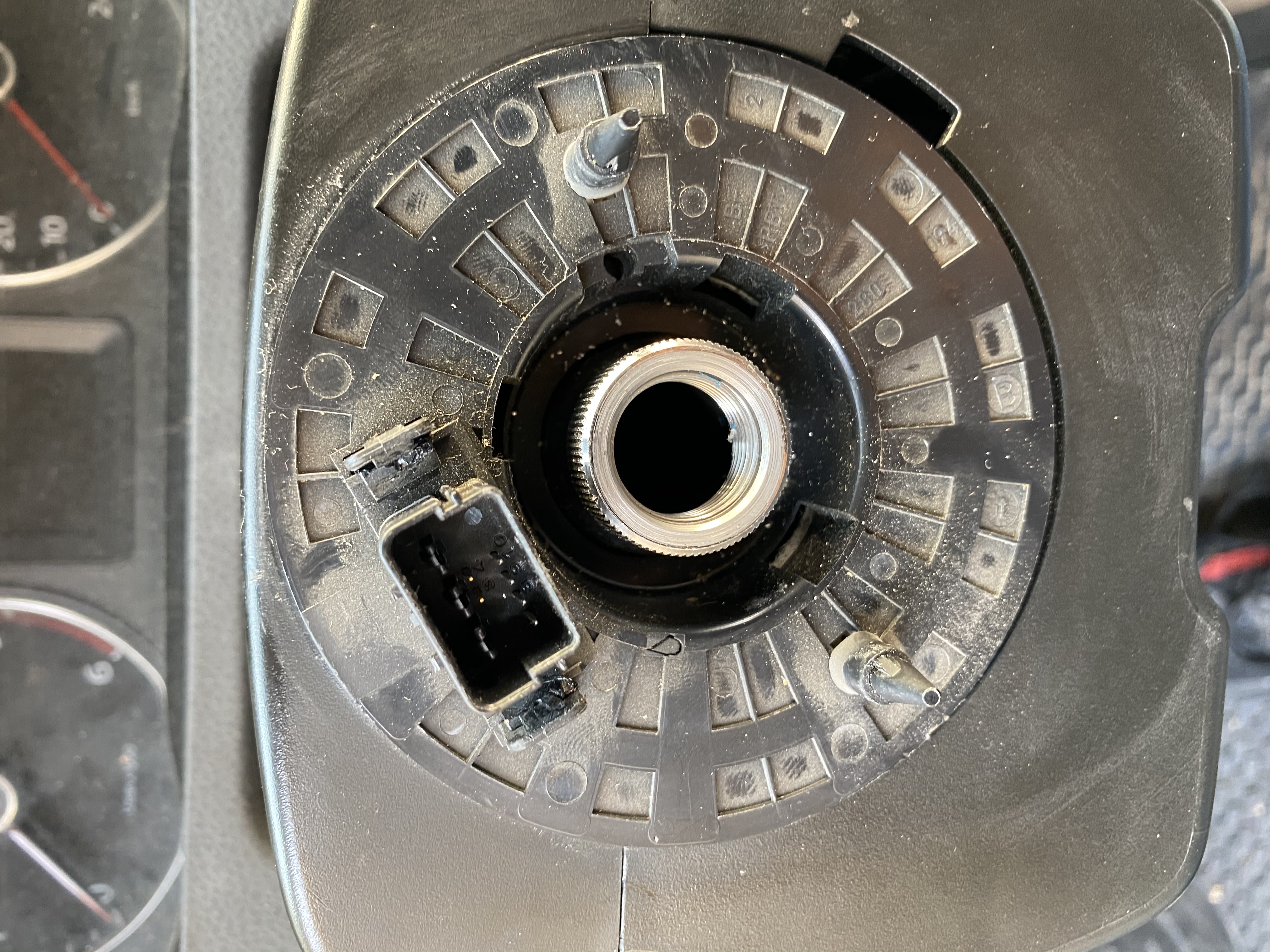

I forgem to mention I have broke this part
Tomorrow I will replace it
- Posts: 6695
I would recommend to check the wiring to the ECU/E-Box.
- Shadow109
- Posts: 154
- Location: Israel
Thanks iichel, all the wiring was good, 1 issue was fixed by vsdc, and the other has disappeared when I disconnect and reconnect the stalk connector

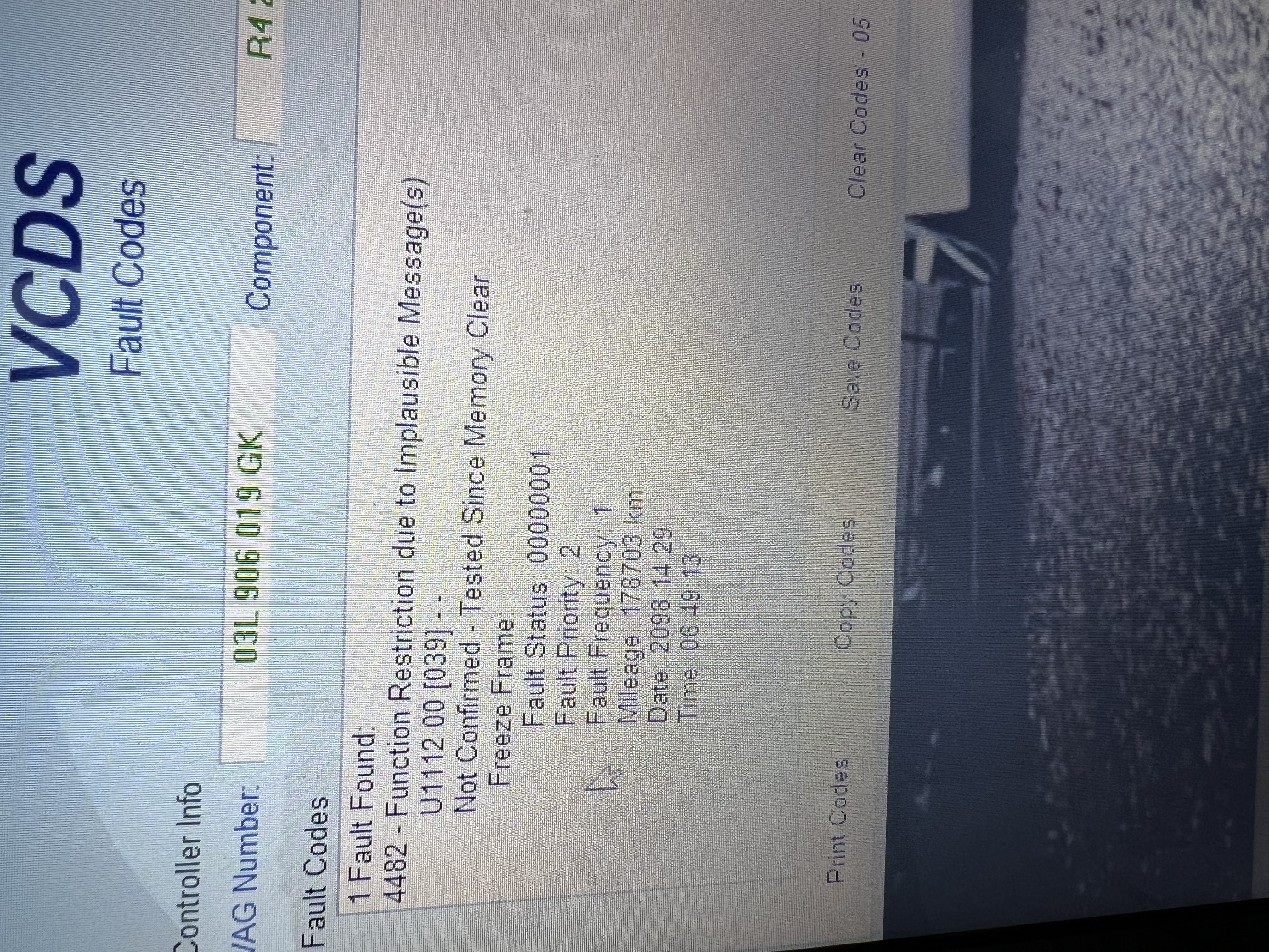

Just did the install, got this error.
- E374583F-891F-4D32-96E1-EAFF36D904B7.jpeg (5.11 MiB) Viewed 6234 times
- 1B3FA874-DBD4-49BC-9291-1EBC77349E3F.jpeg (2.55 MiB) Viewed 6234 times

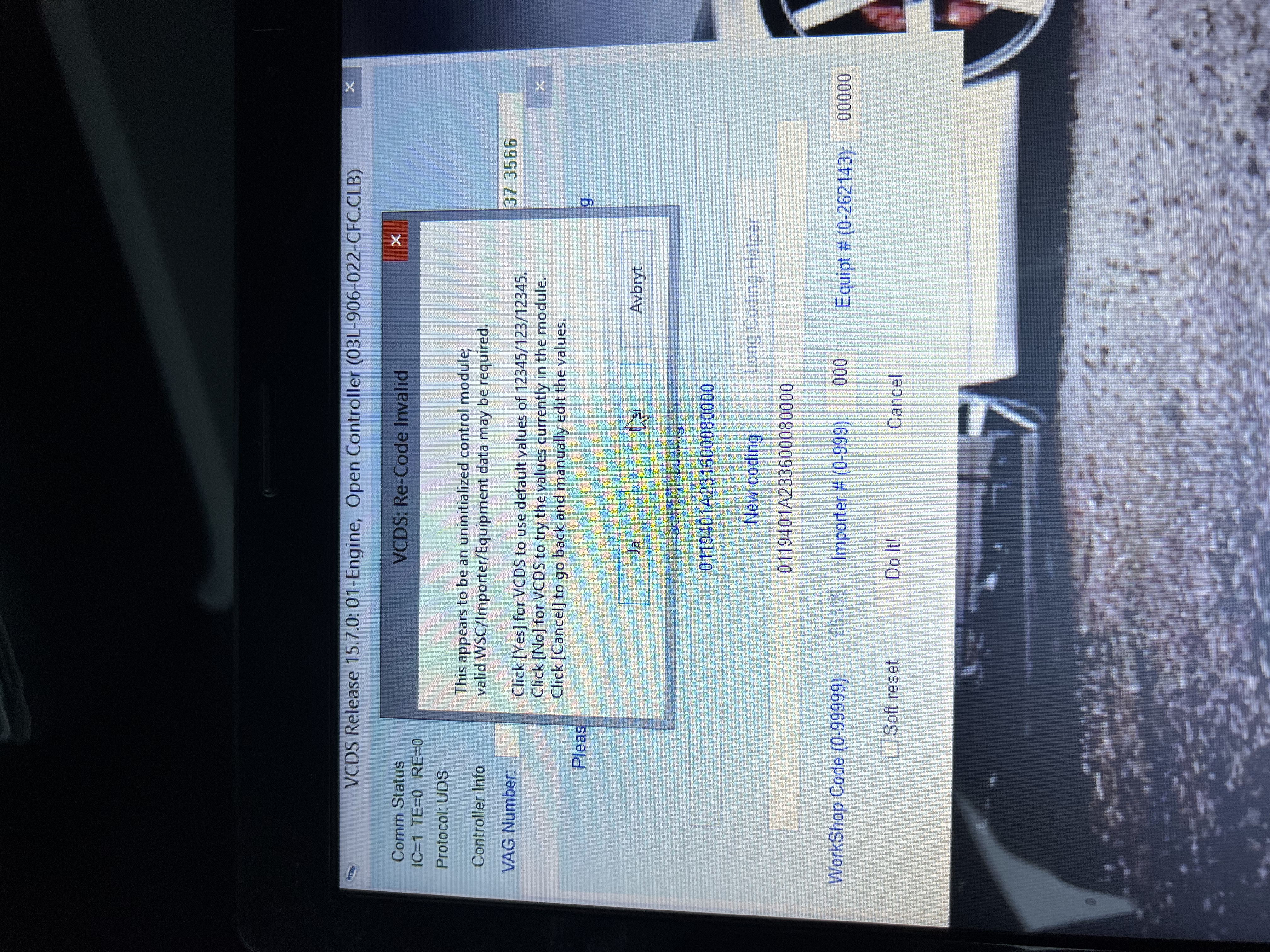

What coding did you make ?
Can you post an autoscan
Bcm byte 17 bit 7
Engine byte 5 bit 5
Thats all i have done.
Will try to post a scan tomorrow, comp is at work.
Engine byte 5 bit 5
- A20A0296-E0F4-4B9F-BDDD-B9EF71129AE2.jpeg (6.1 MiB) Viewed 6177 times
I think it was coding, post an autocsan so we could help you
