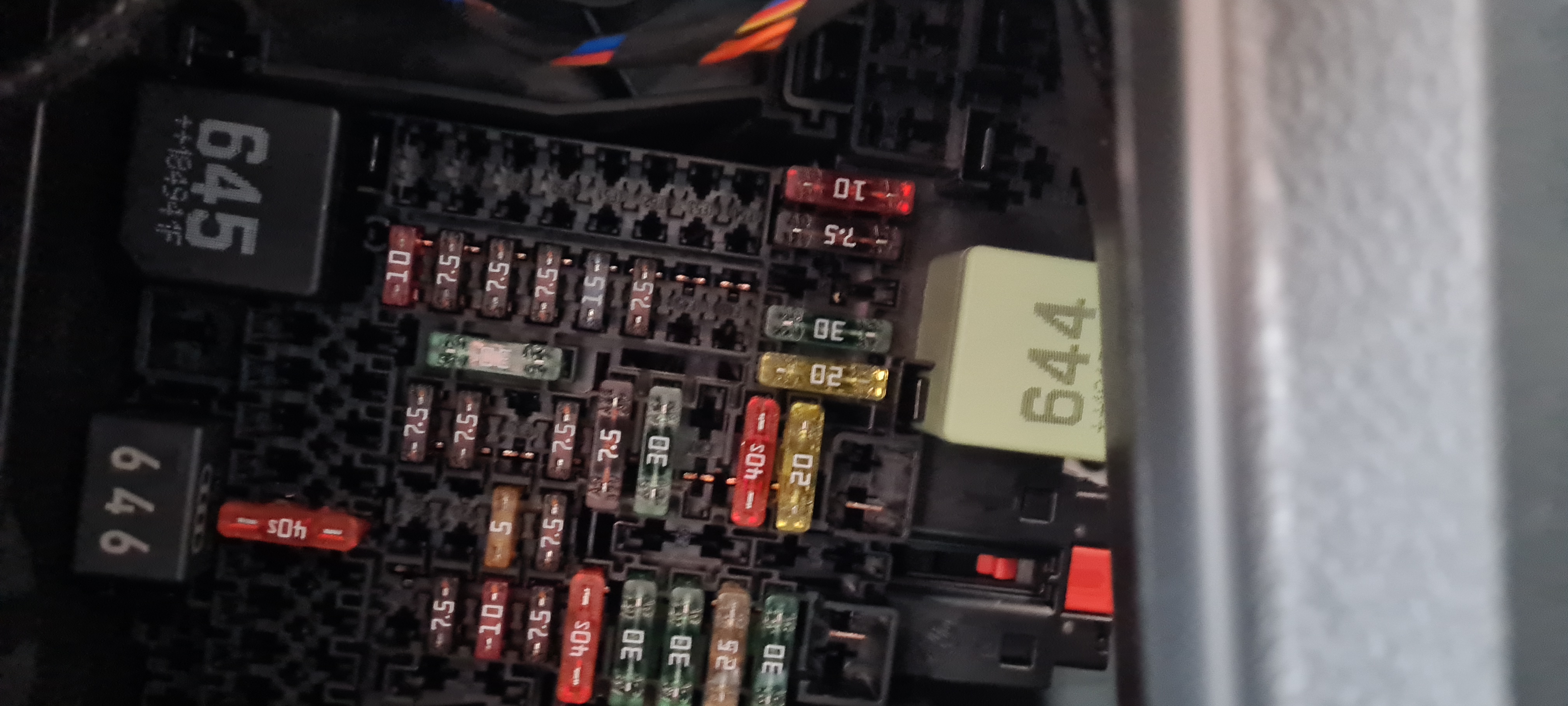

It was the fuse, but not the one in slot 43. It's the 7.5A fuse in the bottom right of the fuse box.
I'll change it and test when the temperature gets above 0⁰C.

Hello fellow Polo users! Spent several hours scouring the internet for information about my fuse box until I stumbled across this forum. I replaced the 7.5 fuse (which had blown) in the bottom right of the most recent picture but the washers still didn't work.
I took out the newly installed fuse to find the brand new one had also blown.

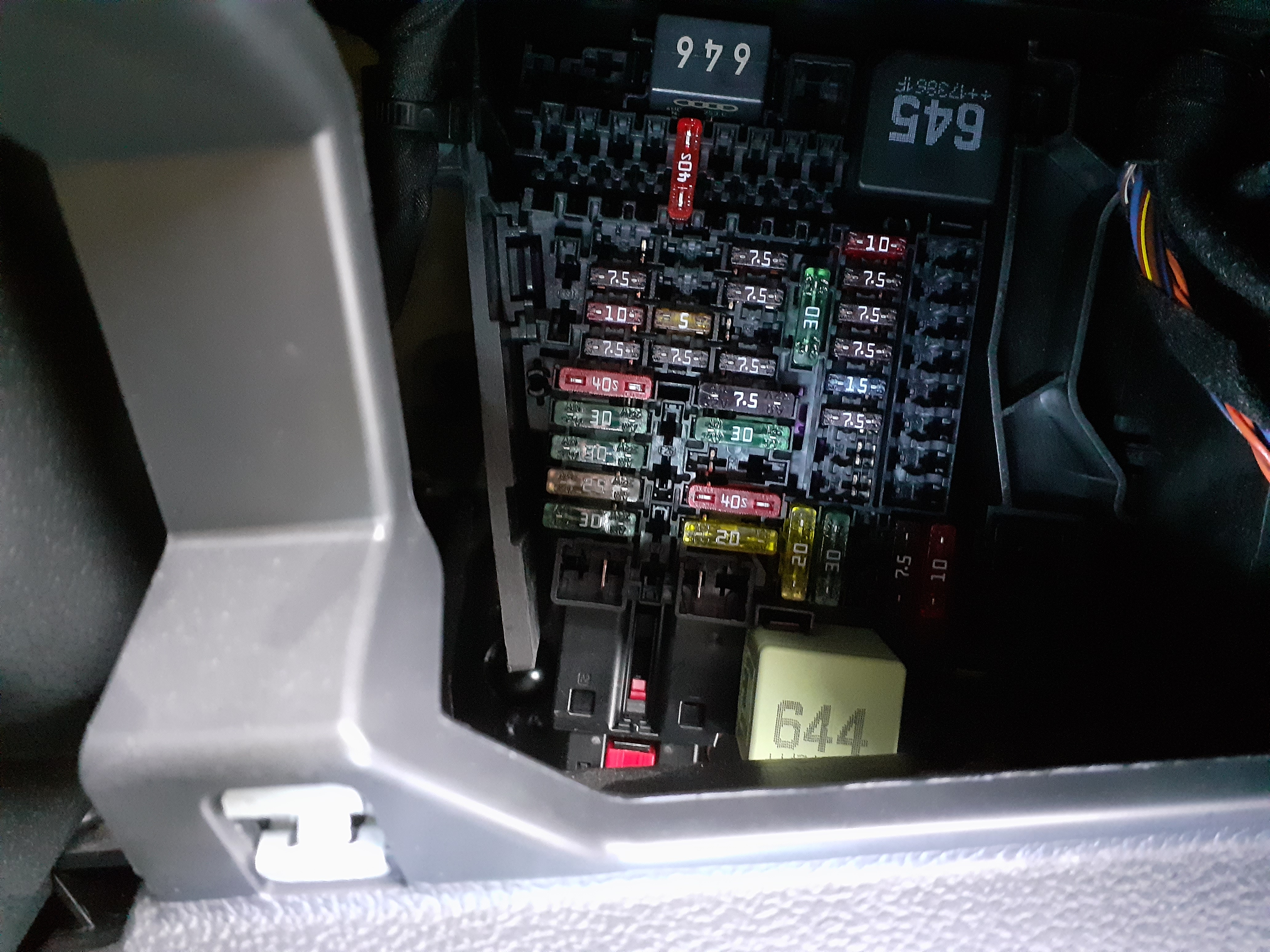

The fuse for the screen washer pump is F58 (7.5A) See layout drawing in the Polo Owners Manual. This information is missing from the Manual! My screen washer pump froze over the recent cold spell here in the UK, and blew the fuse! Just replaced it. Everything is fine now. Fuse is the 2nd one in from the bottom righthand side corner on my attached photo.
