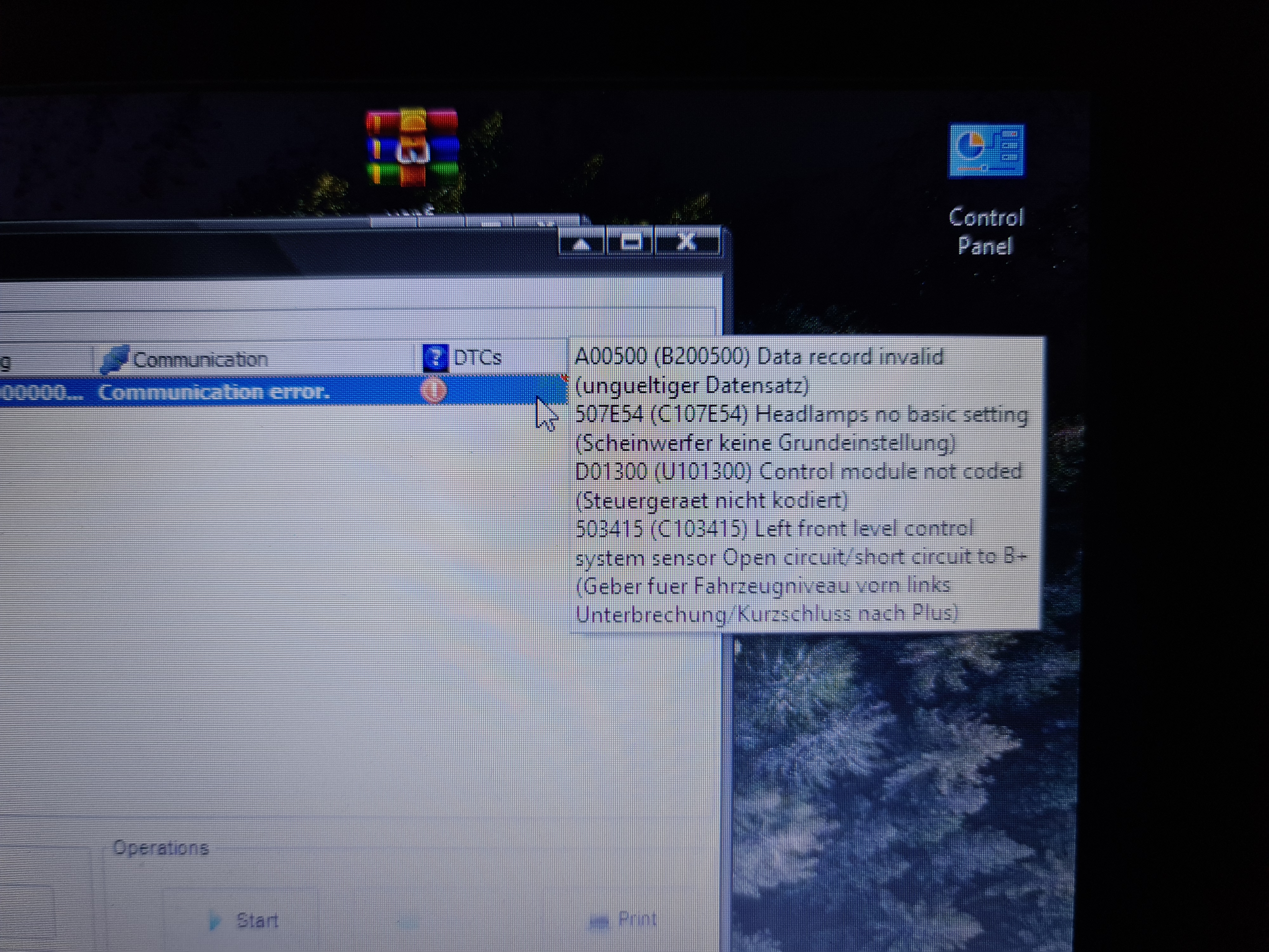

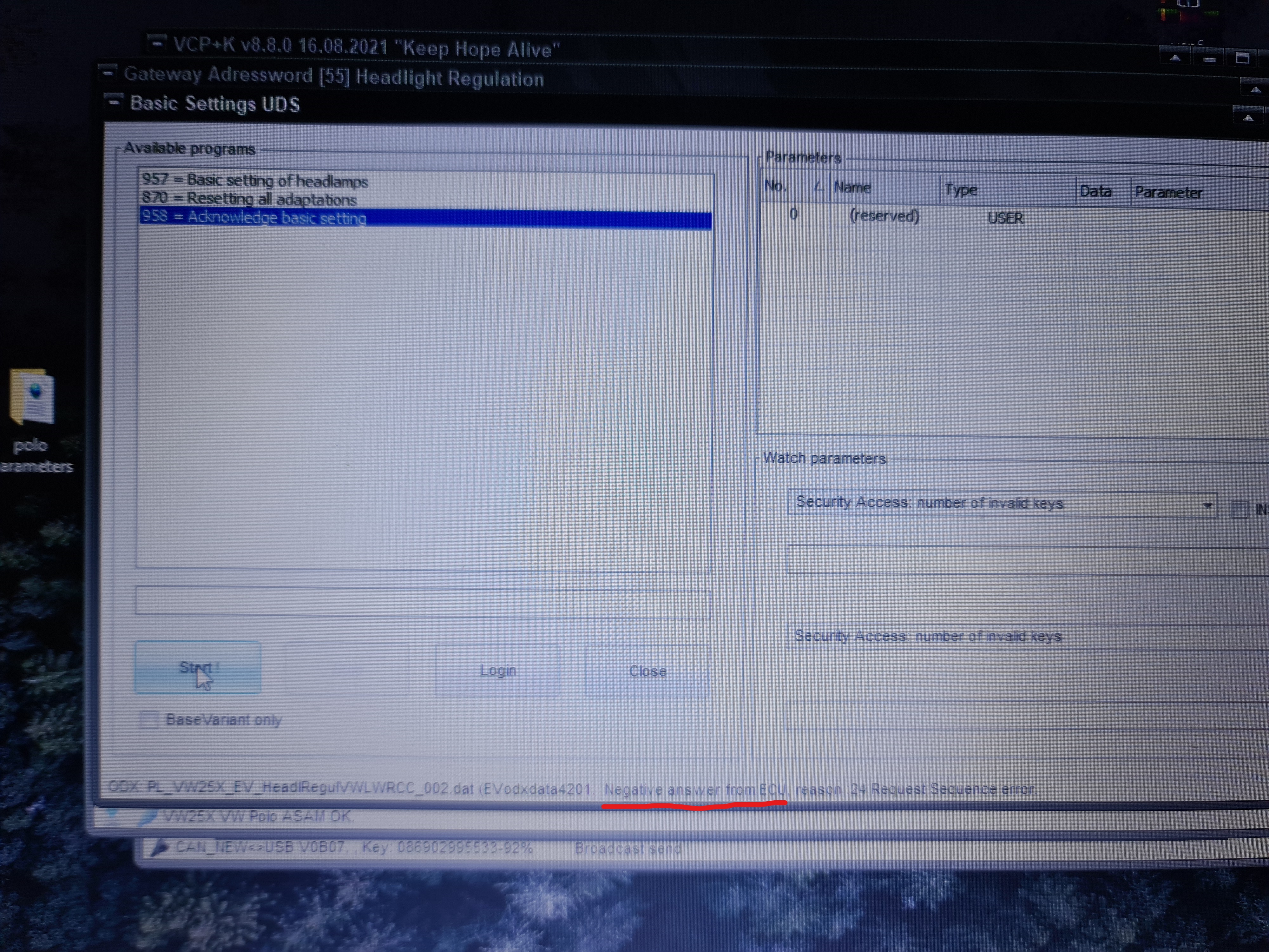

Hello guys,
I have a very big problem finishing my upgrade with the headlights....
After i retrofit the AFS system, make the adapters for LED Headlighs, parameterized the BCM with original VCP, and here comes the problems:
- I don't have front parking lights at all ( maybe the problem is in the module for day driving lights )
- dipped beam are flashing from time to time
- on IC got the Adaptive front lighting system (AFS) failure" error message and flashing yellow lamp
When i make a scan for DTC'S with VCP i get this:
When i try to do the basic settings for the headlights i get this:
And for the coding of the module, i really need help here:

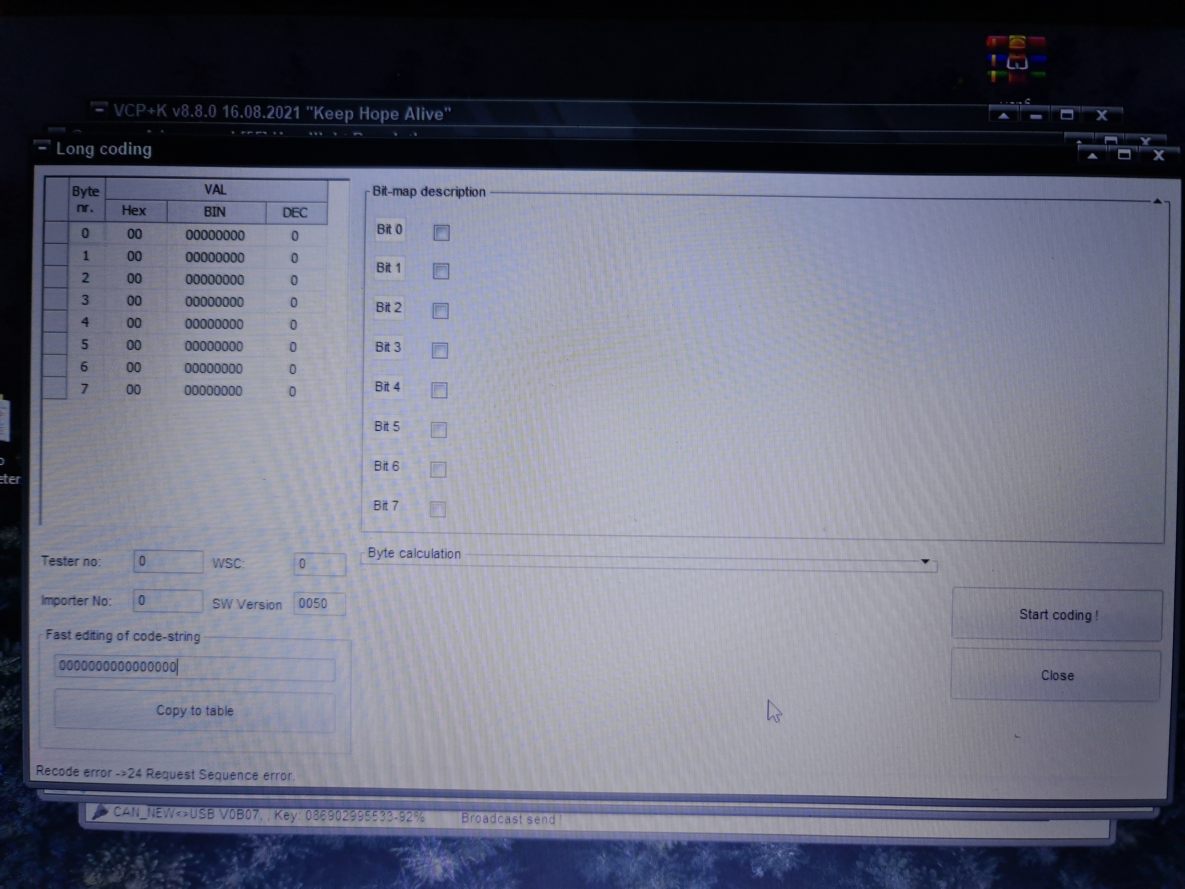

Still no results, when i try to code the module with 0112000001000000 it refused..

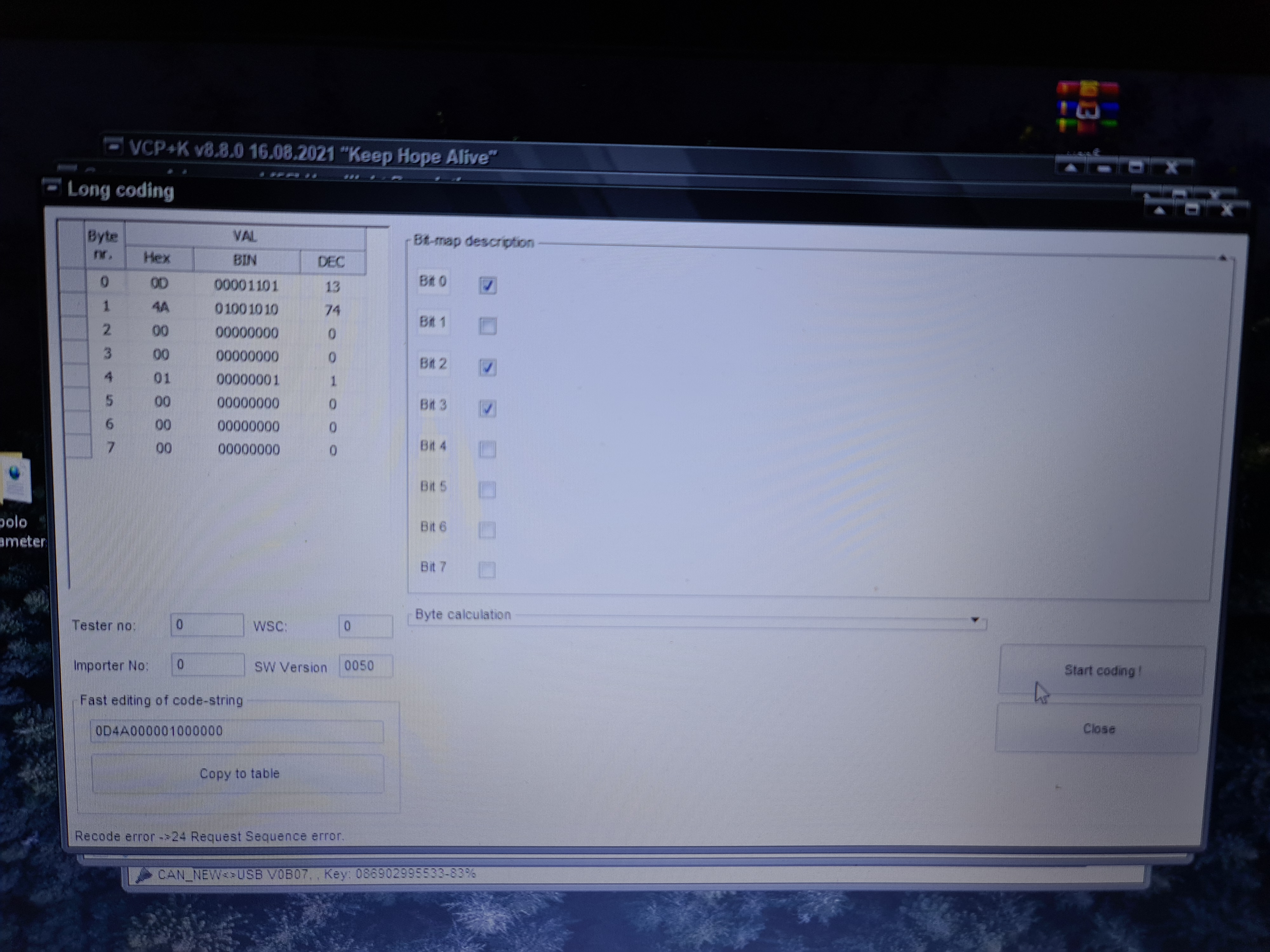

Try this coding: 0D4A000001000000

I always get this message: Recode error - 24 Request sequence error. I am not really sure where is the problem - the coding, the headlight range module (which is brand new), the rear axle sensor (which is used and it is from polo), or i dont know what happening, but cannot finish my project for HBA until i solve this mystery with the LED headlights

Hello ciclo,
I already did this, and get rid of that error, but still can't code the module, and do the basic settings and got flashing low beam, and no front parking lights at all
