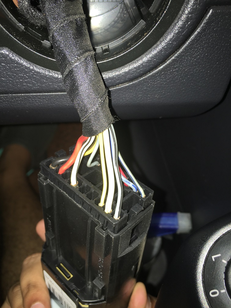

Re: Polo 6R auto light & rain/light sensor kit + retrofit harness, 140 €
Hi iichel and Ciclo,
I am about to purchase the automatic headlight harness and the auto headlight switch from Patrik. Just wanted some help from you'll to understand if it would fit my car or if I would need to do some alteration to it, I know iichel has already confirmed that it shouldn't be an issue, but I have some more details to share regarding my 6R's hardware which weren't known to me prior to my initial query.
It's an MY21 model, Dec 2020 Production date.
VIN: MEXM20609MT11XXXX
BCM Headlight Switch Relay Carrier (I couldn't get the right side dashboard panel to open, so i tried to make a video from the headlight switch's location)
[youtube]https://youtube.com/shorts/9c-cTFzbJLY[/youtube]
Also, I have got the RLS sensor and Auto dimming mirror installed from the factory. Unfortunately, I don't have a VCDS cable with me to provide the log.
Many Thanks,
Sanket
Many Thanks,
Sanket
- Posts: 6687
Wiring compatibility:
- For 6R models with BCM Max from factory.
Your car does not meet this requirement
