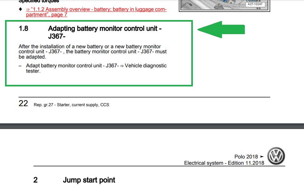

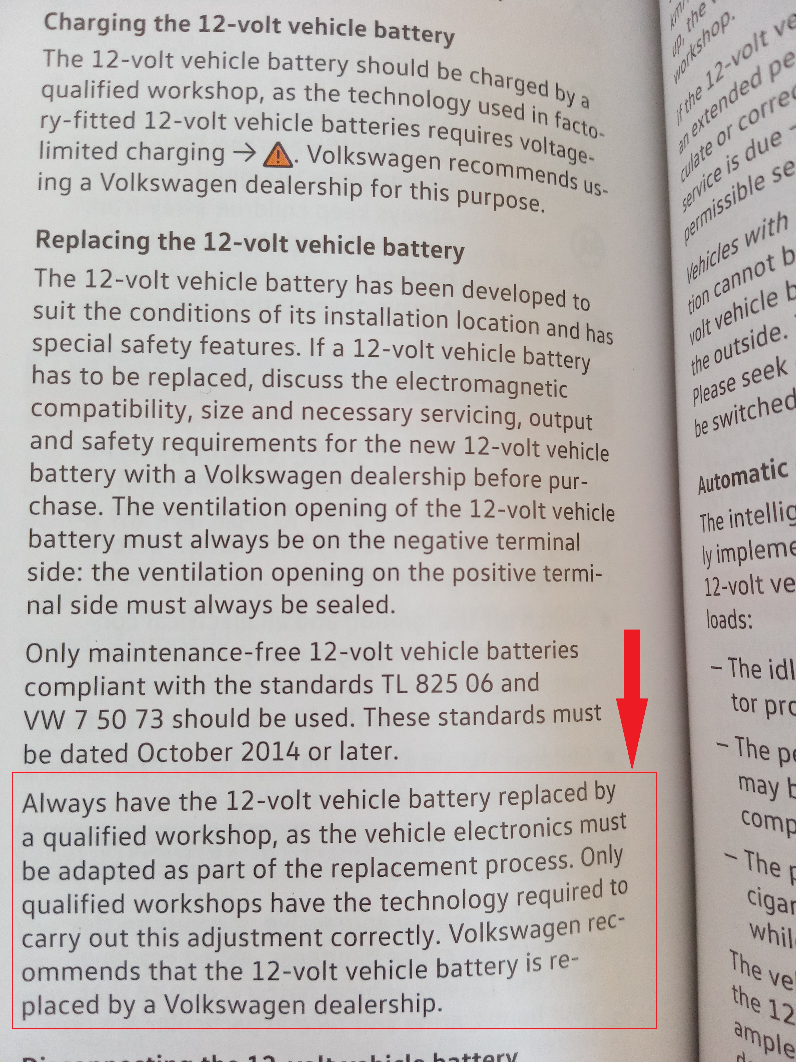

According to the "Owner's Manual" and the "Workshop Repair Manual" you need to input the new battery's details into the computer.
Extract from the Owner's Manual:
Extract from the Workshop Repair Manual:
