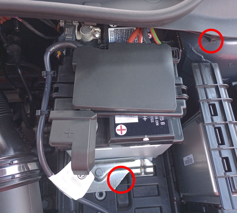

Thanks for the info. Please see the attached photo, would either of the areas circled in red be suitable? Thanks.

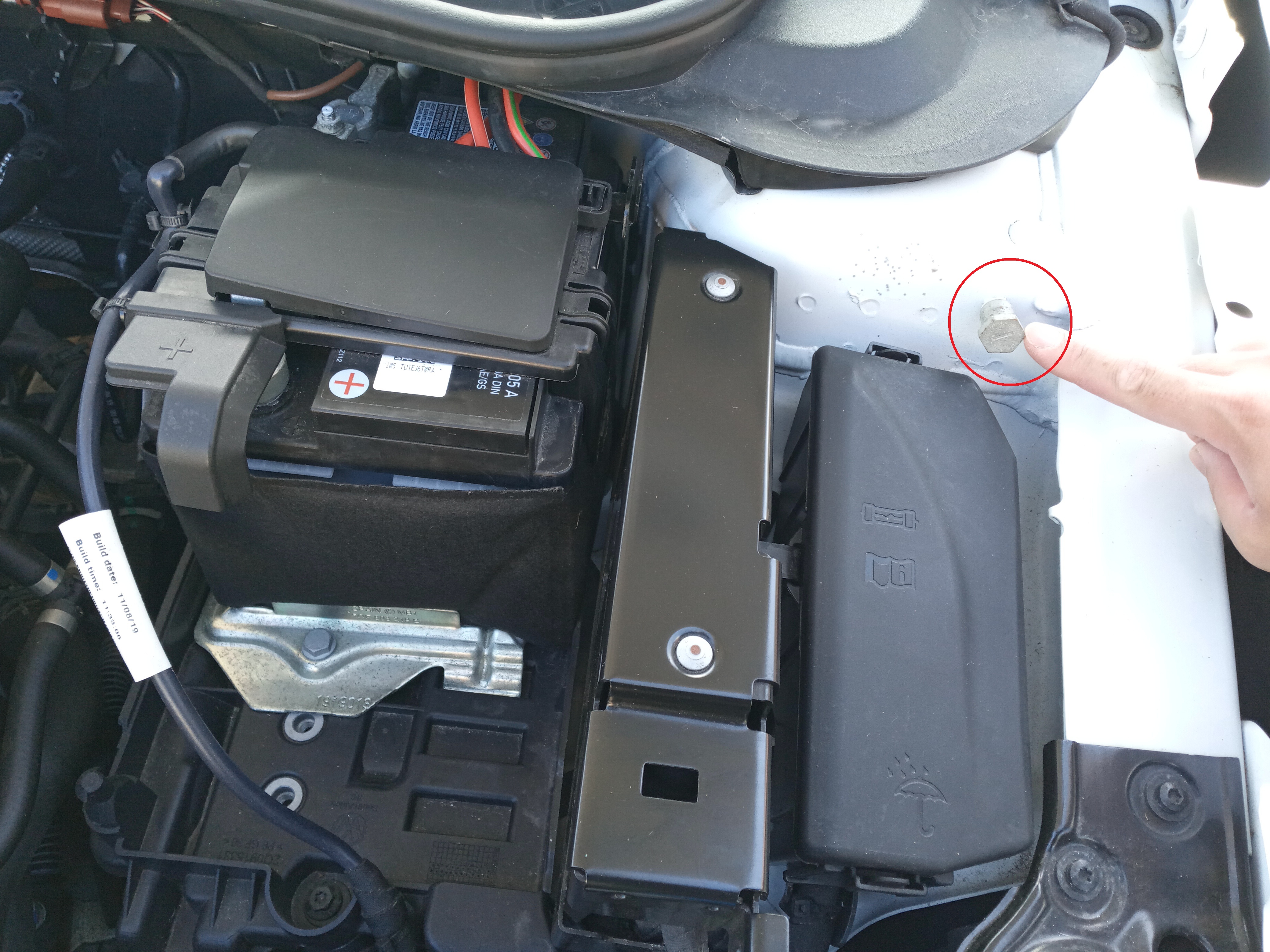

Re: Battery charging for stop-start engine question
I use this as the negative terminal when charging the battery:
(Note: My Polo built by the factory without Start & Stop System.)
- Posts: 6090
Good to see that VW are fitting that "-VE" or chassis point to cars, perfect for charging and jump starting - which will be why they fitted it.ho8882000 wrote: Tue Aug 17, 2021 12:13 pm I use this as the negative terminal when charging the battery:
Edit:- I looks like from both pictures that access to the local earth or chassis point that the battery -VE connects to, is not easily accessed - so providing that "service" chassis stud was essential.

No, the metal hold down clamp for the battery screws into a metal captive nut in a plastic tray - so no chassis connection.jhn34225 wrote: Tue Aug 17, 2021 11:32 am Thanks for the info. Please see the attached photo, would either of the areas circled in red be suitable? Thanks.
The other point does not look too good either, does your car not have the large -VE chassis "service" stud?
Thanks for all of your help, yes the car has a service stud so I'll use that.
