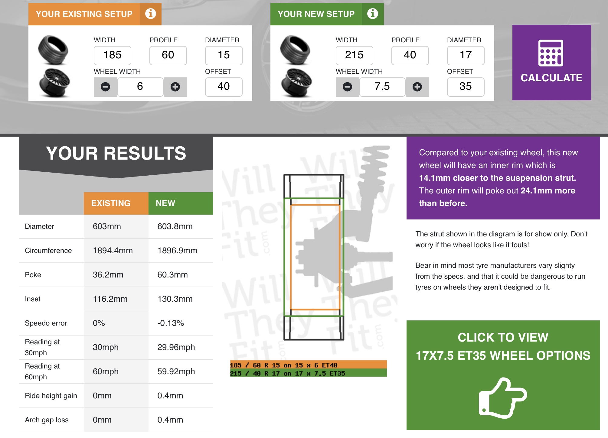

Rimstyle have a good reputation, so I wouldn’t have a problem buying alloys from them.
I just now clicked on the link you posted to the Romac Radium 17” Gloss Black alloys you’re thinking of getting and they currently only have the Gloss Black version in 18” (unless they did have a set in 17” and you’ve just bought them 🙂). Rimstyle should supply everything you need in their fitting kit to fit the wheels on your car. I don’t think locking wheel bolts will be included in the fitting kit - you might want to check with Rimstyle. I’m sure they could supply a set with the correct bolt profile.
Looking at the picture you posted up of your car, I think your existing wheels are actually 15” and not 14” - the tyre size is visible on the bottom of the sidewall in the picture and looks as if it’s a 185/60 R15 tyre (R15 would mean the wheels are 15”). If so, then your current alloys are either VW ‘Castille’ or ‘Riverside’ alloys; both are (I think) 6Jx15 ET40. Assuming this is the correct size, I’ve put the details of your existing wheel/tyre set up and the Romac Radium alloys (7.5Jx17 ET35 with 215/40 R17 tyres) you’re thinking of buying into the calculator on www.willtheyfit.com - screenshot below;
Note that compared to your existing wheels, the outer face of the new wheels will protrude outwards an extra 24.1 mm and the inner face will be 14.1 mm closer to the suspension strut. This should be OK, otherwise Rimstyle wouldn’t have shown this as a wheel that’s suitable for the 6r Polo. However, you might want to just measure 24.1 mm out from the face of your wheels to make sure the face of the wheel doesn’t extend out beyond the bodywork.
If you were planning on fitting your existing VW centre caps to your new alloys, there’s a good chance that they’ll be too small to fit, so you’d either need to keep the centre caps fitted that are supplied with your new alloys, or find a set of VW replacements that will fit. An alternative would be to buy a set of VW centre cap stickers and fit these to the centre caps supplied with your new alloys.

yeah so yesterday they were on the website but they must've been bought by someone today. however I've seen them on another website for roughly the same price so will just potentially get them from there. oh really here's me thinking i had 14" wheels this whole time lol. I'll have a check tomorrow to see whether the 24.1mm would still be within the bodywork but i assume it would be. i probably will end up getting new centre caps i think it'll make it a bit more authentic. i really appreciate your help and will let you know on here if i do decide to make the purchase and will upload a new photo of the wheels when they're fitted! again thank you very much. also actually one more question, will the bigger wheels affect driving performance at all and if so how?

17x7.5 ET 35 have a lot of clearance, and they are so tucked in especially in the back.
Flush fitment would be 17x8 ET35-40
will they fit site is useless if you dont want to take a tape measure and piece of wood or a ruler and take it to you car. ( So you can calculate the ideal size you want to go for)
