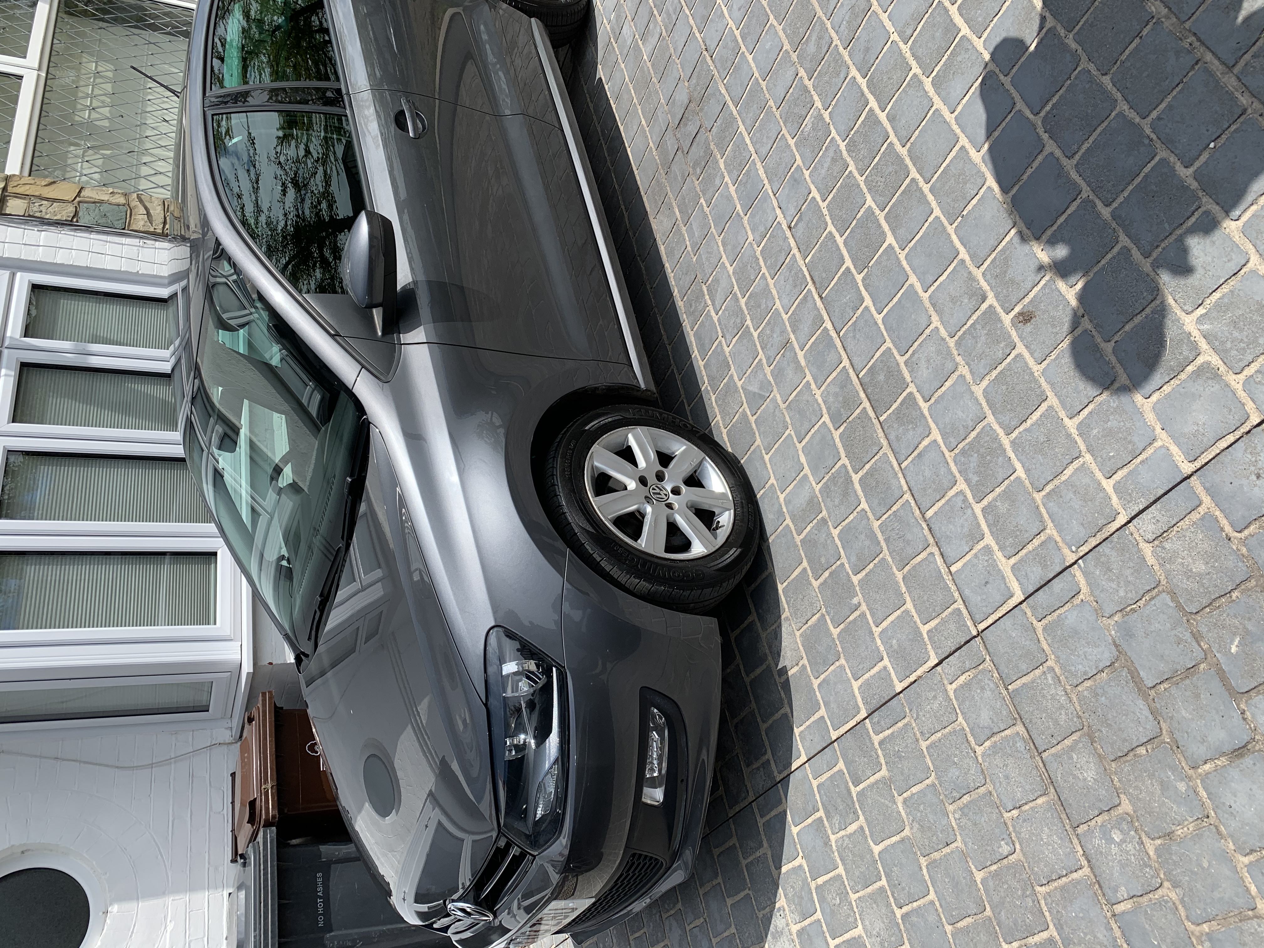

Haha yeah exactly they are tiny hence want to buy some bigger ones!
The pics a bit old but it’s the best side one I’ve got at the moment

She looks well clean 👍🏼 Nice, i think 17” will look nice ,
I edited my last messege with tyre size which mine has etc , should give you an idea where to start .
If you put the 17” on you will need to get the tracking done .
