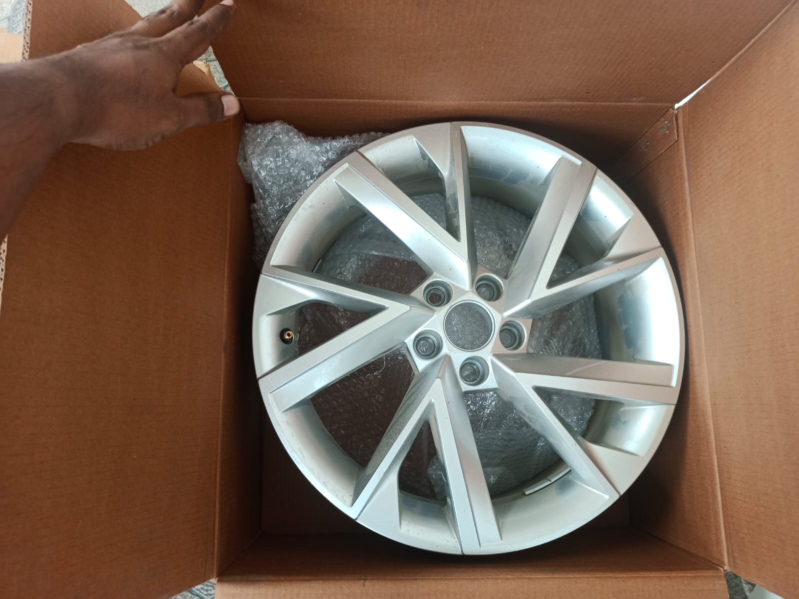

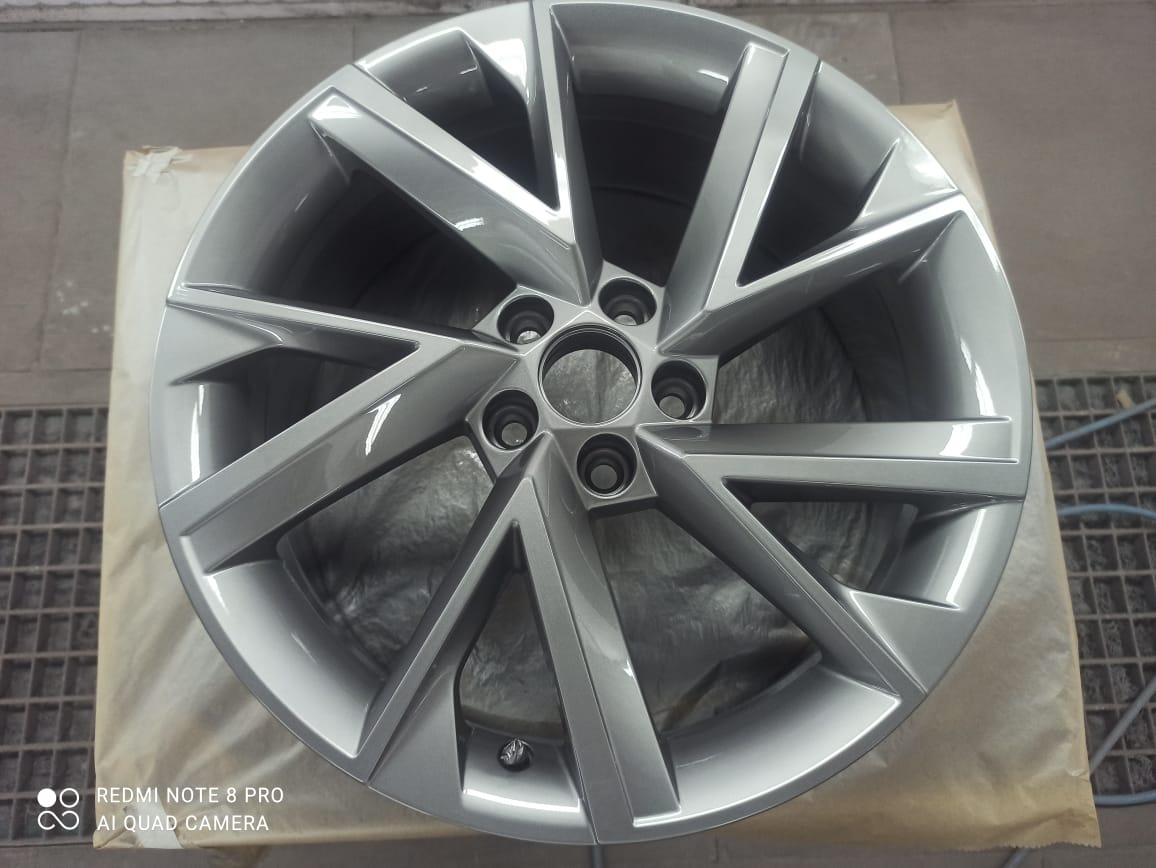

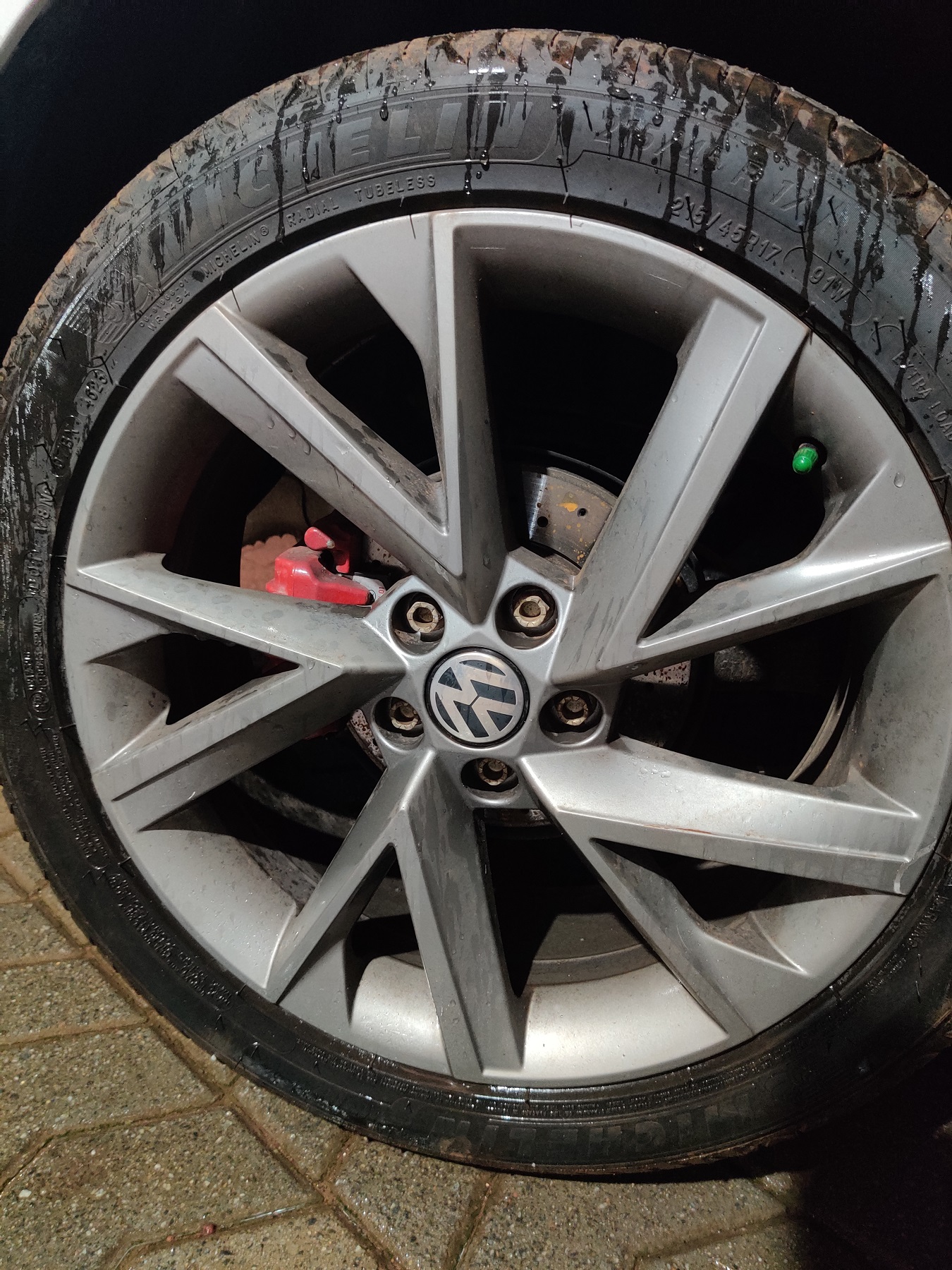

17" Alloys
After installing BCM Max, I ended up procuring and installing a set of 17" Vegas which came off Skoda Kushaq. I was quite lucky with this set as I got them off a new vehicle as the owner was changing to a new set of alloys prior to taking delivery of his vehicle. I tried to go for 215/40 R17 but the tyre size is just too rare and there aren't much options to choose from so I decided to go with 215/45 R17.
I got them painted grey before installing them. I had asked the VW ASC to get them painted in the OE alloy colour scheme but to my surprise, even ASC didn't have the actual colour code for the OE. Anyhow I am satisfied with the current color as it is :D. In hindsight, I feel I would have been better off powder-coating them instead of spray-painting them as the paint seems to get chipped quite easily.

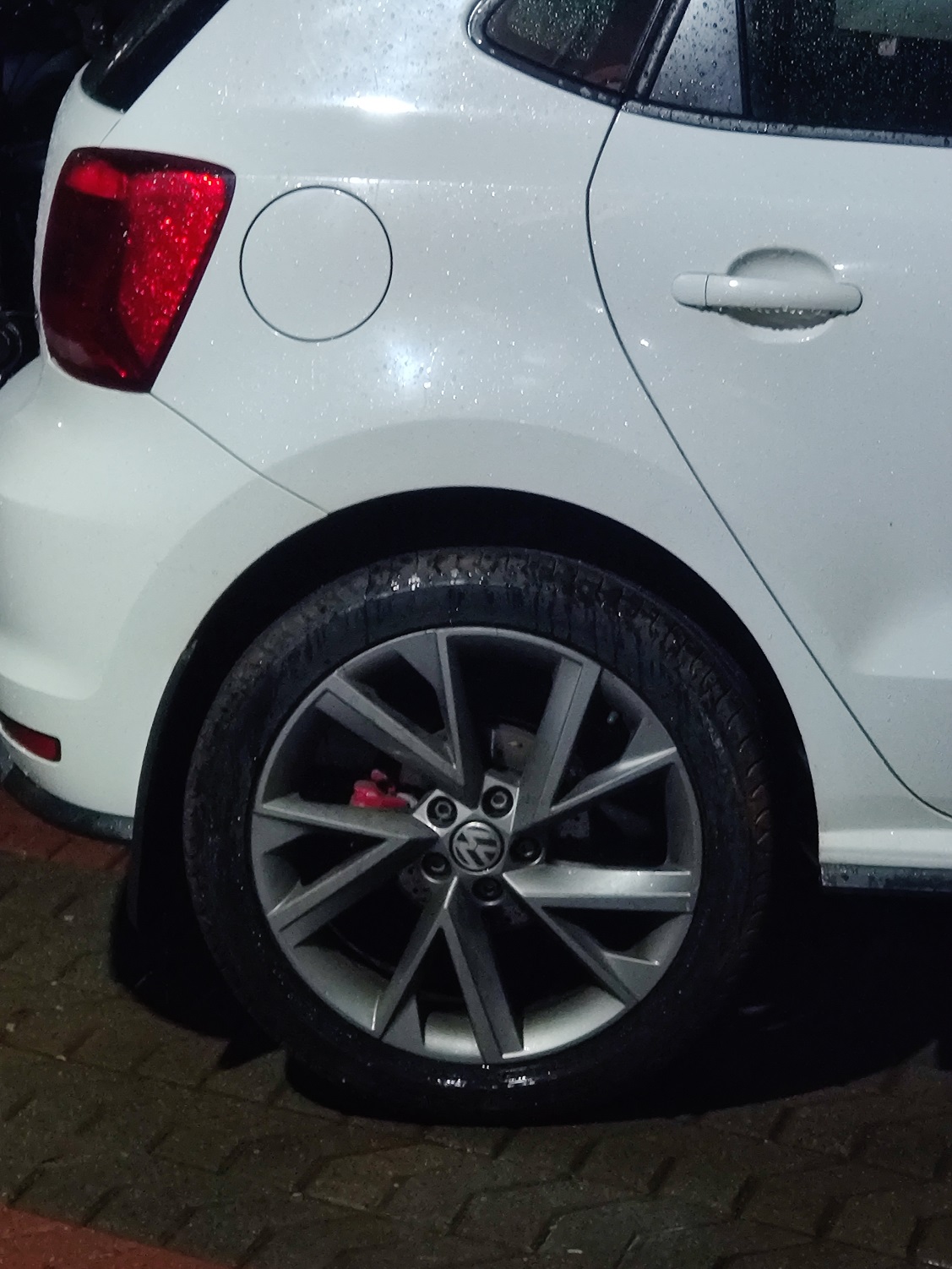

After installation
Rear Drum to Disc conversion
I ended by installing the rear axle beam from the pre-facelift polo and got the drum-to-disc conversion completed at the rear. Sometime back I had procured a set of rear and front calipers off a 6R GTI and after arranging a whole bunch of parts for rear disc upgrade, I could get them installed. A big shout out to Dr. Patil for the wonderful guide that he has shared with us for this conversion along with the whole list of parts that are required and the coding changes which need to be carried out. Thank you very much Dr. Patil πŸ™
Halogen to LED Headlights

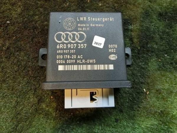

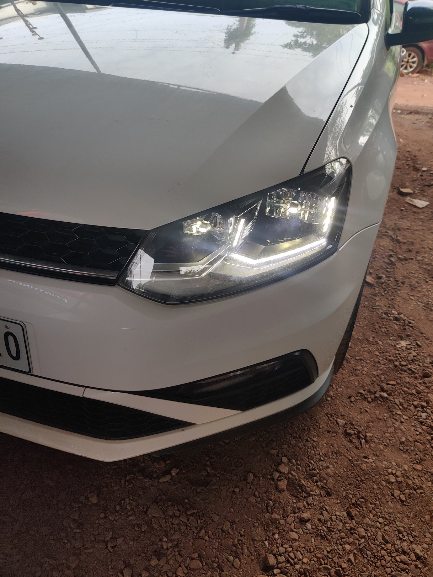

While procuring the caliper set I also got a set to Polo 6C LED headlights. I then went ahead to arrange the wiring set and the set of Headlight modules, the AFS Module and the rear axle sensor. I was fortunate to find a great offer on the axle sensor on an Australian e-commerce website during Christmas Time and I decided to pick it up without wasting much time. The LED Headlights wiring which I had procured from VAGExpress required some rework as it was originally meant for passat and Aditya helped me out with this rework. While installing the wiring, the dashboard was opened up and in the same go, I also got to install the hood contact switch and the windshield washer fluid sensor. Thanks to Aditya for the wiring πŸ™ and Fernando for sharing this retrofit with us πŸ™
Now that all of the writing has been connected I had an issue with the AFS as it came from a Polo 6R GTI. It wasn't parameterized for LED Headlight. Looking at the firegraphic post on drive2 I found the XML file which we have to use to adapt the AFS module for led headlight. I tried updating AFS module using LED parameter XML using ODIS Engineering v12.x but it started popping up with an error almost near completion of the process saying "Write Data: security_access_failed". I tried to find out over the internet what might be causing this error but didn't find a helpful solution. I ended up flashing the module with FL_6R0907357___0070.frf, hoping that this would fix the issue. Upon flashing the file I got a new error on the cluster saying "no bend lighting (afs) function owner's manual ". Now when I try to update the coding for the AFS module it says "coding refused". Prior to flashing, I was at least able to code the module :D with egg on my face I moved ahead. Next I tried to load the LED parameter XML using ODIS but it didnt work either. Now trying to Look at it practically it then seemed that I had to perform access authorization before doing data transfer. I tried the security access code which I found on the forum but couldn't get them to work via ODIS. I see even GovindSharma Ji had a similar issue. I wonder how he managed to get it sorted. If anyone can help me out with this it would be a great help. πŸ™ PS: DRLs, turn indicators, low and high beam are working fine.
I see the parameterization file is for 6R0 907 357C and my module is 6R0907357. could that be the reason. Also in the parameterization file I see for login they have mentioned 20103 which I feel might be used as value for security access.
Initially the AFS module (before flashing)
   Revision: --------    Serial number: -------------- Dataset Number: 6R0036v____ 0004
   Coding: 0114000001000000
   Shop #: WSC 00046 000 00000
   ROD: N/A
   VCID: 77FD5EDBCECD4D2BFA-8022
Parameterization file which firegraphic had shared on drive2.ru for adapting AFS for LED Headlight
<MESSAGE DTD="XMLMSG" VERSION="1.1">
<RESULT>
<RESPONSE NAME="GetParametrizeData" DTD="RepairHints" VERSION="1.4.7.1" ID="0">
<DATA>
<REQUEST_ID>000000000</REQUEST_ID>
<PARAMETER_DATA DIAGNOSTIC_ADDRESS="0x55" START_ADDRESS="0x000001" PR_IDX="" ZDC_NAME="6R0907357C" ZDC_VERSION="0004" LOGIN="20103" LOGIN_IND="" DSD_TYPE="1" SESSIONNAME="" FILENAME="">0x91,0x31,0x78,0xDB,0x00,0x00,0x05,0x01,0x0C,0x03,0x11,0x04,0x16,0x05,0x19,0x06,0x1D,0x07,0x1D,0x07,0x1F,0x07,0x01,0x00,0x01,0x02,0x00,0x00,0x00,0x7F,0x00,0x00,0x6E,0x01,0x00,0x44,0x42,0x0D,0x00,0x01,0x5B,0x00,0x0A,0x01,0x01,0x00,0x01,0x00,0x03,0x02,0x5B,0x5B,0x01,0x09,0x09,0x0B,0x09,0x09,0x01,0x09,0x01,0x00,0x01,0x00,0x00,0x01,0x00,0x07,0x03,0x00,0x03,0x00,0x03,0x00,0x03,0x00,0x03,0x00,0x03,0x00,0x03,0x00,0x03,0x00,0x03,0x00,0x00,0x00,0xB8,0x0B,0x00,0x00,0x10,0x27,0xF8,0x2A,0xB0,0x36,0x22,0x00,0x22,0x00,0x14,0x00,0x90,0x01,0x1E,0x00,0x5A,0x00,0x4C,0x1D,0x98,0x3A,0x00,0x00,0x00,0x00,0x03,0x00,0xC8,0x00,0x32,0x00,0x00,0x00,0x00,0x00,0x00,0x00,0x00,0x00,0x24,0xFA,0xDC,0x05,0x38,0x4A,0xF4,0x4C,0x50,0x46,0x40,0x06,0xB0,0x04,0xD0,0x07,0xF4,0x01,0x00,0x00,0x35,0x00,0xFF,0xFF,0xFF,0xFF,0xFF,0xFF,0xFF,0xFF,0xE8,0x03,0x9A,0x19,0xE8,0x03,0xF4,0x01,0x08,0x00,0xE2,0xFF,0x00,0x00,0x1A,0x00,0x00,0x00,0x3C,0x00,0x00,0x00,0x00,0x00,0x00,0x00,0x00,0x00,0x64,0x6E,0x00,0x00,0x00,0x00,0x00,0x00,0x00,0x00,0x00,0x00,0x00,0x00,0x00,0x00,0x00,0x00,0xE8,0x03,0x10,0x27,0x98,0x3A,0x58,0x02,0x90,0x01,0x90,0x01,0x90,0x01,0x50,0x00,0x03,0x00,0x03,0x00,0xC8,0x00,0x64,0x00,0x03,0x00,0x64,0x00,0xC8,0x00,0x20,0x03,0xF4,0x01,0x08,0x07,0x20,0x03,0xE8,0x03,0xF4,0x01,0xD0,0x07,0x1E,0x00,0x00,0x00,0x0A,0x00,0x0A,0x00,0x0F,0x00,0x01,0x00,0xE2,0xFF,0xBA,0xFF,0xBA,0xFF,0xE2,0xFF,0x00,0x00,0x00,0x00,0x00,0x00,0x00,0x00,0x96,0x09,0x2C,0x01,0xA8,0x02,0x64,0x00,0x2C,0x01,0x9C,0xFF,0xD4,0xFE,0xC8,0x00,0xF4,0x01,0x1E,0x00,0x14,0x00,0x90,0x01,0x32,0x00,0x64,0x00,0xF4,0x01,0x2C,0x01,0x6A,0xFF,0x0C,0xFE,0x38,0xFF,0x00,0x00,0x0A,0x00,0x64,0x00,0x64,0x00,0x64,0x00,0x05,0x00,0x05,0x00,0x01,0x00,0x05,0x00,0x64,0x00,0x10,0x27,0x10,0x27,0x2C,0x01,0x32,0x00,0x50,0x00,0x70,0xFE,0x70,0xFE,0xD4,0xFE,0xD4,0xFE,0x9C,0xFF,0x5E,0x01,0x05,0x00,0x02,0x00,0xC8,0x00,0x64,0x00,0x64,0x00,0x14,0x00,0x64,0x00,0x0A,0x00,0x9A,0x10,0x58,0x09,0x60,0x06,0x47,0x10,0xE0,0x2E,0x4D,0x01,0x4D,0x01,0x53,0xFD,0x53,0xFD,0x00,0x00,0x8C,0x3C,0x50,0x46,0x10,0x27,0x04,0x29,0x12,0x00,0xF0,0x0C,0x00,0x00,0x00,0x00,0xD8,0xFF,0x1E,0x00,0x84,0x03,0x20,0x03,0x20,0x03,0x20,0x03,0x20,0x03,0x2C,0x01,0x2C,0x01,0x2C,0x01,0x2C,0x01,0xF4,0x01,0x00,0x00,0x02,0x00,0x16,0x00,0x64,0x00,0x32,0x00,0xE8,0x03,0xC8,0x00,0x64,0x00,0xF4,0x01,0xF4,0x01,0xC8,0x00,0xE8,0x03,0xE8,0x03,0x96,0x00,0x0A,0x00,0x1E,0x00,0x98,0x3A,0x68,0xC5,0x00,0x00,0x00,0x00,0x00,0x00,0x00,0x00,0x98,0x3A,0x98,0x3A,0x98,0x3A,0x98,0x3A,0x98,0x3A,0x98,0x3A,0x96,0x00,0x19,0x00,0x19,0x00,0x19,0x00,0x19,0x00,0x50,0x00,0x00,0x00,0x00,0x00,0x2C,0x01,0x2C,0x01,0xA0,0x0F,0x00,0xFA,0xE8,0x03,0x98,0x3A,0x64,0x00,0x32,0x00,0xE8,0x03,0x94,0x11,0x80,0x0C,0x00,0x00,0x00,0x00,0xA6,0xFF,0x00,0x00,0xA6,0xFF,0x03,0x00,0xC8,0x00,0x04,0x00,0x00,0x00,0x70,0x17,0x00,0x00,0x4C,0x1D,0x00,0x00,0x10,0x27,0x00,0x00,0x00,0x00,0x00,0x00,0x00,0x00,0x64,0x00,0x64,0x00,0xD0,0x07,0x64,0x00,0x0A,0x00,0x2C,0x01,0xF4,0x01,0x64,0x00,0x0A,0x00,0x04,0x01,0x90,0x01,0x38,0xFF,0x00,0x00,0x38,0xFF,0x00,0x00,0x01,0x00,0x14,0x00,0x04,0x01,0x90,0x01,0x0A,0x00,0x2D,0x00,0x00,0x00,0xE8,0x03,0x01,0x00,0xC8,0x00,0x64,0x00,0x96,0x00,0x40,0x00,0x00,0x00,0x68,0xC5,0x98,0x3A,0x0C,0xFE,0xF4,0x01,0x00,0x00,0x70,0xFE,0xE8,0x03,0xF4,0x01,0xB8,0x0B,0x28,0x23,0x00,0x00,0x88,0x13,0x06,0x00,0x78,0x05,0x1E,0x00,0xF4,0x01,0x28,0x23,0x03,0x00,0x05,0x00,0x14,0x00,0x28,0x00,0x00,0x00,0x06,0xFF,0x48,0xF4,0x00,0x00,0xB8,0x0B,0xE8,0xFE,0x00,0x00,0x00,0x00,0x00,0x00,0x18,0x01,0x18,0xFC,0xF6,0xFF,0x00,0x00,0x0A,0x00,0xE8,0x03,0x00,0x00,0x3C,0x00,0x0D,0x00,0x50,0x00,0x00,0x00,0xB6,0xFE,0x24,0xFF,0xAA,0xFF,0xC6,0xFF,0x00,0x00,0x00,0x00,0x58,0x02,0xB0,0x04,0xC4,0x09,0x88,0x13,0x06,0x00,0xAA,0x00,0x5E,0x01,0xBC,0x02,0x78,0x05,0xF2,0x03,0x68,0x06,0xDE,0x08,0x54,0x0B,0xCA,0x0D,0x40,0x10,0x2A,0x03,0x38,0x04,0x46,0x05,0x54,0x06,0x62,0x07,0x70,0x08,0x2A,0x03,0x2A,0x03,0x2A,0x03,0x2A,0x03,0x2A,0x03,0x2A,0x03,0x2A,0x03,0x38,0x04,0x46,0x05,0x54,0x06,0x62,0x07,0x70,0x08,0x04,0x04,0x00,0x00,0x00,0x00,0x00,0x00,0x00,0x00,0x00,0x00,0x00,0x00,0x00,0x00,0x12,0x00,0x12,0x00,0x00,0x00,0x00,0x00,0x00,0x00,0x00,0x00,0x00,0x00,0x00,0x00,0x01,0x00,0x02,0x00,0x04,0x00,0x05,0x00,0x06,0x00,0x07,0x00,0x03,0x00,0x08,0x00,0x09,0x00,0x0A,0x00,0x0B,0x00,0x0C,0x00,0x0D,0x00,0x09,0x00,0x08,0x00,0x07,0x00,0x06,0x00,0x05,0x00,0x04,0x00,0x00,0x00,0x64,0x00,0x4C,0x04,0xB0,0x04,0x14,0x05,0x78,0x05,0xDC,0x05,0x40,0x06,0x34,0x08,0x1C,0x0C,0x04,0x10,0xD4,0x17,0x98,0x3A,0x80,0x3E,0x5C,0x44,0x50,0x46,0x44,0x48,0x38,0x4A,0x2C,0x4C,0x20,0x26,0x48,0x21,0x80,0x1D,0x80,0x1A,0x10,0x18,0x08,0x16,0x50,0x14,0xD8,0x12,0x98,0x11,0x78,0x10,0x80,0x0F,0x30,0x0F,0xD8,0x0D,0x28,0x0D,0x88,0x0C,0xF0,0x0B,0x70,0x0B,0xF0,0x0A,0x80,0x0A,0x18,0x0A,0xB8,0x09,0x60,0x09,0xE0,0x2E,0x08,0x2A,0x40,0x26,0x40,0x23,0xD0,0x20,0xC8,0x1E,0x10,0x1D,0x98,0x1B,0x58,0x1A,0x38,0x19,0x40,0x18,0x60,0x17,0x98,0x16,0xE8,0x15,0x48,0x15,0xB0,0x14,0x30,0x14,0xB0,0x13,0x40,0x13,0xD8,0x12,0x78,0x12,0x20,0x12,0xE0,0x2E,0xE0,0x2E,0xE0,0x2E,0xE0,0x2E,0xE0,0x2E,0xE0,0x2E,0xE0,0x2E,0xE0,0x2E,0xE0,0x2E,0xE0,0x2E,0xE0,0x2E,0xE0,0x2E,0xE0,0x2E,0xE0,0x2E,0xE0,0x2E,0xE0,0x2E,0xE0,0x2E,0xE0,0x2E,0xE0,0x2E,0xE0,0x2E,0xE0,0x2E,0xE0,0x2E,0xE0,0x2E,0x08,0x2A,0x40,0x26,0x40,0x23,0xD0,0x20,0xC8,0x1E,0x10,0x1D,0x98,0x1B,0x58,0x1A,0x38,0x19,0x40,0x18,0x60,0x17,0x98,0x16,0xE8,0x15,0x48,0x15,0xB0,0x14,0x30,0x14,0xB0,0x13,0x40,0x13,0xD8,0x12,0x78,0x12,0x20,0x12,0x00,0x00,0x00,0x00,0x00,0x00,0x00,0x00,0x00,0x00,0x00,0x00,0x00,0x00,0x00,0x00,0x00,0x00,0x00,0x00,0x00,0x00,0x00,0x00,0x00,0x00,0x00,0x00,0x00,0x00,0x00,0x00,0x00,0x00,0x00,0x00,0x00,0x00,0x00,0x00,0x00,0x00,0x00,0x00,0x00,0x00,0x00,0x00,0x00,0x00,0x00,0x00,0x00,0x00,0x00,0x00,0x00,0x00,0x00,0x00,0x00,0x00,0x00,0x00,0x00,0x00,0x00,0x00,0x00,0x00,0x00,0x00,0x00,0x00,0x00,0x00,0x00,0x00,0x00,0x00,0x00,0x00,0x00,0x00,0x00,0x00,0x00,0x00,0x00,0x00,0x00,0x00,0x00,0x00,0x00,0x00,0x00,0x00,0x00,0x00,0x00,0x00,0x00,0x00,0x00,0x00,0x00,0x00,0x00,0x00,0x00,0x00,0x00,0x00,0x00,0x00,0x00,0x00,0x00,0x00,0x00,0x00,0x00,0x00,0x00,0x00,0x00,0x00,0x00,0x00,0x00,0x00,0x00,0x00,0x00,0x00,0x00,0x00,0x00,0x00,0x00,0x00,0x00,0x00,0x00,0x00,0x00,0x00,0x00,0x00,0x00,0x00,0x00,0x00,0x00,0x00,0x00,0x00,0x00,0x00,0x00,0x00,0x00,0x00,0x00,0x00,0x00,0x00,0x00,0x00,0x00,0x00,0x00,0x00,0x00,0x00,0x00,0x00,0x00,0x00,0x00,0x00,0x00,0x00,0x00,0x00,0x00,0x00,0x00,0x00,0x00,0x00,0x00,0x00,0x00,0x00,0x00,0x00,0x00,0x00,0x00,0x00,0x00,0x00,0x00,0x00,0x00,0x00,0x00,0x00,0x00,0x00,0x00,0x00,0x00,0x00,0x00,0x00,0x00,0x00,0x00,0x00,0x00,0x00,0x00,0x00,0x00,0x00,0x00,0x00,0x00,0x00,0x00,0x00,0x00,0x00,0x00,0x00,0x00,0x00,0x00,0x00,0x00,0x00,0x00,0x00,0x00,0x00,0x00,0x00,0x00,0x00,0x00,0x00,0x00,0x00,0x00,0x00,0x00,0x00,0x00,0x00,0x00,0x00,0x00,0x00,0x00,0x00,0x00,0x00,0x00,0x00,0x00,0x00,0x00,0x00,0x00,0x00,0x00,0x00,0x00,0x00,0x00,0x00,0x00,0x00,0x00,0x00,0x00,0x00,0x00,0x00,0x00,0x00,0x00,0x00,0x00,0x00,0x00,0x00,0x00,0x00,0x00,0x00,0x00,0x00,0x00,0x00,0x00,0x00,0x00,0x00,0x00,0x00,0x00,0x00,0x00,0x00,0x00,0x00,0x00,0x00,0x00,0x00,0x00,0x00,0x00,0x00,0x00,0x00,0x00,0x00,0x00,0x00,0x00,0x00,0x00,0x00,0x00,0x00,0x00,0x00,0x00,0x00,0x00,0x00,0x00,0x00,0x00,0x00,0x00,0x00,0x00,0x00,0x00,0x00,0x00,0x00,0x00,0x00,0x00,0x00,0x00,0x00,0x00,0x00,0x00,0x00,0x00,0x00,0x00,0x00,0x00,0x00,0x00,0x00,0x00,0x00,0x00,0x00,0x00,0x00,0x00,0x00,0x00,0x00,0x00,0x00,0x00,0x00,0x00,0x00,0x00,0x00,0x00,0x00,0x00,0x00,0x00,0x00,0x00,0x00,0x00,0x00,0x00,0x00,0x00,0x00,0x00,0x00,0x00,0x00,0x00,0x00,0x00,0x00,0x00,0x00,0x00,0x00,0x00,0x00,0x00,0x00,0x00,0x00,0x00,0x00,0x00,0x00,0x00,0x00,0x00,0x00,0x00,0x00,0x00,0x00,0x00,0x00,0x00,0x00,0x00,0x00,0x00,0x00,0x00,0x00,0x00,0x00,0x00,0x00,0x00,0x00,0x00,0x00,0x00,0x00,0x00,0x00,0x00,0x00,0x00,0x00,0x00,0x00,0x00,0x00,0x00,0x00,0x00,0x00,0x00,0x00,0x00,0x00,0x00,0x00,0x00,0x00,0x00,0x00,0x00,0x00,0x00,0x00,0x00,0x00,0x00,0x00,0x00,0x00,0x00,0x00,0x00,0x00,0x00,0x00,0x00,0x00,0x00,0x00,0x00,0x00,0x00,0x00,0x00,0x00,0x00,0x00,0x00,0x00,0x00,0x00,0x00,0x00,0x00,0x00,0x00,0x00,0x00,0x00,0x00,0x00,0x00,0x00,0x00,0x00,0x00,0x00,0x00,0x00,0x00,0x00,0x00,0x00,0x00,0x00,0x00,0x00,0x00,0x00,0x00,0x00,0x00,0x00,0x00,0x00,0x00,0x00,0x00,0x00,0x00,0x00,0x00,0x00,0x00,0x00,0x00,0x00,0x00,0x00,0x00,0x00,0x00,0x00,0x00,0x00,0x00,0x00,0x00,0x00,0x00,0x00,0x00,0x00,0x00,0x00,0x00,0x00,0x00,0x00,0x00,0x00,0x00,0x00,0x00,0x00,0x00,0x00,0x00,0x00,0x00,0x00,0x00,0x00,0x00,0x00,0x00,0x00,0x00,0x00,0x00,0x00,0x00,0x00,0x00,0x00,0x00,0x00,0x00,0x00,0x00,0x00,0x00,0x00,0x00,0x00,0x00,0x00,0x00,0x00,0x00,0x00,0x00,0x00,0x00,0x00,0x00,0x00,0x00,0x00,0x00,0x00,0x00,0x00,0x00,0x00,0x00,0x00,0x00,0x00,0x00,0x00,0x00,0x00,0x00,0x00,0x00,0x00,0x00,0x00,0x00,0x00,0x00,0x00,0x00,0x00,0x00,0x00,0x00,0x00,0x00,0x00,0x00,0x00,0x00,0x00,0x00,0x00,0x00,0x00,0x00,0x00,0x00,0x00,0x00,0x00,0x00,0x00,0x00,0x00,0x00,0x00,0x00,0x00,0x00,0x00,0x00,0x00,0x00,0x00,0x00,0x00,0x00,0x00,0x00,0x00,0x00,0x00,0x00,0x00,0x00,0x00,0x00,0x00,0x00,0x00,0x00,0x00,0x00,0x00,0x00,0x00,0x00,0x00,0x00,0x00,0x00,0x00,0x00,0x00,0x00,0x00,0x00,0x00,0x00,0x00,0x00,0x00,0x00,0x00,0x00,0x00,0x00,0x00,0x00,0x00,0x00,0x00,0x00,0x00,0x00,0x00,0x00,0x00,0x00,0x00,0x00,0x00,0x00,0x00,0x00,0x00,0x00,0x00,0x00,0x00,0x00,0x00,0x00,0x00,0x00,0x00,0x00,0x00,0x00,0x00,0x00,0x00,0x00,0x00,0x00,0x00,0x00,0x00,0x00,0x00,0x00,0x00,0x00,0x00,0x00,0x00,0x00,0x00,0x00,0x00,0x00,0x00,0x00,0x00,0x00,0x00,0x00,0x00,0x00,0x00,0x00,0x00,0x00,0x00,0x00,0x00,0x00,0x00,0x00,0x00,0x00,0x00,0x00,0x00,0x00,0x00,0x00,0x00,0x00,0x00,0x00,0x00,0x00,0x00,0x00,0x00,0x00,0x00,0x00,0x00,0x00,0x00,0x00,0x00,0x00,0x00,0x00,0x00,0x00,0x00,0x00,0x00,0x00,0x00,0x00,0x00,0x00,0x00,0x00,0x00,0x00,0x00,0x00,0x00,0x00,0x00,0x00,0x00,0x00,0x00,0x00,0x00,0x00,0x00,0x00,0x00,0x00,0x00,0x00,0x00,0x00,0x00,0x00,0x00,0x00,0x00,0x00,0x00,0x00,0x00,0x00,0x00,0x00,0x00,0x00,0x00,0x00,0x00,0x00,0x00,0x00,0x00,0x00,0x00,0x00,0x00,0x00,0x00,0x00,0x00,0x00,0x00,0x00,0x00,0x00,0x00,0x00,0x00,0x00,0x00,0x00,0x00,0x00,0x00,0x00,0x00,0x00,0x00,0x00,0x00,0x00,0x00,0x00,0x00,0x00,0x00,0x00,0x00,0x00,0x00,0x00,0x00,0x00,0x00,0x00,0x00,0x00,0x00,0x00,0x00,0x00,0x00,0x00,0x00,0x00,0x00,0x00,0x00,0x00,0x00,0x00,0x00,0x00,0x00,0x00,0x00,0x00,0x00,0x00,0x00,0x00,0x00,0x00,0x00,0xB6,0x93</PARAMETER_DATA>
<COMPOUNDS>
<COMPOUND COMPOUND_ID="1">
<SW_NAME/>
<SW_VERSION/>
<SW_PART_NO/>
</COMPOUND>
<COMPOUND COMPOUND_ID="2">
<SW_NAME/>
<SW_VERSION/>
<SW_PART_NO/>
</COMPOUND>
<COMPOUND COMPOUND_ID="3">
<SW_NAME/>
<SW_VERSION/>
<SW_PART_NO/>
</COMPOUND>
<COMPOUND COMPOUND_ID="4">
<SW_NAME/>
<SW_VERSION/>
<SW_PART_NO/>
</COMPOUND>
<COMPOUND COMPOUND_ID="5">
<SW_NAME/>
<SW_VERSION/>
<SW_PART_NO/>
</COMPOUND>
</COMPOUNDS>
<INFORMATION>
<CODE/>
</INFORMATION>
<DSD_DATA>
<COMPRESSED_DATA CONTENT="DSD-Files" CONTENT_TYPE="application/tar" CONTENT_TRANSFER_ENCODING="base64" BYTES_UNCOMPRESSED="0" BYTES_COMPRESSED="0"> </COMPRESSED_DATA>
</DSD_DATA>
</DATA>
</RESPONSE>
</RESULT>
</MESSAGE>

POLO 6R (Sedan-Rus) Bi-xenon headlights.
Address 55: Headlight Range (J431) Labels:. 6R0-907-357.clb
Part No SW: 6R0 907 357 C HW: 6R0 907 357 B
Component: AFS-ECU 005 0050
Revision: -------- Serial Number: --------------
Encoding: 0D4B000001000000
Workshop #: WSC 01430 965 01200
ASAM Dataset: EV_HeadlRegulVWLWRCC 002,006
ROD: EV_HeadlRegulVWLWRCC.rod
VCID: 3A70CEF1BD8746E76D-807F
POLO 6R (Vento-Ind) LED headlights.
Coding: 0D0C000001000000
Shop #: WSC 01234 785 00200
ASAM Dataset: EV_HeadlRegulVWLWRCC 002006
VCID: 3A7A0A74BD5F989684-806E
Currently VCDS does a read of the data set.
My 6R Bi-xenon.
Part No SW: 6R0 907 357 HW: 6R0 907 357
Component: LWR-ECU H02 0070
Revision: -------- Serial number: -------------- Dataset Number: 6R0036v____ 0005
Coding: 0112000001000000
Shop #: WSC 00788 648 00255
VCID: 77AB16A00F4AAFD23E1-8022
Conclusions: :lol:
Start by finding an Autoscan with VCDS updated from a 6R (Vento-Ind) with factory LED headlights to find out the data set it has installed.

ciclo wrote: Wed Jun 26, 2024 4:07 am From here you can download the dataset for VCP that TinyQ modified <DATEN-NAME>POLO_LED_by_TinyQ</DATEN-NAME>
Firstly thank you so much for coming to my rescue Fernando :) πŸ™. I had been trying with that exact dataset to parameterise the AFS module for LED headlights. Unfortunately, Govind didn't mention in that thread how he got around it to fix the issue. Hopefully I'll get the opportunity to do that. :D
I don't have access to VCP else I think this would have been much easier.
I'll have a word with Slavik, shortly.
ciclo wrote: Wed Jun 26, 2024 4:52 am Start by finding an Autoscan with VCDS updated from a 6R (Vento-Ind) with factory LED headlights to find out the data set it has installed.
I think I am getting your drift Sir. Since the AFS ECUs are completely different, the one that I have installed probably might not be compatible with LED Headlights. Just for more clarity, I am posting an image of the AFS which I have Installed.
While going through our forum. I found a scan of Vento(IND) with LED Headlights posted by our member LeroyLobo. Big thanks to him πŸ™. How wonderful this forum is! Its a
of knowledge.
Thank you fernando for taking out time to help me. πŸ™
Posts: 9037
Location: Earth β™₯, Spain.
Re: Polo 6R - Sanket's 1.0 TSI
Clarifications:
- Now I seem to remember that Govind installed Bixenon headlights on his 6R, not LED headlights, so his experience is of no use to you.
- I insist πŸ˜„, the autoscan you must look for must be done with an 'UPDATED' VCDS tool, otherwise we will not be able to know the dataset 'number'/'name' installed in unit 55 of that 6R (Vento-Ind) with LED headlights.
- Because your 6R is young, you should install a 'C' version 55 unit, which as you have seen can be useful for both Bixenon headlights and LED headlights.
If it is second-hand, make sure it comes from a PQ25 platform vehicle.
Only need to get the FACTORY data sets πŸ‘Œ for those 'C' units fitted to the 6Rs with LED headlights.
πŸ™

ciclo wrote: Wed Jun 26, 2024 2:47 pm - Now I seem to remember that Govind installed Bixenon headlights on his 6R, not LED headlights, so his experience is of no use to you.
Yes In that case it won't be.
ciclo wrote: Wed Jun 26, 2024 2:47 pm - I insist , the autoscan you must look for must be done with an 'UPDATED' VCDS tool, otherwise we will not be able to know the dataset 'number'/'name' installed in unit 55 of that 6R (Vento-Ind) with LED headlights.
Only need to get the FACTORY data sets for those 'C' units fitted to the 6Rs with LED headlights.
I agree, Now having known the difference in the AFS ECUs between the "C" version and non "C" version, even if I had to succeed in flashing the LED Parameters, there would always be a thought at the back of my mind if the AFS is working how it works in the "C" version. So I have decided to get myself a tried and tested way and get the "C" version of AFS unit to save time and peace of mind.
Once I have the new AFS with me, I'll try to post the VCDS scan.
Once again Thank you so much Fernando for taking the time to help me and to answer my queries. πŸ™ :)
