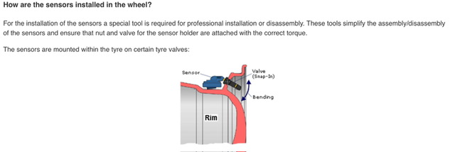

If the Polo had a direct TPMS (tyre pressure monitoring system), I’d say that it might be a sensor that had become detached from the valve stem inside the tyre that was causing the noise. However, the Polo’s TPMS is an indirect system that uses the car’s ABS sensors to measure differences in the rotational speed of wheels, so it doesn’t have specific TPMS sensors mounted inside the wheels. Do you know if the previous owner of your car ever had the wheels fitted to a different car with a direct TPMS?
If the noise is definitely coming from the wheel / tyre and you can hear it when you roll it along, the next step would be to get the tyre removed to establish what it is inside the tyre that’s causing the noise.
