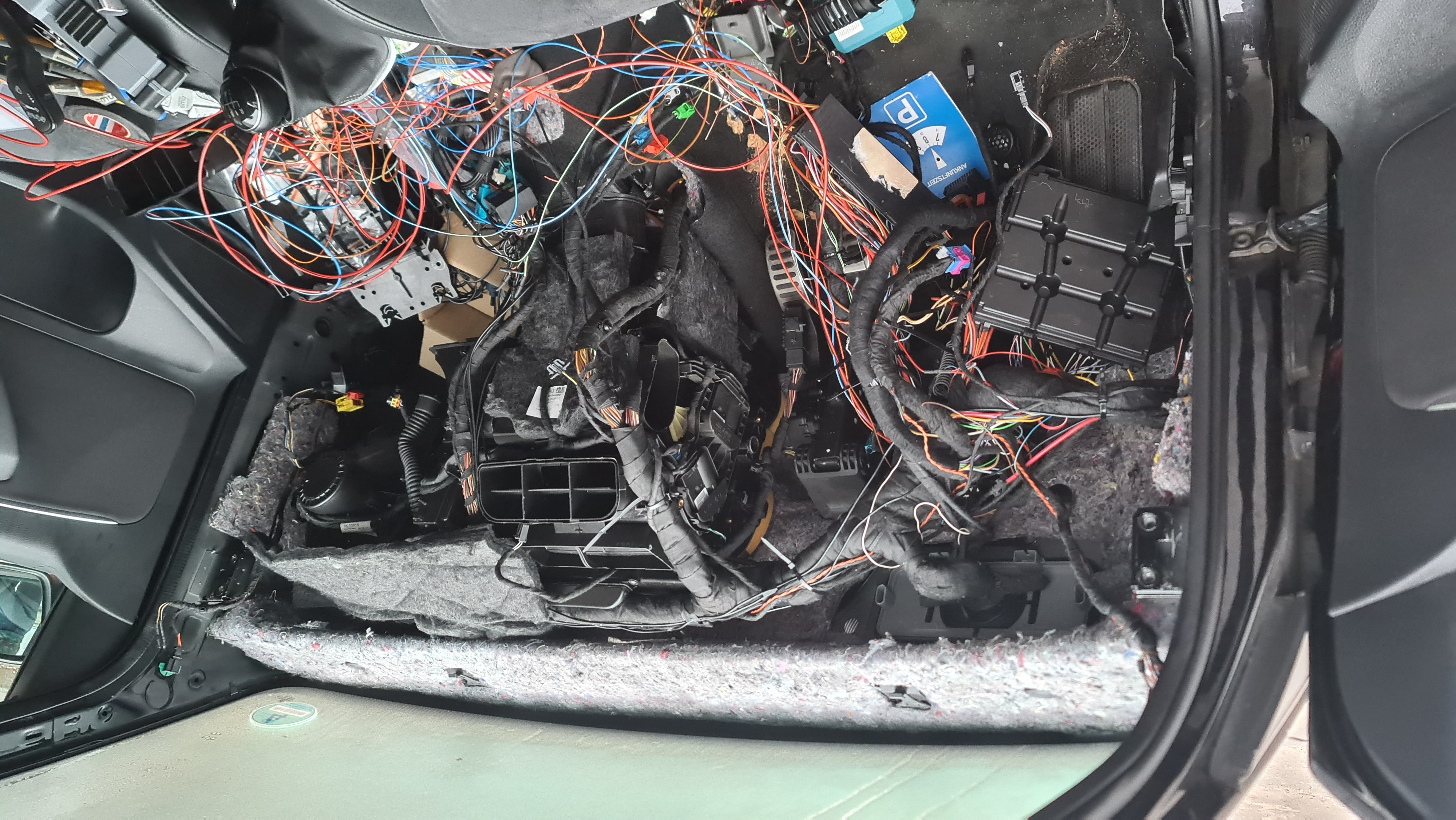

The interior electrics are finished. It included (but wasn't limited to):
  • Rewiring of the fuel pump
  • Adding of a voltage stabilizer underneath the driver's seat
  • Rewiring of almost the entire relay board
  • Adding of a Start-Stop-Automation-Deactivation button
  • Some changes in the wiring to the BCM
  • Some changes in the wiring to the ignition switch
For now there are still some trim pieces missing, but that's something for later because I absolutely hate each and every single piece of interior trim. All of them are just always a massive pain in the lower backside to put back on.
Here's a picture of the interior during the electrics works: :shock:

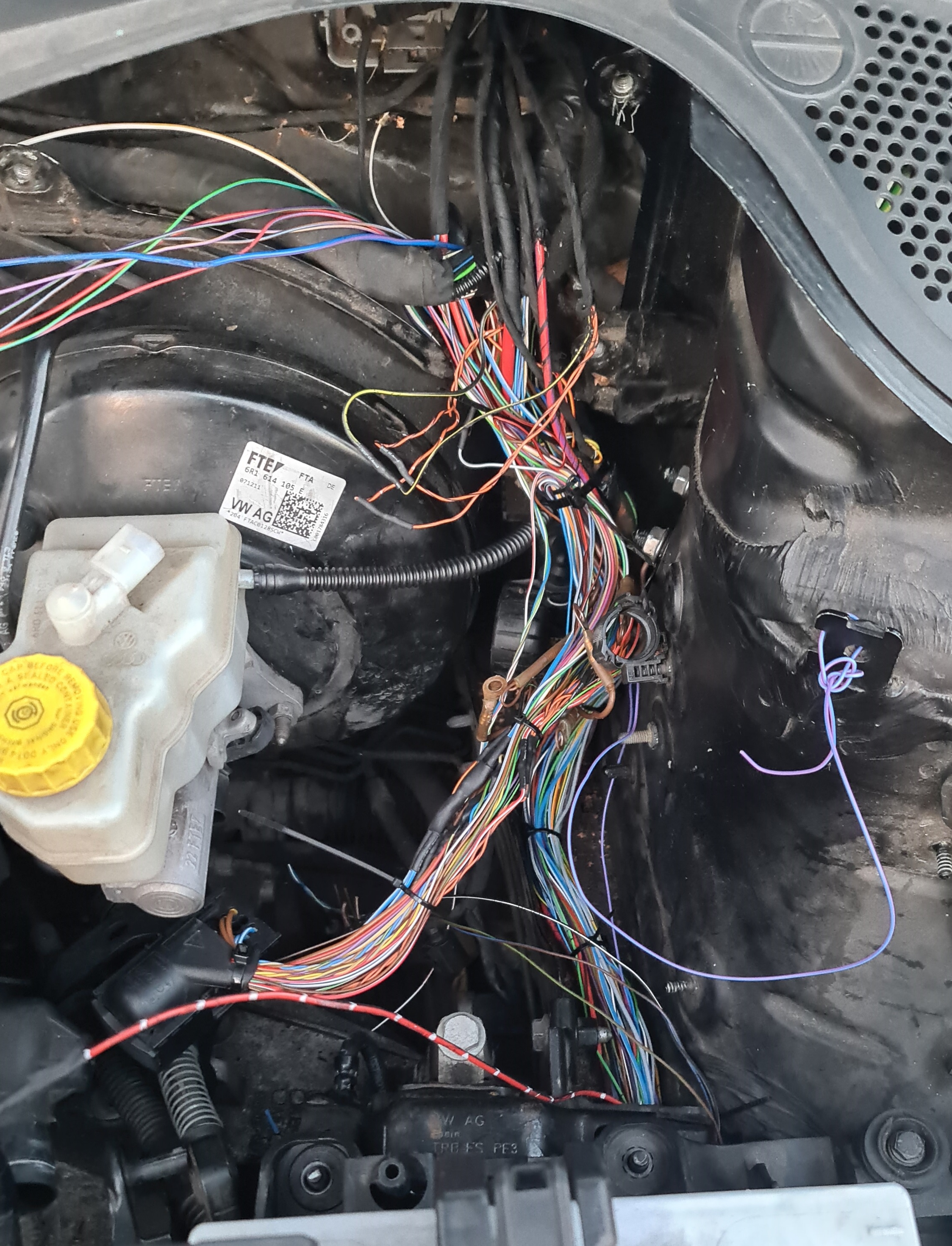

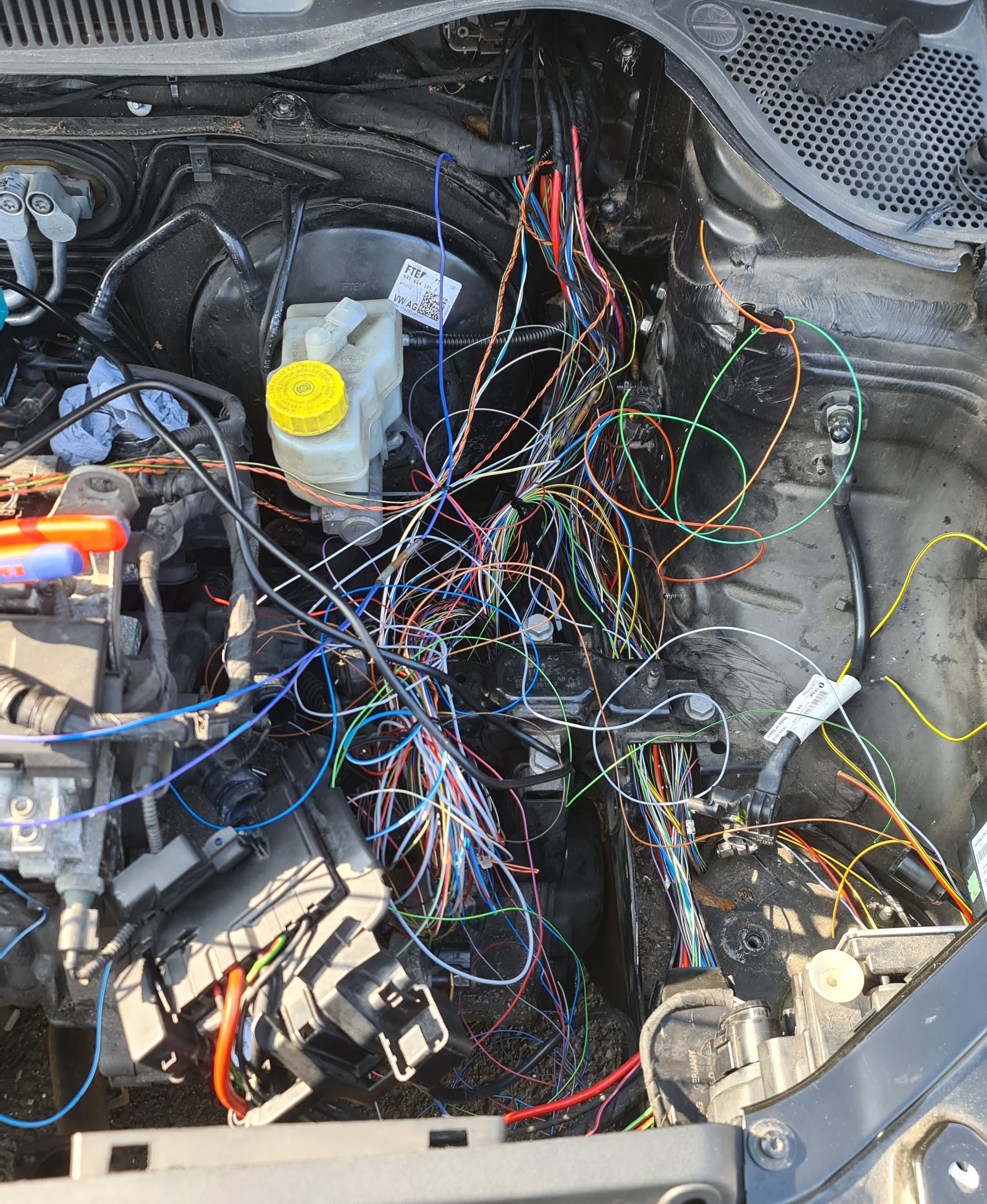

I removed the cover plate for the plenum chamber as well as the wiper motor, then pulled all the prepared cables from inside out into the open.
I removed basically all of the original wiring tape on the left side in an effort to get all the wiring as clean as possible.
Biggest job was to completely rewire the connector to the ECU: All the existing cables had to be extended and put into their new positions in the new connector. An awful lot of soldering.
Furthermore, one wire had to be removed, some had to be replaced, a lot had to be added.
As of now, I am in the process of sorting all the new cables and putting them into their new homes: The T14 connector to the engine harness, the completely rewired cooling fan assembly and coolant temp sensor, the wiring harness to alternator and ac compressor as well as the G701 and G294 sensors and the battery control module.
Here's a picture of the mess of cables I had to deal with:
And here's a picure how it looks now: Quite a bit better, even though not yet finished.
Though, I made a little mistake: I forgot that my lambda probes don't remain in their old positions in front of the engine. I therefor wrongfully assumed that I would be able to reuse the existing wires from the old ECU. Subsequently, I just bought very little of the correct wires, so I now have to extend them as well. Yay, even more soldering!

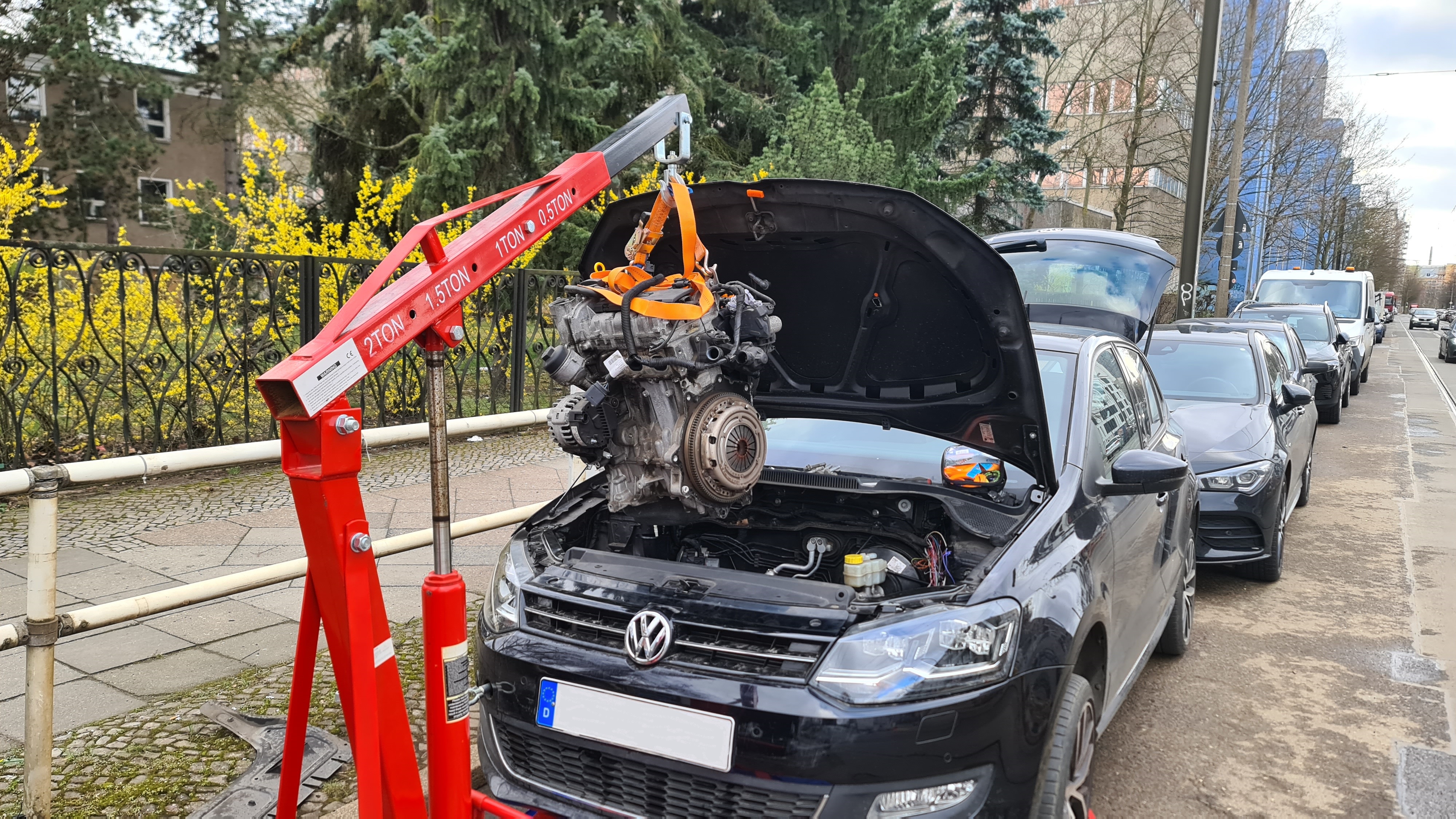

The old engine is out!
On that occasion I also removed the exhaust and some other bits and bobs. The transmission remains in place for now, since otherwise I fear my front wheels might fall off on the way to the workshop.
Now it's time for the remaining wiring works, then prepping front and back axle for a fast installation in the workshop.
To answer a question I get asked in public quite often: Why don't I do all these works in a workshop with a proper lift instead of lying on the street half a meter away from very active tram tracks?
The answer is cost: it is cheaper to rent an engine crane for two days as it is to rent a workshop for two hours. Since I figured I would need more that two hours to get the engine out, this was the cheaper way. Also for most of the tasks at hand I don't need a lift or special workshop tools. So while it is quite annoying to constantly get "ringed" at by the passing tram drivers this is the better way for me.
And why didn't I just buy a car with the engine I want?
Come on guys, you now this isn't the way we work here :wink: :D
