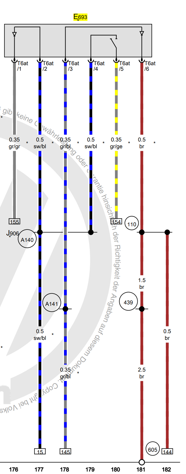

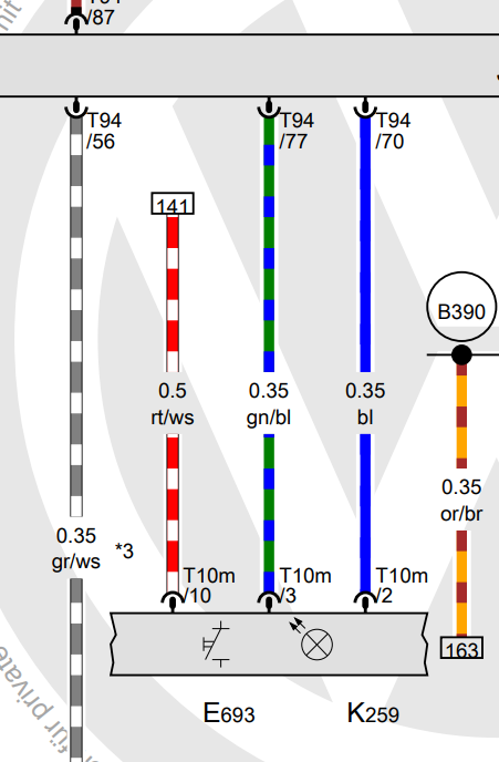

I spent a litte more time thinking about the s/s wiring, here are my thoughts:
This is the ErWin wiring diagram I have for the CPTA engine (which is wrong concerning E693 and K259):
Screenshot 2024-01-16 212137.png (61.57 KiB) Viewed 6666 times
And this is a J693 wiring from a random other engine:
Screenshot 2024-01-16 212451.png (147.25 KiB) Viewed 6666 times
I assume one of the two wires from/to the CPTA ECU is for the yellow LED. The ECU should be switching that wire to ground to turn the LED on, since T6at/2 is connected to A140, which is + voltage (ASR = +12V)
So the other one is the input from the "switch". When pressed, the input into the ECU should also be the same +12 Volt, since T6at/4 is also connected to A140.
Given I connect the two wires the wrong way round, the yellow LED should light continuously and pressing the botton would do nothing. There would not be any reverse polarity or unproteced/unloaded circuits which may result in killing the ECU.
If I want to be extra safe, I could connect one of the two wires into T6at/1 and turn the iginition on. If the yello LED stays off: Great, I can put the other wire into T6at/5. If it lights up: I shall put the wire into T6at/5 and the other one into T6at/1
Sorry, I hope that is understandable. :D
Re: Pauls Polo 6R Trendline conversion road to OEM++
just try, it will not kill anything if reversed. if it doesn't work, reverse it. or try the 6c0 diagram for the 150hp engine. hardware of the button and ECU is the same.
