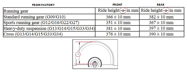

On this table:
And I quote you:
My R-line: (without sport chassis -15mm)
Front Axle from factory
L: 355mm
R: 355mm
Rear Axle from factory. Basic rear springs. 6Q0511115CD PR-1JP+0YE
L: 375mm
R: 375mm
355mm at the front match with the sport running gear on the table (351-+10mm)
So you have the sport chassis ? don't you ?
Or thanks to the table you are just in the limit of the standard running gear (366 +/-10mm) ?

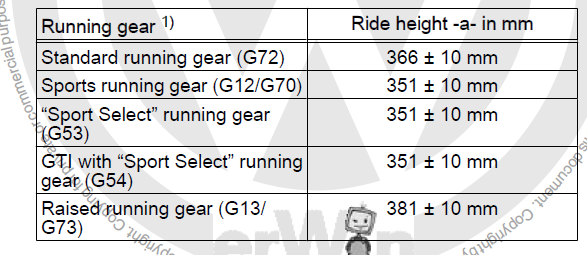

On VW Workshop Manual for the 6C (not the 6R) here are the data:

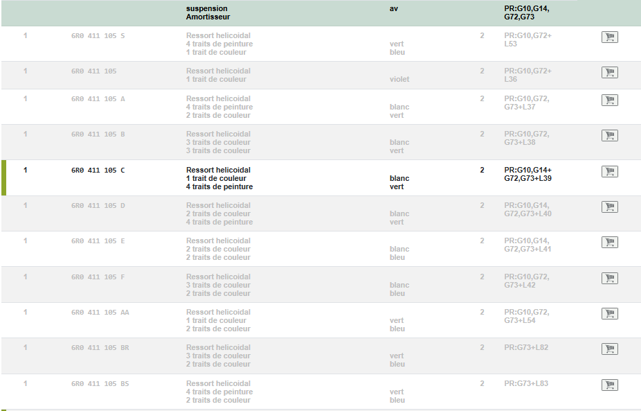

And on ETKA, here are the options availables:
Nothing is matching G12/G70 spec for the "sport chassîs". And color coding for the spring are not available on internet.

Because on my ETKA, I cannot found any information for my weight code L39.
Or it's way too much, or way too low.

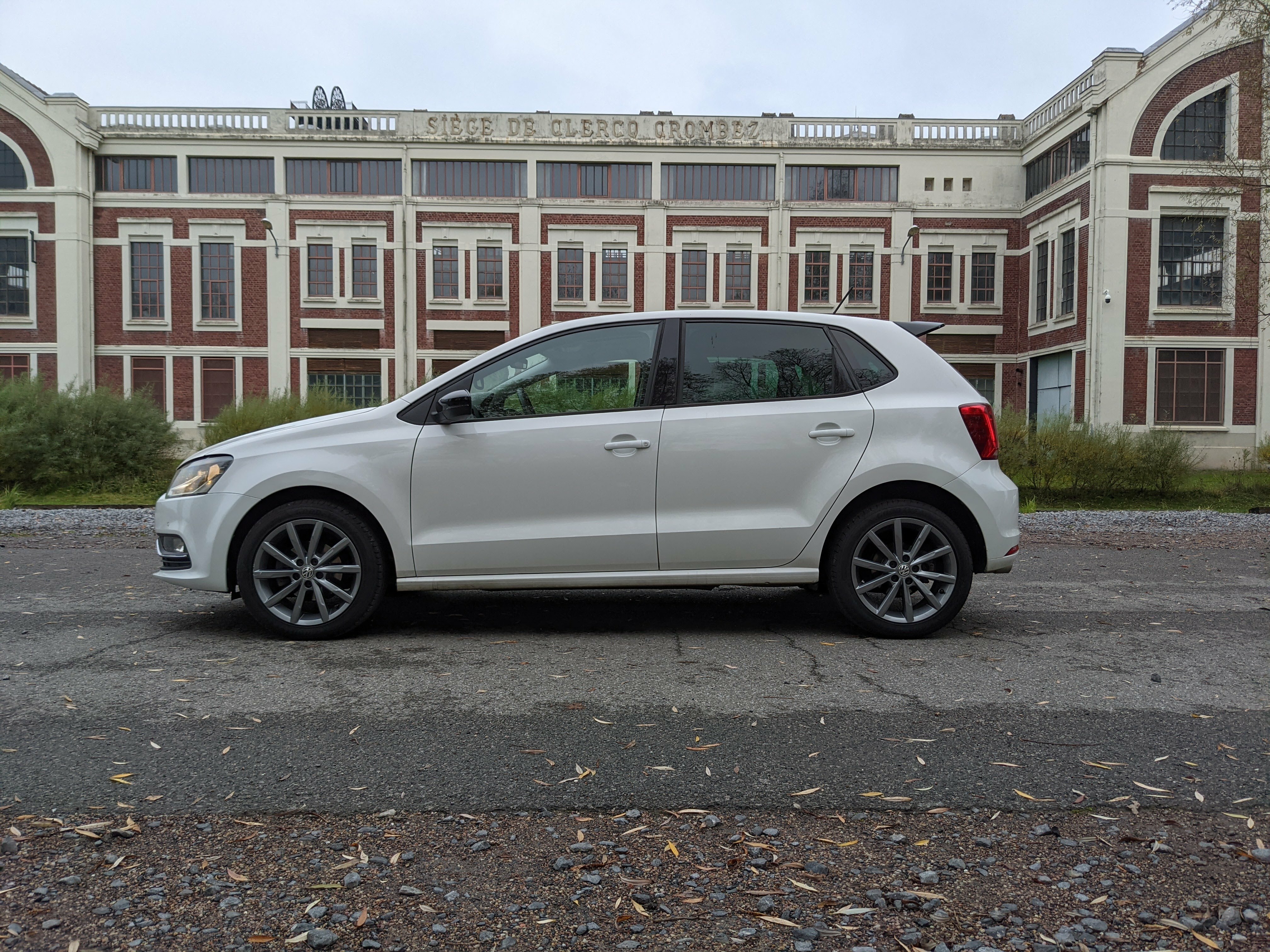

My rims is 16 inches, visually I cant see much different than what I had originally, only by measuring I see they are change front is 345mm and back is 360mm.

Tinman wrote: Fri Jan 31, 2025 3:43 pm Image
My front spring is same as ciclo, 3 white 3 green and my front shock absorber is 6C0413031AH.
To be honest, the difference is massive.
If you compare to mine:
Everything was stock, 16" rims.
With your setup, the looks is perfect. Not too low, not too high.
And I presume comfort still okay.
