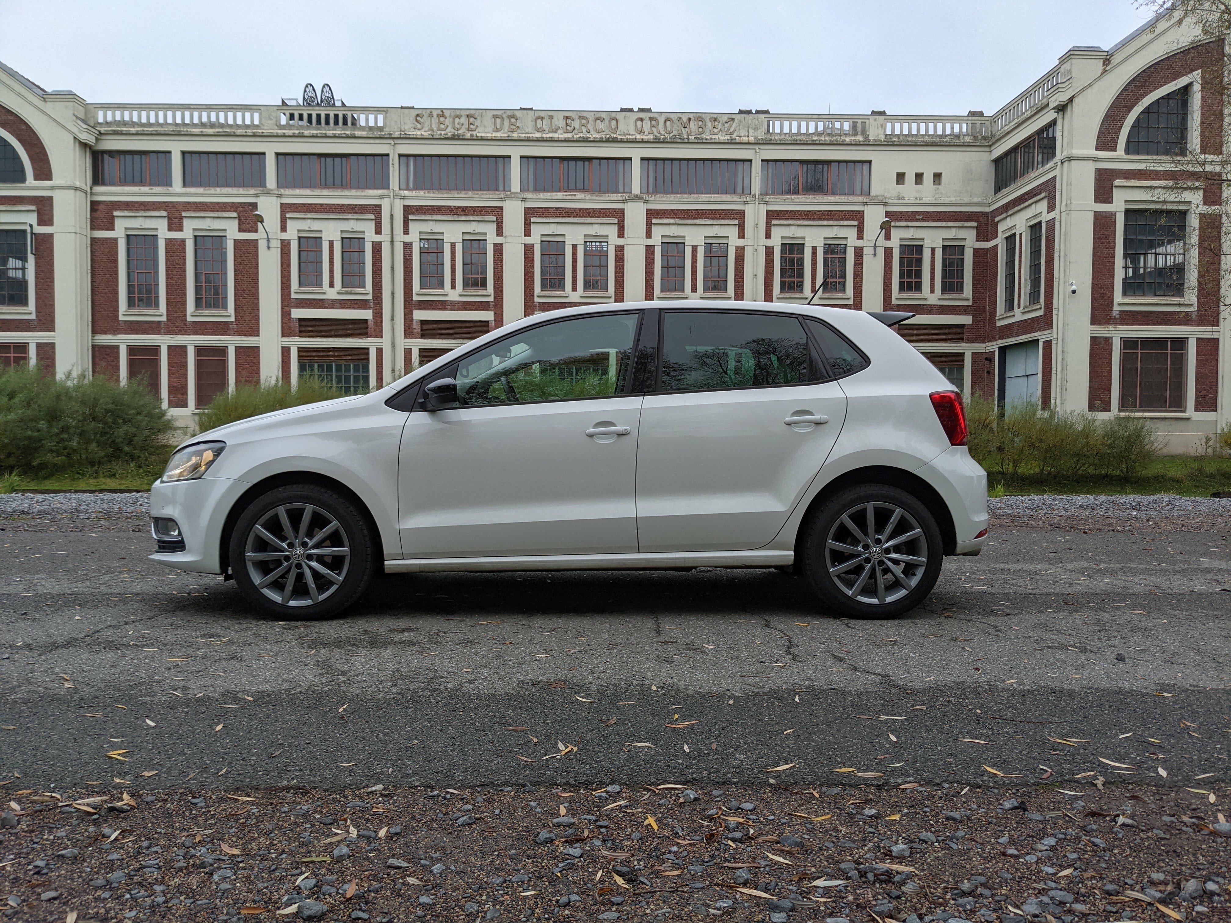

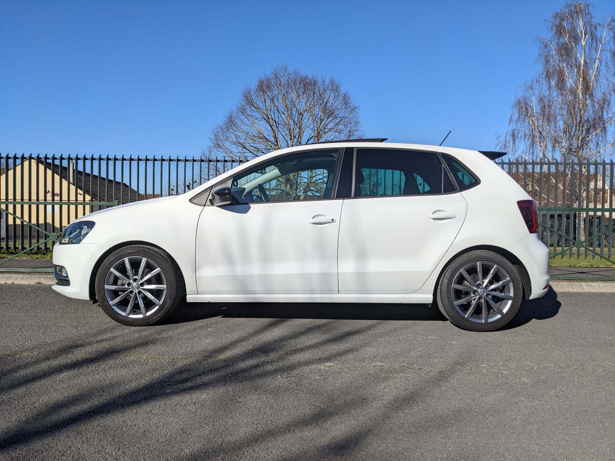

In June 2025, it will be 3 years since the car is lowered.
3 years and over 90000/100000 km.
By the past, I went for the cheapest lowering setup as:
-Bilstein B14
-EIBACH lowering spring: 6R0071677
But now I consider to switch back to stock setup for few reasons:
-Comfort
-Cabine rattle: when the weather is cold and the roads are bad, I have some rattles inside the car and it's driving me crazy.
BUT !
The way the car looks stock is...meh. The front is OK, but the back is way way too high. VW, what did you do ?
I already considered the fact of switching rim from 16" to 17"
Stock car (few years ago):
Lowering spring installed:
What are your opinions ?

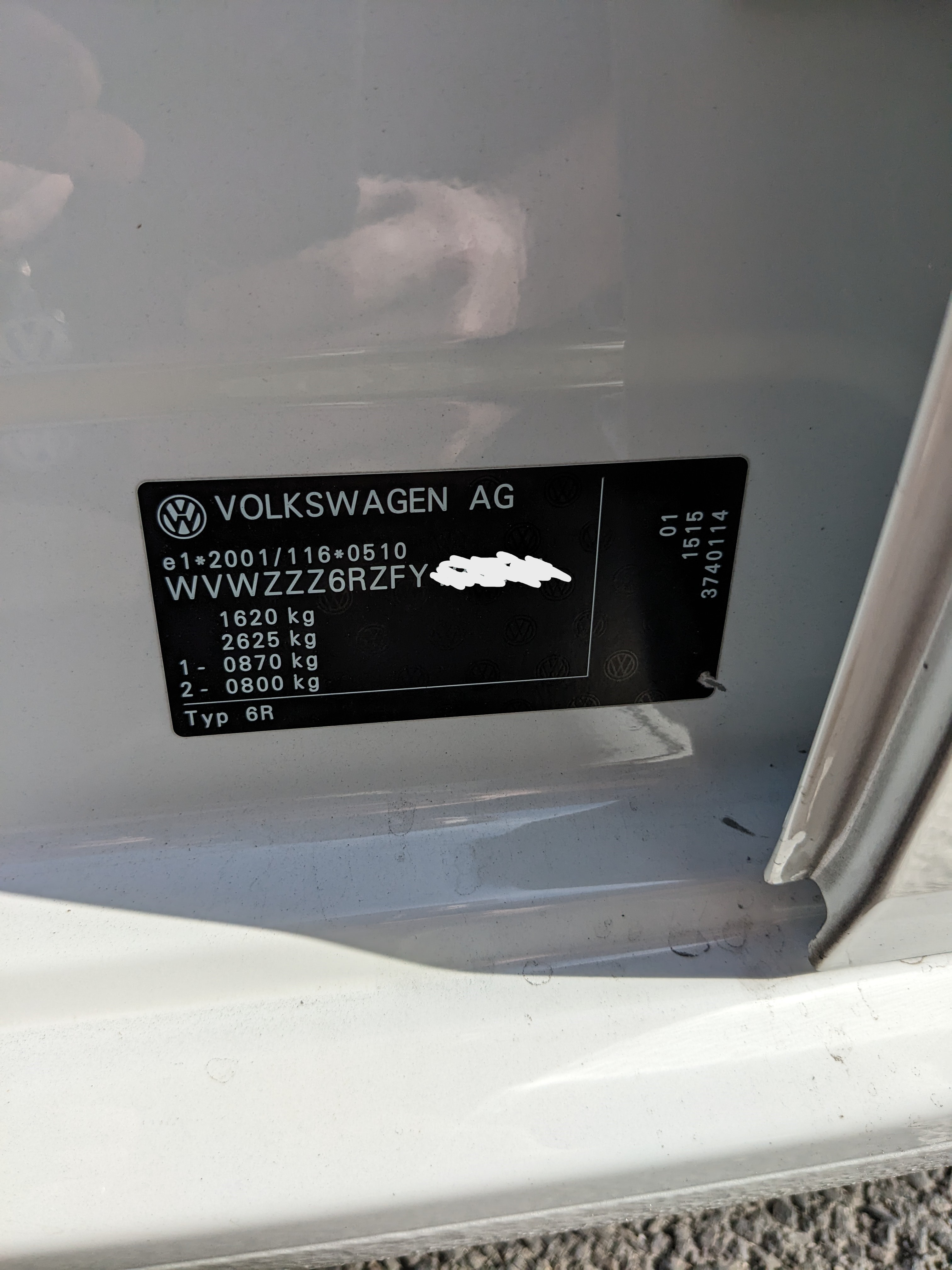

Posts: 9037
Re: Lowered or not lowered: this is the question
Yes, it is exactly that reference.
On the axle weight identification label of my 6R I have this data:
A little bird. :)
If you want comfort, opt for OEM springs from a sportier 6R/6C model... BlueGT, GTI, WRC. :?:

Thanks for the picture :)
Here is mine:
A little bit heavier at the back :roll:
Did you remember the of the part number of the front and rear spring for the GT ?
Mine is currently lowered with VW Spring kit 6R0071677
860KG
770KG
Comfort was not present with Eibach kit I suppose ? Or I mean, not comfortable as you may expected.
