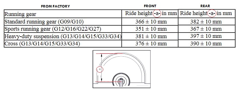

355mm at the front match with the sport running gear on the table (351-+10mm)
So you have the sport chassis ? don't you ?
Or thanks to the table you are just in the limit of the standard running gear (366 +/-10mm) ?

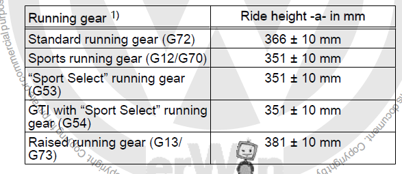

On VW Workshop Manual for the 6C (not the 6R) here are the data:
And on ETKA, here are the options availables:
Nothing is matching G12/G70 spec for the "sport chassîs". And color coding for the spring are not available on internet.

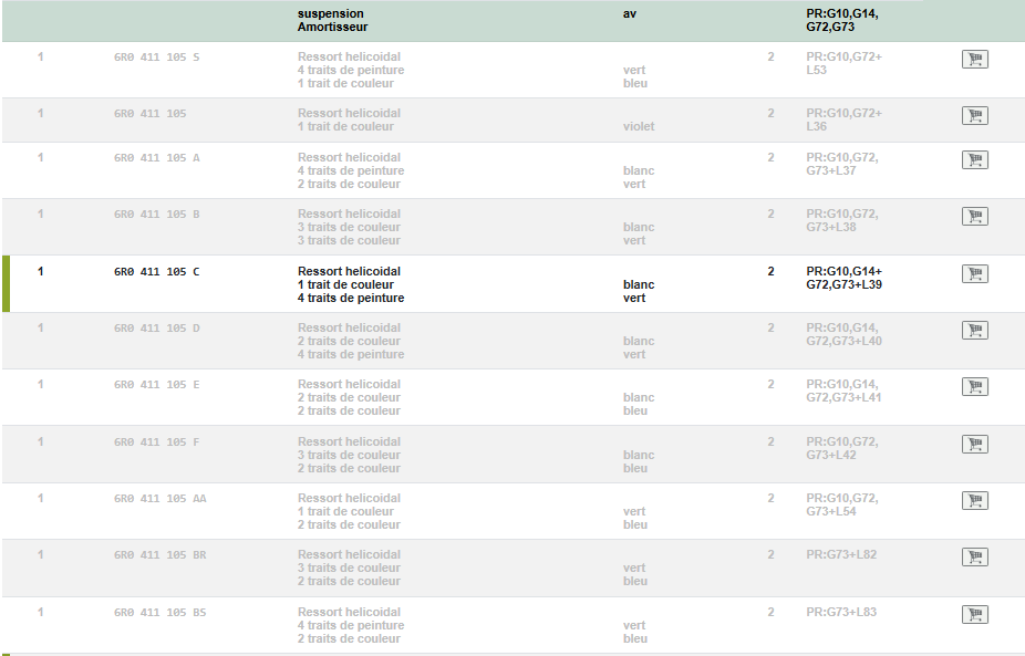

So according to the color code, part number is: 6R0411105B
PR:G10,G72,G73+L38
Maybe classic coilover could fit over those spring.
According to my VIN: 6C0413031CS
PR:G72+L39,L40,L41,L42,L54
or
Part number: 6C0413031CR
PR:G72+L53,L36,L37,L38
to match "Weight" L38 of the spring.
Funny thing is, 6Q0 511 115CL spring are not know on Autodoc or elsewhere.
Sachs is the OE to VW ?

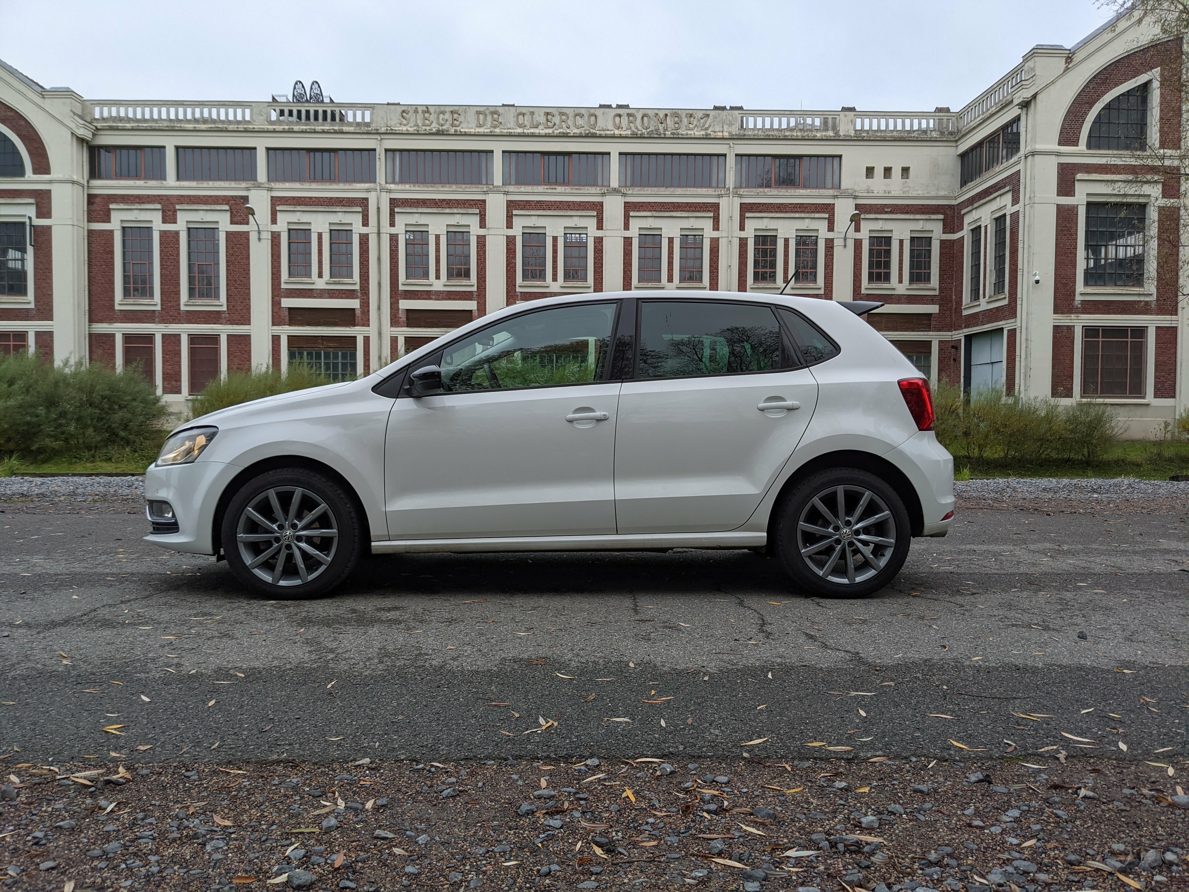

My rims is 16 inches, visually I cant see much different than what I had originally, only by measuring I see they are change front is 345mm and back is 360mm.

Tinman wrote: Fri Jan 31, 2025 3:43 pm Image
My front spring is same as ciclo, 3 white 3 green and my front shock absorber is 6C0413031AH.
To be honest, the difference is massive.
If you compare to mine:
Everything was stock, 16" rims.
With your setup, the looks is perfect. Not too low, not too high.

Btw, it's better to match "L" class weight of the coilover with the spring or the current state of the car ?
I mean, If I install, at the front "6R0411105B" (same as you), they are L38.
So for the coilover, it's better to choose:
-6C0413031CR (L38) to match the -15mm springs 6R0411105B
OR
-6C0413031CS (L39) like factory setup
