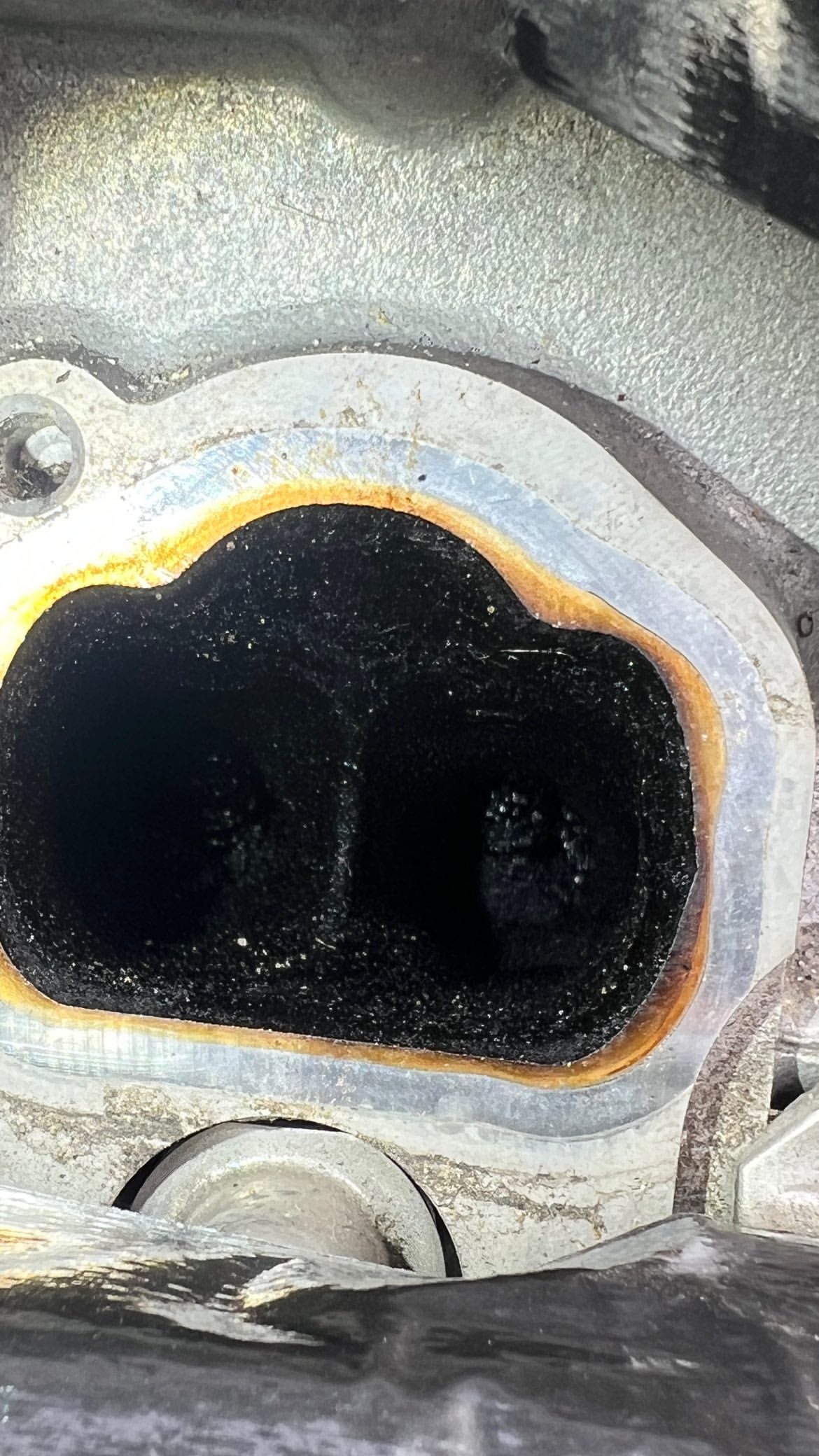

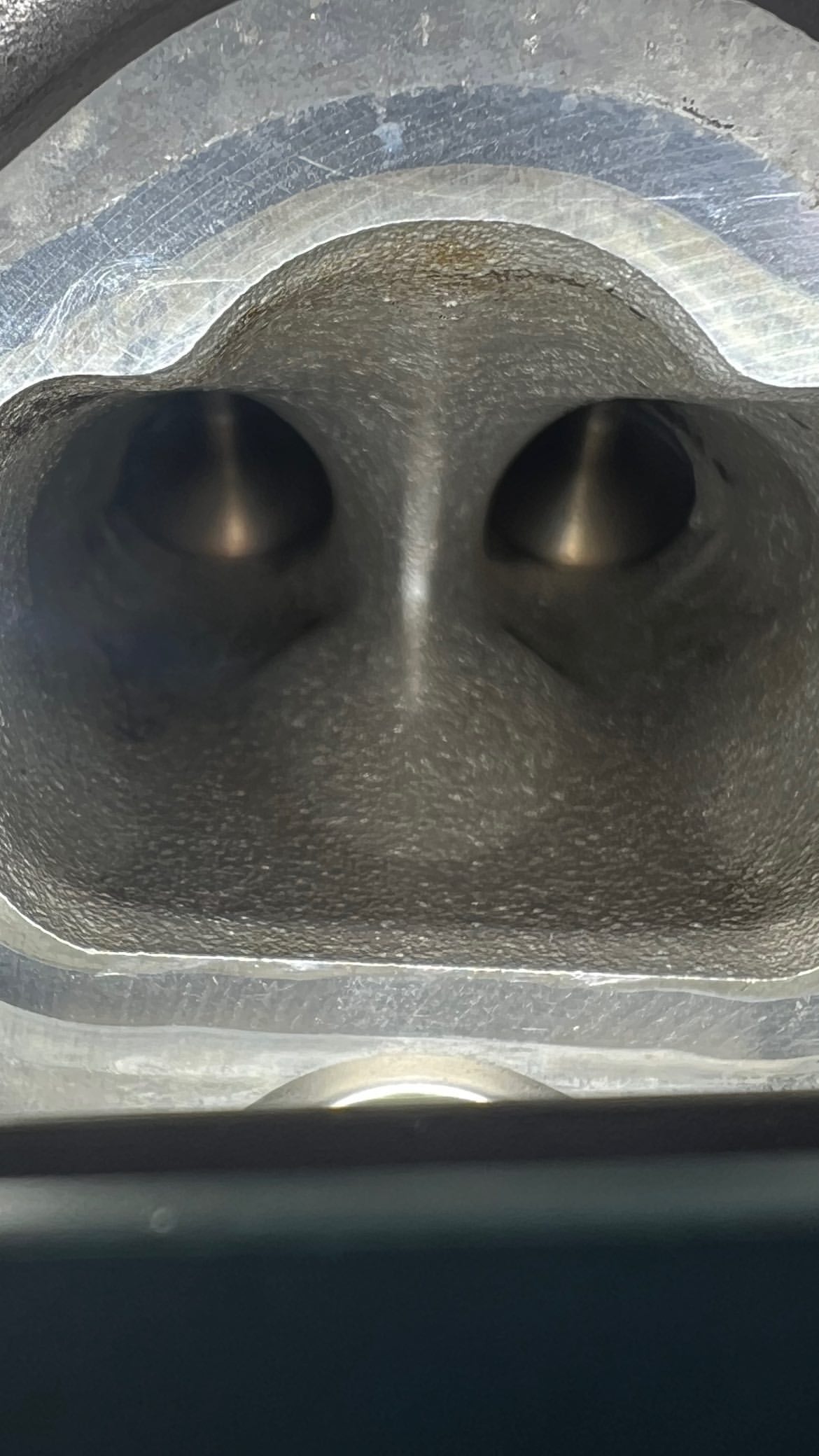

Carbon build up is an issue on EA211.
For info, It was my intake back in 2023 (?) with 150000 km on the clocks.
And after cleaning with dry ice (I called a company, specialized in engine cleaning):

Dry ice ... interesting. For doing at home I think I'll stick with walnut media as I can re-use it.
See the shape of the intake port... that bump at the top? Look on the intake manifold where it matches that location. Has flat areas that could be injector ports. The intake is already set up for port injection.
One could modify these engines to have both direct injection and port injection. The intake needs to be drilled, but there is already mounting holes on the head that could hold a fuel rail.

it seems like this cavity is intended for LPG / natural gas versions of 1.4 TSI engines. I have no direct information about this but it just looks like it.

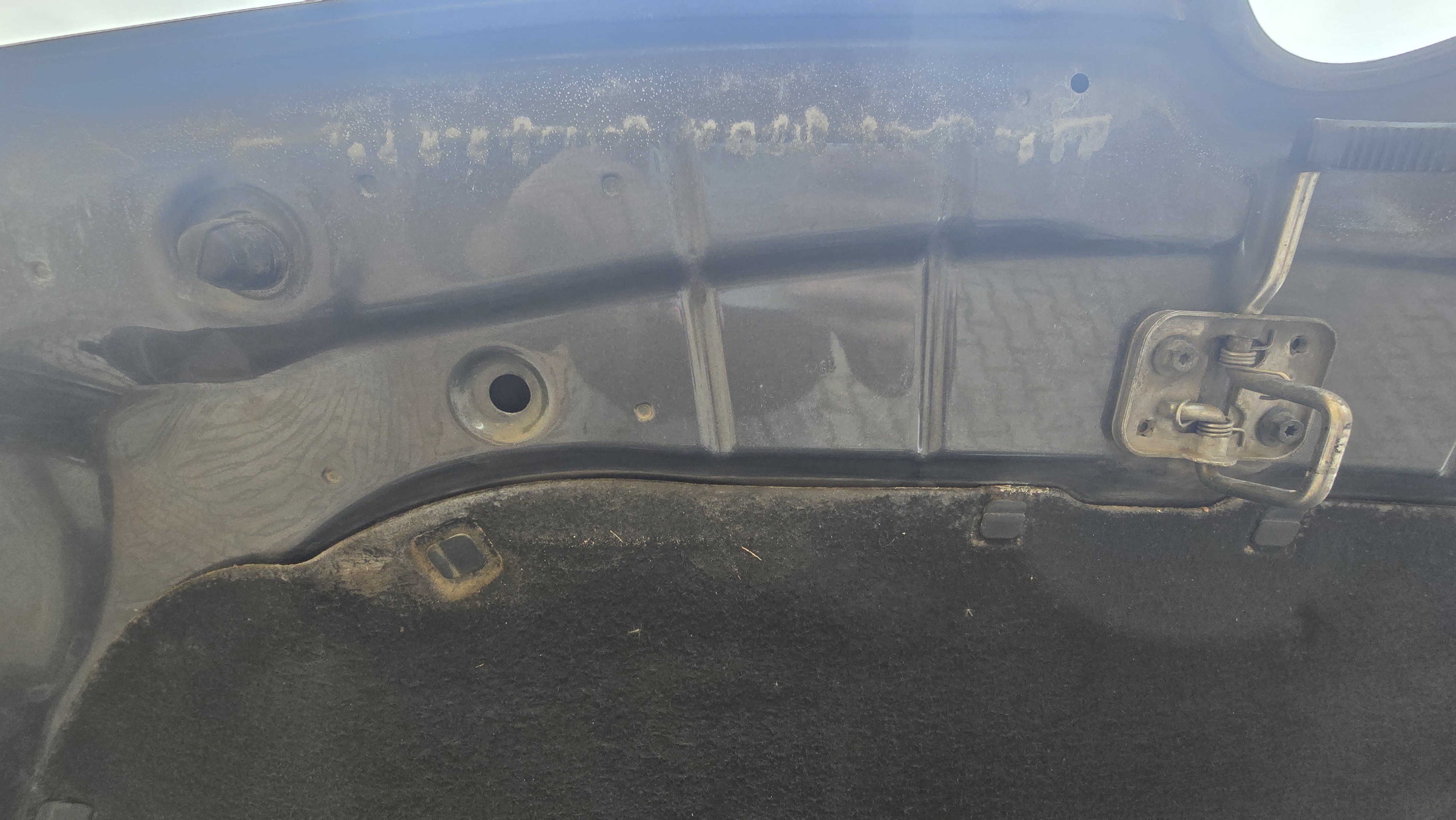

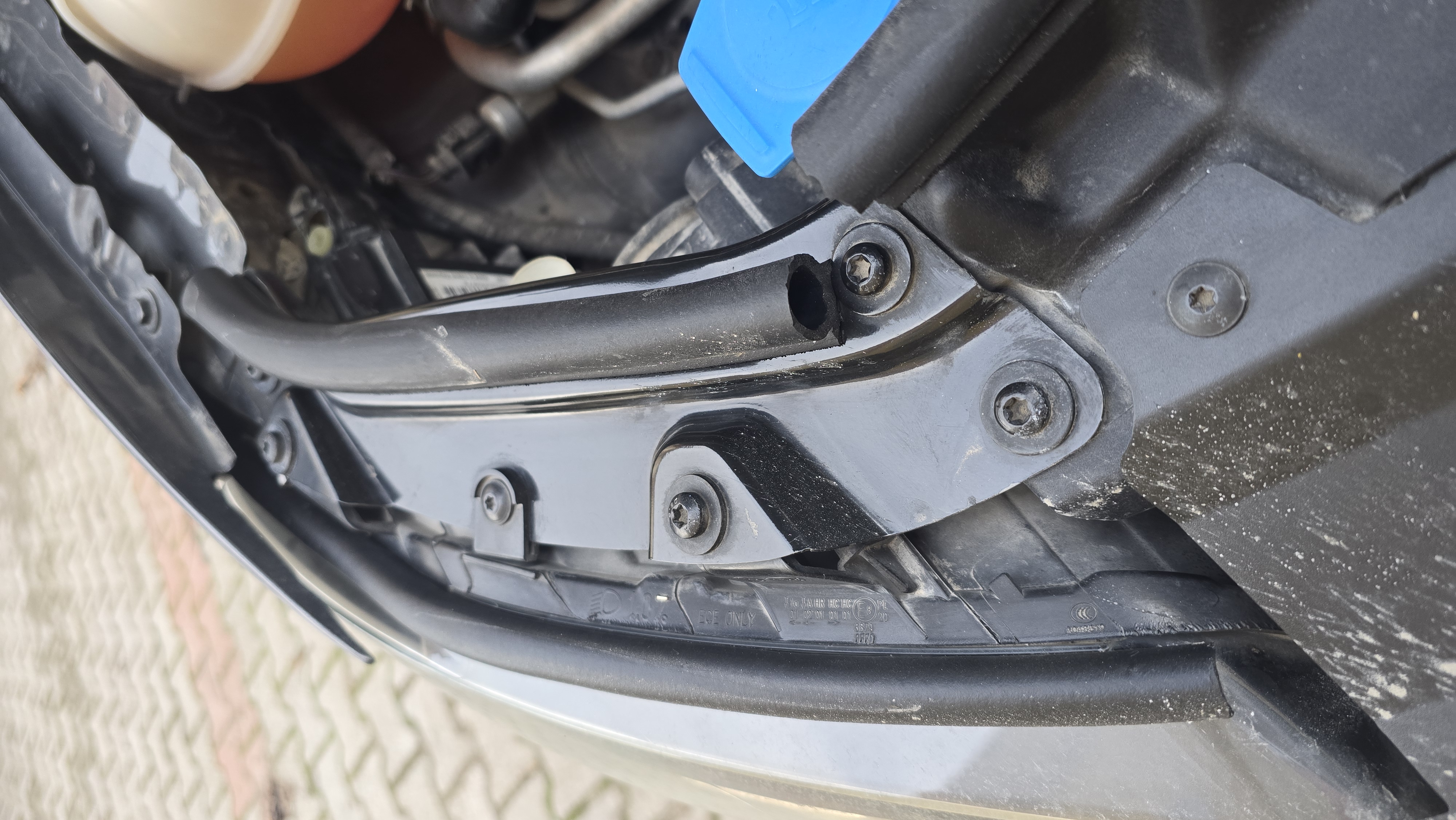

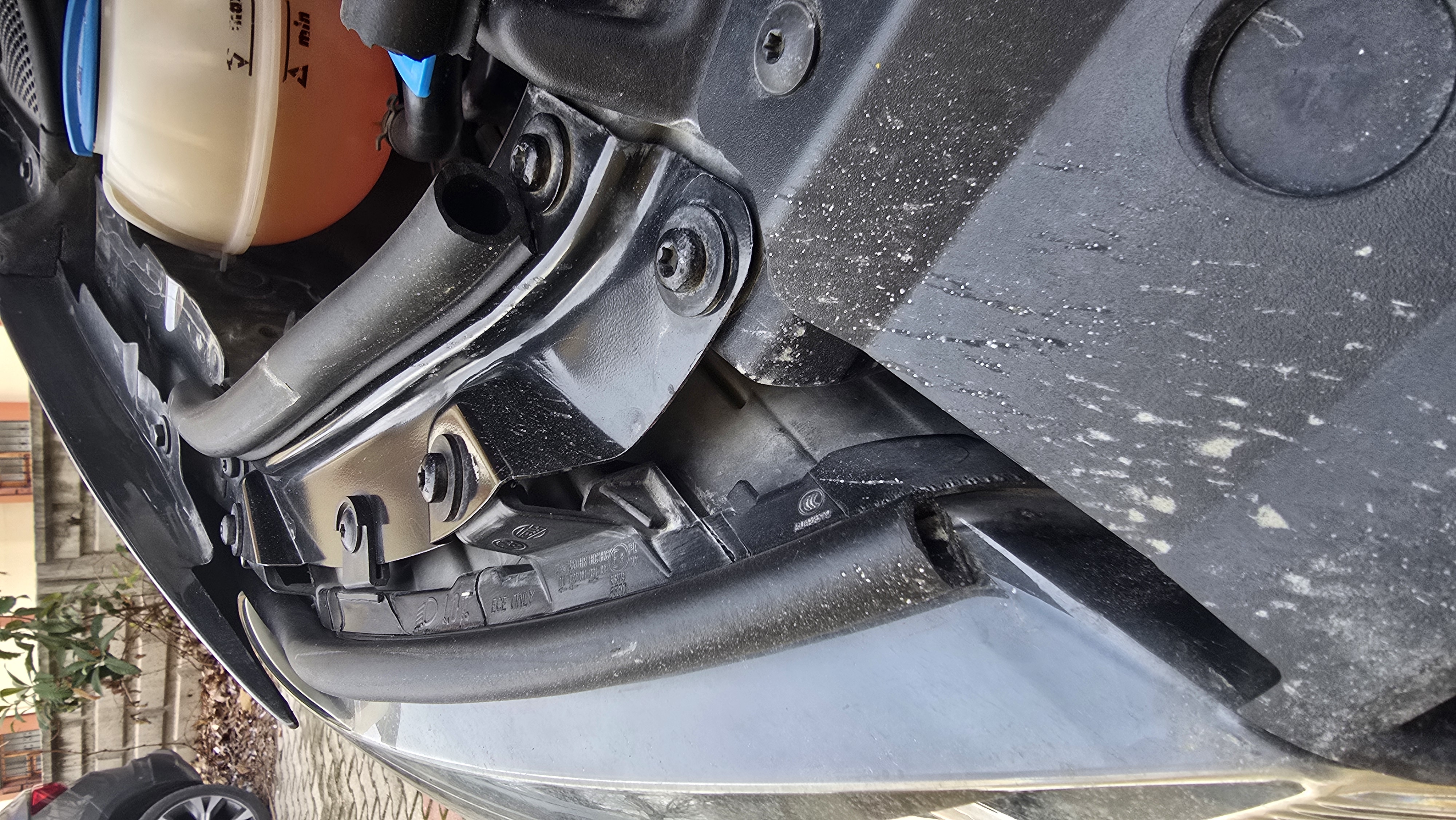

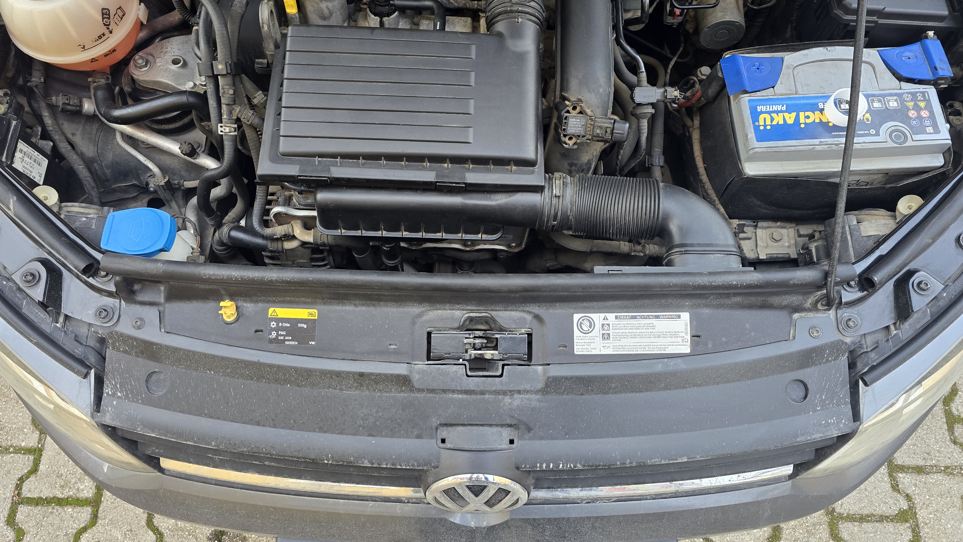

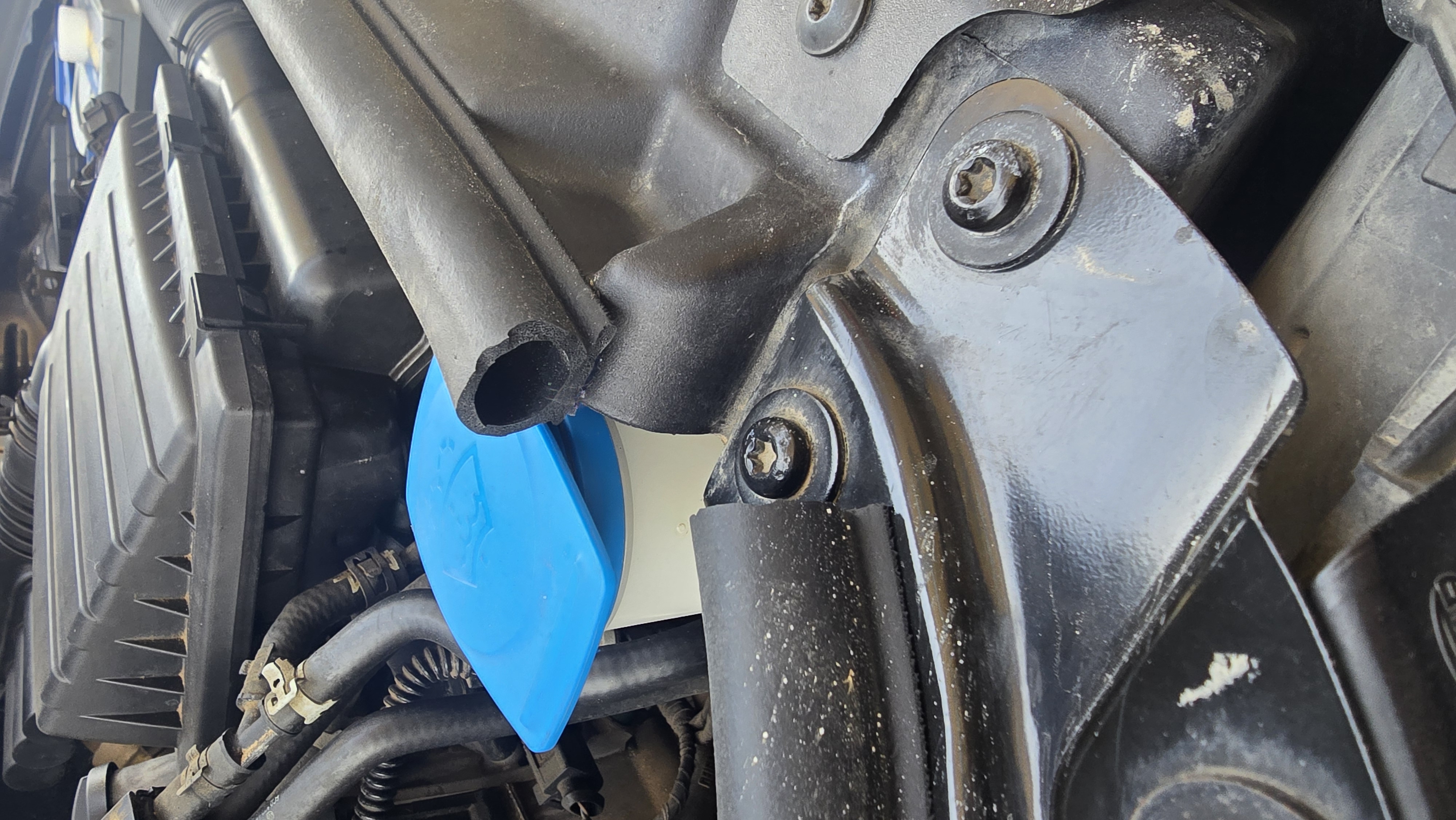

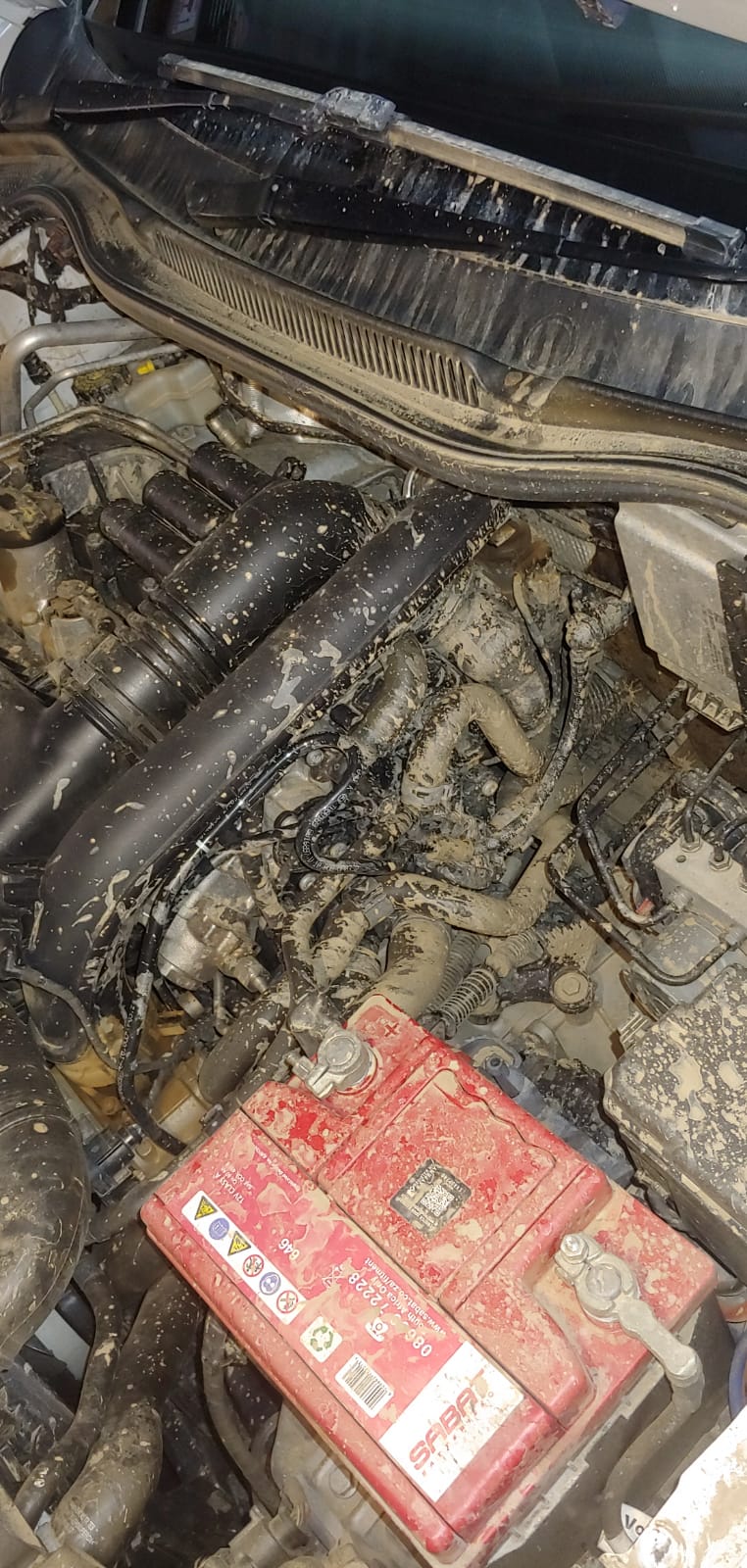

Throughout the owenrship, the car just suffered from very dirty engine bay. We didn't care this over the years but at some point it made me mad. So i started to clean everything one by one. After one week, the engine bay was dirty as before. So i started to find a solution and i found this product:
Then the question came, where do i install these without any disturbances to the bonnet?
On top of the plastic grill was not a good idea since bonnet latch sits there.
Headlight brackets were not fine since there are holes on them and they have bolts.

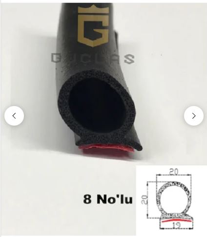

"size 8" was used for headlight bracket and grille.

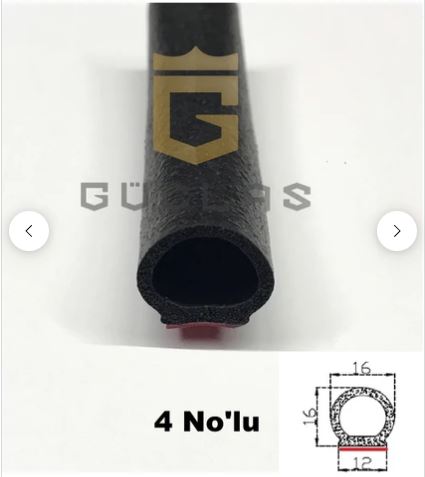

"size 4" was used for just the headlight cover only.
Otherwise the seal won't be established or the bonnet won't close.

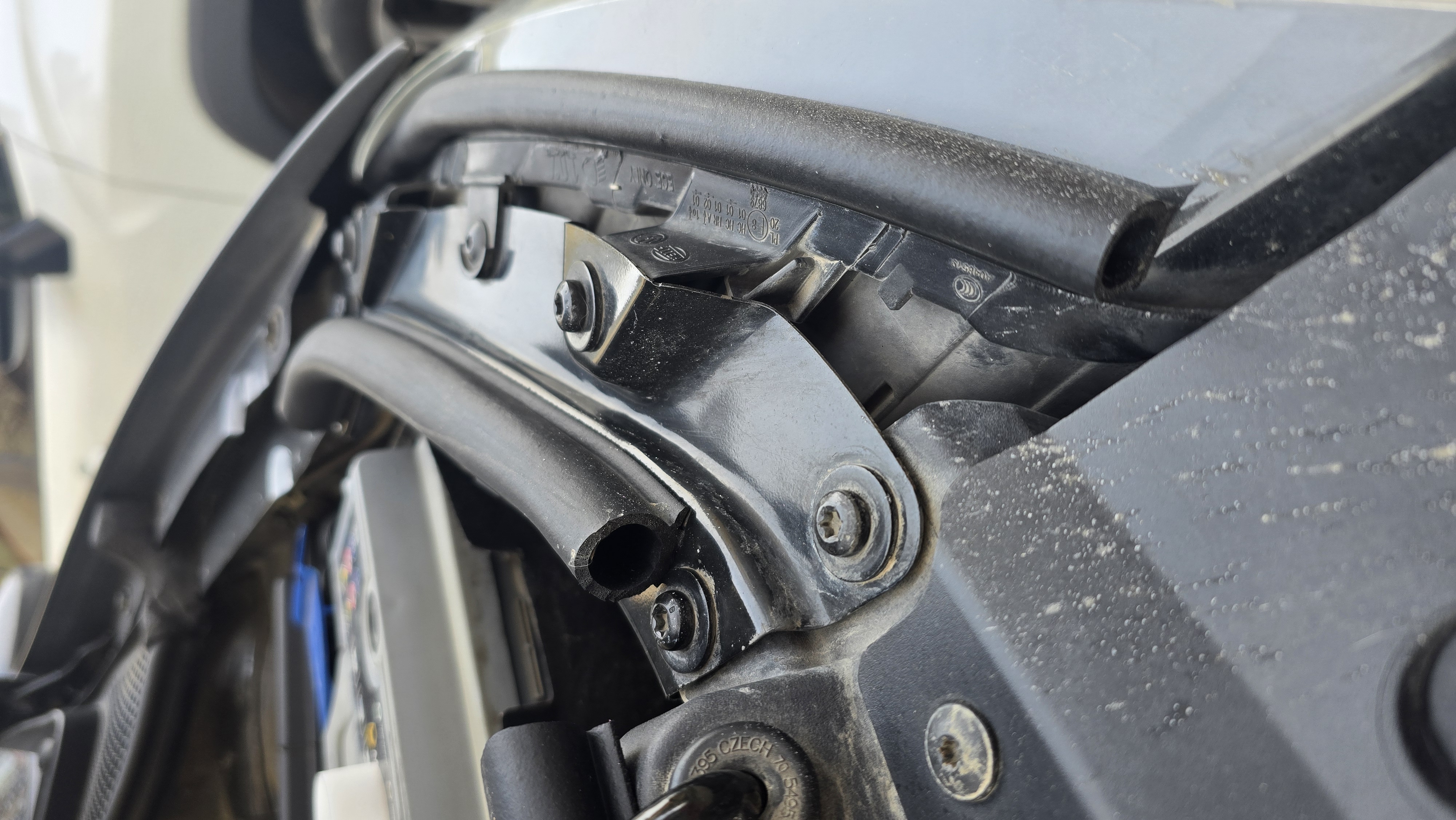

So i installed the main one at a weird position and it worked (with included double sided tape).
I recommend this solution for everyone who encounters with same problem. It surely works.

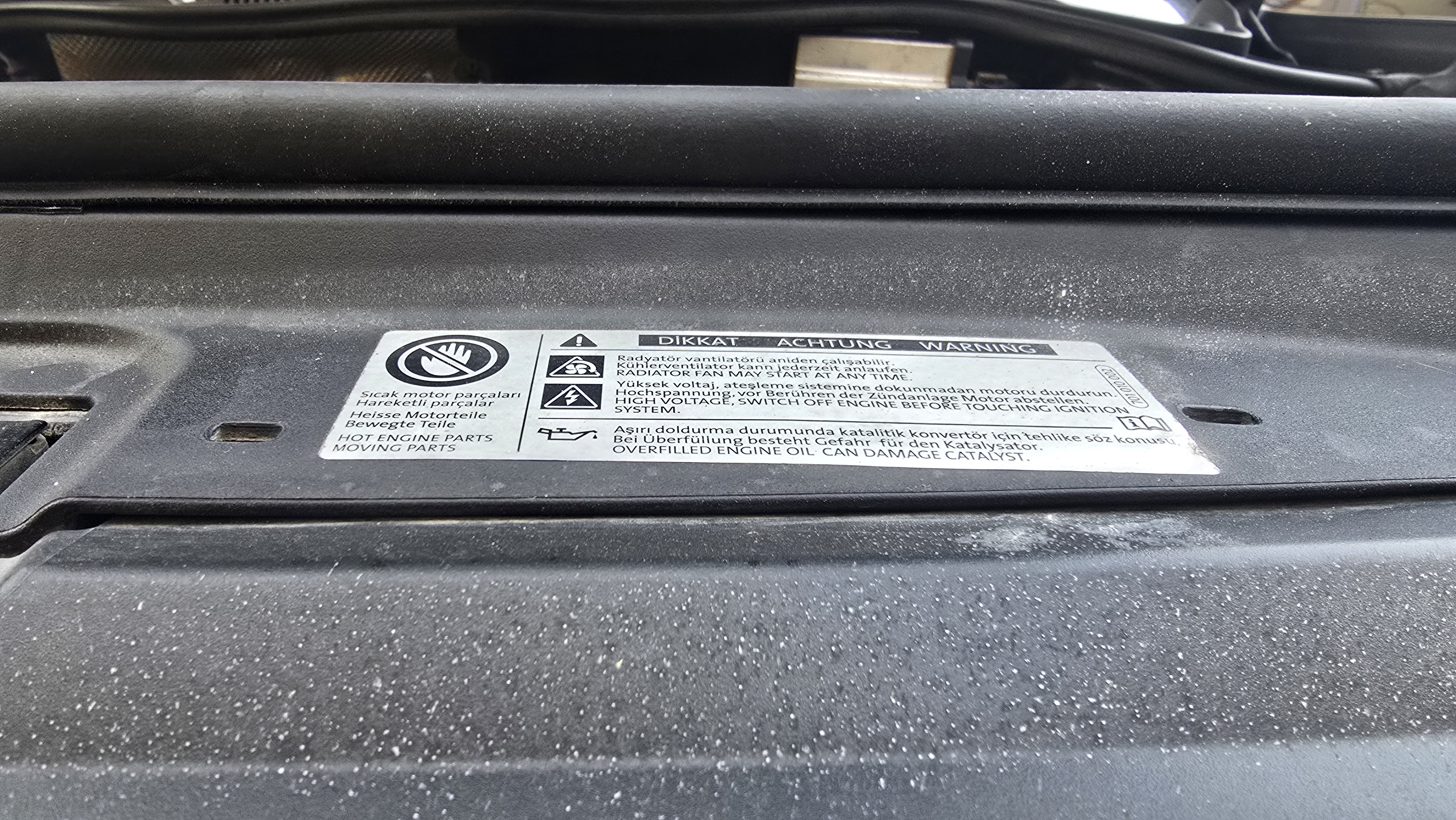

As you can see, they clearly block the dirt and seal properly when the bonnet is closed.
I am posting the other photos too, one thing i did not capture is the little "4 sized" seal was goes up to the end of the headlight, which means it extends to the fenders.

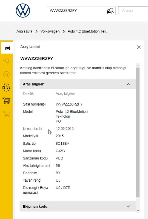

Now, as you know, these cars were built in two plants: Spain and South Africa.
There is one easy way to understand where was your car produced.
The VAG Group uses this kind of VIN algorithm:
First, the country and brand identifier code, for our case it is "WVW"
Then, i guess special section comes and this section is nearly always "ZZZ" in VW cars which i believe means blank, maybe in expensive brands or trucks it can be other story but i have no idea.
Then, the chassis identifier comes. For this generation of polo, we get "6R" (then a "Z" again). For comparison, a golf might have "1J","1K", or a passat can have "3B" or "3C". This surely depends on the car.
Then we have the model year identifier at the 10th digit. For my case, it is "F" which stands for 2015. "A" stands for 2010 and "H" stands for 2017.
11TH digit is the plant number. For EU market, we encounter "Y" (Spain) and "U" (South Africa). For more information you can check the corresponding Wikipedia page. https://www.wikiwand.com/en/articles/Li ... _factories
The rest is serial number for the car and normally for other vehicles (especially japanese originated), lower number means early production but i have no idea about VAG cars.
Normally, there is no prodived VIN checker from VAG unlike Mercedes or BMW. Unless you have the Vehicle ID paper thingy in the user manual and at the trunk, there is no way to check for your equipment. Also, you can not check your build date, only you can estimate from the glasses and production of the parts.
But there is another way actually. By using a paid website called "partslink24", you can check your equipment number and many more. This applies for all cars actually which is very handy. Here is a screenshot for my vehicle information, in turkish.
Also, you can check the equipment info but sadly i have no document for that. But i am sharing the list of "factory" code thingies in my car. Normally, in vehicle factories, the vehicle is built with this equipment codes. A single vehicle might consist from 100 and more codes and these are not option codes. Without a single or wrong code, whole system will get confused. This is a bit easier in passenger cars but buses and trucks have crazy list of codes since they are more specific.

Those codes are intended for production and end user has no relations with these. But they are very helpful if you want to have an idea what are you dealing with. It is sad that "VAG" does not give us enough information about our vehicles, at least i want to know the manuf. date of my vehicle.
And since my vehicle is pretty much lacking most of the equipment, i wonder a fully spec'd vehicles equipment list even though they are pretty rare. :( :roll:
If your VIN says South Africa and you have problems... my apologies. :-D
Also,
https://igorweb.org/equidec.aspx
Useful for option decoding, but I have found it to be incomplete.
Nobody has a complete set.
Also the codes, especially for suspension, is super vague.

Nice idea on the rubber 'D' seals.

Also, don't worry about your engine bay, it is spotless...
Unlike this:
That was probably 2 years ago and I'm still finding bits of mud on the car.
