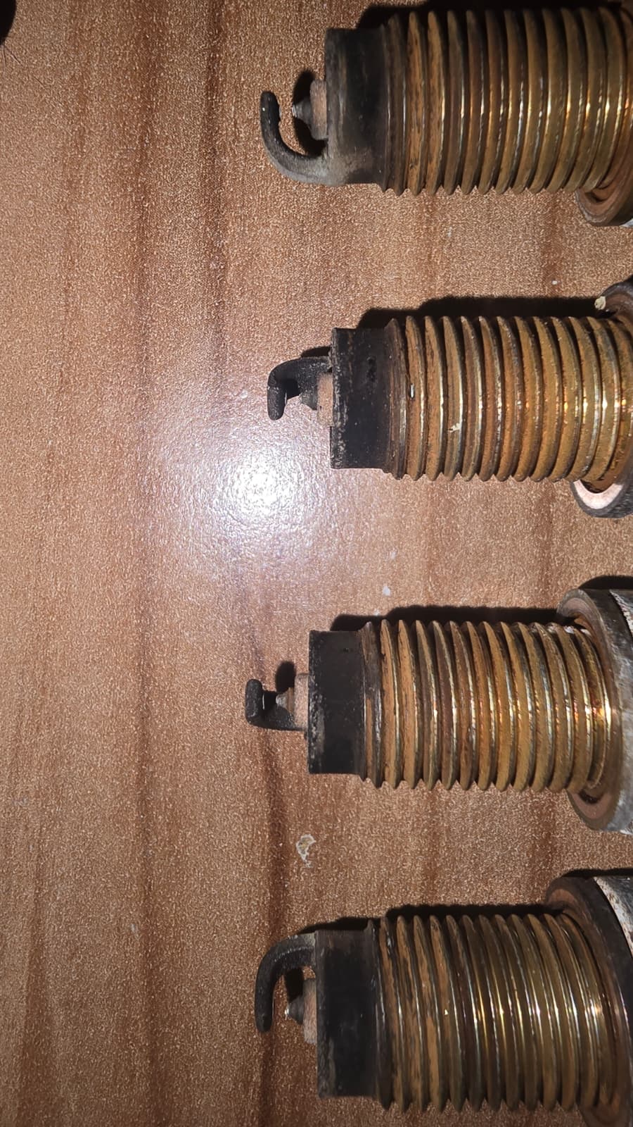

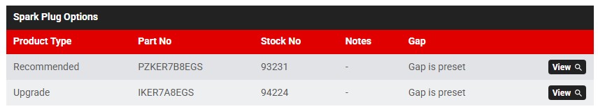

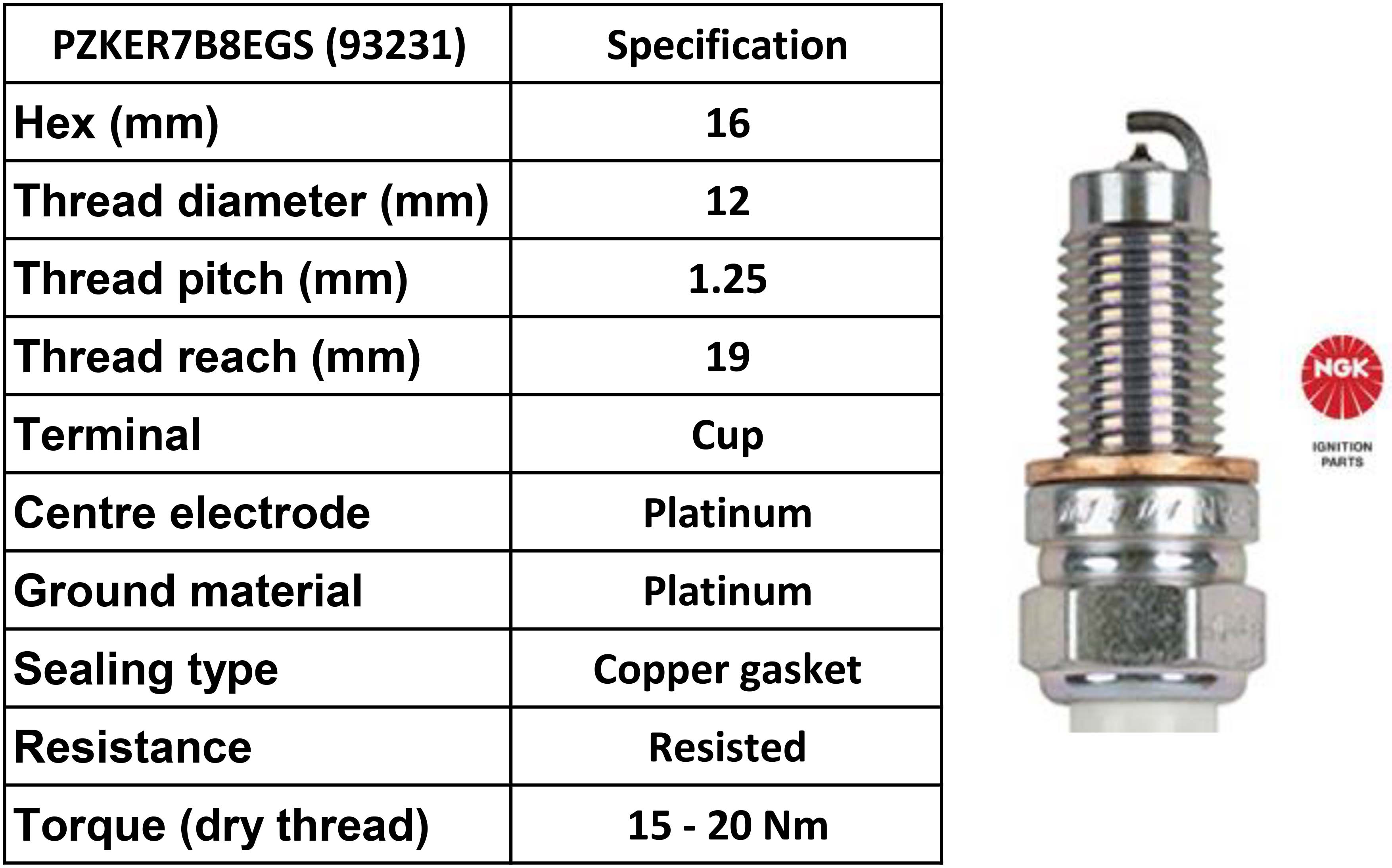

Hello everyone, in the recent months i was using this forum very frequently now i wanted to share my experiences and adventures throughout the ownership of the car. I am scissa and i live in Turkey. I am a mechanical engineer and had experiences in automobile industry at production plants.
The car is 14/5/2015 Comfortline equipped with CJZC EA211 1.2 TSI 90hp with PED 5sp. manual transmission. It has been purchased from the first owner at 8/2018, Currently it is at 103600 km's and it is increasing.

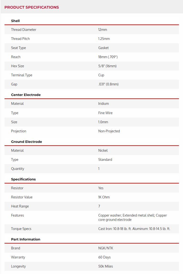

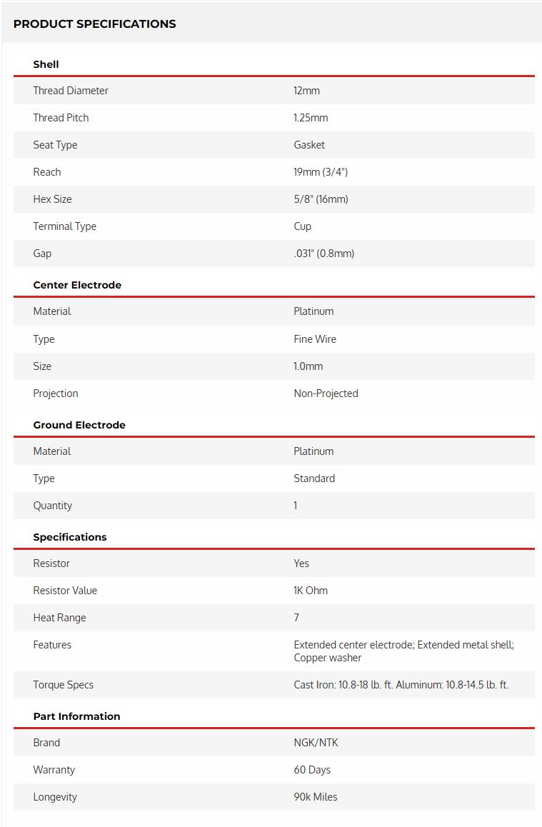

Recently, i have changed the spark plugs with a different one from the catalog and parts list. I used NGK 94224 IKER7A8EGS Iridium, which is service part for EA211 evo, or 1.5 TSI and 1.0 TSI models.
The stats were looking the same except the material and reach of the spark plugs. The EA211 1.2 and 1.4 TSI engines do originally use NGK 95463 PKER7A8EGS Platinum plugs.
I believe Iridium plugs are better compared to Platinum ones.

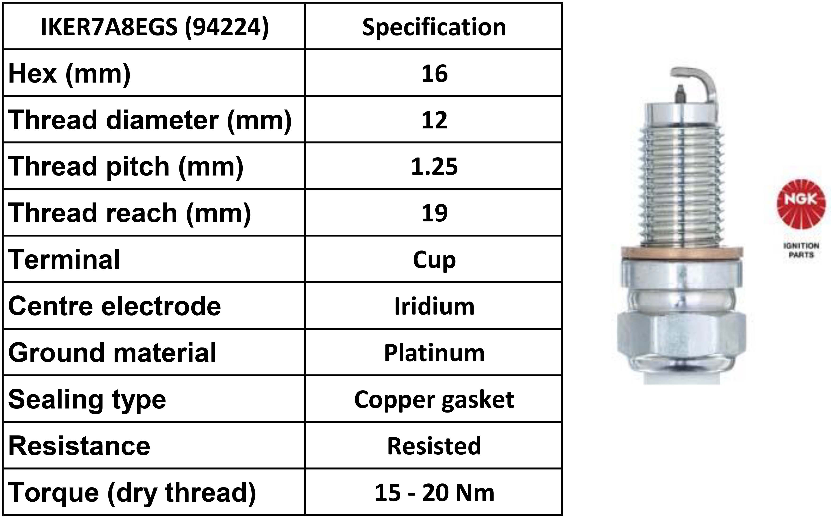

Since there was nothing to lose, I wanted to give it a shot. The specs of the plugs are:
Image Platinum Plugs
Image Iridium Plugs

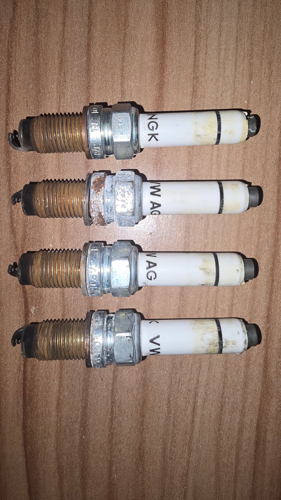

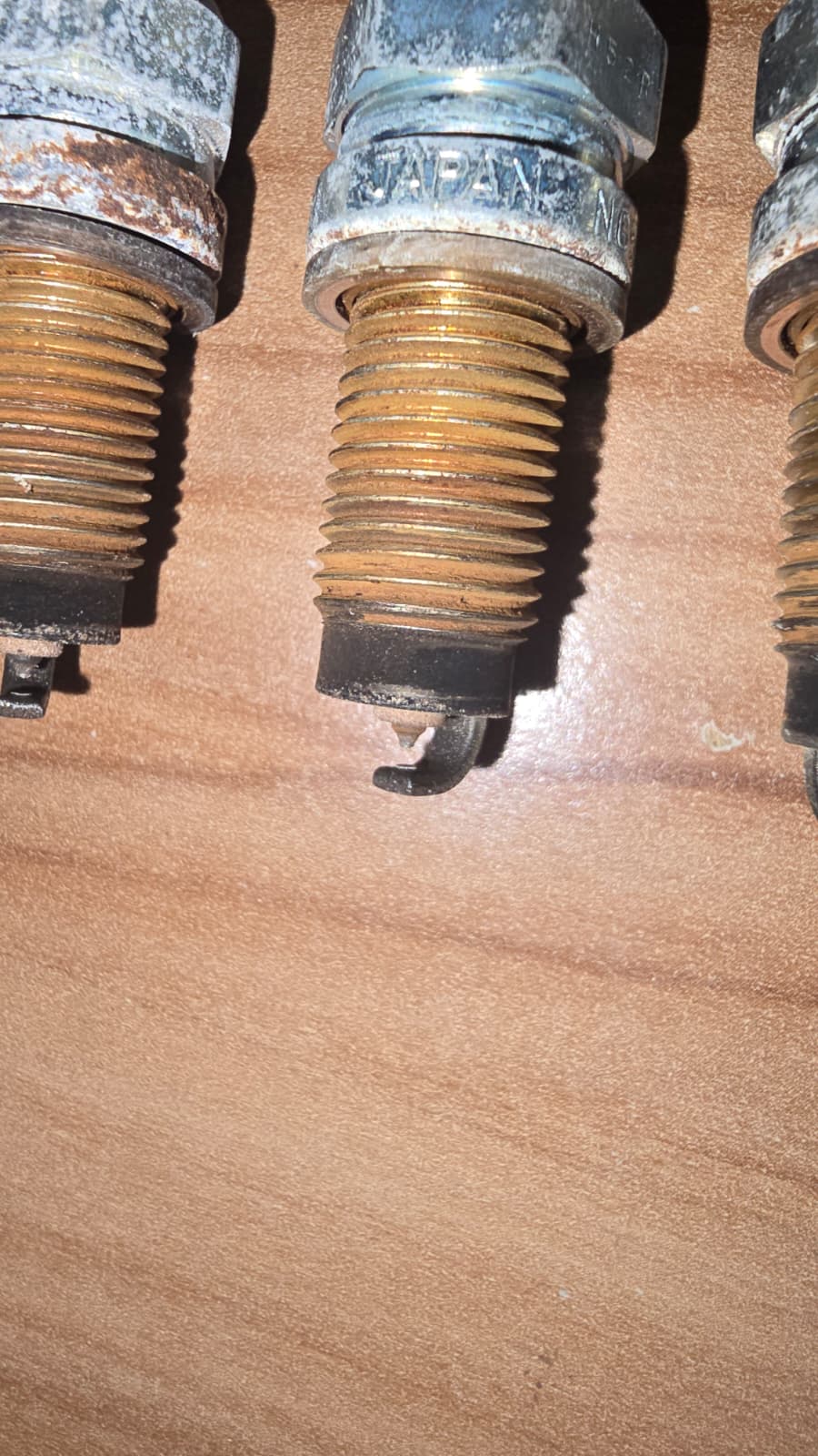

When the plugs were original, the car was not misfiring on VCDS but i was definitely feeling them randomly at idle. I guess they were below the threshold to register as misfire.
When the plugs were changed first, the idle was horrible and the engine was about to leave the engine compartment :lol:
After few start and stop cycles, the result turned out to be absolutely amazing. Now the car is not sluggish anymore at any condition, it can pull from stand still like a rocket, or no need to downshift when climbing a hill with very low RPM such as 1300. Also, it consumes less fuel now.

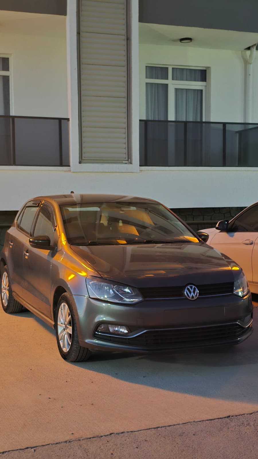

Here is the car
The car
The car
WhatsApp Image 2025-12-28 at 01.19.56.jpeg (95.39 KiB) Viewed 17250 times

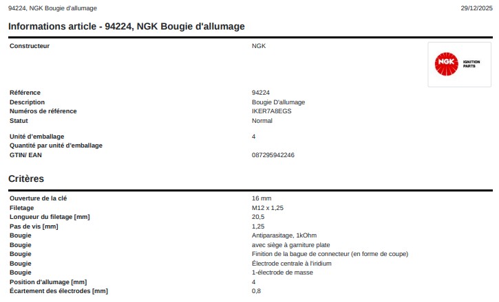

Iridium plugs
Iridium plugs

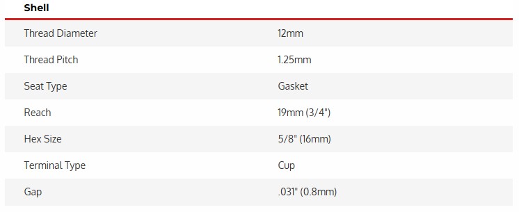

Platinum plugs
Platinum plugs

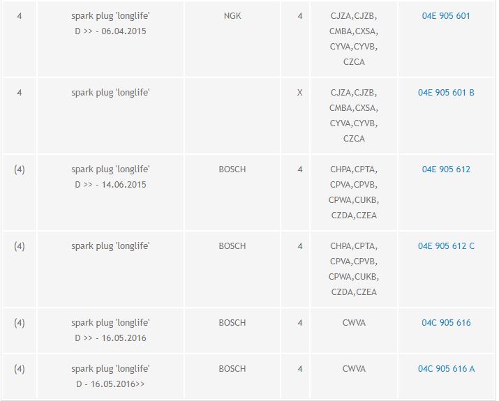

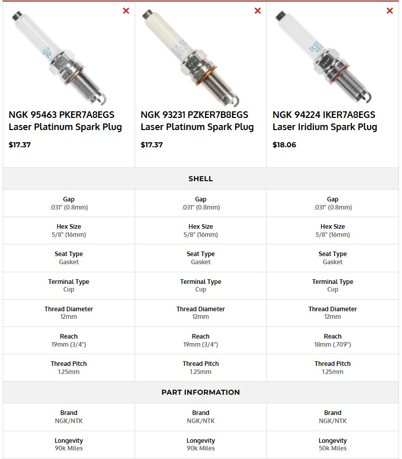

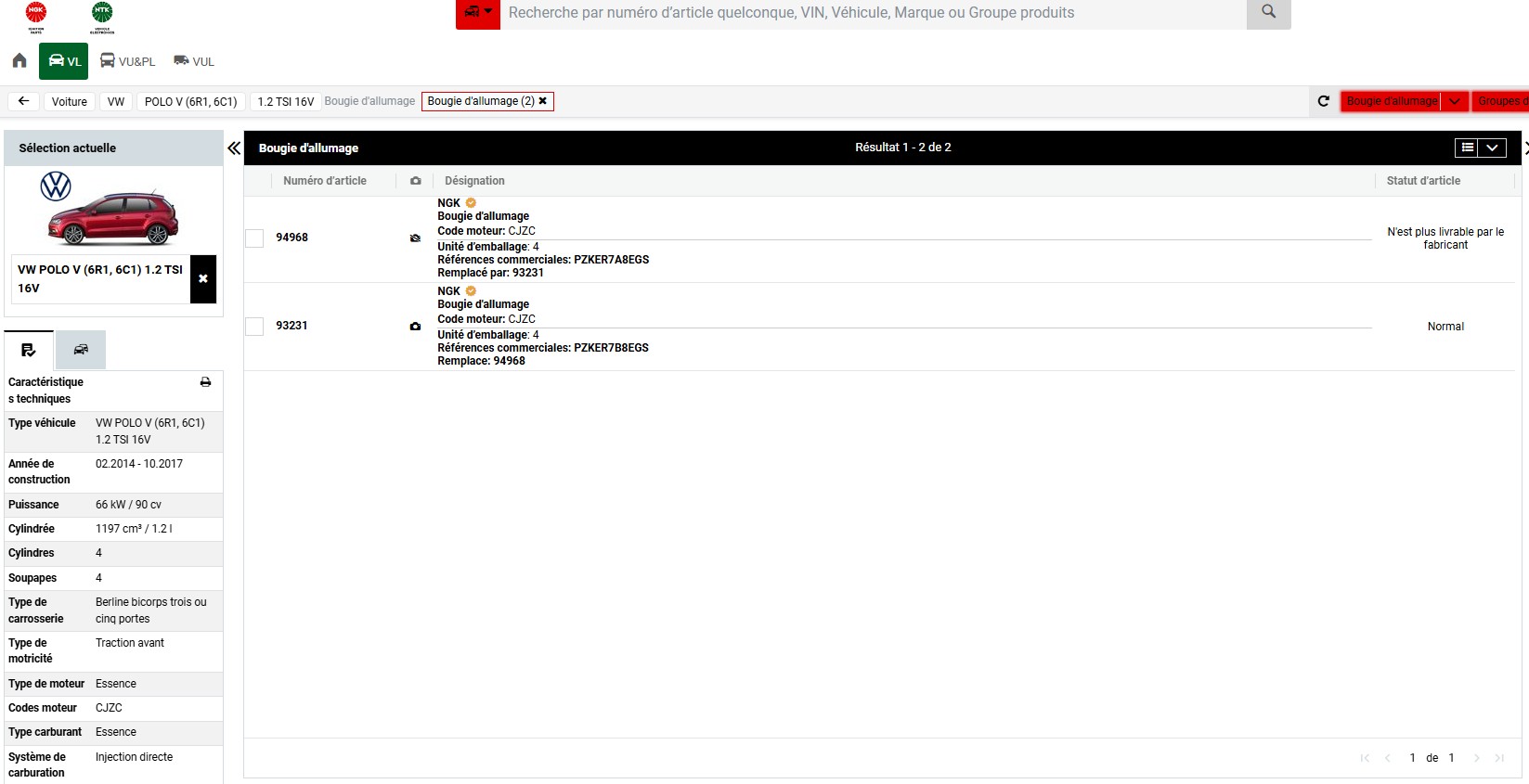

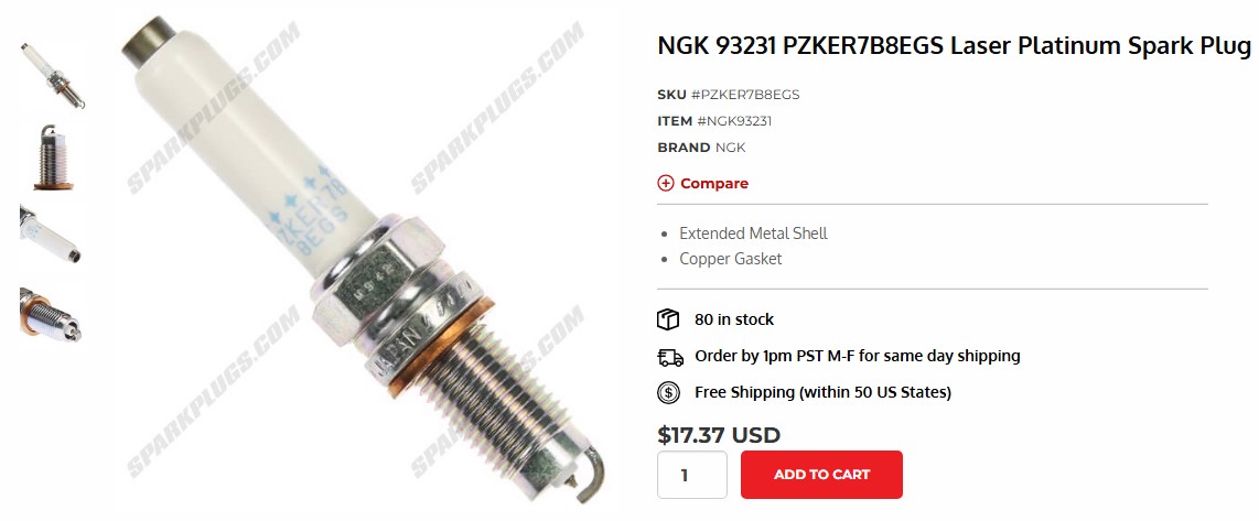

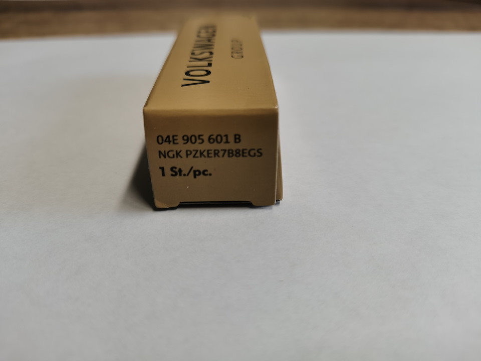

Your stories about spark plug is quite interesting but... there is something I do not
understand.
My car is end 2014, 1.2 TSI 16V E211 engine CJZC.
On ETKA, the P/N of the sparks plugs are: 04E905601B
According to NGK website part's, it's the "PZKER7B8EGS" (­94968, replaced by 93231) and not the "95463" as you wrote previously.
Capture d’écran 2025-12-28 150749.jpg (146.07 KiB) Viewed 17200 times

Yes, i also replaced the factory fitted - in 2015 "A" version of these spark plugs with the "B" version, I never found out if the NGK "A" and "B" versions were exactly the same as the "A" and the "B" versions of the VW Group part numbers, but they seem to work okay.
What I discovered when I first fitted them to my wife's August 2015 VW Polo 1.2TSI 110, ie a CJZD engine, was that the SEAT Ibiza and maybe SEAT Leon with the CJZD engines were listed by NGK use the "B" version for 2015 built cars, but the VW Polo with the CJZD were listed as using the "A" version while the CJZC was listed as using the "B" version of the NGK spark plug.
I put that "irregularity" down to just a mistake on the part of NGK Europe, as by that time, the VW Group parts listing quoted the "B" version of the VW Group rebranded NGK spark plugs.

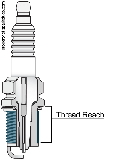

So what are the difference between the A and B version ?
Because according to some website, some spark plug listed in the first post have a longer thread (the iridium one).
So it's quite confusing.

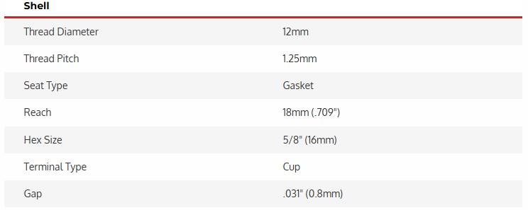

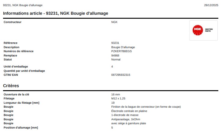

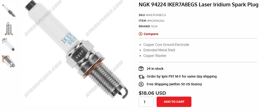

It's even more confusing when you see contradiction from the manufacturer like this:
Here: thread lenght is 19mm between the two
And here ? 19 and 20.5mm
Capture d’écran 2025-12-29 163504.jpg (40.71 KiB) Viewed 17126 times
Capture d’écran 2025-12-29 163536.jpg (41.3 KiB) Viewed 17126 times

Very confusing. Even the specs in the 1st post indicate 1mm shorter on the Iridium.
If I hadn't done my plugs last year and spent a fortune on them, I might be looking at getting these Iridium. I'll wait until the next 100,000km is done. :-D

Only way to find out is have the 2 plugs side by side.
Go to dealer, ask for both plugs and then compare.
Perhaps the 20.5mm is without washer.
I just looked up the plug for the 1.5tsi (From a Taigo) and 1.0tsi.
Part 05E905602B lists with a 26.5mm to 28mm thread length.
Again, 1.5mm difference so some might be excluding the washer.
Not doing much digging on ETKA, but I don't see that lining up with the service part mentioned for the EA211 EVO.
And I'm not going to dig further into ETKA right now... it's 30C and 9PM at night ... Dying in the heat. :mrgreen:

So, the the CJZC/CJZD engines, the sparks plugs are "04E905601B"
Or "PZKER7B8EGS" (93231):
So on NGK website:
-"04E905601B" (PZKER7B8EGS (93231)):
Capture d’écran 2025-12-31 195625.jpg (68.32 KiB) Viewed 17043 times
Capture d’écran 2025-12-31 195726.jpg (22.61 KiB) Viewed 17043 times
-NGK 94224 IKER7A8EGS:
Capture d’écran 2025-12-31 195644.jpg (70.39 KiB) Viewed 17043 times
Capture d’écran 2025-12-31 195741.jpg (23.52 KiB) Viewed 17043 times
So the Iridium one is shorter than the platinium one of 1mm if, the NGK website said the truth.

Also visually shorter on the exposed part below the threads, but both are 13 exposed thread in each photo.
The platinum has a more shrouded tip compared to the iridium.
So anyway, I went to dig up the OEM plug I got out of my CJZD. Measured with caliper from base of washer to end of shroud: 20mm. Threaded part of that is just 16mm long.
All looks good then. Would be interesting to try the iridium and see if I get the same results. Pricey experiment for me though.

The "reach" lenght is indicated as following:

Here are the main sparks plugs we were talking about:
Capture d’écran 2026-01-01 142310.jpg (115.77 KiB) Viewed 16992 times
For wathever reason, this website (https://www.ngkpartfinder.co.uk/catalog ... POLO/2015/), indicate the "95463" for the CJZD
which is the same engine as CJZC.
But in both case, it"s indicated that both 95463 and 93231 are replacable by 94224
Capture d’écran 2026-01-01 141416.jpg (27.13 KiB) Viewed 16992 times
Capture d’écran 2026-01-01 141439.jpg (23.58 KiB) Viewed 16992 times

2226
Posts: 561
Re: Scissa's 2015 Polo 1.2 TSI
Post by 2226 »
Le_Combattant wrote: Wed Dec 31, 2025 10:52 pm We are agree that the sparks plugs you have on your CJZD are the 04E905601B ?
Yes, they were B.
Le_Combattant wrote: Wed Dec 31, 2025 10:52 pm So, in this case, the iridium could be installed.
Would assume so then.
Le_Combattant wrote: Wed Dec 31, 2025 10:52 pm The "reach" lenght is indicated as following:
Everyone has different interpretation it seems.
In this case, it measures 18mm on the B plug I have.

Now, if we check the prefixes of 1.0 N/A, 1.0 TSI (which is based on 1.0 N/A), 1.2 TSI and 1.4 TSI EA211 engine families, it is all "04E".
The newer 1.5 TSI uses "05E" prefix. So i made a confusion by writing 1.5 TSI too, sorry about that.
Many parts of "04E" engines were designed and used together. So this can be applied to the 1.4TSI EA211 too.
If we check the parts number again, we can find NGK 94968 too, which is exactly the same as 95463 and 93231, i have no idea why they use different part number.
Anyway, i guess there is no way to understand really what happened. I am just gonna post the pics of the old plugs. They actually costed 50% less than the platinum ones. I guess mostly because old 1.2 1.4 tsi engine parts are being discontinued and 1.0 sells as brand new.
I think these spark plugs are VAG specific. So, there is no other choice but to buy newer 1.0 TSI plugs for these engines or stick to service original platinum ones.
The image shows the Golf7 EA211 engine spark plug list, which all of them use the same plugs except few of them which i guess operate with natural gas.
I made 1100 kilometers few days ago and even at this cold weather with -2 degrees celsius average, avg. consumption was 5.3 mildly urban. Previously i made 5.8 with same avg. speed.
The old plugs were still fine but you can feel the difference while leaving the clutch and pressing the gas for sure. There were no misfires before the change, but total misfires were around for cy1,2,3,4, were 25k, 35k, 28k, 25k.
I am not sure why the 2nd cylinder has more misfires. Maybe the knock sensor might located on top of it but i have no idea. Thank god the engine is not burning any oil.
