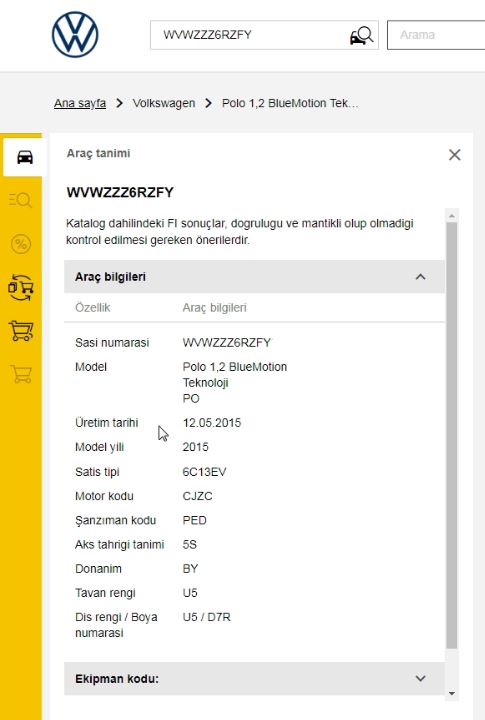

Now, as you know, these cars were built in two plants: Spain and South Africa.
There is one easy way to understand where was your car produced.
The VAG Group uses this kind of VIN algorithm:
First, the country and brand identifier code, for our case it is "WVW"
Then, i guess special section comes and this section is nearly always "ZZZ" in VW cars which i believe means blank, maybe in expensive brands or trucks it can be other story but i have no idea.
Then, the chassis identifier comes. For this generation of polo, we get "6R" (then a "Z" again). For comparison, a golf might have "1J","1K", or a passat can have "3B" or "3C". This surely depends on the car.
Then we have the model year identifier at the 10th digit. For my case, it is "F" which stands for 2015. "A" stands for 2010 and "H" stands for 2017.
11TH digit is the plant number. For EU market, we encounter "Y" (Spain) and "U" (South Africa). For more information you can check the corresponding Wikipedia page. https://www.wikiwand.com/en/articles/Li ... _factories
The rest is serial number for the car and normally for other vehicles (especially japanese originated), lower number means early production but i have no idea about VAG cars.
Normally, there is no prodived VIN checker from VAG unlike Mercedes or BMW. Unless you have the Vehicle ID paper thingy in the user manual and at the trunk, there is no way to check for your equipment. Also, you can not check your build date, only you can estimate from the glasses and production of the parts.
But there is another way actually. By using a paid website called "partslink24", you can check your equipment number and many more. This applies for all cars actually which is very handy. Here is a screenshot for my vehicle information, in turkish.
Also, you can check the equipment info but sadly i have no document for that. But i am sharing the list of "factory" code thingies in my car. Normally, in vehicle factories, the vehicle is built with this equipment codes. A single vehicle might consist from 100 and more codes and these are not option codes. Without a single or wrong code, whole system will get confused. This is a bit easier in passenger cars but buses and trucks have crazy list of codes since they are more specific.
Here is my list of "equipment" codes:
