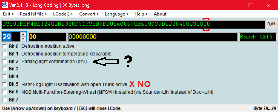

By the way, do you remember the exact function of Byte29 Bit2 in the BCM coding?
My laptop's SSD crashed, and now I don't have the documentation.🤷‍♂️
NOTE: Byte29 Bit5 isn't well documented on the VCDS label. It's used to indicate the installation of control modules for LED headlights.
